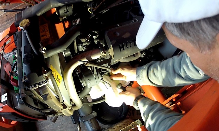

As you said...they should all be that way!!!
Some Kubotas have that...my B3030 was a 30 minute job.
Didn't even have to drain it. Just a "quick swap" of the heater for the plug, and lost maybe a cup of fluid.
