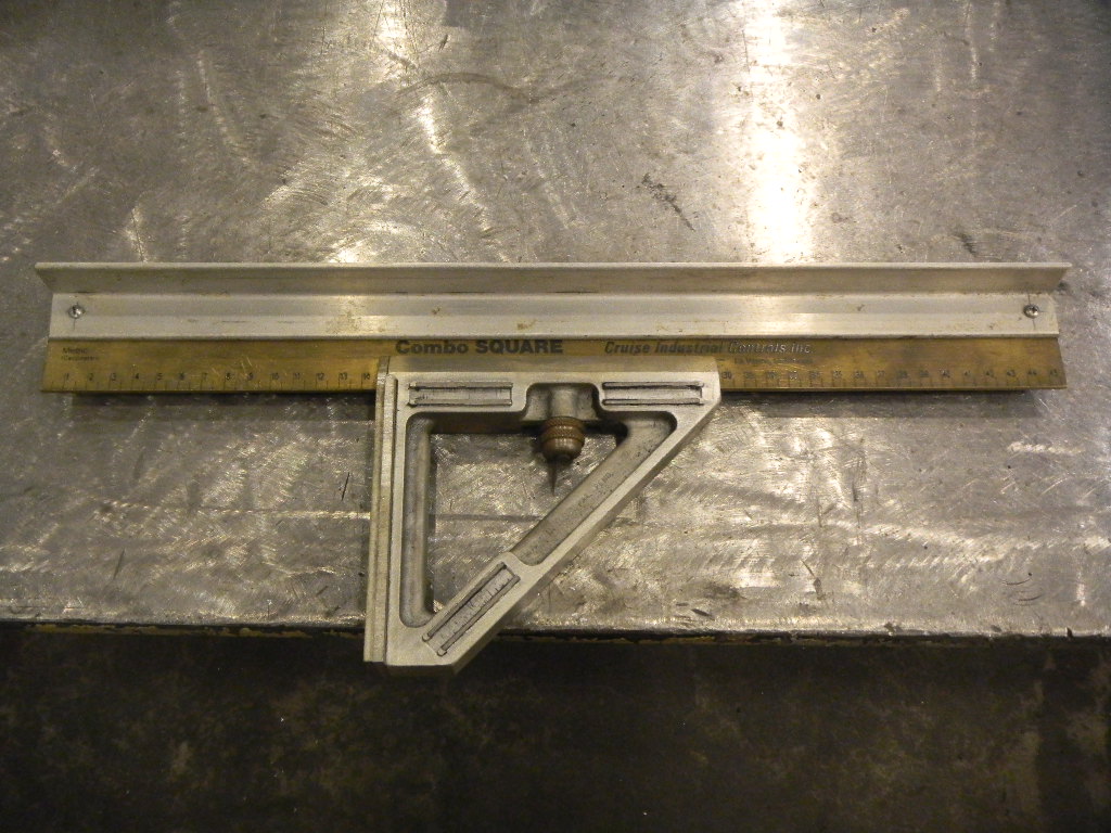

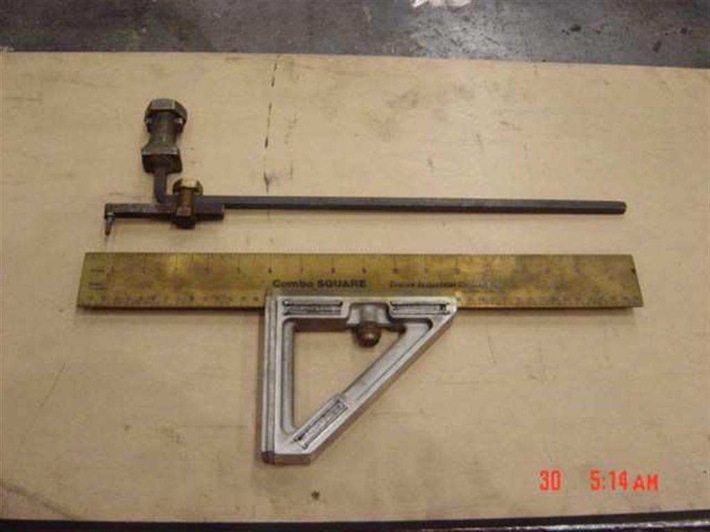

I carried one of these in my bucket for years.

M/W, That was great to see, thanks! :thumbsup:
Shield, does that square elevate the tip for you?
/ Cutting thick (2") Steel #10
I like the combo square with a brass blade! :thumbsup:

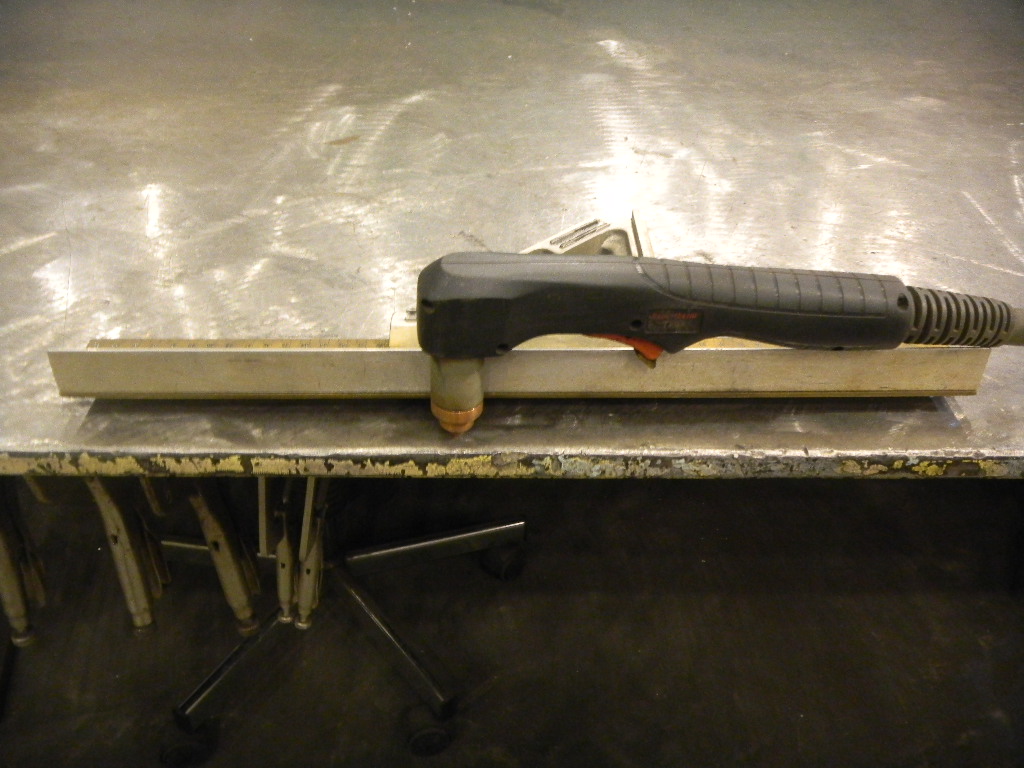

I added the aluminum angle for when using the plasma.

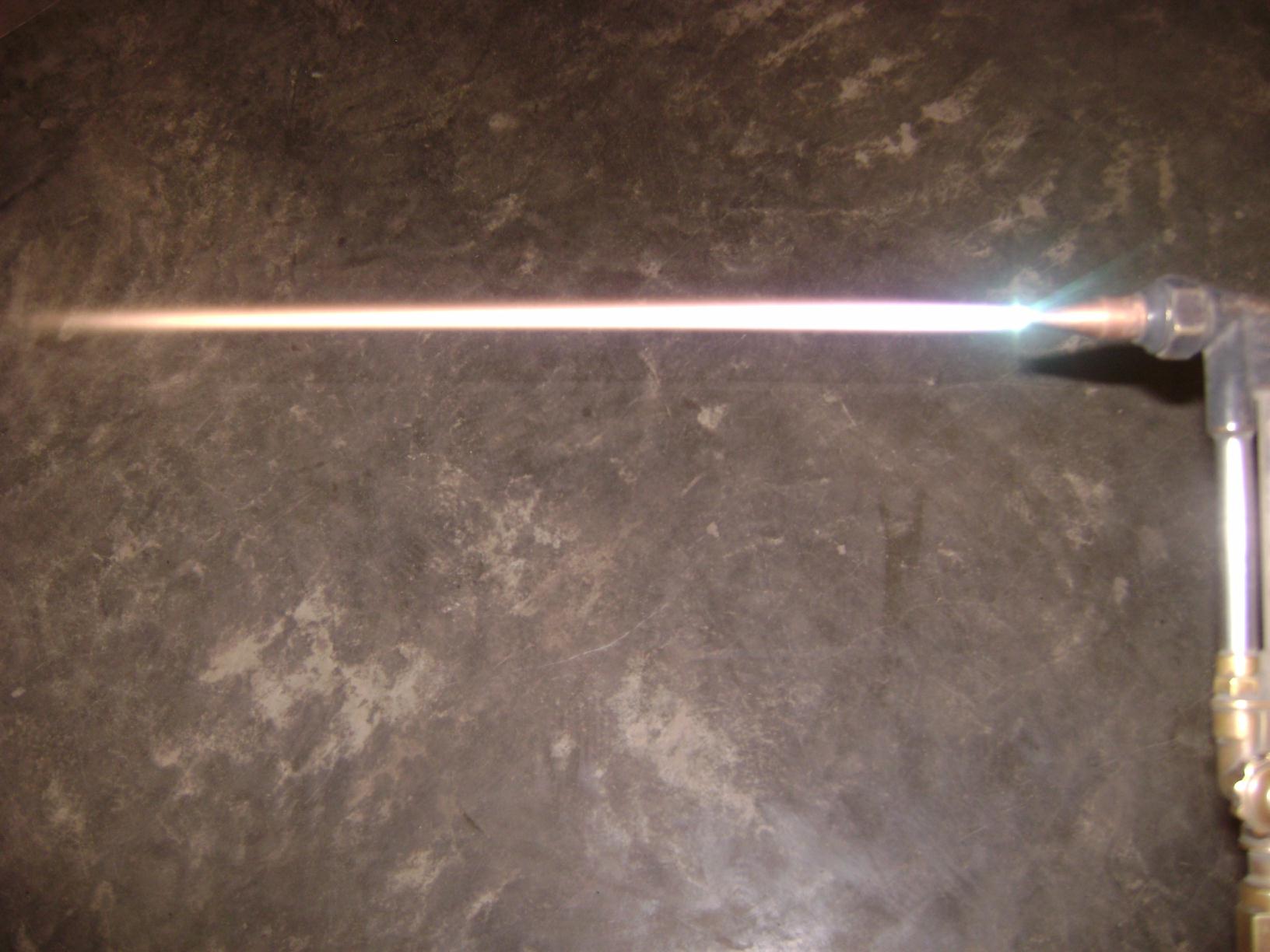

I'm a real hack when it comes to O/A burning. I've worked with a few guys over the years that could burn better free hand than I could with a tractor torch.
When I set up a torch to burn I like to get the cutting cone as long as possible. 99 times out of 100 I only need to press the cutting lever an 1/8 inch or so. When I do find the sweet spot the flame sounds like a small jet engine. :cool:
I'll be copying that as soon as I score some angle. That's slicker than the proverbial deer guts on a door knob.
+1 My little tip that I was referring to will literally split the flame for 2' and it sounds just as you describe. It was a cheepy from US tip company I believe. I wish I would have bought more of them. CJ
