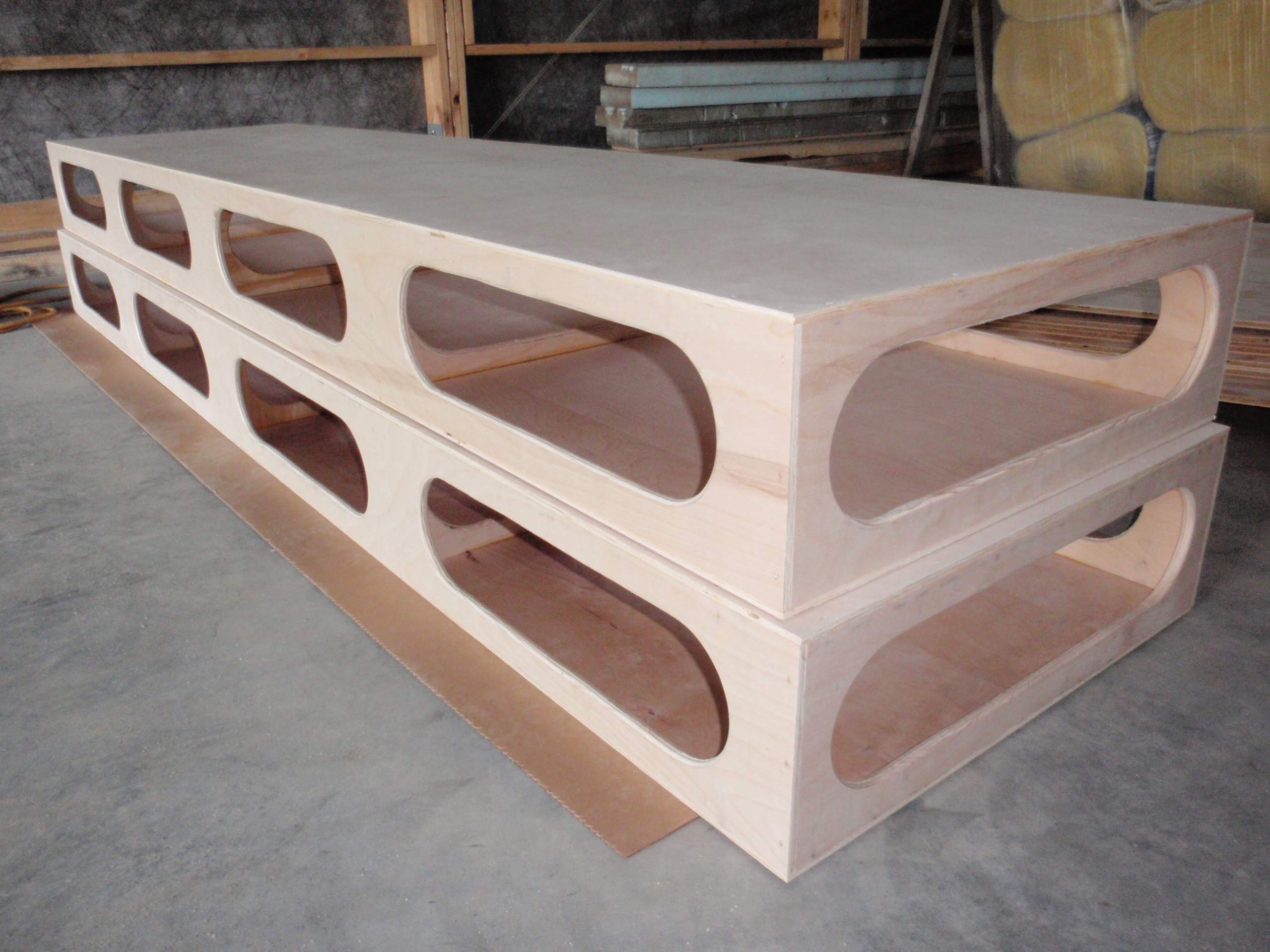

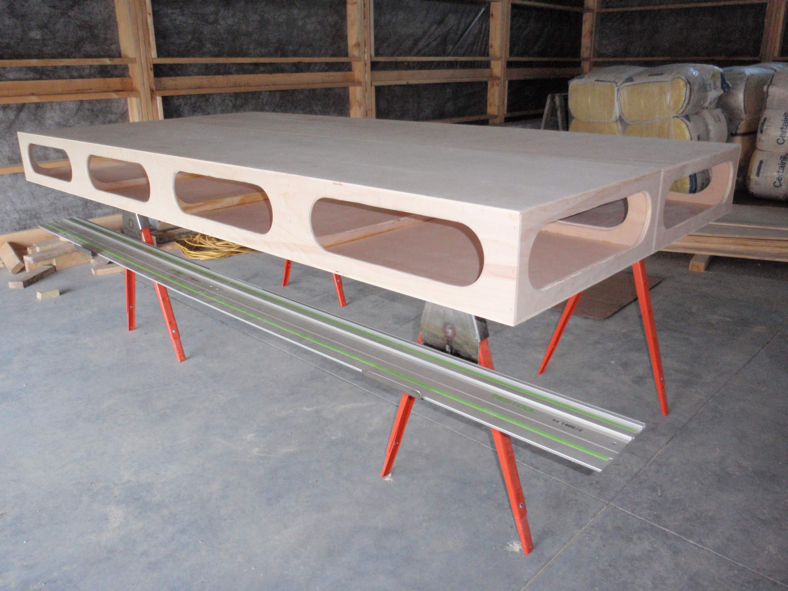

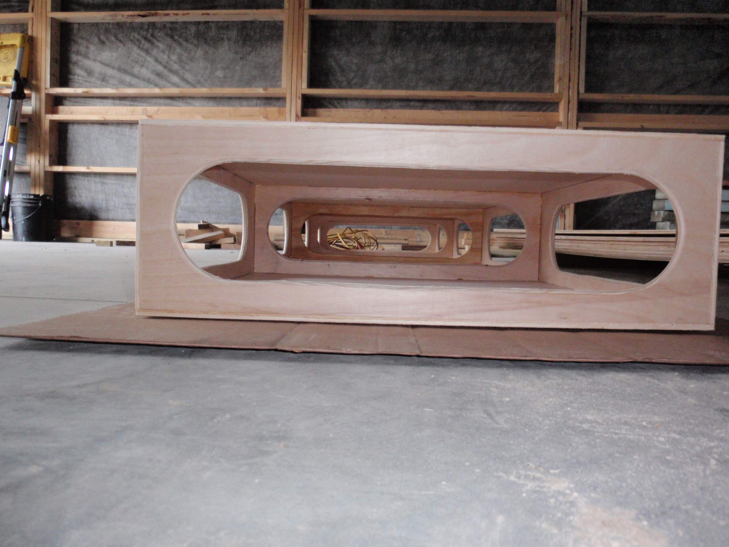

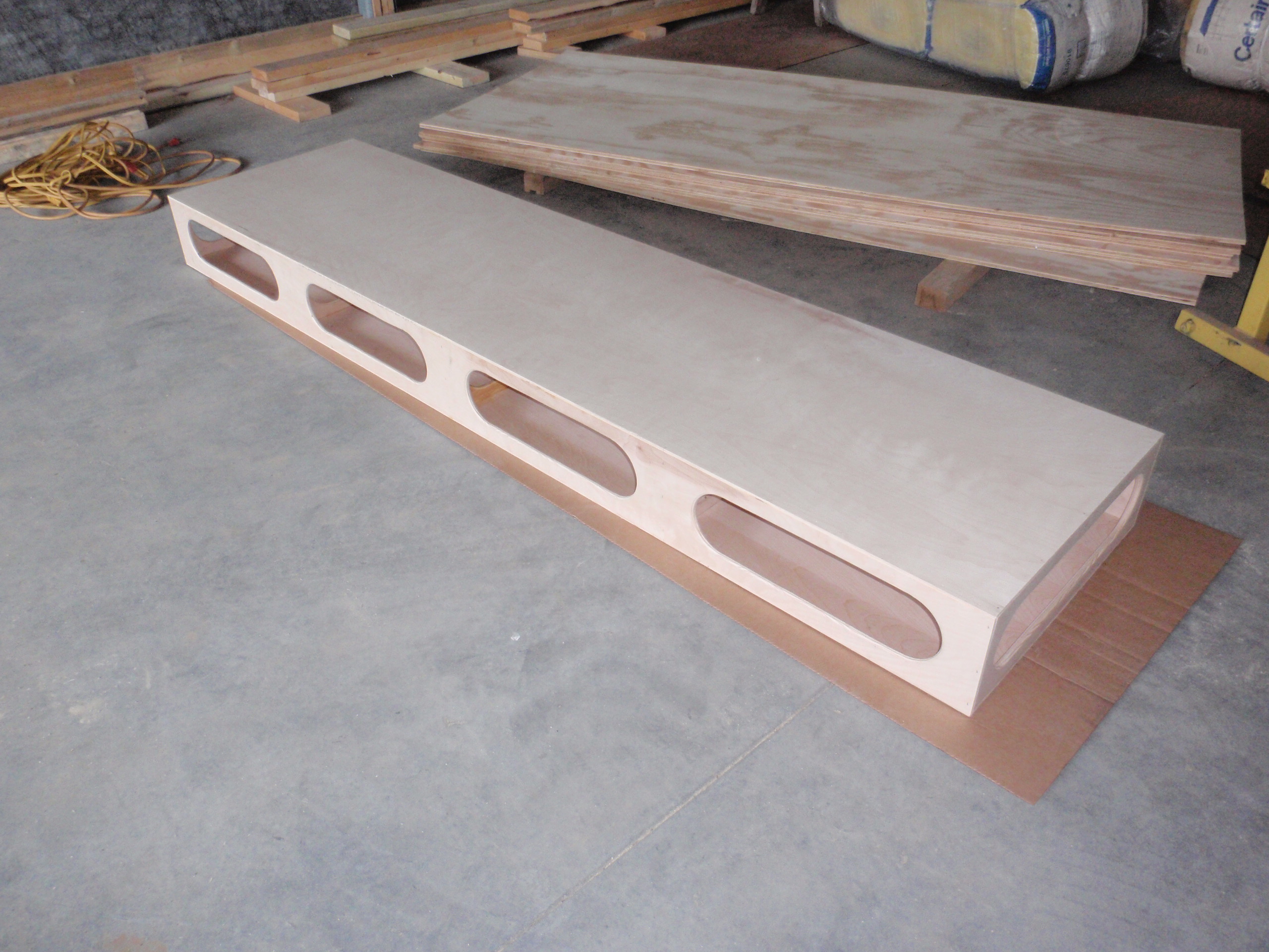

I did a ton and a half of plywood cutting this year, lining the inside of my new shop. I knew what a pain cutting sheets with a tablesaw is, and wanted nicer straighter easier cutting than a couple sawhorses and a skillsaw, so I researched and bought a tracksaw.
http://www.festoolusa.com/power-tools/track-saws/ts-55-req-plunge-cut-track-saw-561556
Holy smokes guys, this thing is the sh*t! Laser-straight, super clean, much better than factory cut edges, it totally made the project a success. And very fast cause you dont really mark the cut line on the sheet, only mark at the ends, and there are no clamps involved. Even angled cuts are simple and fast. Then I also bought the $10 plans for the Paulk cutting table, and substituted purchased metal fold-up sawhorses instead of fabricating wooden ones. Made the cutting table top height the same as my tablesaw and my router table. The whole system breaks down and stores on top of a 6 foot cabinet. It sure is nice to have a 4x8 cutting table, and you can use it for woodworking assembly too. The tracksaw is a Festool TS55. Here are a couple pictures of the cutting table built from plans.
