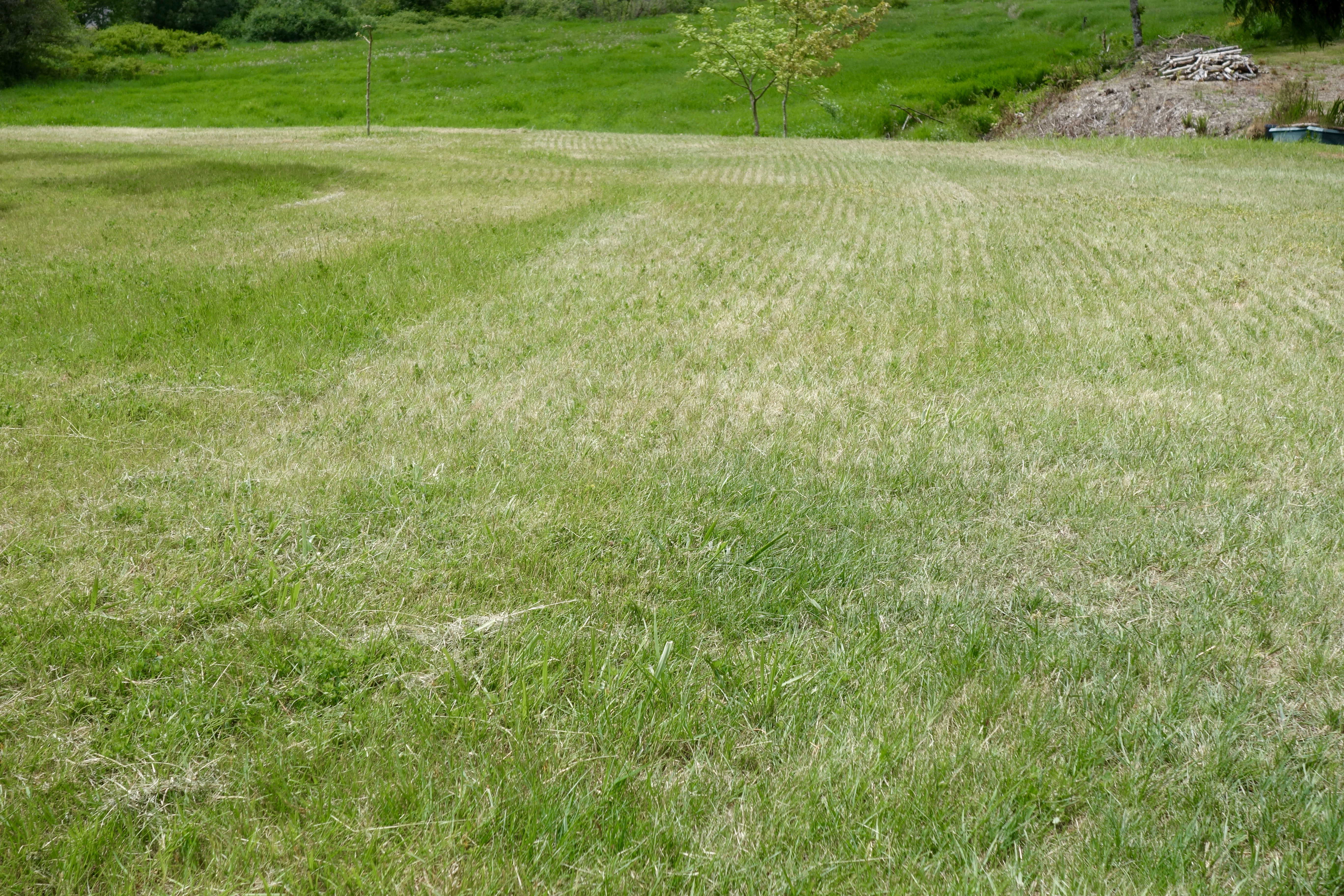

Last year I bought a CK2610 with EFGC 60 flail mower and posted a review of the EFGC after 15 hours. Since then, I followed reviews and comments on this site related to all flails. The collective wisdom has shortened my learning curve. I知 glad I bought the tractor and flail mower. I don稚 need either as my lawn is at .5 acre, slightly sloping to a 2 acre field of reed canary grass on wet ground. Prior to the tractor, I cut everything with a 21 Honda self propelled mower. Attached is a picture of the last mowing. In the distance is my field of reed canary grass. The flail roller is set one bolt hole lower than the lowest setting with the top link on the short side. The tips of the 添 blades are within a 1/4 of the ground. After a couple more mowings, I値l drop the roller a little more and lengthen the top link to increase the length of lawn grass but for now the blade tips do a good job of removing moss build up. For those of you wondering about the flail cut on a lawn, the picture will give you an idea. It痴 not the same as my push mower but it痴 passable and I get to do most of the mowing sitting down. If your just cutting lawn with occasional brush work, I wouldn稚 be too concerned about flail width and tractor hp. When I tried to cut the reed canary grass, I needed all the hp the tractor produced and still used the draft control to reduce cutting resistance.

Last year I bought a CK2610 with EFGC 60" flail mower, made in China, imported by Braber Equipment. I posted a review of the EFGC after 15 hours. Since then I followed reviews and comments on this site related to all flails. The collective wisdom has shortened my learning curve.
I'm glad I bought the tractor and flail mower. Prior to the tractor, I cut my 1/2 acre lawn with a 21(?) Honda self propelled mower. The flail cut does not equal the Honda mower cut but flail cut is passable and now I do most of the mowing sitting down. For those wondering about the flail cut on a lawn, study the picture. In the distance is my field of reed canary grass.
The flail roller is set one bolt hole lower than the lowest setting with the top link on the short side. The tips of the 添 blades are within a 1/4" of the ground. After a couple more mowings, I'lll drop the roller a little more and lengthen the top link to increase the length of lawn grass. The flail blade tips do a good job of removing moss build up.
If you are cutting lawn with just occasional brush work, do not be too concerned about flail width and tractor horsepower. The lawn slopes to a two acre field of reed canary grass on wet ground. When I cut fiberous reed canary grass I needed all the horsepower the tractor produced and additionally raised the (draft) (position?) control to reduce flail load.

I'll bet it does take more HP to cut that low. But once you get it groomed to that level it should be easier to maintain with less power.
