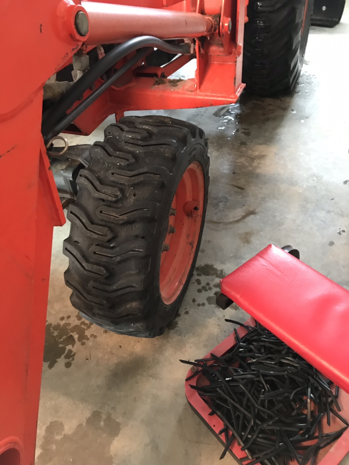

I’ve had two opportunities to test these already and I can say with confidence the grooves make a difference. The first was 2-3 inches of powder on ice. The second was 3 inches of heavy wet snow. I was able to move snow uphill on the drive in a couple spots where I would previously spin and have to dump my blade, head uphill and plow downhill. That required a lot of manual blade adjustments.
For me this was a decision based on two factors: 1. The grooving iron cost 1/10th the price of chains and wheel spacers. (~$80 for iron, ~$800 for chains/spacers. 2. Grooving is a permanent mod requiring no prep work when needed.
So far, I’m very pleased with the investment. It may be one of the best ROIs I’ve made on this machine.

Anyone know if siping or grooving the track on a CTL would make a difference in snow? right now I have a NH C175 and it came with the block tracks (large alternating squares). It is awful in the snow when plowing. New tracks are along the lines of $1700. Studs for CTL tracks are about $800. If I can spend less than $200 to make these tracks work better in the snow I'd be a happy camper.
   / Cutting / Groving / Siping R-4 for snow #651
Watcha gonna do with all of them "fishing worms" :)

The grooved R4 tires on my L3200 have performed well in the several years since they've been done, but an experience today with the L4240 / grooved R4's was nothing short of amazing. I had made one pass down the driveway and turned around at the road to plow the other half coming back. Pushing snow, the tractor didn't quite make it all the way to the top of the hill.
It was only after clearing the snow as best I could that I realized the whole driveway was solid ice. The below pictures show the hill. There's an old tree stump off the side of the driveway in two pictures. The tractor made it that far before running out of traction. Wanting to experiment a bit, I tried plowing uphill a few more times but the tires kept breaking loose near the top. I made several trips just driving up and down the hill and it could easily make it up the hill with the blade raised. The hill is so icy I had to walk in the soft snow on the side to get the picture showing the side view.
