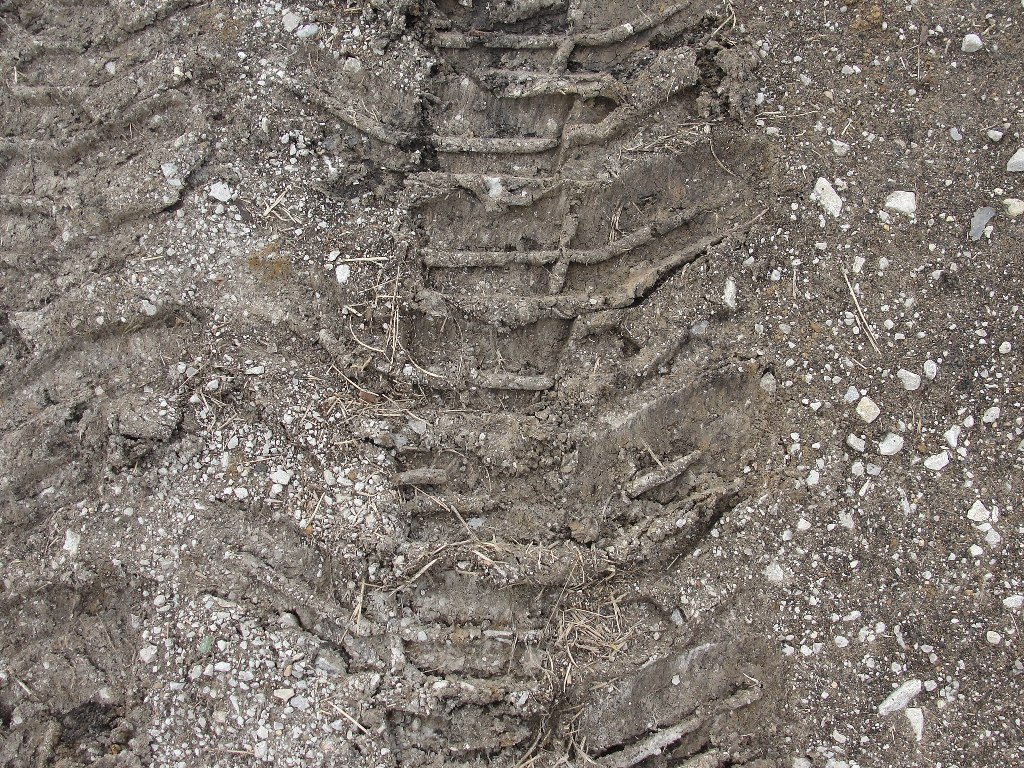

My gang uses a tire cutter a LOT on 4x4 rigs.

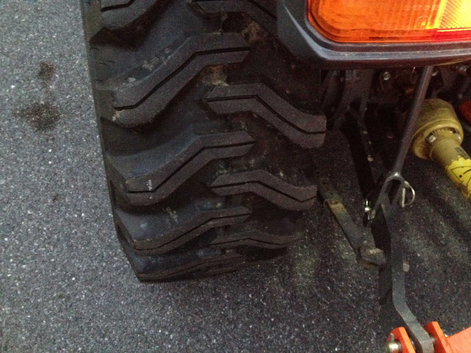

I used it on my previous tractor's rear R4s. Noticed a marked improvement on snow and especially on hard packed dirt. Sorry I don't have better pics.

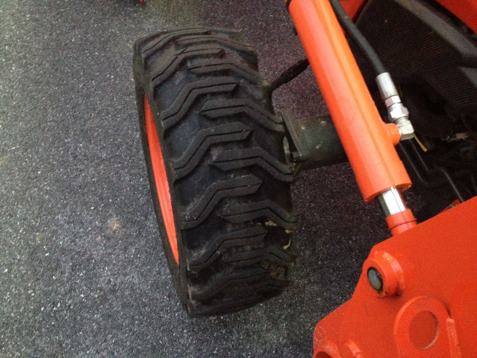

Some of the guys I work with race dirt track cars. One lent me his Ideal groover (said he won't have any use for it till April). I did the rears first with a #4, then switched to a #3 for the front. Doing the rears required moving the tractor several times because the fenders blocked access.
The #3 blade had just finished heating up when Wifey said we needed to head into town to catch the bank before noon. I checked the time and it was 11:18 as I started on the front tires. At 11:42 the front two tires were done and I pulled the groover's plug.
The Ideal groover tolerates two-handed pushing well. I did have two places where it went a little too fast and missed the turn trying to follow the shape of a lug. See the top of the front tire photo.

Good job Chim. Looks professional and factory done.
