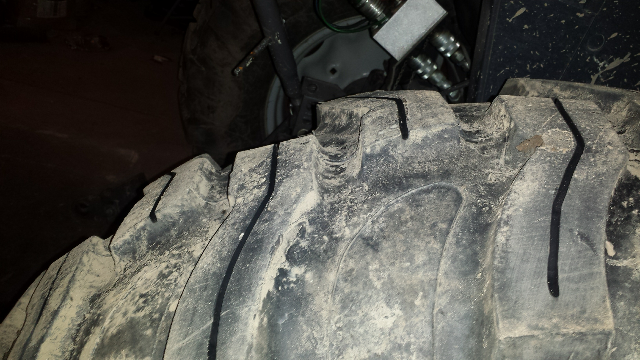

Based upon GarandMan's last picture maybe some sipes would improve snow traction as well. I always thought of them as a feature to improve wet road traction but you can see the snow packed into the sipes also.
/ Cutting / Groving / Siping R-4 for snow #662
Don’t think siping would work as well on R4’s. Sipes bend forward or back under load to create additional edges into snow and ice. Then the wearing of the tire “resharpens” the edges.
The R4 blocks are so massive not sure you could get that to work. The local tire dealer recommended studs, which can be inserted if you don’t groove the tires. For folks running on paved drives that may not be an option. We ended up with chains so I could work in the woods.
/ Cutting / Groving / Siping R-4 for snow #663
Summary: you have not tried this yourself and thus dismiss the effort.
I have tried it, and have empirical proof the technique is an improvement: I couldn稚 push snow up the hill in my driveway before I grooved the tires. After grooving, I could. See where the snow is sticking?
Winter tires have special tread compounds, but that is not the entire story. They also have different tread geometry.

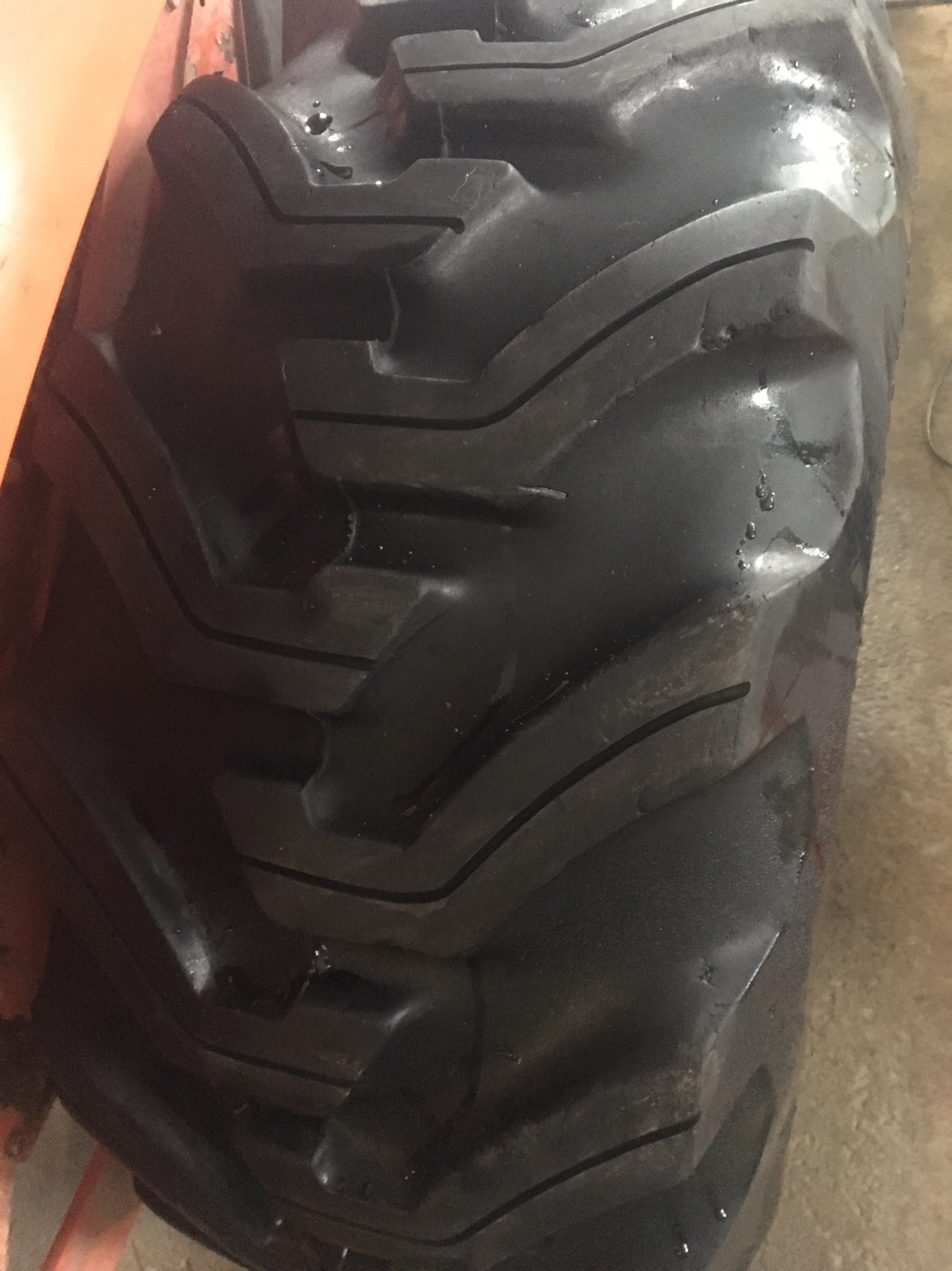

I’ve noticed improved traction with my L3540 (loader rears and 6’ inverted blower on back) on our long hilly blacktopped driveway for sure. Where I used to need to engage the differential lock to push snow uphill (and still struggle), I can easily go up without it. Better on the trails too.
57056236489__C6ACA138-D248-4655-850D-0C11BB7AD2F5.JPG57056243611__87827FFF-BB0A-4723-AAD9-7536A0DB2FEC.JPG
/ Cutting / Groving / Siping R-4 for snow #673
Thanks again, it worked out great. Putting a propane salamander in front of each tire for a few minutes certainly made it easier.
View attachment 592905View attachment 592906
Good to know... that is exactly what I have a newly paved steep blacktopped shared driveway... about 800ft or so.

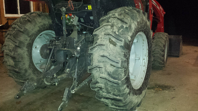

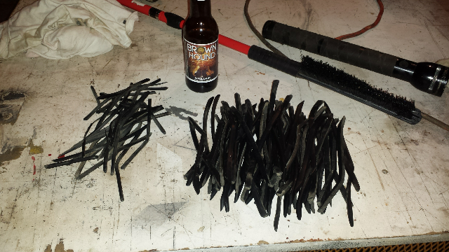

My plan is to both groove and sipe my R-4's for better traction. This evening, I did the grooving part. 20 minutes for the first rear tire, 15 minutes for the second (since I had some practice on the first). Here are some pictures of what I did. I'm hoping this improves snow traction some.
When I get a chance I will sipe them on either side of the grooves for even better traction in hard packed snow/ice. The theory is, the more biting edges the better the snow/ice traction.
It's snowing now, I'll see how they go in the morning! 👍
Great theory, it worked for me.
