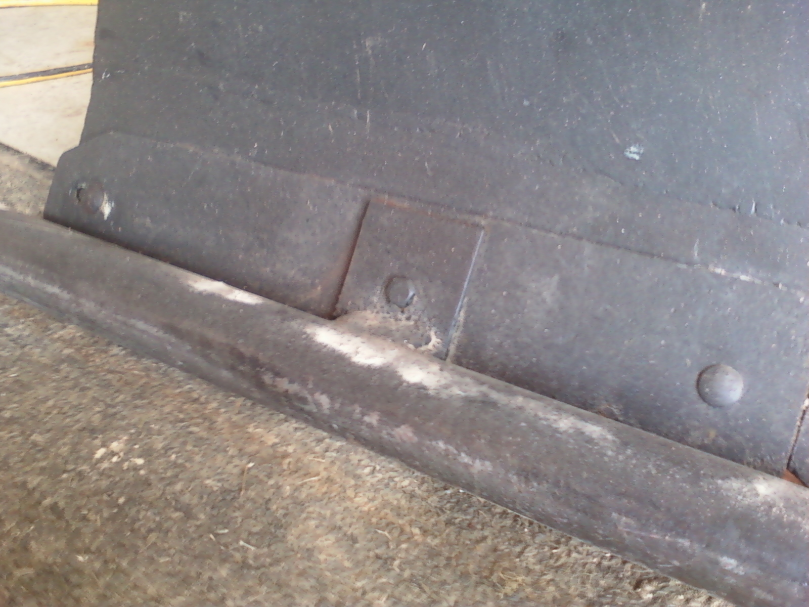

News flash: THERE IS NO NEED TO SLIT A STEEL PIPE FOR THIS PURPOSE. :confused3:
Weld some tabs on it, and bolt it on in front of the blade. If you do it right, you won't notice the difference, and neither will the plow.
/ cut pipe for plow cutting edge
#26
Got a pic of how it's attached? Tab size and thickness? I'd rather not slit the pipe, for sure.
Jim
/ cut pipe for plow cutting edge #27
There are lots of different ways you can do this, without the difficulty of slitting the pipe.
You can make a U shaped tab that fits over the blade, and weld the pipe to the front side of the tab. Like this: oU
Or, the last one I did, I used 3/16" flat, and attached the tab to the front of the blade, and then I welded the pipe to it. Like this: ol
Works just fine. And it only took a few minutes. I have 2 of these tabs, on a 6' pipe.
Aligning the tabs with the existing bolt holes on the plow, makes it an easy job.
I will post a photo, when I get some time in the next few days.

Somehow I have missed the purpose.... I presume its to keep the cutting edge from actually cutting in?
Is this to be used in place of shoes? or with shoes on the blade? Does it end up leaving more snow behind?
/ cut pipe for plow cutting edge #31
Yes, the primary reason is to help keep the plow from digging in. This is of course, helpful when plowing gravel.
My plow has this pipe, and pneumatic casters in place of shoes.
The plow rides primarily on the casters. The cutting edge then can float along on top of the gravel, or since it is a loader frame plow, I can use the bucket tilt mechanism to adjust it so that it rides just above the gravel.
I usually try to pack down the first 3-4 inches of snow, then plowing my drive with this set up is pretty easy.

Ray, thanks for the pic. That was kind of what I imagined. As long as the tabs are pretty stout it should hold up all right. Soon, soon...
Jim
/ cut pipe for plow cutting edge #36
Jim
When you go forward, the force is pushing the pipe up against the blade, so the tabs really don't have much pressure on them.
The tabs only need to resist a lot of pressure, when you back drag the blade. Which we mostly don't do. And, only the bottom edge of the pipe is receiving that pressure, so that really isn't a problem on the ones I have done.
You could also use U shaped tabs, if you do have a problem with it bending from back dragging.
