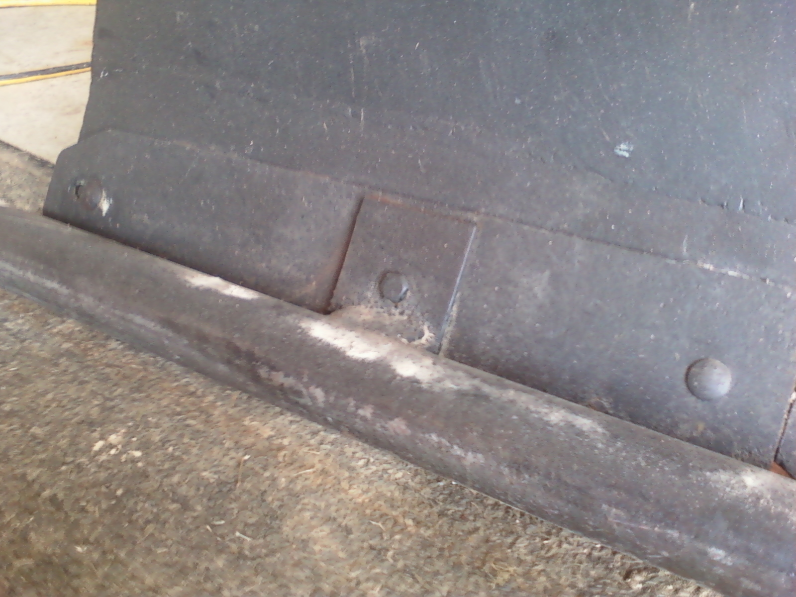

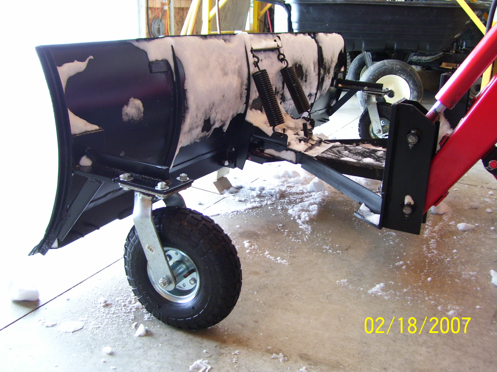

In case you haven't seen what they look like on my plow:
Thanks again. I would like to do something to have gauge wheels added on mine, so this gives me ideas. I've also searched and found some threads on here with various ways folks have done similar, including yours.
I don't have fabrication capabilities, but there is a local shop. I'll have to run some ideas past them, and I think pictures of other solutions will help...

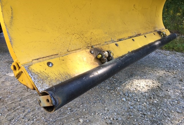

Resurrecting an old thread to show the slotted pipe I added on my 8’ Fisher Speedcast Plow. I have loose crushed gravel on my driveway and hoping this will help keep from digging in before the driveway freezes. It is a 3" pipe with a clevis style point of attachment so it is easy to remove once everything is frozen and ice covered but also easy to put back on for the late spring storms when the ground has started to thaw.

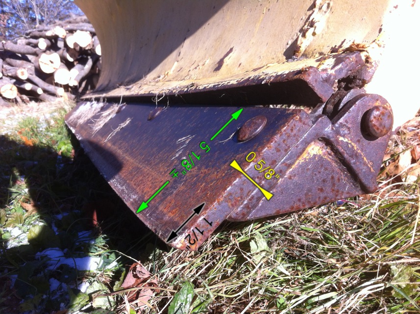

How do you guys who have slipped a pipe over a snowplow cutting edge cut the slot? I have an oxyacetylene cutting torch and thought to use that. Also have 4" grinder but that seems too slow. And do you cut the slot undersize a bit and beat the pipe on? Do the snots from the torch help the pipe "fit" correctly? The pipe is 2" nominal and the edge is maybe 5/8".View attachment 347341
I thought to weld tabs on the end and bolt back to the blade somewhere, though it's a Fisher with a trip edge. Any tips there?
Thanks, Jim
Seriously don’t get too carried away with neat n tidy. I started the snowplow blade 4 years back with oxypropane then got sick of it ( I suck at cutting). Then gave up and finished either a 7 1/4” disk on my skill saw. A cutoff blade on a small grinder works too. This time I used a plasma cutter but I haven’t used it enough to be neat with it. Neat doesn’t matter a bit really . Just hack a slit the entire length . You can spread it using a couple prys, splitting wedges ect. Once it fits over the lip barely I simply banged it on until it’s touching the other side . On the truck plow I welded on 3 tabs to align with existing holes in the frame. With the bucket it’s just sitting there and if it gets pried off I will deal with it then . I will try to think to take a couple pictures tomorrow to stick on here.

I used an angle grinder and cutoff disc to make the slit. It took forever but worked and was the only real option I had. I tried to just beat the pipe on at that point but realized my plow was much thicker than what I removed with the cutoff disc and made it a bit wider. I welded two tabs with holes drilled so I could secure it to the outermost bolt holes where the cutting edge connects to the plow.
