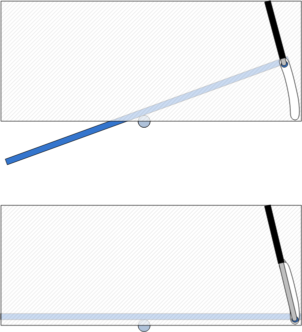

What if you made an arc shaped slit in both sides and had a rod stick through to connect to a pair of rams?
Something like:

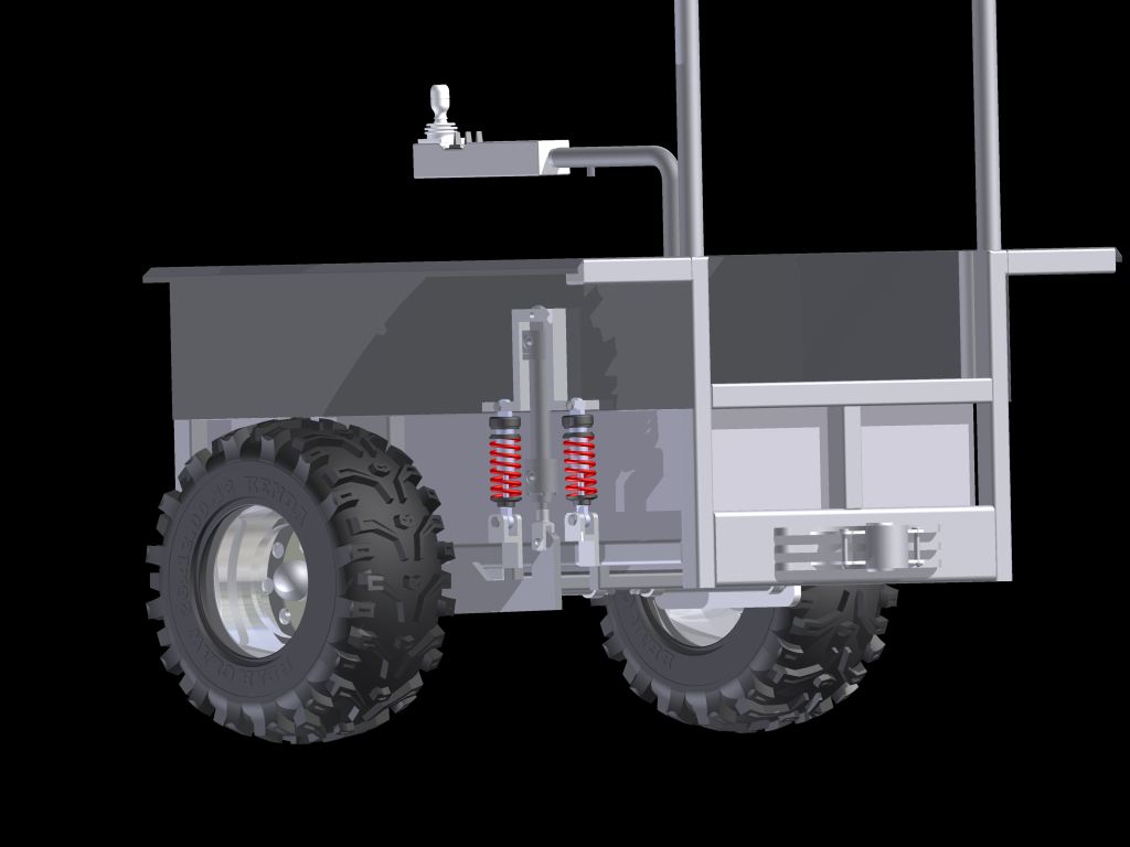

going with an air ride system will kill two birds with one stone, it will give me suspension and allow the front-end to kneel down. Plus there's an option for a self leveling system. Which would be nice on slopes. The cost of the air ride system is making me simplify the system.

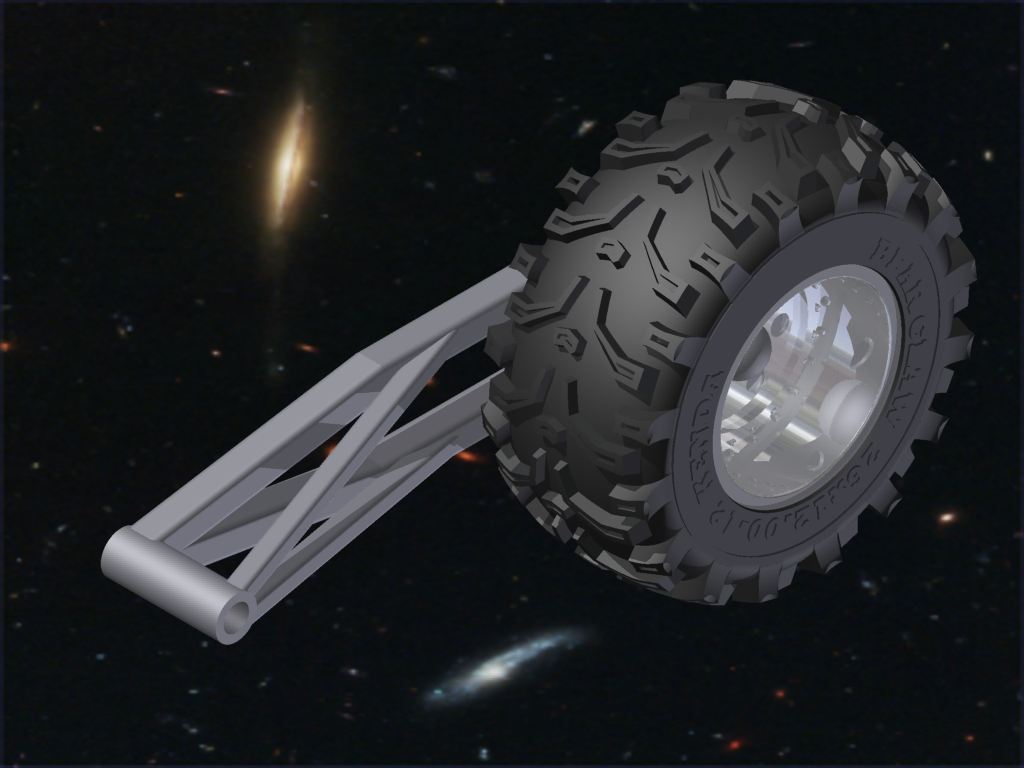

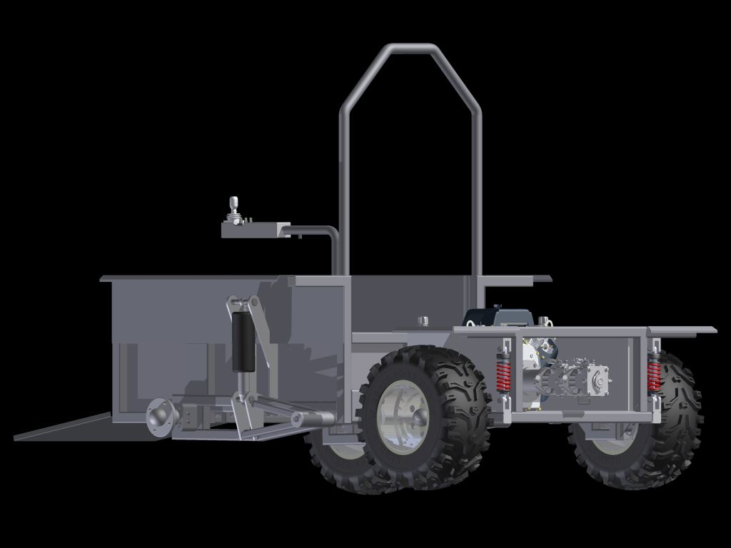

OK, this picture shows the old layout with 2 radius arms + the triangular upper arm (which would be replaced by the panhard rod). If you imagine the coil springs being replaced by air bags, the basic idea would fit. These vehicles have at least 8" of articulation.
So in your case the hardware is simplified. Instead of an axle/differential, you have a tube. You have 2 side mounted radius arms, like what you originally had in mind, just the pivot has to incorporate a pair of elastomeric bushings to allow for some lateral movement. Most leaf sprung vehicles have these bushings for the same reason, the leaf spring has to twist when one wheel is raised and not the other. There is 1 panhard rod connected to the chassis on 1 side and the axle tube on the other side. So now the axle can go up and down and is constrained side to side and is very strong.
Somewhere, you still need drive to the wheels, and the means to allow the wheels on one side to turn faster than the other side when turning. Using a small axle from passenger car could be a relatively simple solution, you drive the differential with a hydraulic motor and it already provides the differential action. Its a pity I have no cad system at home, since whipping up a design like this would not take long.

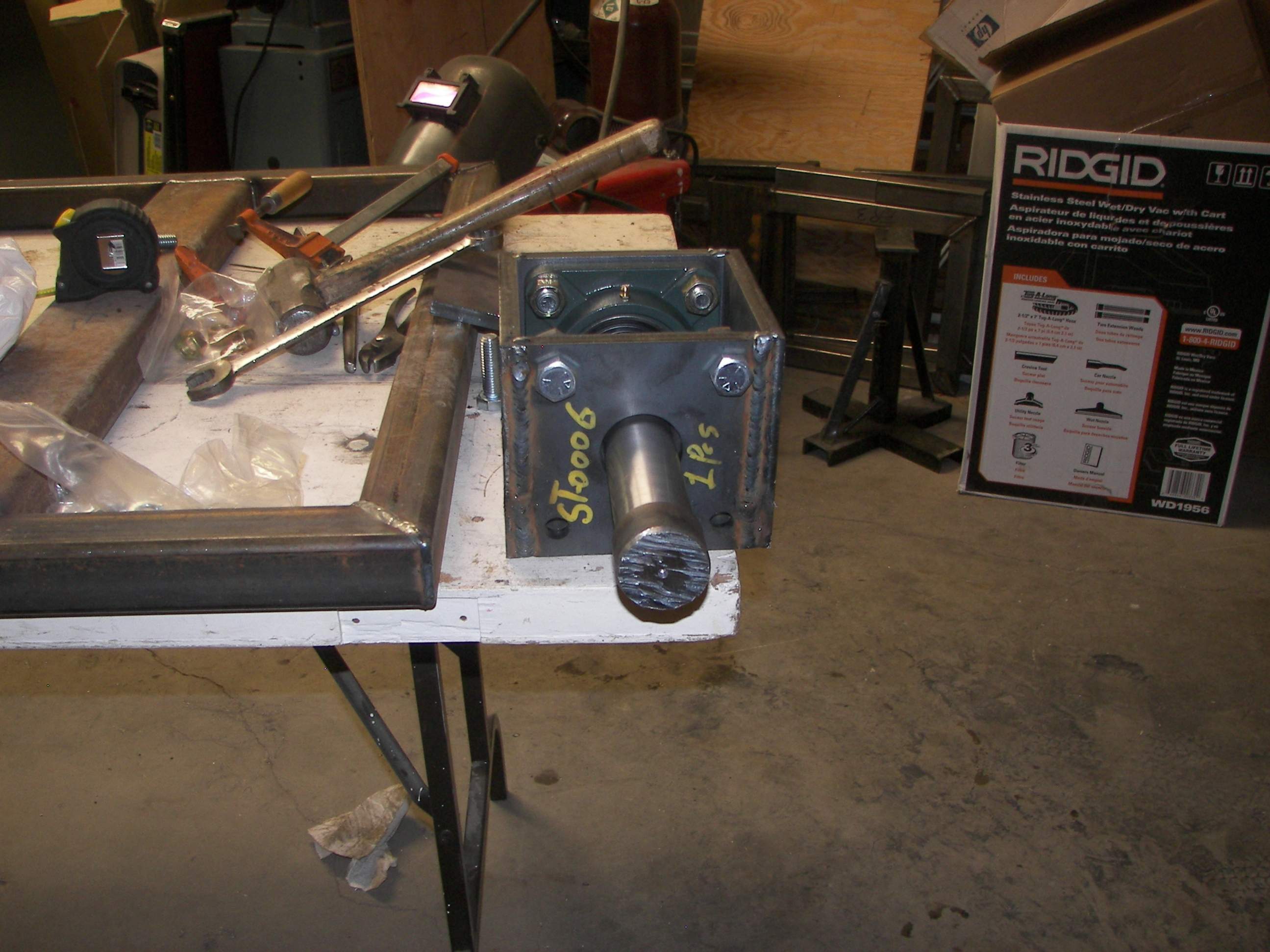

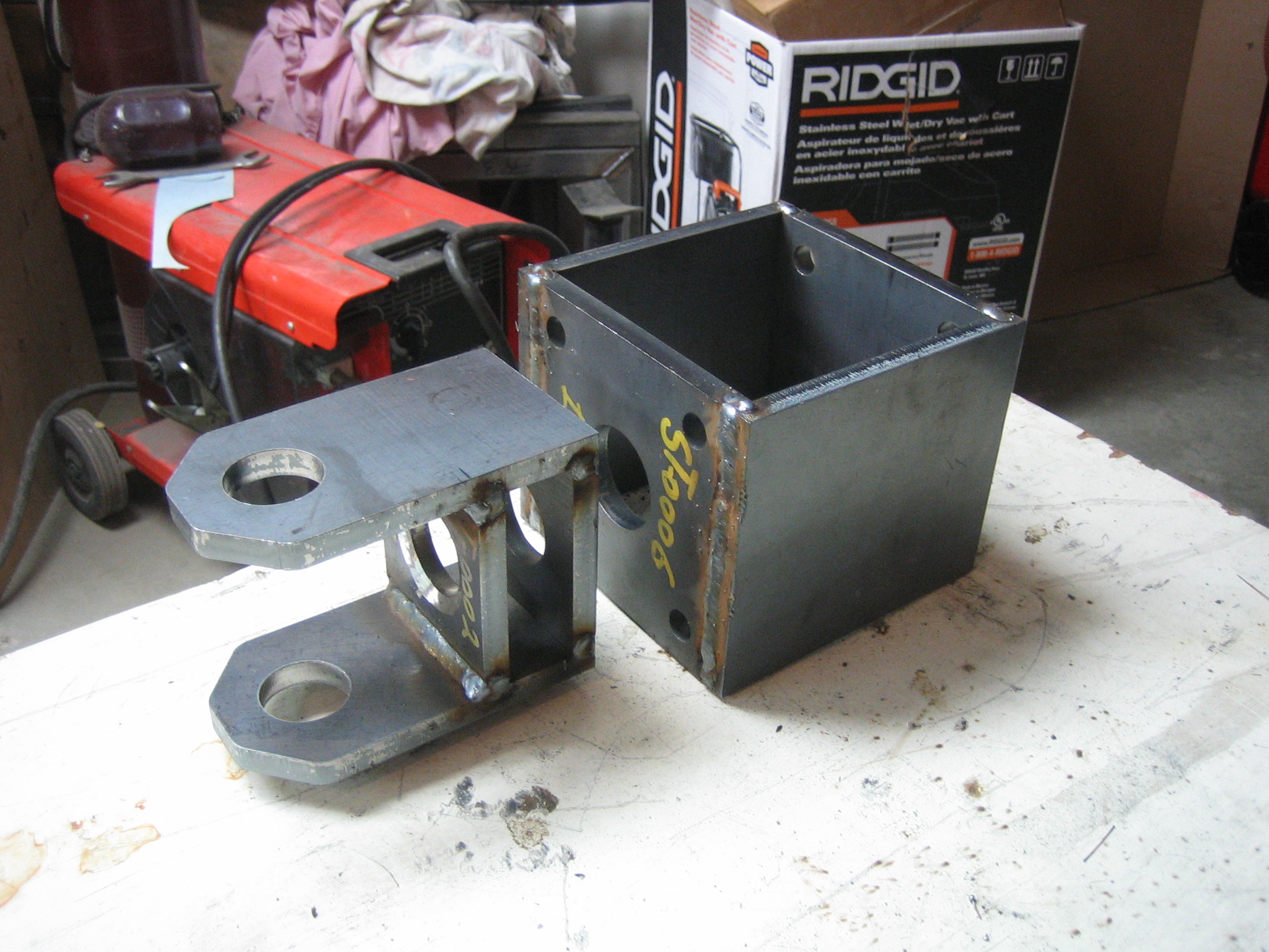

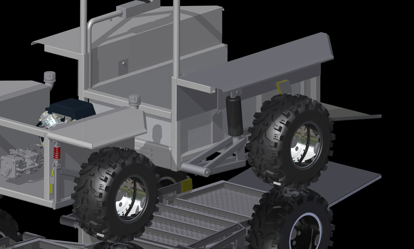

I made a few changes to the pivot arms, I added some more bracing to help the sideload when turning and being on slopes. just looking for some feedback as to whether it will be strong enough or not. The main shaft in the back that holds it all together, is 1.5 inches. It goes completely through the back of the machine to the other side.

Man, that's the coolest looking toy in the world!

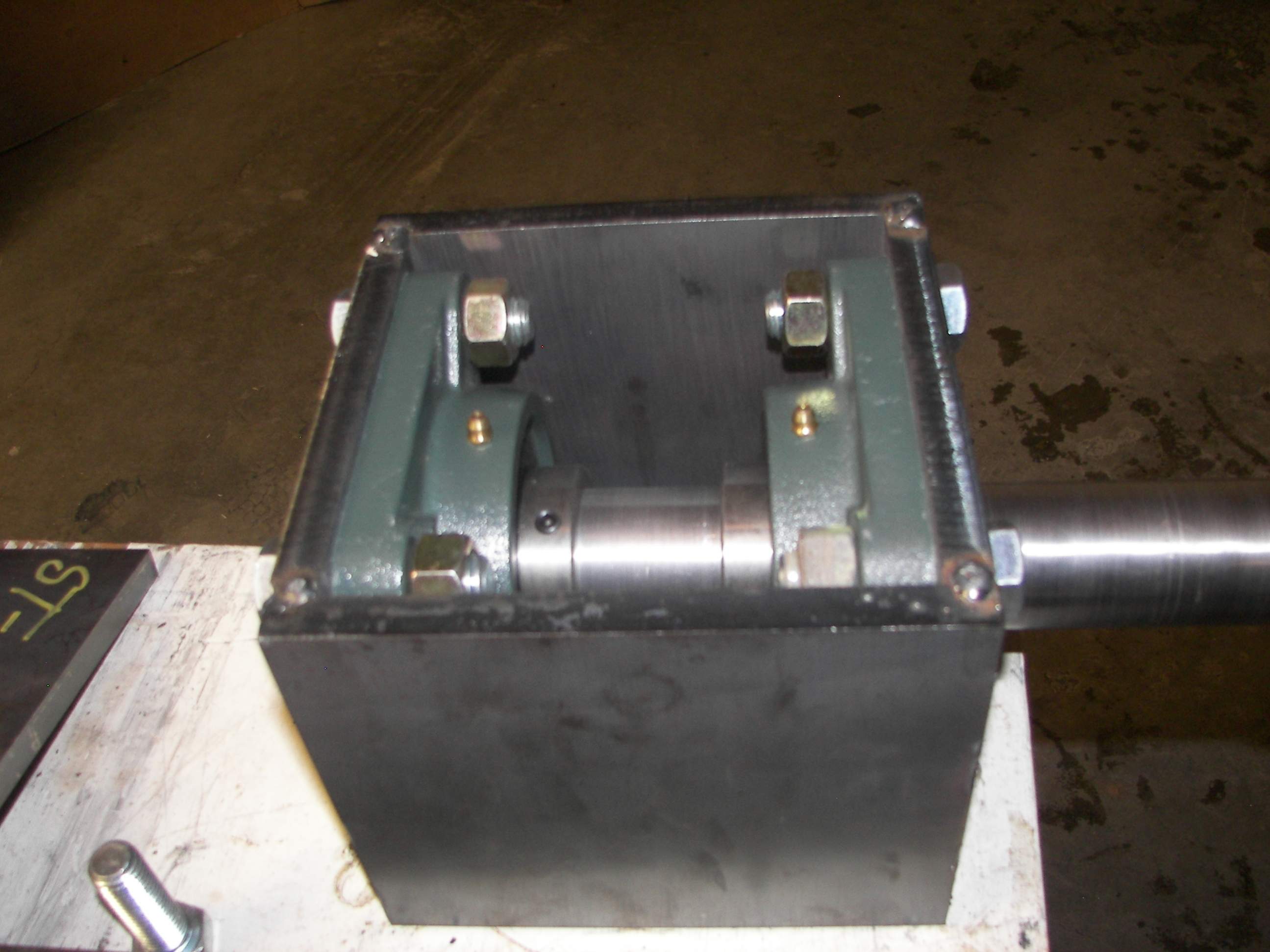

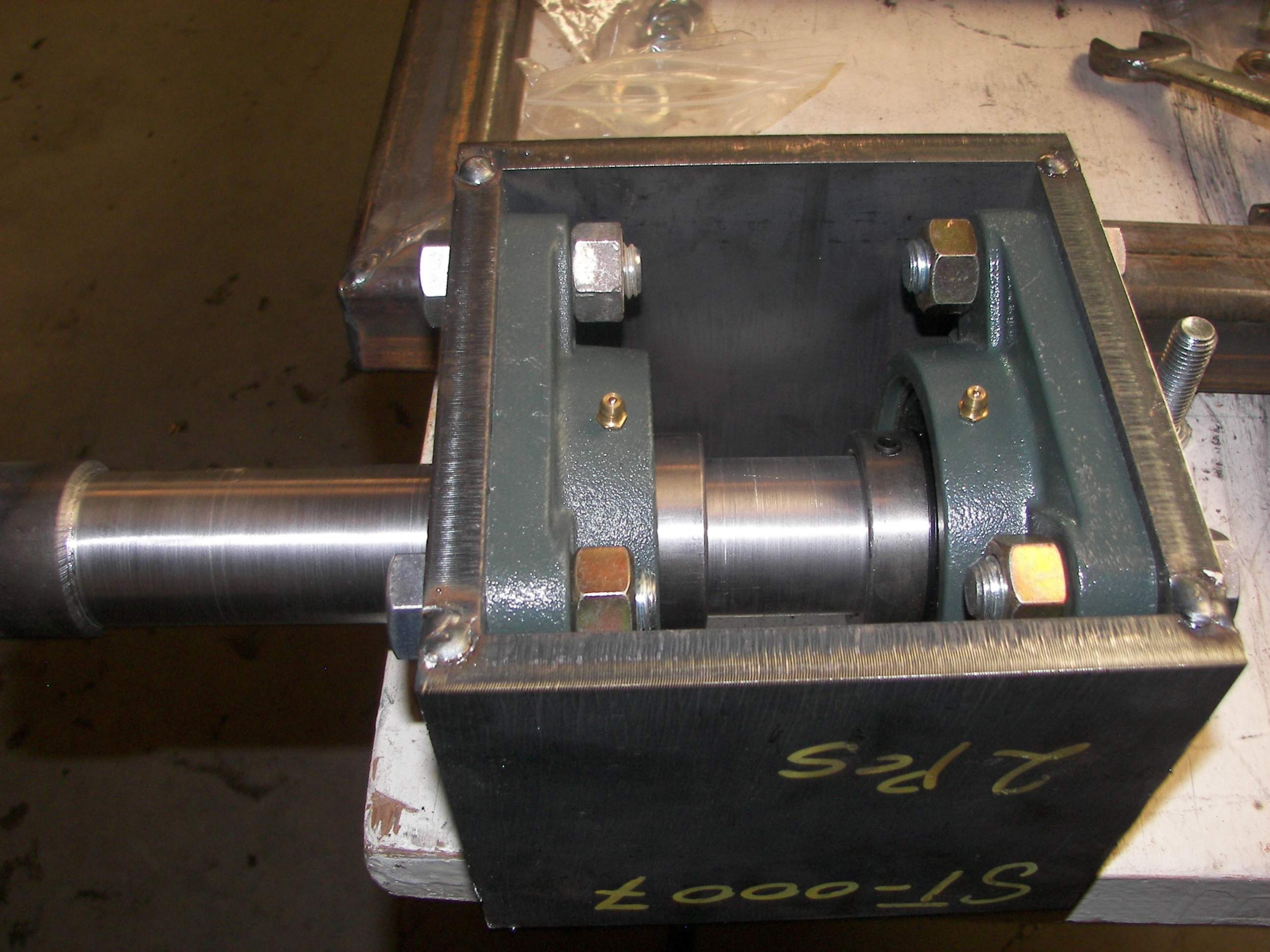

I'm looking for some opinions on which would be the best bushings to use for the front suspension. I've attached a photo that shows where the front suspension mounts and should be self-explanatory as to how it works. What would be the best materials for this type of application. I don't think it'll be too high of heat, but it will be quite rapid movement if the train is rough.
/ Custom UTV #74
If your talking about the pivot point, I would think a needle pin bearing would be best for smooth operation and load capacity,

kdlklm said:
Yes I am referring to the pivot point.
Look into what they use on VW suspension arms. ... I know dune buggies have a similar design.
You maybe able to use a sleeve and rod made from Steel. And then just keep greased with a zerk.
Of course bearings could be installed too...
/ Custom UTV
#78
it seems like urethane bushings are used a lot on pivot points. They are maintenance free, but I'm not sure how long it would last on an application like mine. Does anybody have any experience with them.

#80
that's a good information site, but unfortunately they don't have the size that I need. I need 1.5 ID to 1.75 OD. I was hoping to get a tube of it and just cut the length I need. But that's proving to be difficult. But it does appear that plastics are the way to go.
