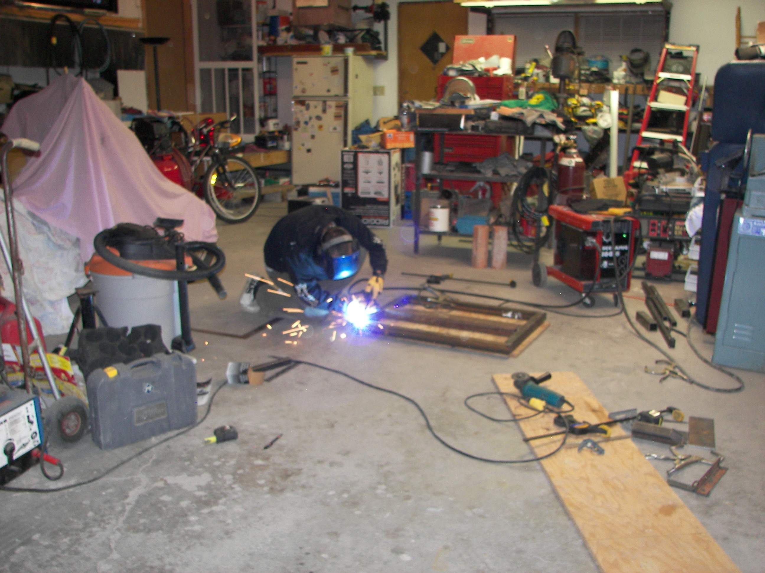

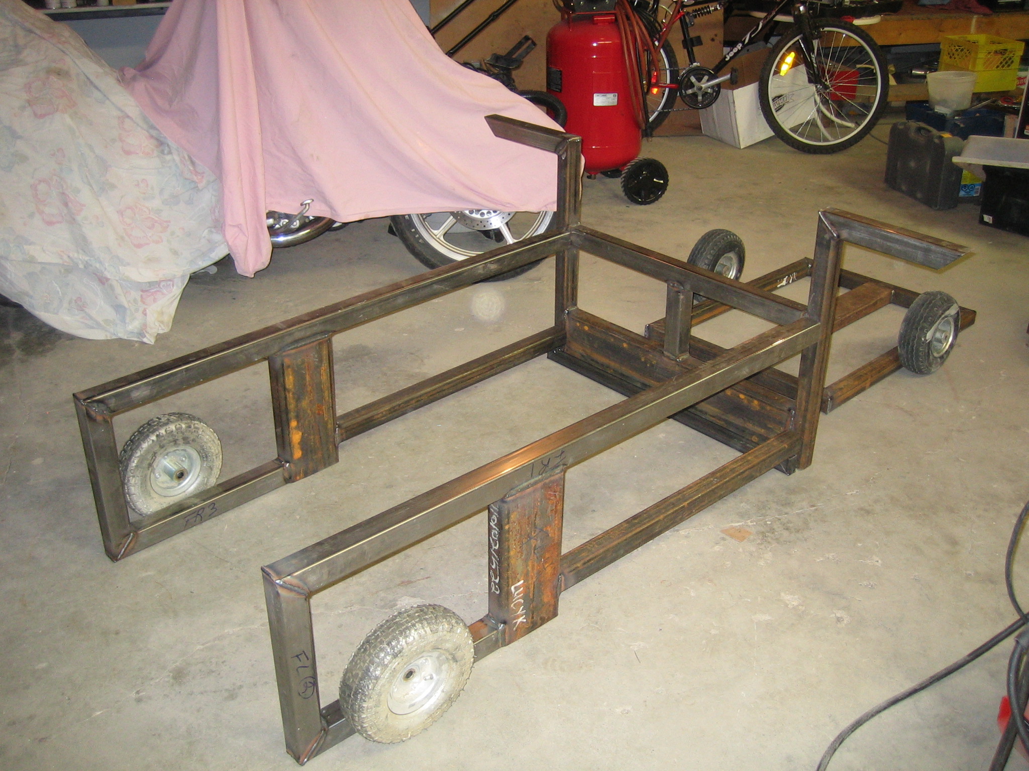

all the hydraulic equipment has already been specked out, from a hydraulics company. They actually got the hydro-gear engineers to run it through all their formulas to make sure that it would give me exactly the performance and the horsepower that I'm looking for. So I'm very confident with what we've come up with.
Boy, this is going to bum out JJ.
/ Custom UTV #28
Starting to take shape, frame looks good.
/ Custom UTV #29
Nice pics! Looks like it's coming along.:thumbsup:
What's that buzz box you're using?

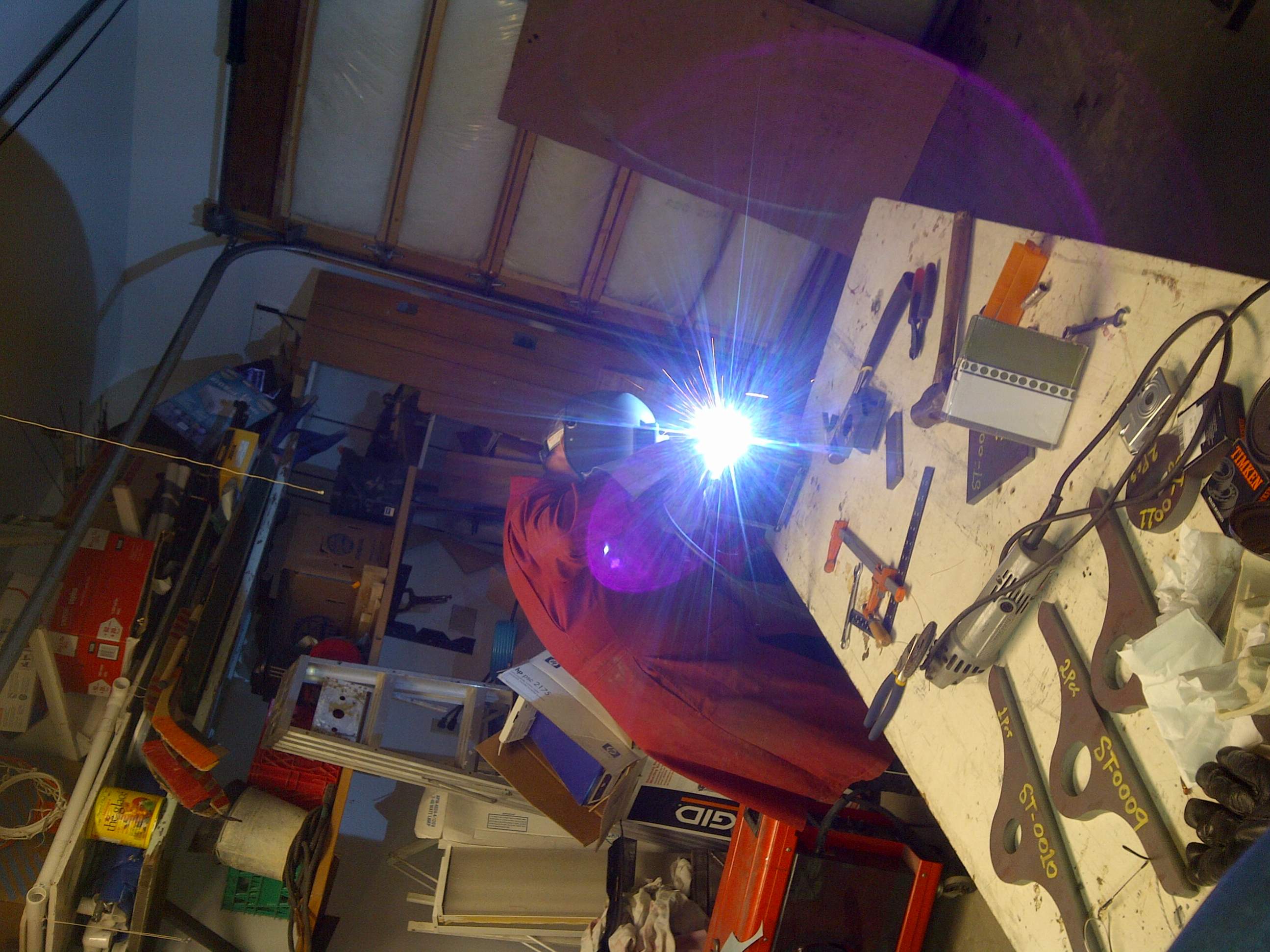

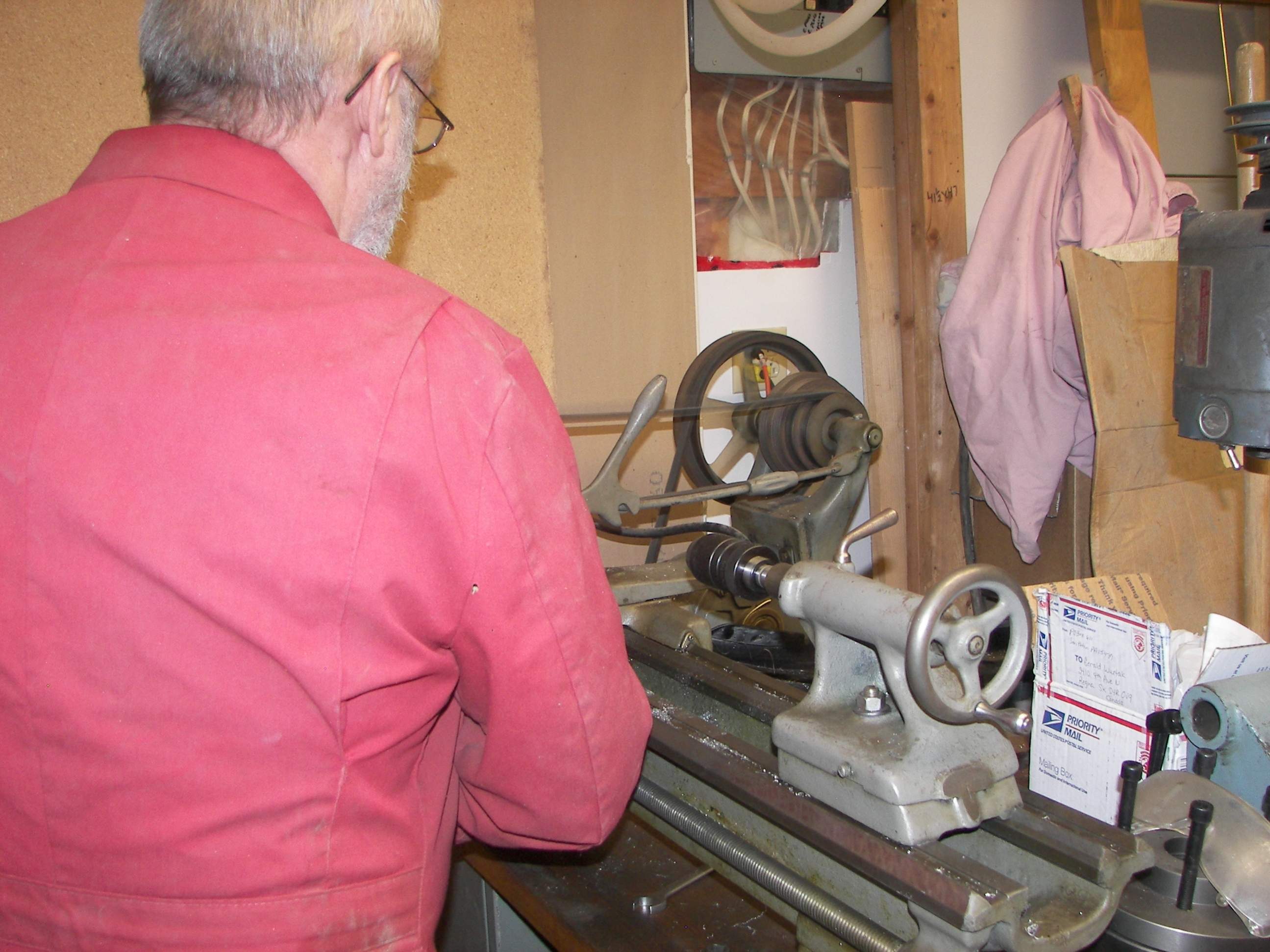

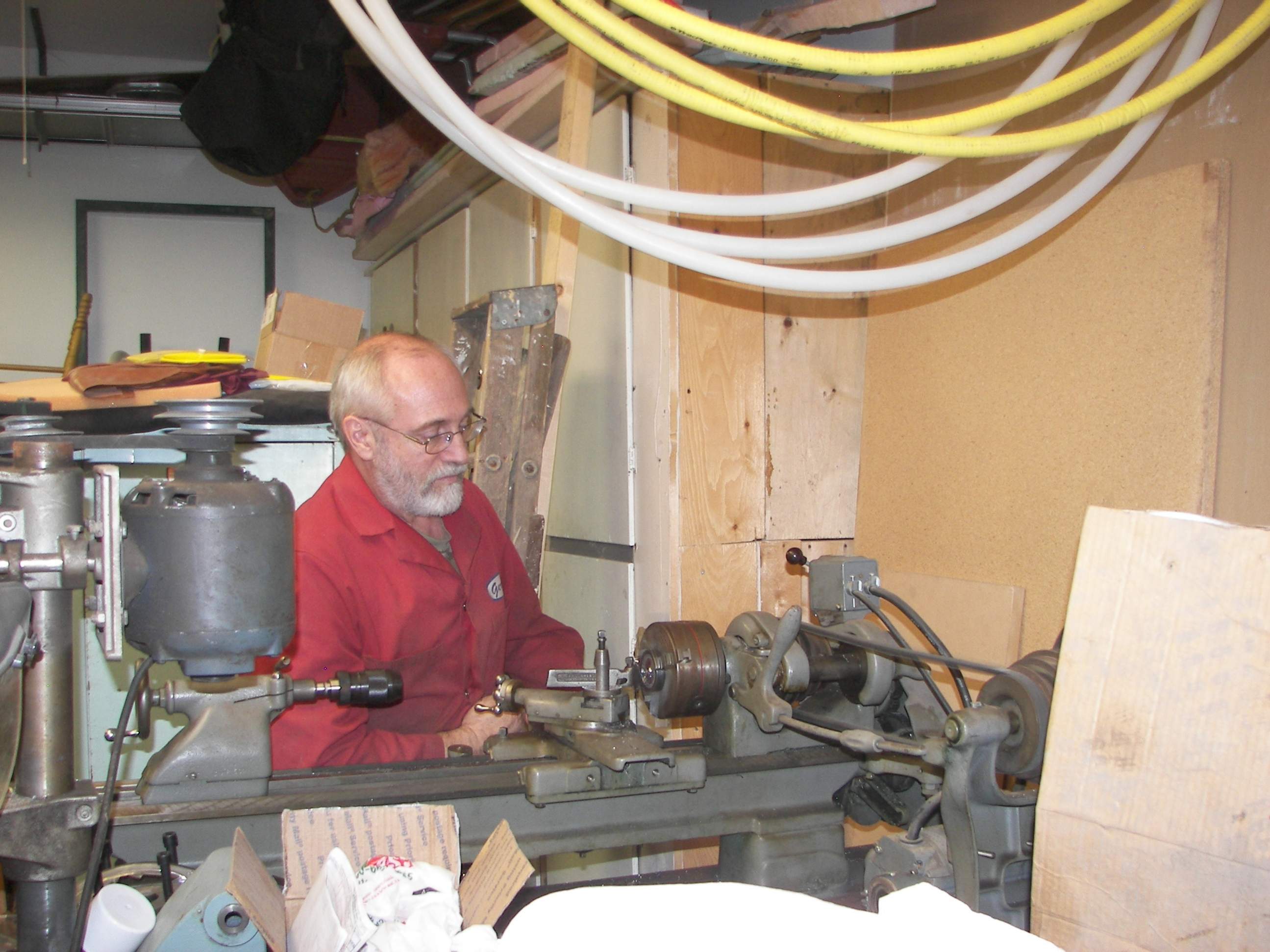

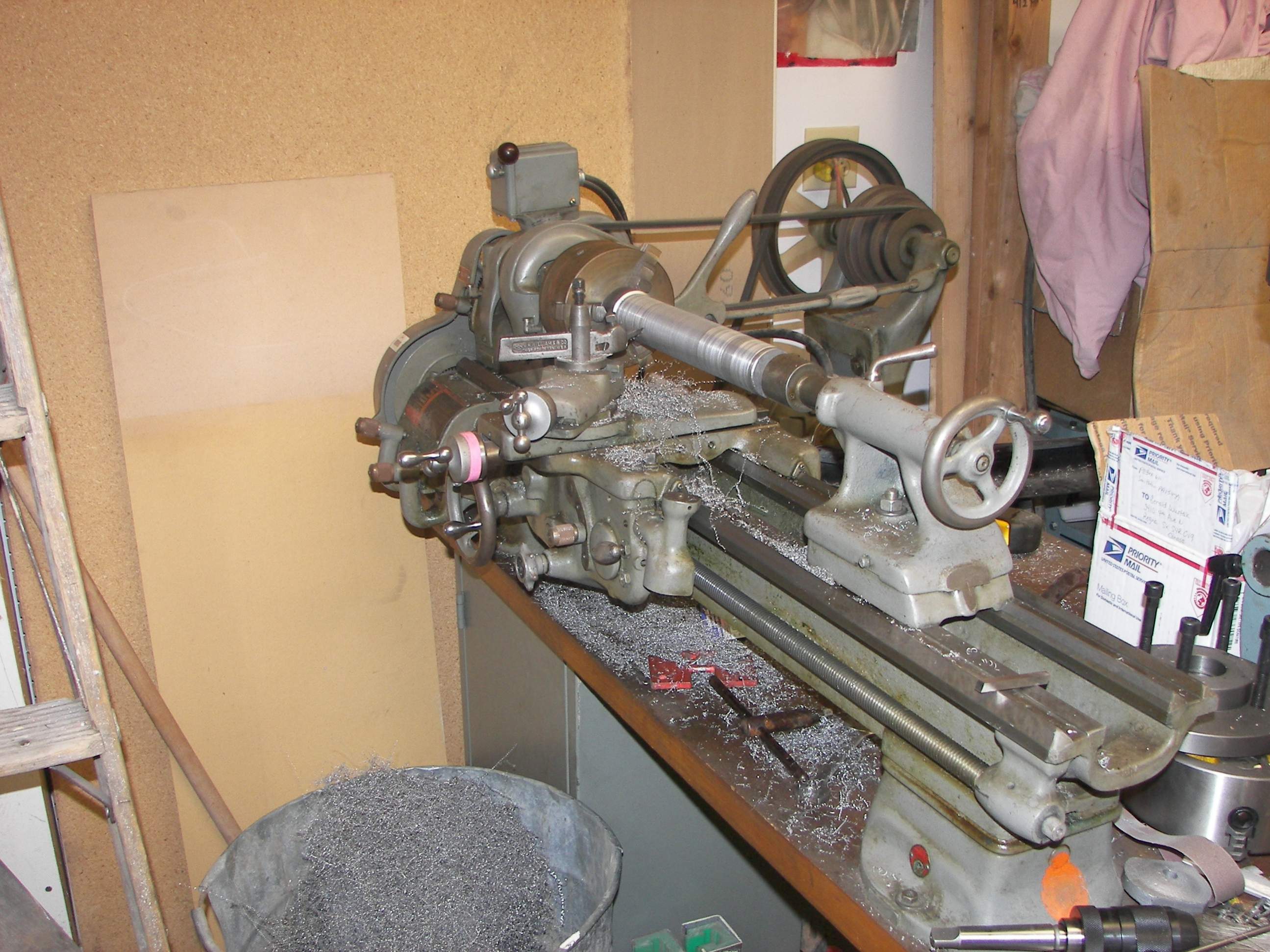

Here are a few photos of forming the shaft for the articulating joint. We didn't have to use the lathe, but we had 2 inch shaft kicking around and then we work it down to 1.75 inch. It only took about six hours, but it was fun playing with the machine. That's not me in the photo, that's Jerry, one of the nice people that volunteered to help me out on this project.

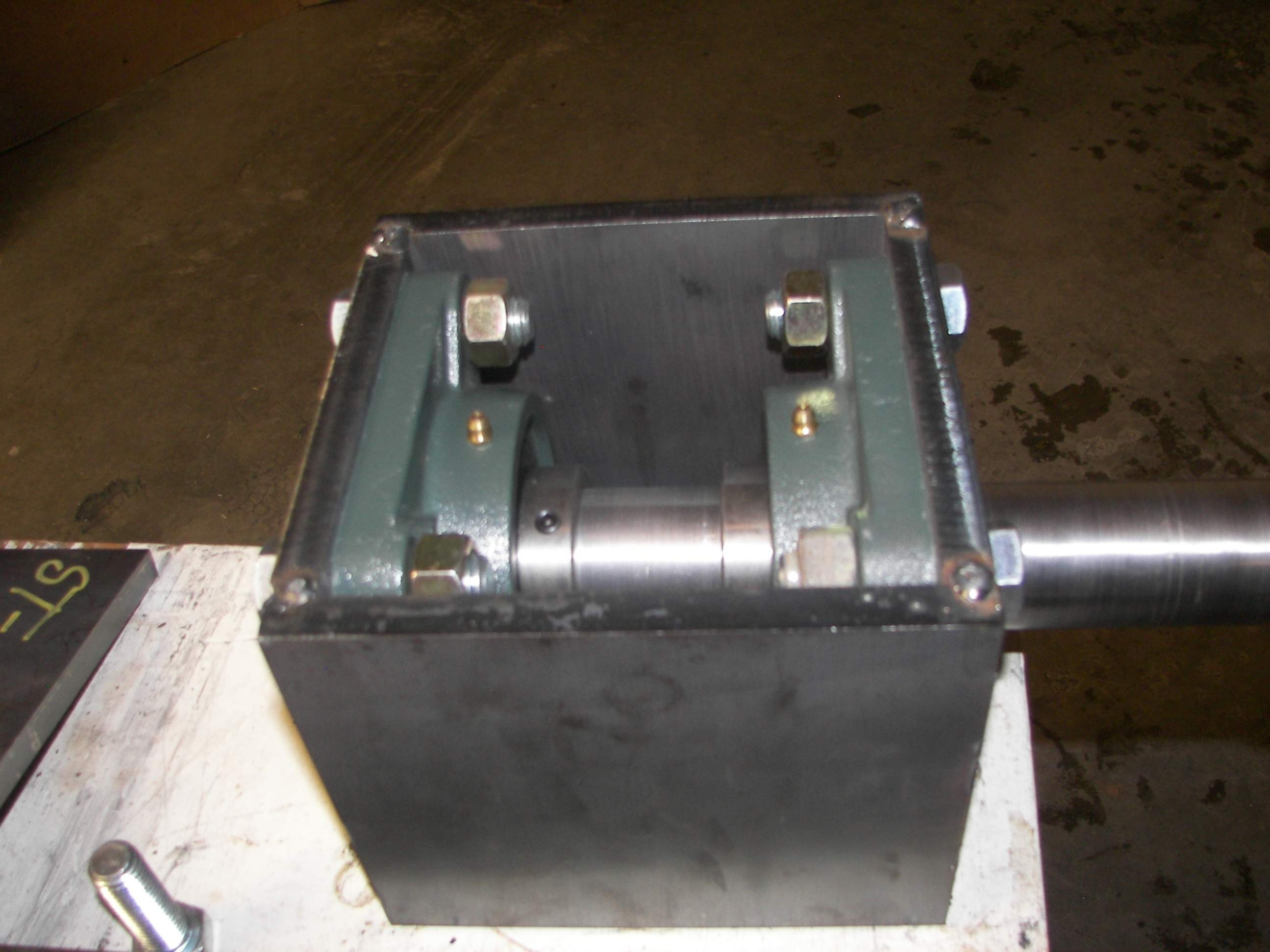

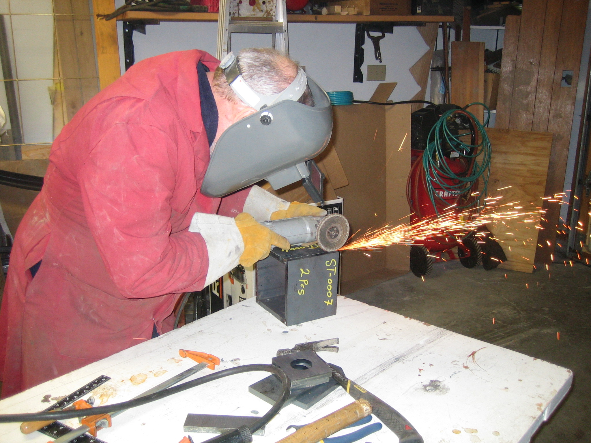

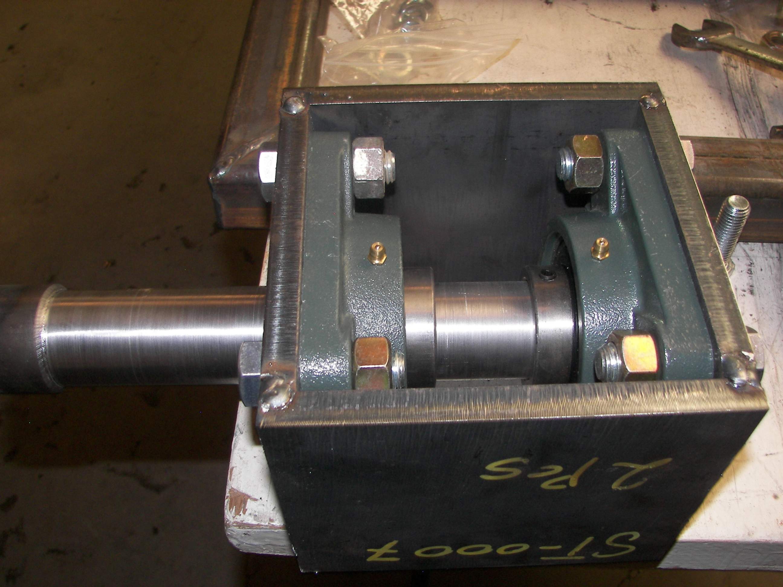

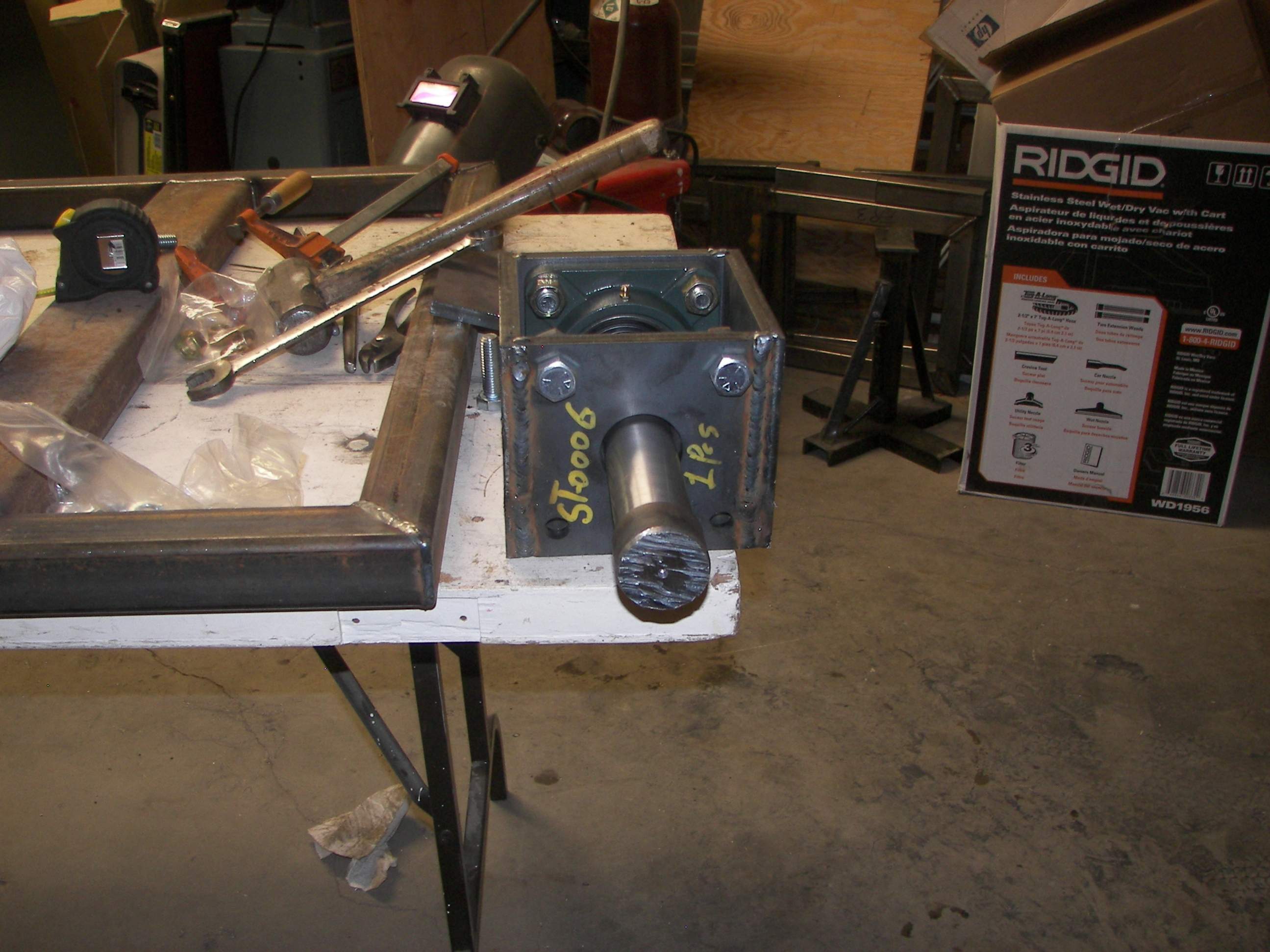

Here are some photos of the box with the bearings for the back half of the articulating joint.

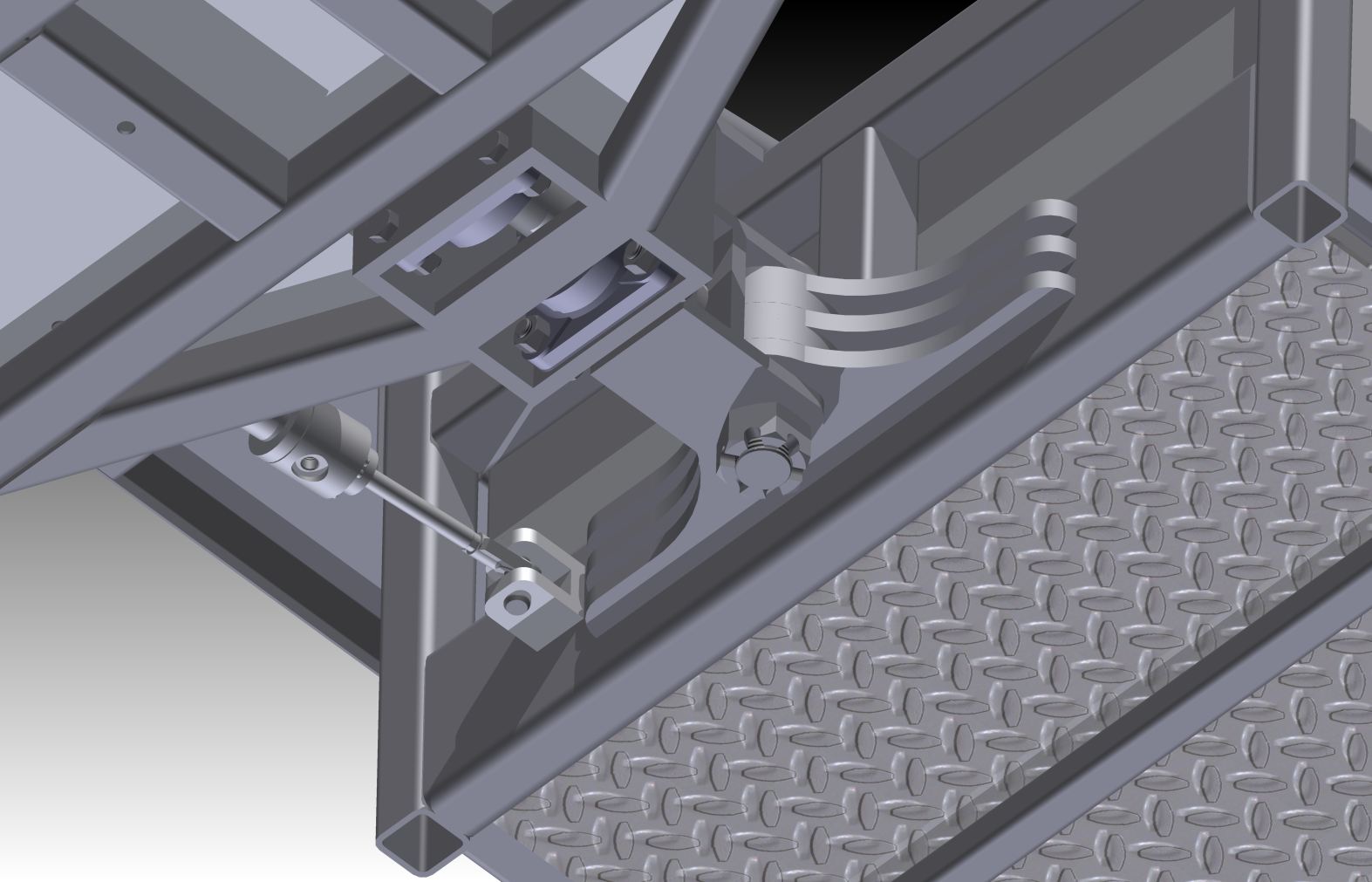

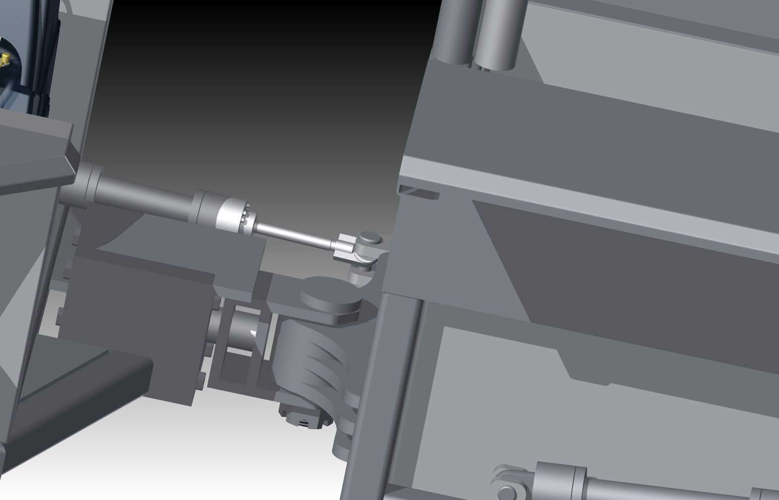

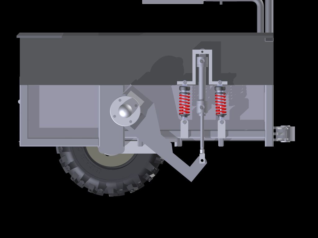

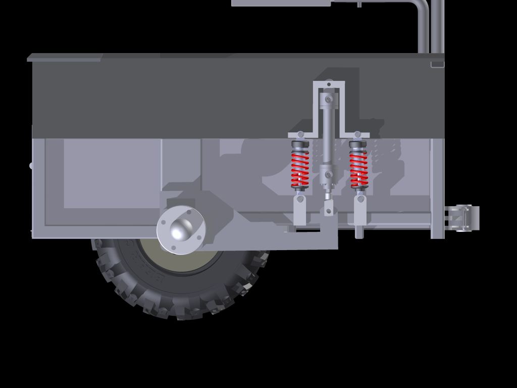

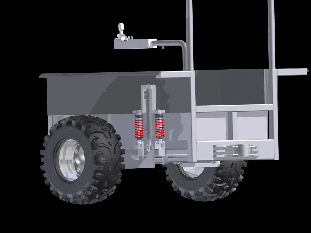

I've come up with an idea for a suspension system, for my machine's front-end. It's a little crude yet, but I'm looking for little bit of feedback before I refine it more. I've attached a few photos, and also did a video animation of how it works. Let me know what you think.
[ame=http://www.youtube.com/watch?v=4dE4wd_YVbQ&context=C3258590ADOEgsToPDskI9hNxXlogvOfO8hpl0cGcN]Hydraulic Suspension System - YouTube[/ame]
/ Custom UTV #40
Not sure what to think about that suspension. Very unusual. Can you please explain it's purpose? I'm assuming you are using it to adjust ride height?
