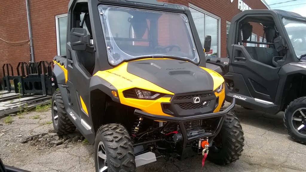

Yes I have many times. The book says top speed 80 kmh ( 50 mph) I had it up to 83 kmh and I guess the governor kicks in and it start to bog down lol. that is just for protection I guess so can't go any faster. Believe me that is fast enough on the road I ususally go about 25 mph in the straight trails. Very nice machine to own if you decide to you won't be sorry. Be sure it is a 2017 MX series like pictured below

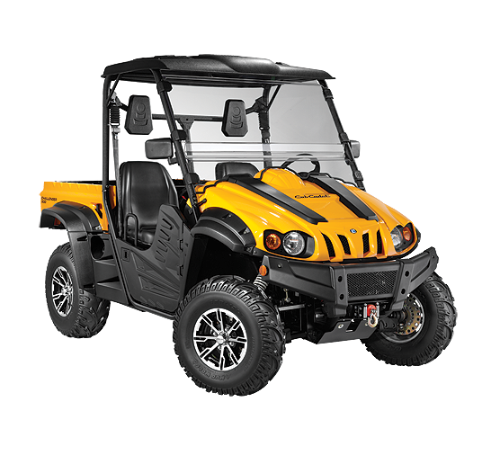

This is a pic of the older 500/700 series before the re-designed 550/750 MX. Lots of confusion over these models.

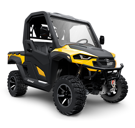

Here are 2 better pics of the difference between the older and newest side by side
