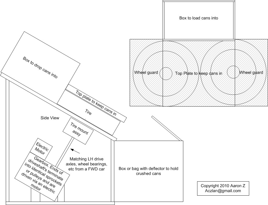

How about a can crusher made as follows:
Get the driveshafts, wheel bearing/brake and wheel assemblies from 2 identical FWD cars.
Mount the tires to be ~3/4" apart and connect each one to a sprocket or gear, connect all of this to a motor, put something solid and removable on the top and bottom of the tires (covering the crush section) for safety and to keep the cans in.
My idea of how it could look:
Aaron Z
