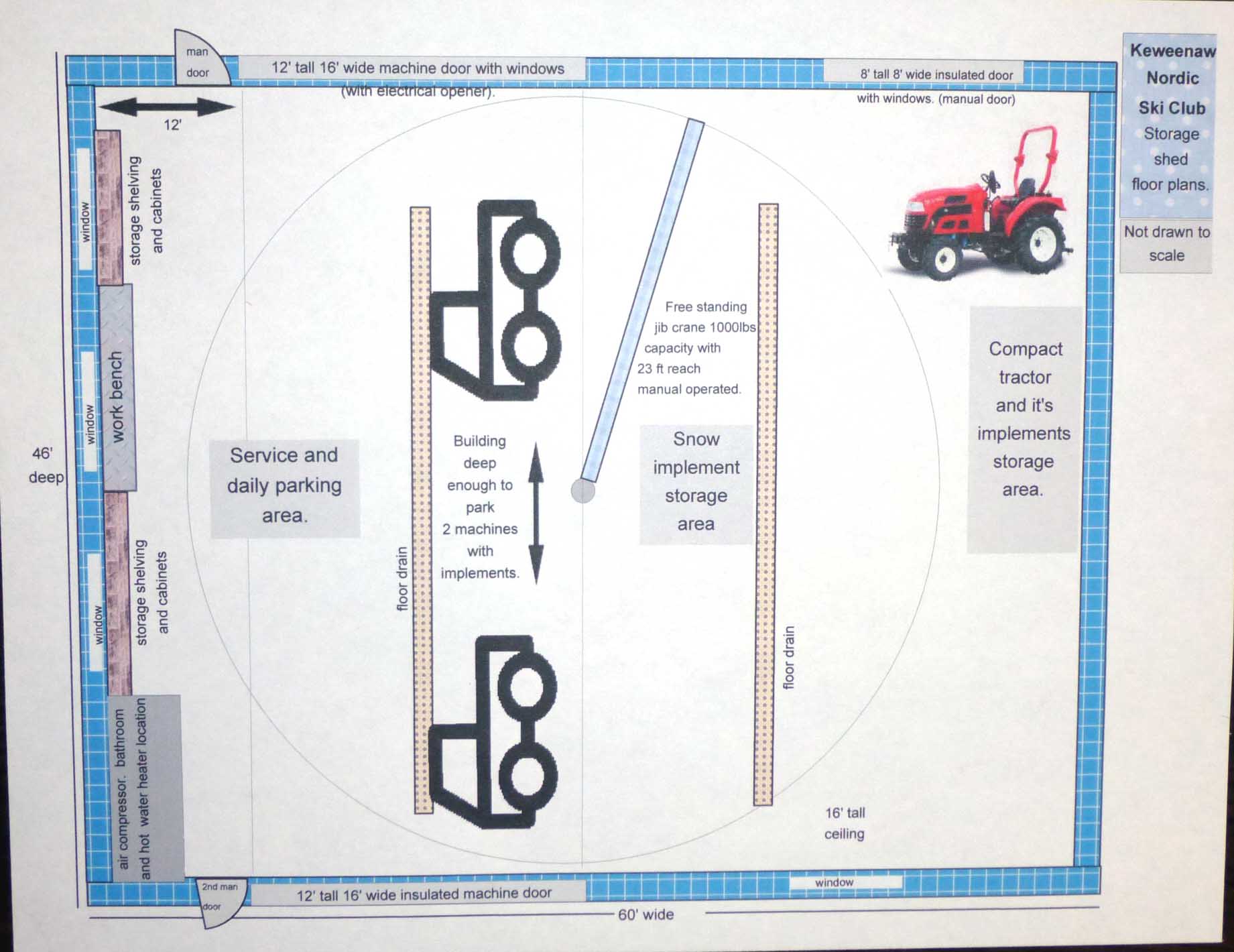

Your shop is nearly the same size as the one I've designed, although mine is for snow machine storage, and maintenance. How I came up with the design is by asking other folks who do the same job and ask them "how do you like your shed? What would you do different?" and heard all kinds of good suggestions. I'll try attaching a print of my floor plan here in a bit. My building goal is of course different than yours, but it still might be helpful.

Here is the floor plans of the shop I drew up. This simple photo misses many details. Carl, Its hard to switch from mechanical repairs to welding, in the same bay. What machines or implements, will you have in the bays?

We thought we'd have the potable water heater, close or in the same room as the bathroom. Then have the air compressor on that rooms roof which is on the wall with the work area. Keeping air and water lines as short as possible. For welder power outlets, have than on the same wall as the work area which is 45ft long.
