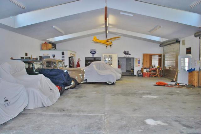

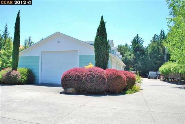

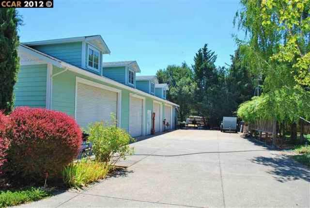

This is 40 x 96 stick framed... it had to have the dormers so it wouldn't look commercial...
Was in backup position to buy the place but after 59 days it closed... not to me ;-(
