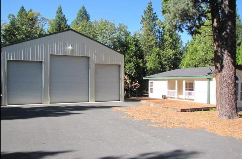

You guys are absolutely right, it is on me for not knowing true costs. What I was getting at, though, was that the price of a metal building appears to be very similar to the price of a pole barn. As noted, flexibility will be an issue, I was wondering about kitting out the interior, if it makes sense to go with wood framing (pole) as opposed to red framing.
Secondly, I am struggling with the notion of $25 a sq ft. I have asked for quotes for both a 2000 sqft building and a 3000 sq ft building and the difference was around $6 to 10 a sq ft not $25. It seems to me I should just find an extra 10K and build the 3000sq ft building and be done with it.
Also - go up with your building. With the added height (usually much cheaper than increasing square footage) you will be able to add a loft in the building later, when $$$ is available. Permitting here will allow a second floor that is 1/3 the square footage of the building. Plan it in when you pour and pour pier foundations when you dig/pour the floor and then you can come back and put in post anchors for the mezzanine when you build it - and use the perimeter posts for the rest of the supports. My same-size barn is 2' shorter than I would prefer for a 2nd floor (but it works) and I had to cut into the floor and dig/pour six new spots for the supporting posts for the mez.

So in your guys estimation, what is better, a metal building or a pole barn?
Also, I hear some people say build a pole barn because you can add windows and doors much easier. Is this true?
I like both but I have quite a bit of experience with metal on wood roofing/siding and that should be considered in the decision. Metal and wood really don't get along very well over time. They expand at different rates and this causes the screws to loosen a bit over time. I found more than 50 screws on the roof of my 36x48 barn had worked lose in about 15 years, enough to cause leaks. Metal on metal is a bit better - I have two of those, 20x24, and they seem to be less inclined to work lose.
I don't find adding doors or windows in a metal on metal building to be much of a problem, one can pretty much find "off-the-shelf" windows at the big box stores that are inexpensive and will fit the (usually odd sized) framing of the metal building without cutting anything and adding sills and headers really stiffens up the structure.
I added a man-door to one of my buildings without cutting anything, it is a 24" but heck, I didn't build it to move big stuff through, only to help me enter without having to fiddle with the 8' main door. Fit like a glove in the 27 1/2" stud bay.
