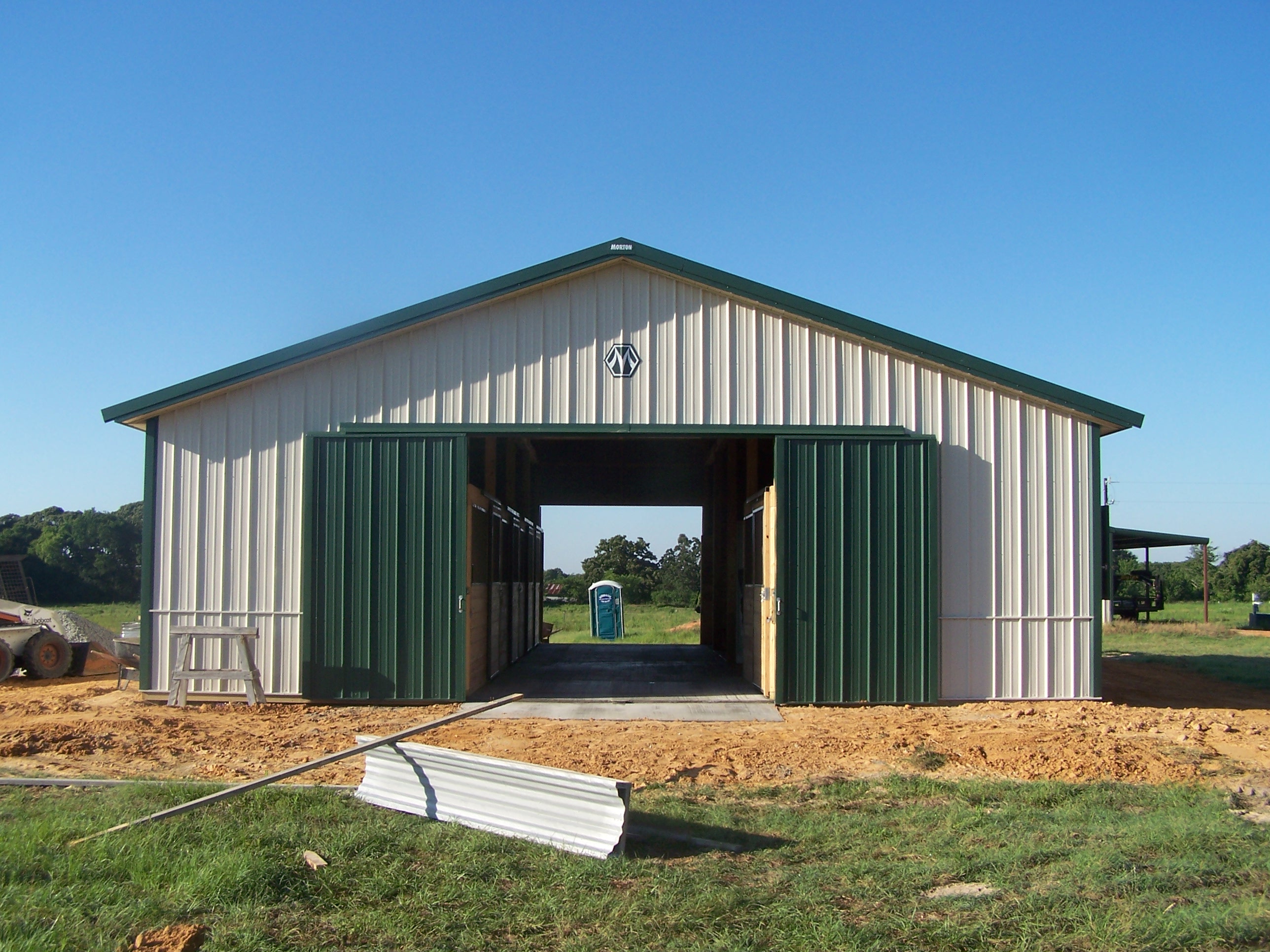

I like my Morton sign. It was a little pricey. But if you buy the sign they will through in a pretty nice building and a jacket. :laughing:
In all seriousness, Morton does built a high quality building. For us it was well worth the price.

View attachment 544516 View attachment 544515
Good looking barn! My wife would love to have something like that.

Your building looks GREAT !!
