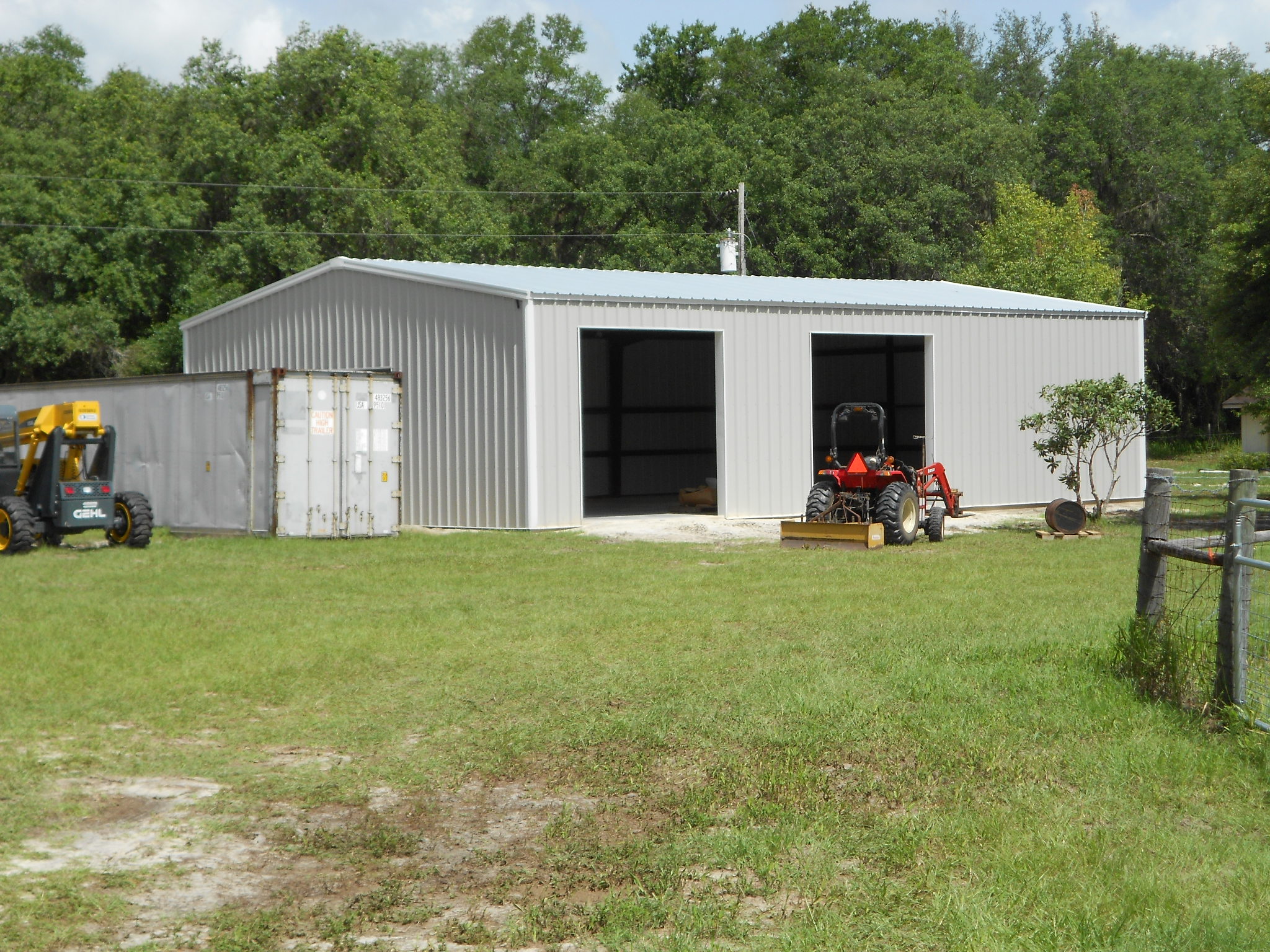

I had this 14' X 40' X 60' red iron put up in summer 2015 for under $40,000. including concrete, me hanging the doors.

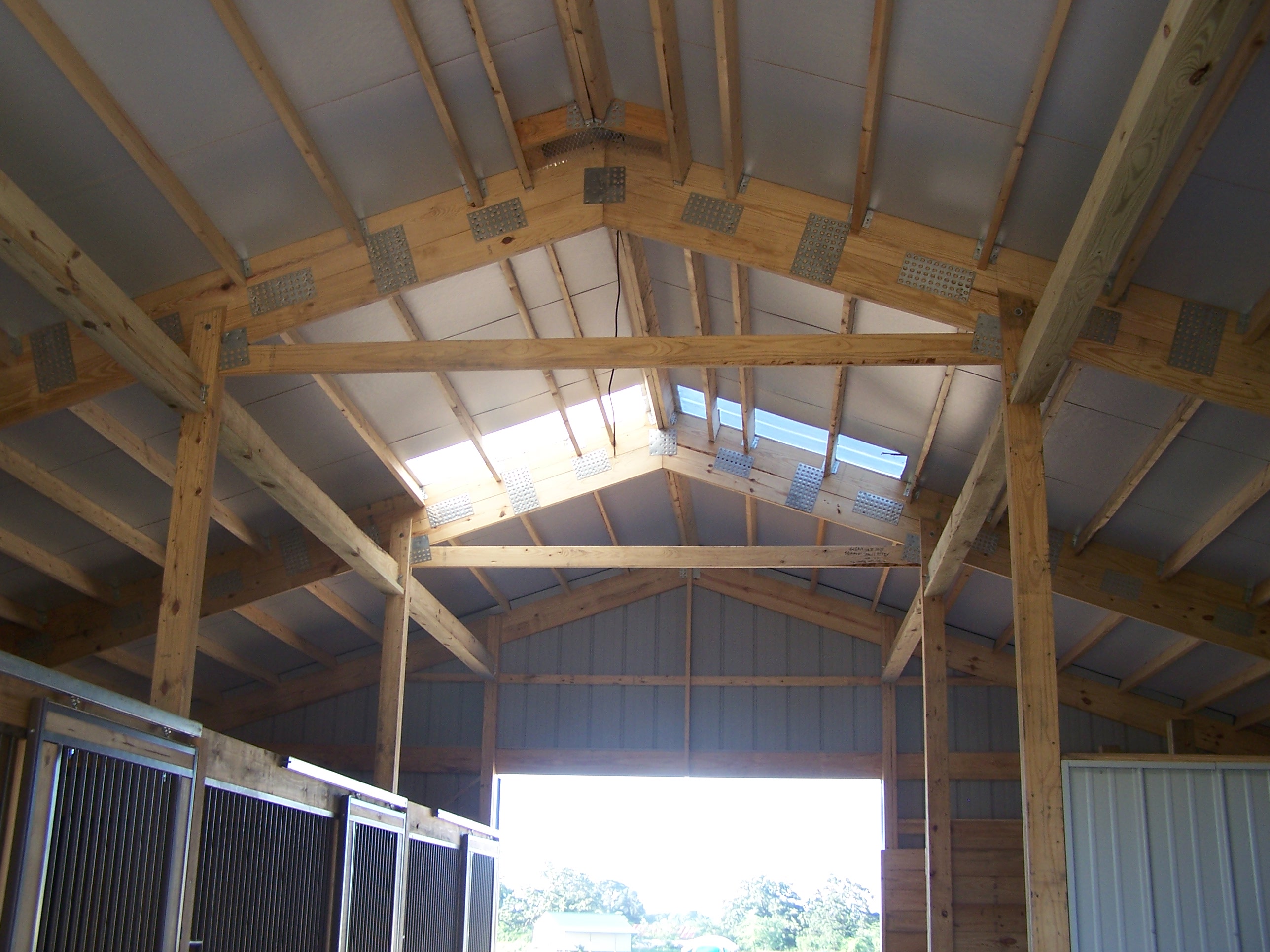

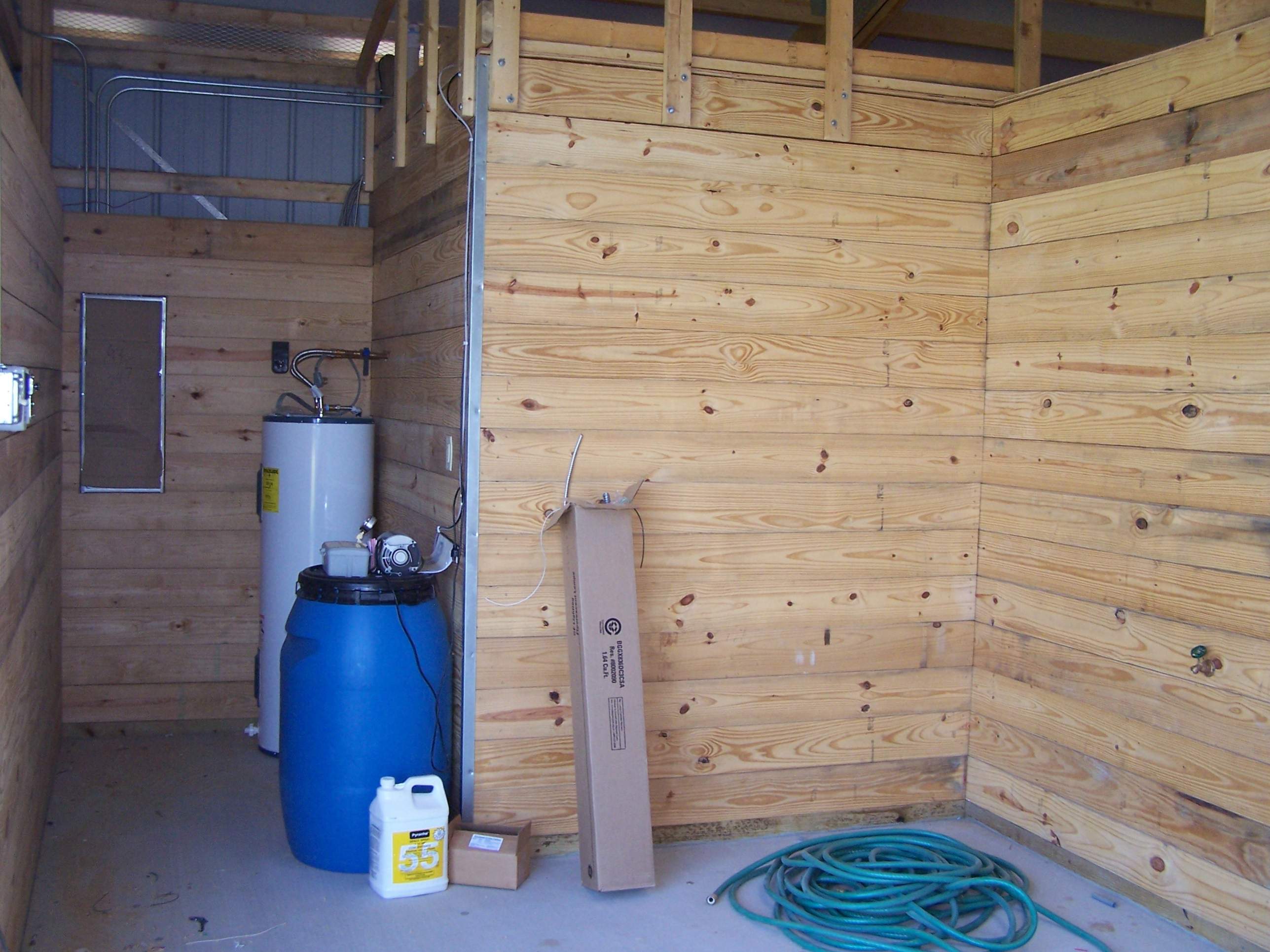

We built in 2009. Ours is a 36'X48' with 5 stalls, tack room with washer/dryer &HVAC, bathroom, and wash rack. Morton did the walls, concrete, and fly spry system. I sub-contracted out the electrical, plumbing, HVAC, septic, burglar & fire alarm system, and dirt pad with select fill. My Morton salesman recommended that as his prices would be too high. Morton's share was $75,000 which works out to about $43/sq ft. All total I have about $100,000 in it so $58/sq ft.
If I had to do it again I wouldn't hesitate a minute. Morton's people are top notch. You couldn't find a nail or screw in the grass after they left. Any left over lumber I got to keep if I wanted it. Trash was picked up every night and placed in their trash trailer. They furnished their own port-o-potty separate from the GC's potty. They worked great with my subs. I have had zero issues with the Morton part of the building. Did have some HVAC issues but my sub changed out the whole system under warranty.
