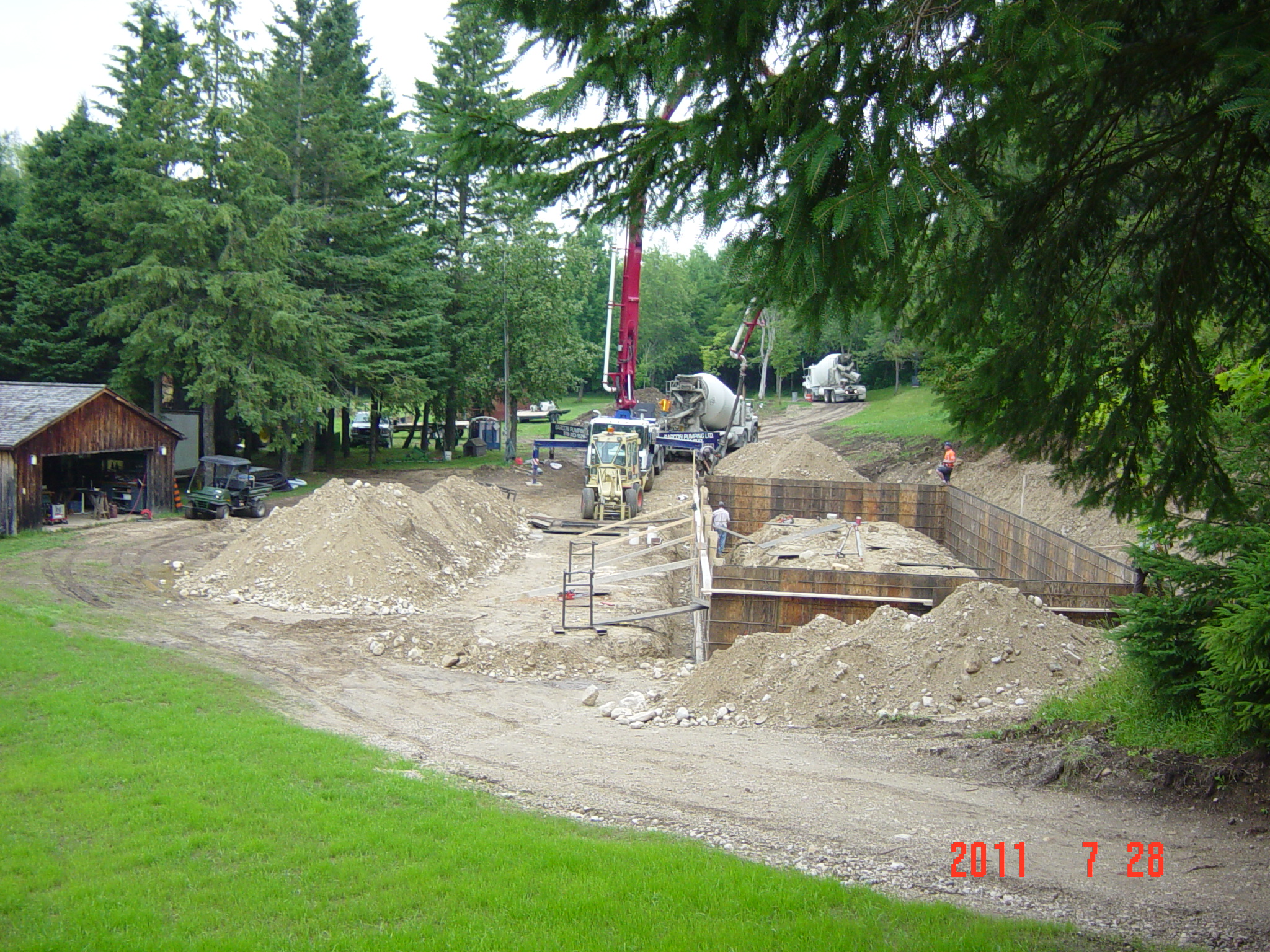

Wow. Deep water here... I originally started out with a very similar plan for my shop - 2 stories set into a hillside much like you are doing. It ended up just getting too crazy so i ended up putting a single story building in another location on the property.
Some key points:
1. The foundation wall that will be in that hillside is not just a foundation wall but a major retaining wall because you are open on the opposite end. Plus with vehicle traffic just in front of the shop, this is going to require some engineering. This is going to be true no matter what you do in this location. Plan for it
2. Consider Spancrete for the upper floor. It can span very long distances easily and they could easily set that all in a half a day. But this requires proper support to set the floor panels on. Downside is a concrete floor upstairs but that also makes it easy to add radiant tubing on top of the slab. Certainly isn't required, but something worth looking into.
3. Radiant tubing should go in any slab. It is great heat, but make sure you insulate below and at the edges of the slab. The only downside is you really can't drill into the slab safely as the risk of hitting tubing is high (darn near 100% with my luck...) unless you pre-plan areas to be free of tubing and carefully track and measure for those. Also you don't ever have to use the tubing if you don't want to, but there is no going back if you do not. Couple hundred bucks of tubing and a day is all it takes to set it up.
