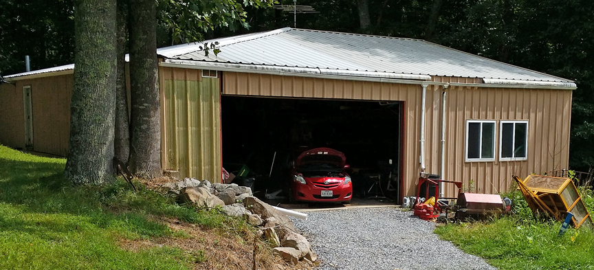

My 45X57 shed is built on an incline,,
We excavated a flat spot, then the first thing done was pour a 65 foot long retaining wall.
the wall is on the left side in this pic.
For scale, that rollup door is 18 feet wide, and 11 feet high.
My retaining wall is 8 inch concrete sitting on a footer that extends down below the frost line.
I poured the concrete floor in 1999,, so, it has been there a while,,,

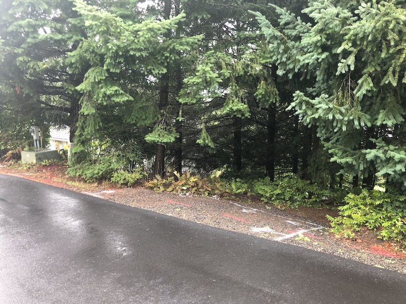

The service power is very close... less than 20ft from the shop at that corner of the property. Utility location service came out yesterday and marked. The good news is the electricity to the main house runs parallel between the existing paved driveway and the south foundation wall. There is also a spare meter box next to the transformer. I do plan to set it as separate service. See photo.

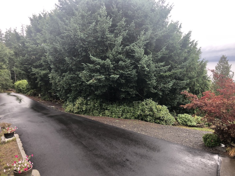

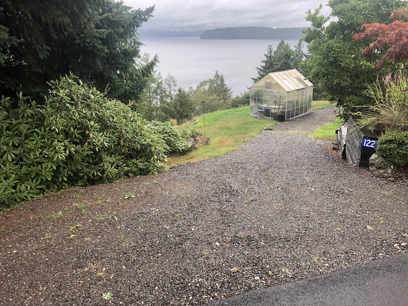

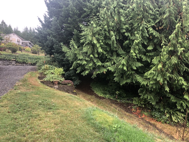

Here are a few more pics to give you an idea of what I am dealing with as far as slope and driveway access. First pic is looking west at the stand of trees, most will be cleared. Second and third pics show the access from the paved driveway. Much of the excavation will be fill to build up pad in front of lower garage door. I will likely have to access the lower garage by backing down the sloped gravel driveway and making a 'Y' maneuver to pull forward into the shop... or drive forward down gravel driveway and then back into the shop. This is because the turn radius will be too tight and slope too steep.
