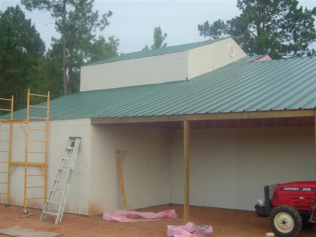

#442
The workshop end also turned out better than I'd hoped for. Originally I ordered the roll up door in tan, but after getting home and telling Steph what color it was, whith the green roof, she told me I'd made a mistake and needed to fix it. I called my sales rep at Mueller and told him that I was in trouble for ordering the door in the wrong color. He said it wasn't a problem, and changed the order. Real nice and easy. That's why I use them. /forums/images/graemlins/smile.gif
If I'd used that tan door, it would have looked terrible. Good thing she's there to correct my mistakes.
Now I need to get on building some shelves in my outdoor storage space and my workbench inside so I can get organized.

</font><font color="blue" class="small">( If I'd used that tan door, it would have looked terrible. )</font>
I agree with that! /forums/images/graemlins/tongue.gif It could have been very nearly the same color as the siding and would have been okay. If it had been brown you would probably have had to paint it to make it look right. It's much easier to get it right the first time.
I worried about my brown garage door on my house, but since all my doors are dark brown and the cedar siding is also brown, it looks just fine. In my case, I think green would have been the wrong color, but your green just fits perfectly.
Tell your mom she did a nice job on the doors and the siding. Everything is really starting to have a finished look. Your front door has a really inviting look.

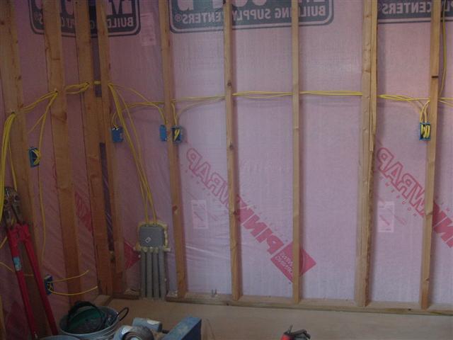

#449
It rained the other day it's too muddy out to play in the dirt, so I did a little work on the workshop.
In this corner I'm putting my metal welding table with the vice. My air compressor will go under it and my welder will sit just to the left along the side wall. This is also the roll up door wall.
I like lots of outlets. Thanks to some advice on another thread, I put in a dedicated line to the air compressor. The welder has it's own outlet and that's been in for awhile now.
On the bottom left side of the wall you'll notice a gray box with four gray pipes leading into the ground. This is where I've brought power for outside demands. Namely my entrance, my street lights and a barn I'll build at a later date. The fourth line is there just in case something comes up.
I have a cover on the outside, under my overhang, to access the wires and pull them through the conduit.

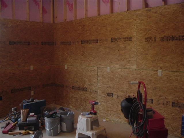

#450
I put the top of the outlet boxes at 4 ft so it would be easy to cut them out. Then I used sheetrock screws to attach the OSB. Price for 7/16's OSB was $10.79 and who knows what it will be next week. Two weeks ago it was over $14 a sheet.

#451
The second row went up real fast and easy. Then it's all about putting in the outlets and covers. I guess I could have put up the third row, but having outlets seemed more important. Sometimes I get sidetracked. /forums/images/graemlins/grin.gif

/ Creating a Workshop & Home #456
Great work Eddie, been following all your projects. BTW, how did you handle the 2nd row OSB seam that dosen't lie over a stud, or is that some kind of camera angle illusion? Keep the updates coming!
#457
Michman,
Your not supposed to notice that!!! /forums/images/graemlins/grin.gif
Just kidding. The OSB is stiff enough that I don't worry about ending it on the edge of a stud, but always have it end in a different location for strength. Each row will have a seem at a different location.
The first row ends with a piece cut to fit. I start the next row with that piece and don't worry about the edges hitting a stud. The third row will be done the same way.
When I put my shelves up, there will be several ledger boards going across the wall that will also stiffin things up and flatten out the slightly uneven edge on the ends.

/ Creating a Workshop & Home #458
Eddie,
You can also take a scrap piece of 1 or 2 x 4 and slide it down behind the osb and screw the two boards to it. That way they are locked together. I've seen and used this technique for drywall too as it keeps the number of seams to a minimum.
/ Creating a Workshop & Home #459
toe nail a 2x4 between the studs and screw the board to that. if you put it flat side so that the 4" side is facing you, you have more area to hit when you want to hand something.
We do this all the time in offices we build. When we need backing for mounting some heavy equipment we have the contractors put blocking in the walls. Usually 2x10 put in flat side out so that we have some leaway

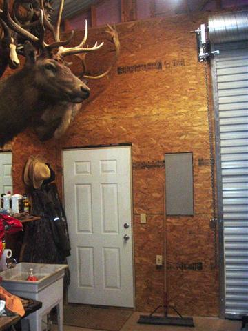

#460
THanks for for taking the time to share your advice on the seams, but when the shelves are built, I think you'll see that it will take care of the seams.
I've got an idea on how to build the shelves that I've never done before, or actually seen before. Simple, open, and with minimal materials.
First I had to finish off the corners. This one is of the back door and main power box. Earlier threads it was mentioned that I need conduit to protect the wires that were exposed. Hopefully this looks a little safer.
