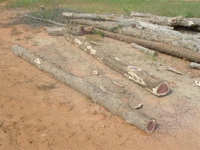

#413
I've been saving my cedar trees for just such a project. I found two that were nice and straight and cut them to 14 feet, then cleaned them up some.
Eddie

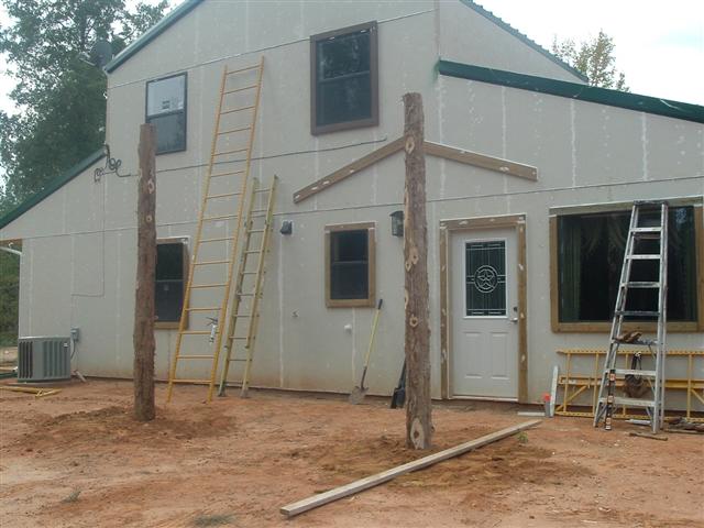

/ Creating a Workshop & Home
#414
They just barely fit in the holes, but that was planned. I wanted these posts to be as thick as I could get to make a statement.
Getting them plumb was kind of tricky. I tried a level, than a second level and finally just eye balled it. I figures the taper of the log would be an issue, but the surface is so uneven that I couldn't even get a good guess with the levels.
Eddie
#415
Trying to figure out the exact length the logs needed to be is math way beyond my capabilities.
I found a straight 12 foot 2x4 in my wood pile that I attached to my ledger board. Then I leveled it out and attached it to the post.
At this point I realized I needed to cut the post to the height of the bottom of the ledger board, so I screwed on a scrap piece of 2X6 flush with the top of the 2x4. Now the bottom of the 2x6 is where I need to cut the post.
It's kind of a round about method, but it worked. /forums/images/graemlins/tongue.gif
Eddie

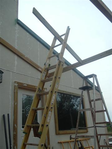

#416
The next issue was building and installing a truss in the middle of my roof. Nine feet is too far to span with 2x4's on edge.
I almost always work alone, which means I'm always using one tool for multiple purposes. To hold my rafter up while attaching it, I used my extension ladder with a shovel wedged in between the stephs to form an unstable tripod.
Eddie

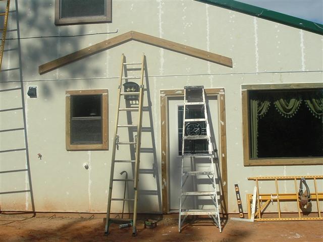

#417
Then it's a simple matter of putting up the other side and screwing it together.
Eddie
