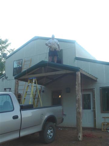

#421
I finished off the framing of the roof. One of my bigger mental challenges was determining the length of the end beams that form an exposed truss from PT 4x6's. The metal roof trim has about a 6 inch overlap. I wanted to be able to see the wood without the metal covering it up, so I put the purlins on top of it. This gave me a 3 1/2 inch spacer above the truss to absorb some of the overhang from the trim.
Once I figured out these numbers, it was smooth sailing.
Eddie

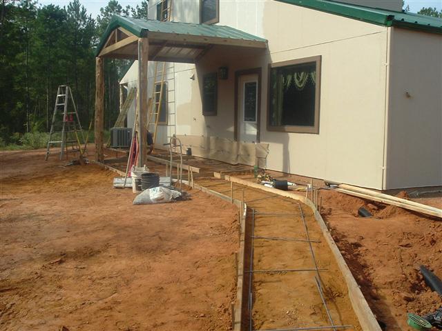

/ Creating a Workshop & Home
#423

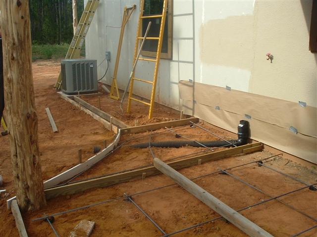

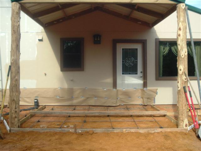

As I was setting my forms I realized that I wasn't really happy with the way it was looking. The basice porch was simple enough, but I wanted to put a pad on the side for my BBQ and a walkway on the other side.
Here's the forms for the porch with rebar and paper on the wall to cut down on some of the splatter.
Eddie

I realized I had a problem when I had my forms set and started thinking about mowing. Getting a ride along mower into an inside corner just seemed like more work than I want to do. Anything I can do to make like easier is a good thing.
This bend will allow me to get the mower all along the edge. I also put a 4 inch drain pipe in for my downspout from that side of the porch.
Eddie

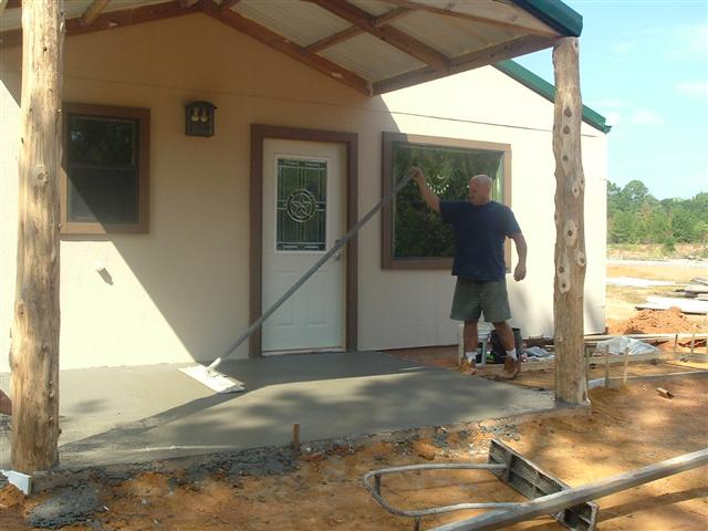

#428
Spreading concrete isn't one of those things I enjoy, nor am I very good at it. But I'm cheap, and doing it myself is still the chaepest way I know. /forums/images/graemlins/grin.gif
Eddie
#429
It's all poured, smoothed and finished with a broom. I like a broom finish for safety reasons, but it also covers up my poor troweling skills.

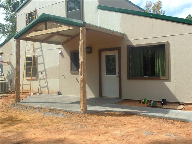

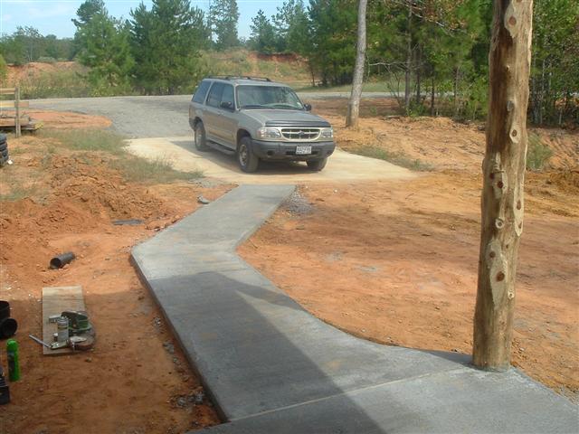

#432
The walkway came out really nice. The slope isn't very steep, and the angle is nice and mild.
Grass will be planted on the right, shrubs on the left.
Eddie

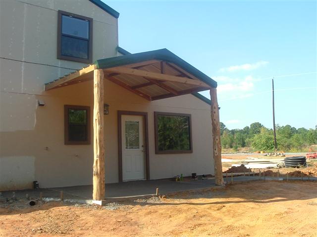

#433
Here's the basic porch. Paint is still in progress, but you can get a pretty good idea of what it looks like so far.
I'm really happy with the way the cedar posts tie in with the exposed truss in the end and how the green metal roof all tie in together.
Eddie

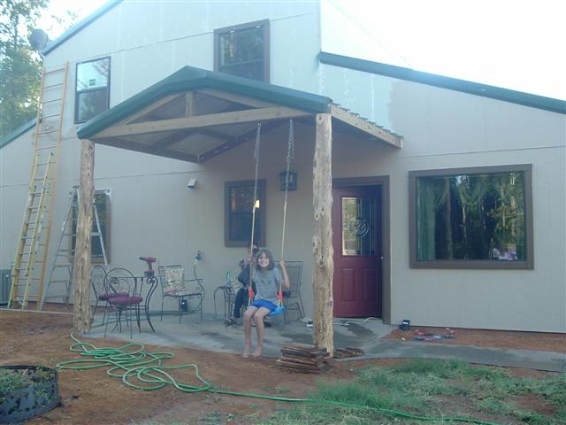

#435
"Western Lodge" is exactly what I'm hopeing to achieve with the look of my buildings. Thank you for noticing it. I keep thinking, would this fit in if it was in Yellowstone?
I had all sorts of plans to do all sorts of things on Sunday, but ended up smoothing dirt, then placed my fire ring, which started the kids on wanting a fire. Then roasting weenies. /forums/images/graemlins/smile.gif
So we all took some time to enjoy the porch and what we've accomplished. To say it was nice to do nothing is an understatement!
Eddie
