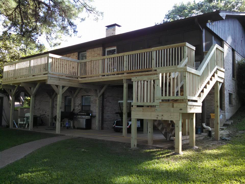

No deck or hot tub in this location. I have been thinking that I might want to build a nice dock out on the water one of these days, but's its so far down on my to do list that it's not even on the radar. Here is a deck that I just built for a client out at Lake Palestine, a 26,000 acre lake close to Tyler.

Deck looks great Eddie. My son in NC has a high deck and wants me to put in steps one day. I may copy your look. How wide are these steps?

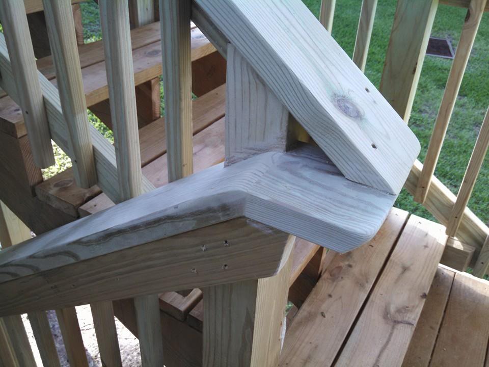

The steps are 36 inches wide. I like that because there isn't any waste with 12 foot boards and I have plenty of strength with three stringers. It is a personal peeve of mine to see only two stringers on a set of stairs. That third one in the middle takes away all the bounce and they last a lot longer!!!
On this job, the clients wanted to have as much of a view of the lake as possible and for the stairs to be out of the way. Getting them to double back and have enough head room under the deck proved to be my biggest challenge.
