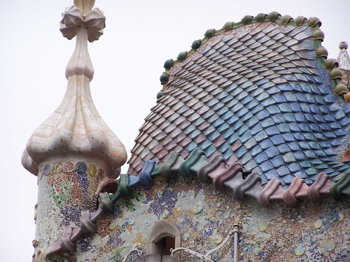

One possibility is to use stainless steel and apply your own finish - perhaps like these two examples. The designs are only limited by your imagination. Air tools and sand paper.
Have your metal shop cut your metal into the size you want. Then purchase an English wheel and roll the metal strips to fit the double curve of your roof.
English wheel - Wikipedia, the free encyclopedia
If you are using light gauge metal, I think it's a doable project for an English wheel newbie. Might suggest you buy a bit extra to practice on. Oh and you will end up with some very toned forearms when done!
I only suggest stainless - since copper is out. Stainless can also be heat treated to produce different color tones (I think).
Hope this helps.

Love the steamed shingle idea. I've never done it and might give it a try. The dragon tiles look like they are from Barcelona. We loved all the Gaudi buildings there and would love to do something like that. I like the idea of metal, but copper is the only metal that I like the natural look of, which is what Karen doesn't like.
What will probably happen is I will start using cedar shingles and modify them to fit. I doubt I will get to it this weekend, so the following weekend should be when I commit to something.

How about thin gauge stainless steel and then powder coated? The shapes would be unlimited and the finish would last a long time.
You could almost cut them to look like shakes but they would be easy to form. With powder coating, the colors are unlimited. Even a multi-color might look good.

Hi Eddie, why don't you try copper, it will age and has a very natural patina after a few years!

Rubber-based faux roofing slate might be flexible enough to use. Ceramic or porcelain tile is a possibility but would be heavy, and you would need scaffolding to hold the wet saw next to the dome. :laughing: Some of those mosaic tiles that come in sheets (like used in showers) are very flexible.
I saw lots of onion domes in places like Bavaria and they looked like slate. The Germans have composition look-like slate roof materials that I think are somewhat flexible. You might look in that direction. Real slate roofs in new construction there are rare, but people still like the more traditional look of composite slate.

I've been watching a lot of you tube video's on steaming shingles and reading everything I can online. It seems pretty doable and something that I'm going to try. I'll never know until I start if it will work or not. LOL

Yes I agree the shiny new copper would look a little odd. You can get an aging solution that you rub on it. I'll be interested in seeing the steamed cedar for a natural look. I love working with ceder Should be in keeping with the environment there.
