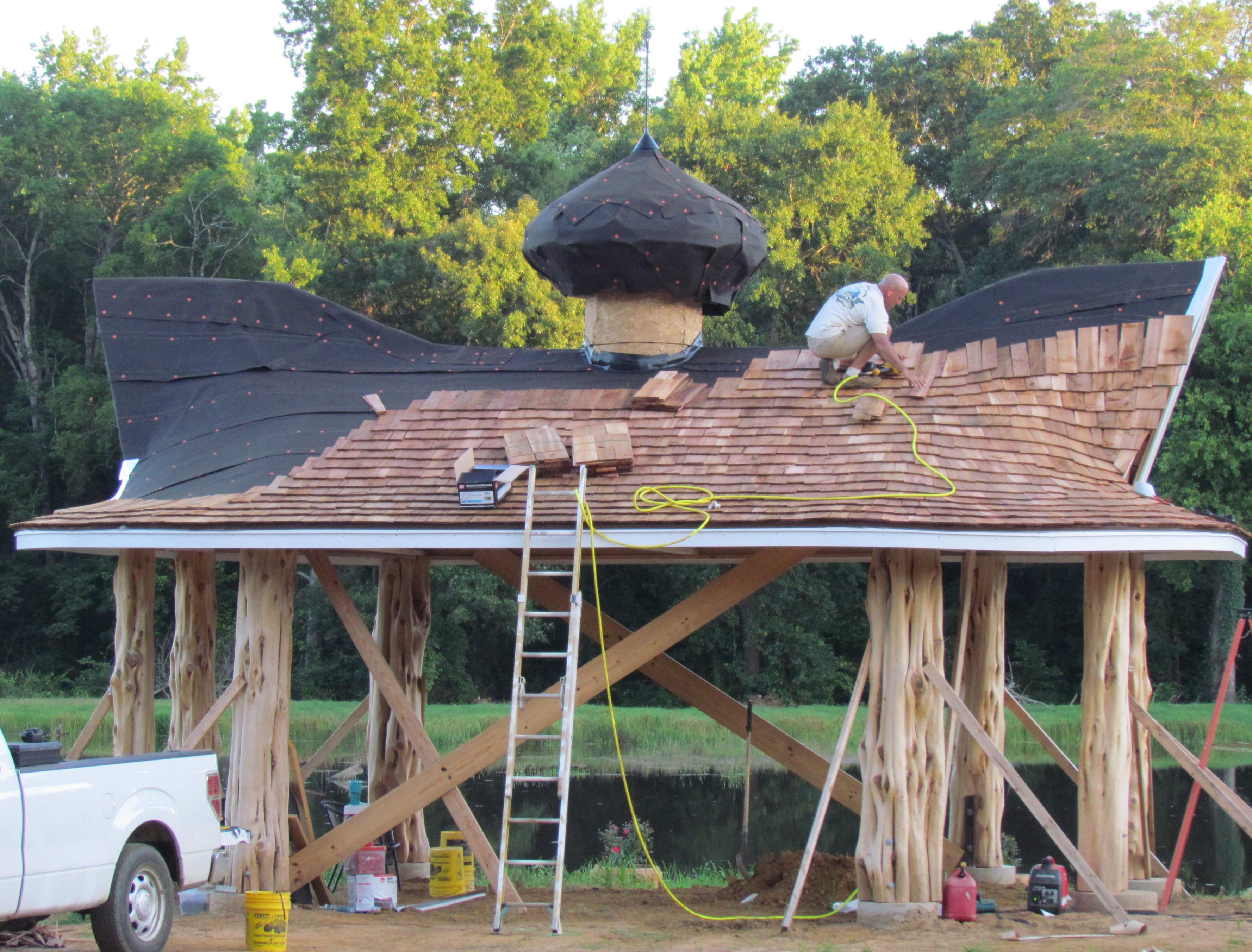

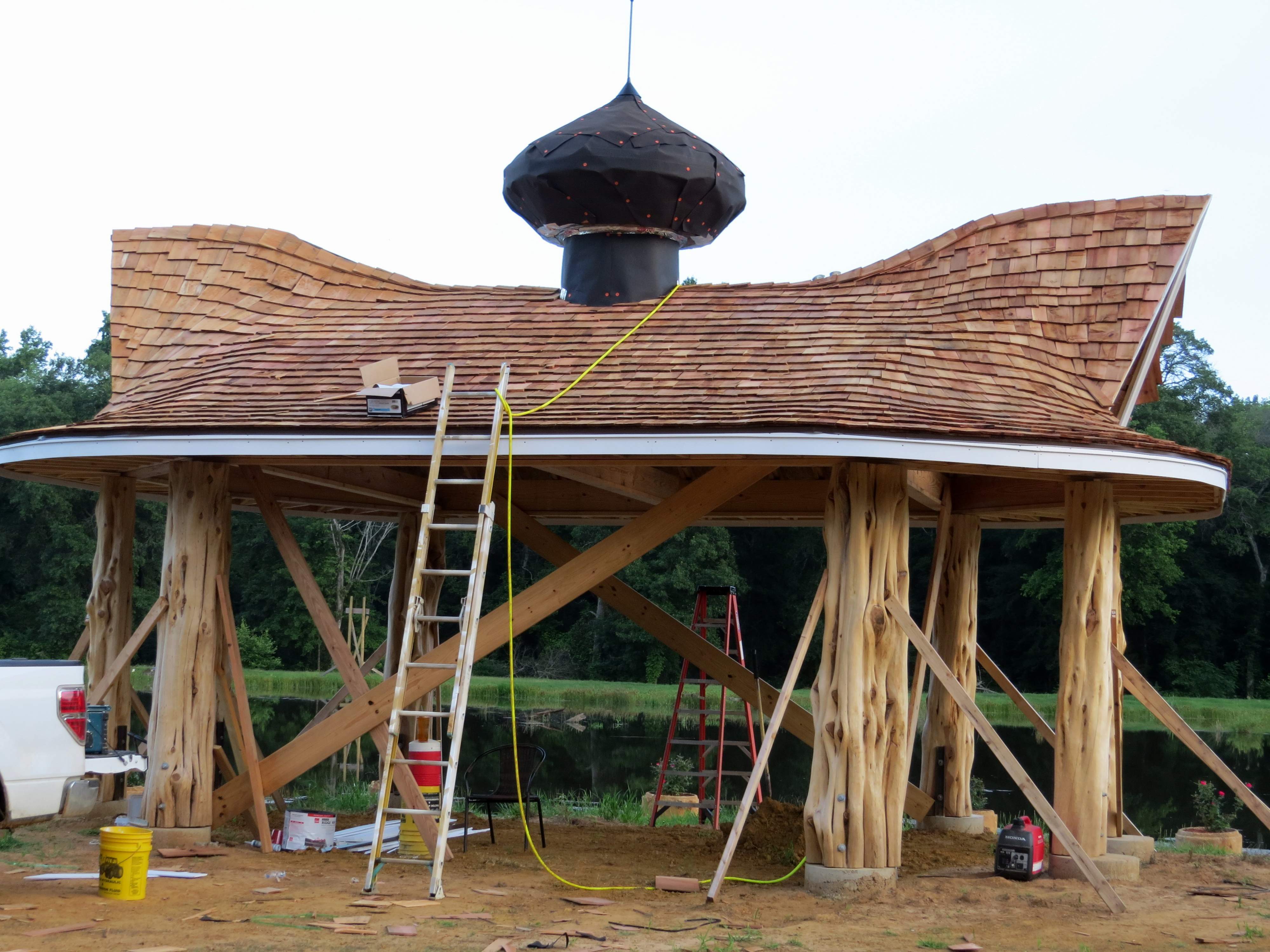

It's been a very long weekend of cutting, fitting and installing shingles. I'm well over half done with the roof, but haven't figured out how to do the cupola yet. There might be some very small shingles on it. :)

Man that's a roofing nightmare! Where's an Englishman when you need him?
I would have gotten frustrated and blue tarped it. :D

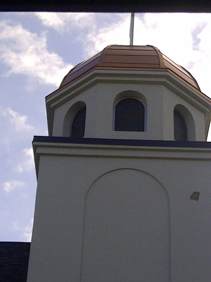

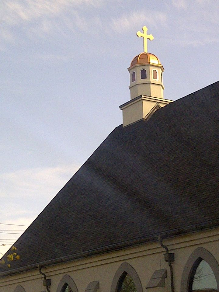

You may already have figured out your plan for the cupola, but I happend to drive past a church that was replacing the roof and they had two domes that were being re-done with copper colour tin. I got a close look but didn't have my phone, and the next day when I had my phone to take a picture they had already been hoisted to the roof. In other word I got a close look, but not a close-up picture. For what its worth, this is the way they did it. Maybe it will give you some ideas that you can use to your benefit.
They cut the tin into quadralaterrals, with bottom wider then the top, and then laid them from the bottom up so that they would get overlap just like a cedar shake and water would runoff. When they are curved around the cupola, the sides end up forming a straight line from top to bottom, leaving a series of vertical seams. In order to cover those seams, they cut long strips of tin and made relief cuts all along both sides. When the "tabs" were folded in, the strip could then be curved to the shape of the cupola and they would cover the vertical seams. The pics below may do a better job of describing than my words can.
You mentioned in an earlier post that your wife to be was ok with copper colour but did not like the patina green. I can't remember if you discussed copper colour tin though. Either way though, maybe you can glean something useful from the way this was done.

I'm not opposed to something other then shingles for the cupola and agree that metal might look better then the shingles. I just haven't found anything that I like or will work on the shape of it. Most of the metal shingles I've seen are in 3 foot lengths. What I need is something that's 3 to 6 inches wide and about a foot long or less.
I've thought about cutting my own and painting them, but if I'm going to do that, I go back to thinking that the cedar shingles will look better and last longer then anything I paint. Paint scares me because I know it's going to need to be repainted and I really don't want to be dealing with that.
