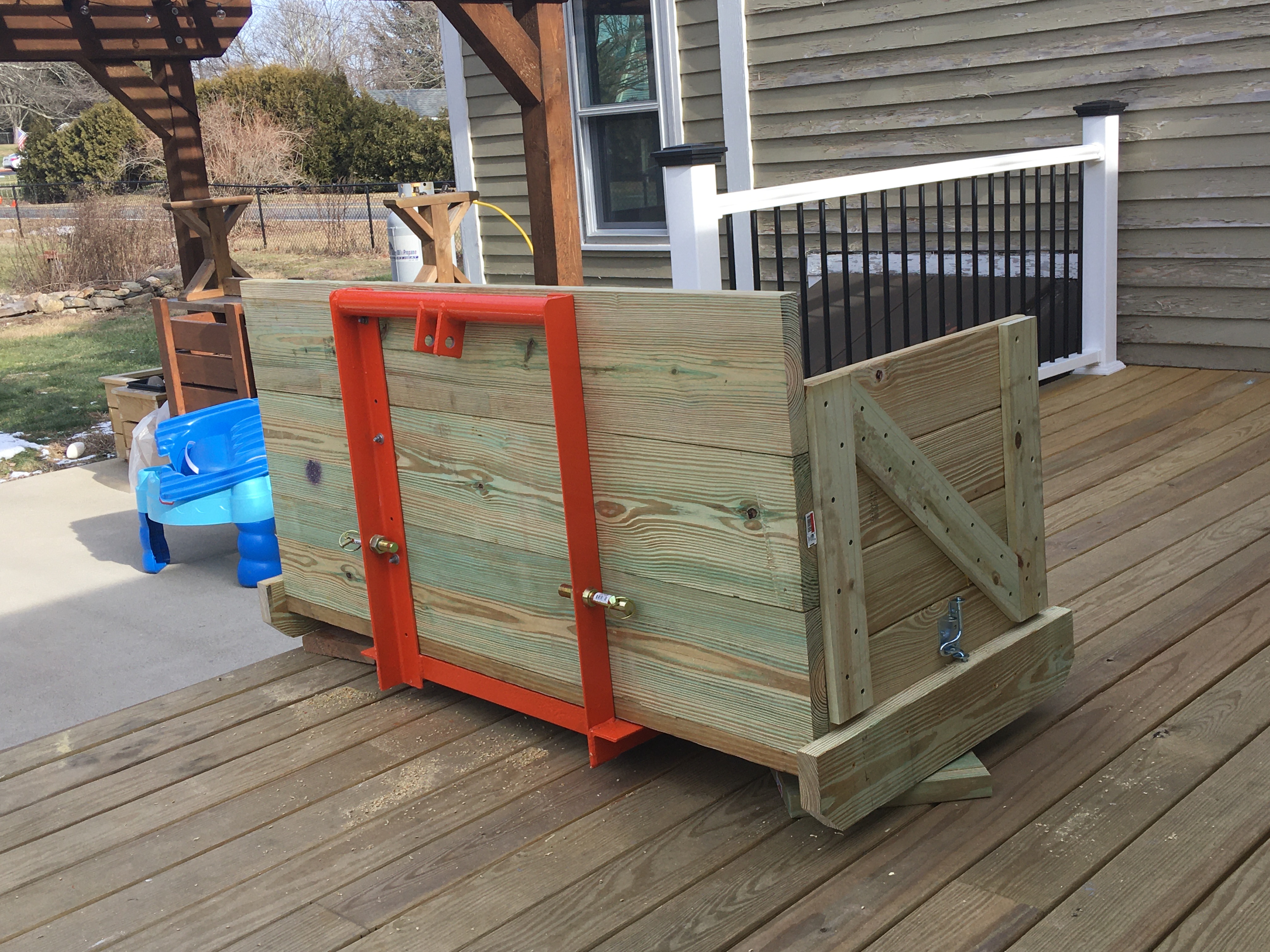

Nice job. Looks like a fun project! With an underslung plow build underway and waiting on hydraulic parts, I decided to build a carryall for a little bit of counter weight and to carry my snowblower for a few sidewalk jobs in the neighborhood. Just used some steel ninjas laying around and most of the lumber came from a Home Depot scrap bin for pennies on the dollar.
Great looking carryall!! I have never built one, because I use a 4X8 trailer,, for me, it is more convenient if I need to leave it loaded,,
I never take the trailer anywhere that turning around is an issue,, touring the neighborhood would not work,, pulling a trailer,,, :laughing:
