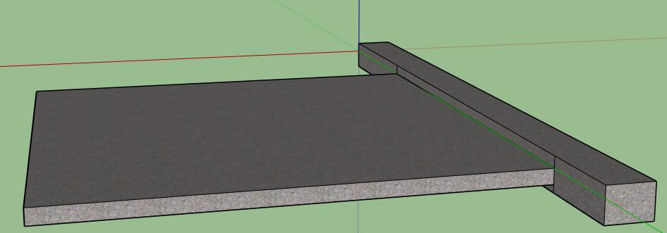

There is currently a 10'x10' slab in the location I want the 12'x14' slab. It is right off the back door, and is about a 3" step down from the threshold. This 10x10' slab was poured at the same time as the house slab, and I do not see an expansion joint present. Therefore, I believe that it is all monolithic. I measured the slope of this slab using a laser, and the pad actually slopes in 2 directions. The slope away from the house is ~1/5" per 12", and the slope towards the side of the house is 1/5" per 12". So, the difference between the highest corner and lowest corner is about 4".

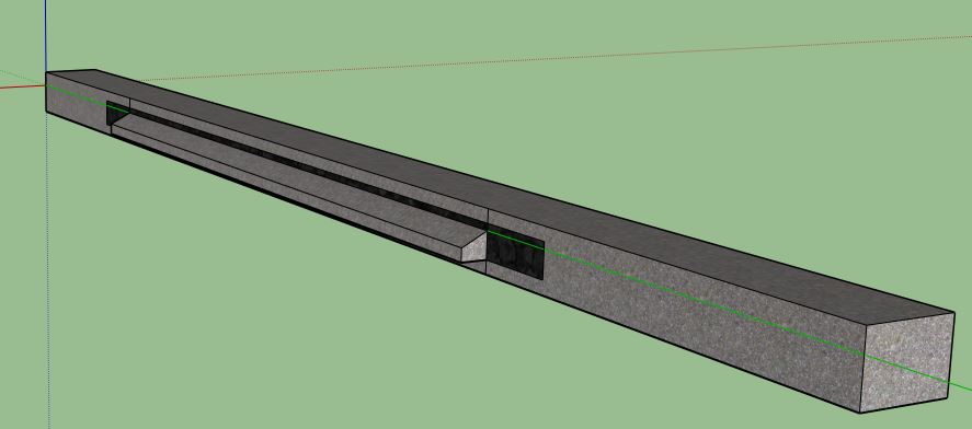

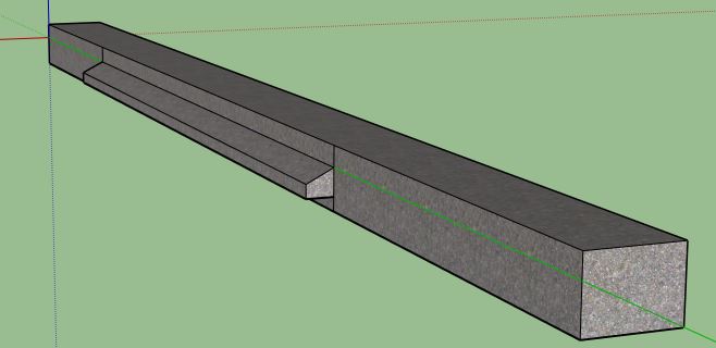

My gut tells me to rent a saw, cut the slab as close to the house as possible, demo the 10x10' slab, then grind what is left attached to the house slab as much as possible using my angle grinder. Then I could drill the house slab, insert rebar, and tie that into my new slab's rebar work. I do not know if there is currently mesh/rebar present. Depending on how that works out, I may have to raise the new slab about 1" or so, making a 2" step between the house slab and porch slab. The 1" raise would give me a little thickness over the "stub" of slab that is likely to exist still attached to the house. It is hard to picture how well this idea will work, as I do not know how closely I can easily run a concrete saw to the house. I am guessing the stub I will have left over would be 3-6" wide.
Here are some drawings:
Current Slab and thickened edge of house slab (This is not showing the slope):
Current Slab, cut as close to the house as possible and ground to an angle:
Same image as above, showing the outline of the new slab in black. This shows how for a small section near the door, the slab would be thin, 1" or so tapering outwards:
There is of course a chance that I can using a concrete cutting wheel on an angle grinder and cut more of the slab stub away, but it is hard to know until I start demo. I really wish they had used some sort of joint here, as that would make this a lot easier...but no such luck.

Can you add rebar into existing slab and then pour a topping slab when you extend the slab
   / Covered Slab Slope #19
So you are adding 24" to each of the 3 open sides??
Why not just dig a footer all the way around and pour right over top of the existing slab to bring it up level with the house??

1' on each side, and 4' longer. The 12' dimension is against the house, and the slab will go out 14'. I would go even bigger, but am restricted by septic/plumbing/corner of house.
That sure would save a lot of demo...
How much of a step should I keep between the house slab and the patio slab? I just measured...I have 3.5" between the top of the slab and the bottom of the door threshold.
So, if I poured a slab over/around the existing, and up to a height of 1.5" below the threshold...I think that could work. The slab would be 2" thick at its thinnest point. I could drill the current pad as well as the house pad and pin everything together and integrate it with my rebar...
Are there any special steps I would take when pouring new concrete over old? I plan on doing all of the excavation and form work myself, then hiring the pour done.
