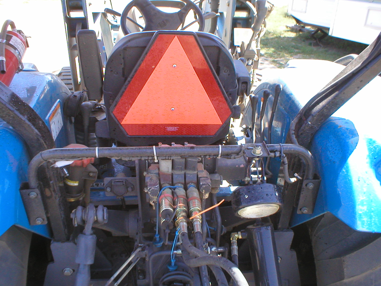

Here is a pic of mine, no collars either. The fittings are fastened directly to the valves, there is no bracket what so ever. You need to zoom in to get a better look.

/ Coupler styles--why are there 2? #17
Are you saying that to unplug, you pull the male coupling out. What keeps it locked in place? Is there a sleeve under the rubber part, or a release mechanism? What brand are they?
Do you have to push in first and then pull?
/ Coupler styles--why are there 2? #18
Mine are what come OEM for Mahindra QDs. I have to push first and then pull to disconnect mine. However mine work, it is all internal.
