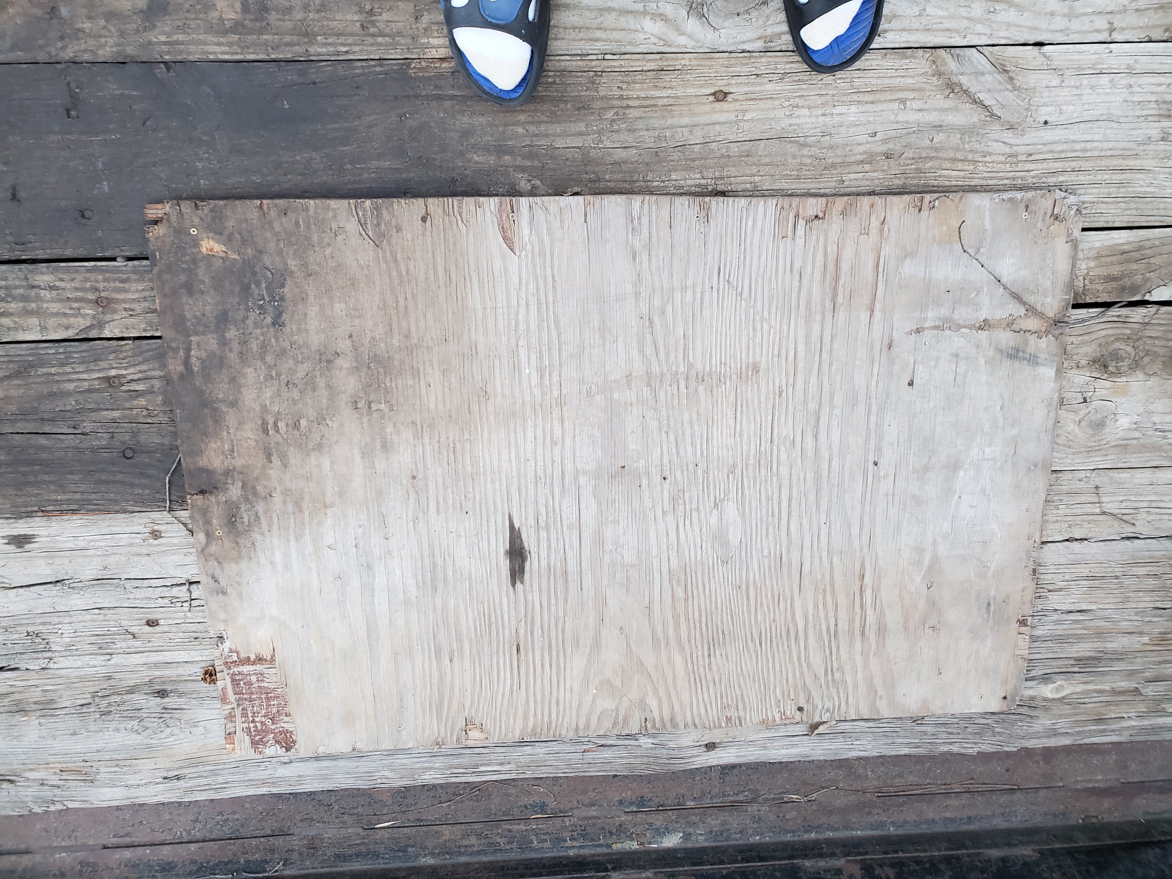

Recently bought this older T10D-16' Towmaster that's in need of some deck work.... Existing deck is 2" white oak.... Where's the best place to buy replacement boards? If I was to buy them from a local saw mill, would they need to be treated?

If you want the same material as on there now,ask for #2 yellow pine;) and it will benefit immensely if pressure treated.

+1 That looks like good old spruce/pine/fir lumber.

That looks like oak to me. You could source oak from a mill or just go with PT SYP. No idea on the quality of tow master

I disagree!
That original decking is NOT OAK!

There’s a piece of plywood patching the deck. I’m pretty sure the rest of the deck is pine.

There is pine, oak and plywood on the deck in the picture. I would go back with ground contact pressure treated pine.

Looking again. ****. There is no oak there at all. I must have not had glasses on

There's always that chance the deck has been replaced because the trailer is a 97'... AFAIK that's the original deck.... Newer specs from Towmaster show the deck of the T-10D as 2" nom. White Oak.... It's no deal breaker but I wanted to go back with whatever the factory had used...
