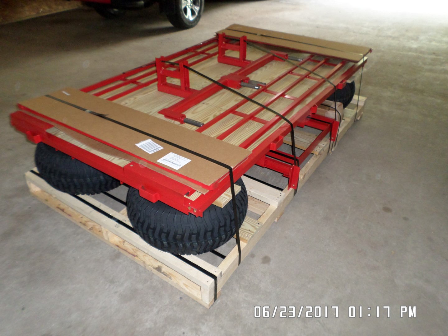

Here is what the 4' by 7' look like before they are born.... fresh off the semi.... Going to paint it black when I am done welding on it. :)

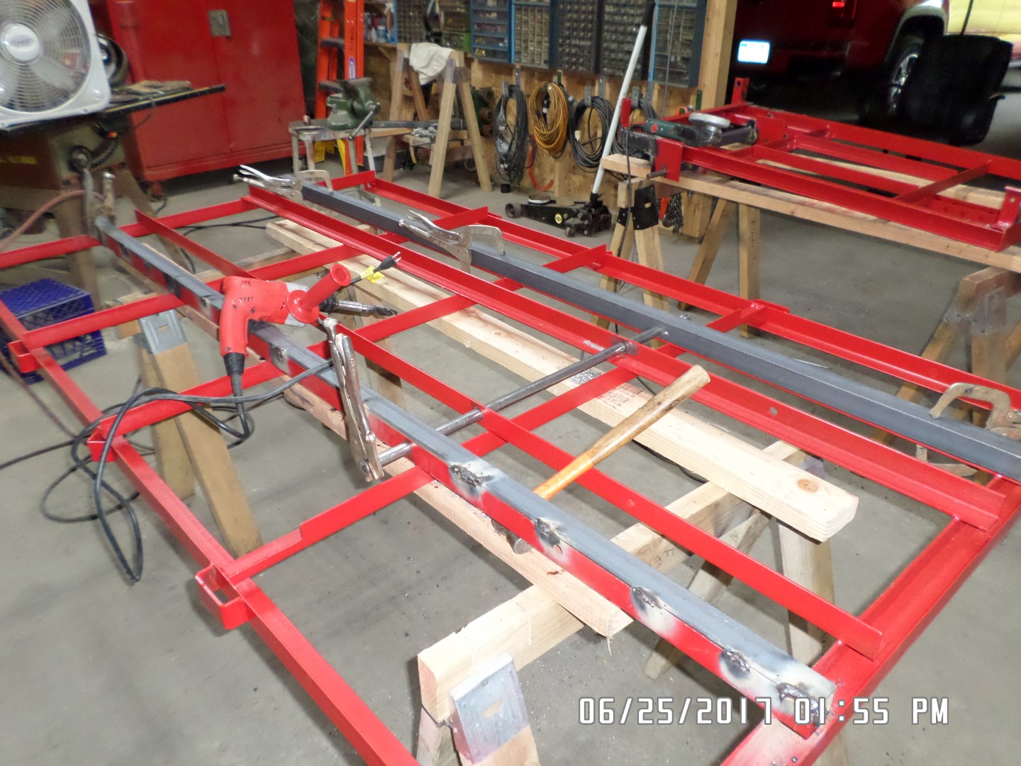

/ country UTV trailer review? #24
Let the welding commence .....

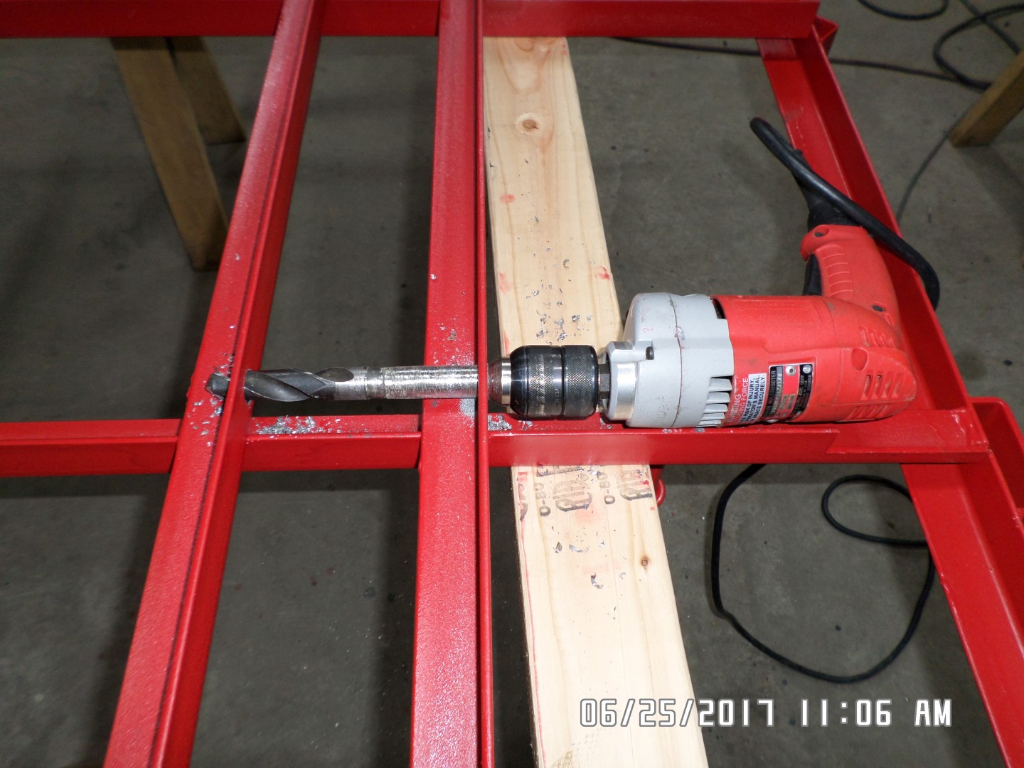

/ country UTV trailer review? #25
I am adding thick washers to the walking beam axle [ add reasons and pictures when I get to welding that area up ], since I have an old used longer axle than they supplied. I am boring out the holes for the stock 1/2" bed pivot rod so I can use the surplus 3/4" axle as a heavier rod in that position......

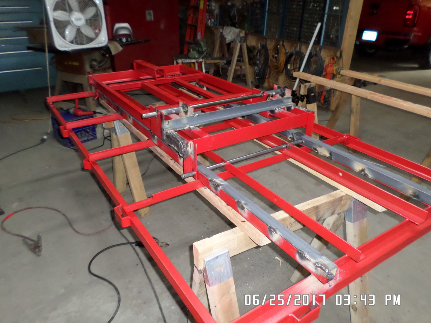

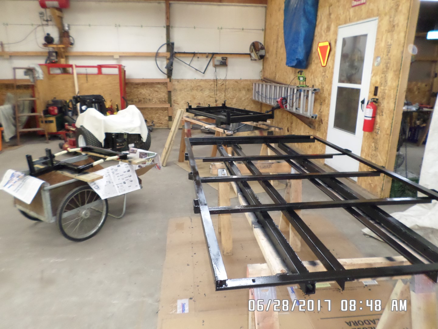

Put the subframe onto the trailer bed [ upside down ] to do final stuff. Tomorrow I am going to clean up, maybe start painting then or Tuesday. I will mod the walking beams while the paint is drying....

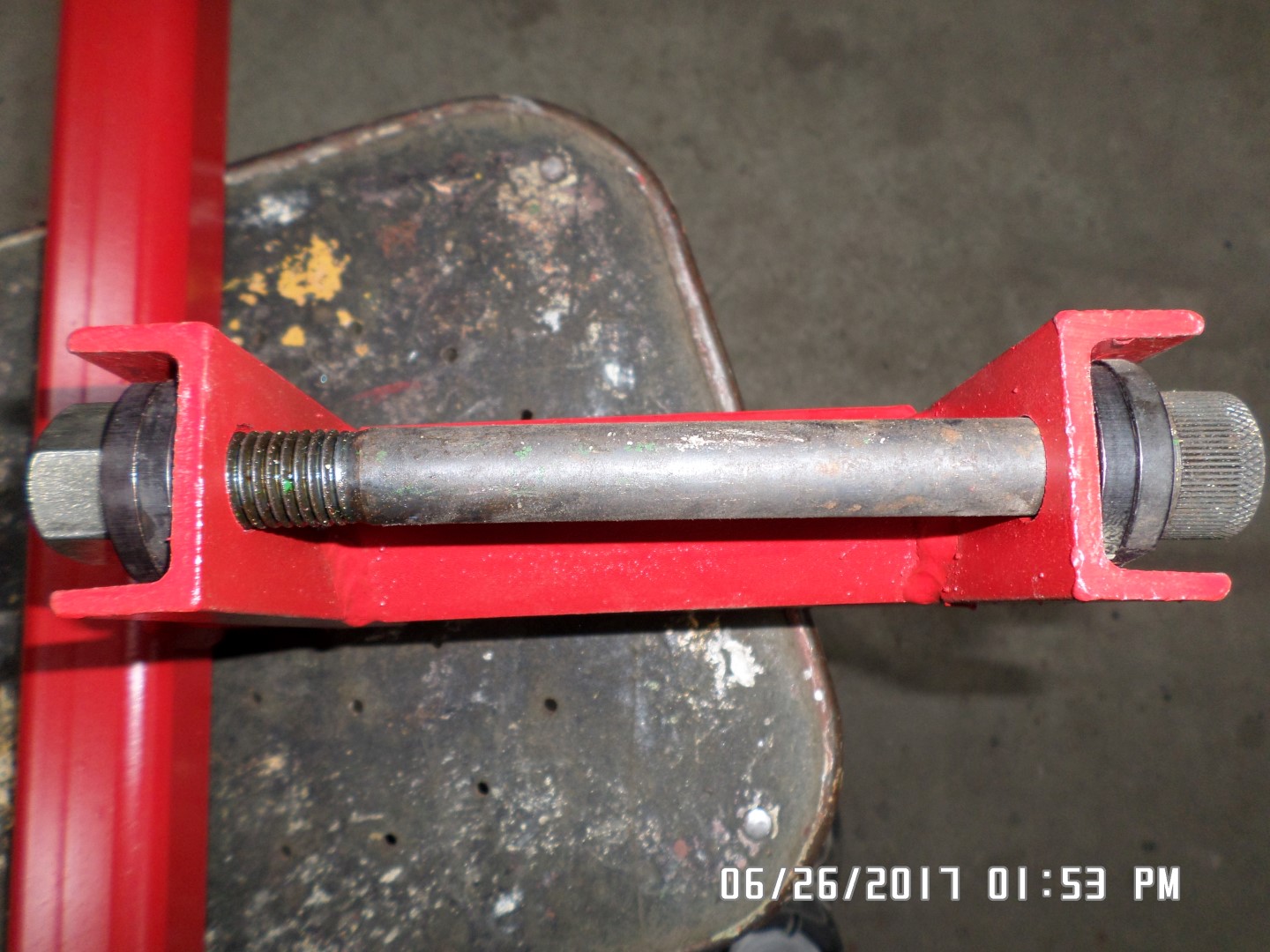

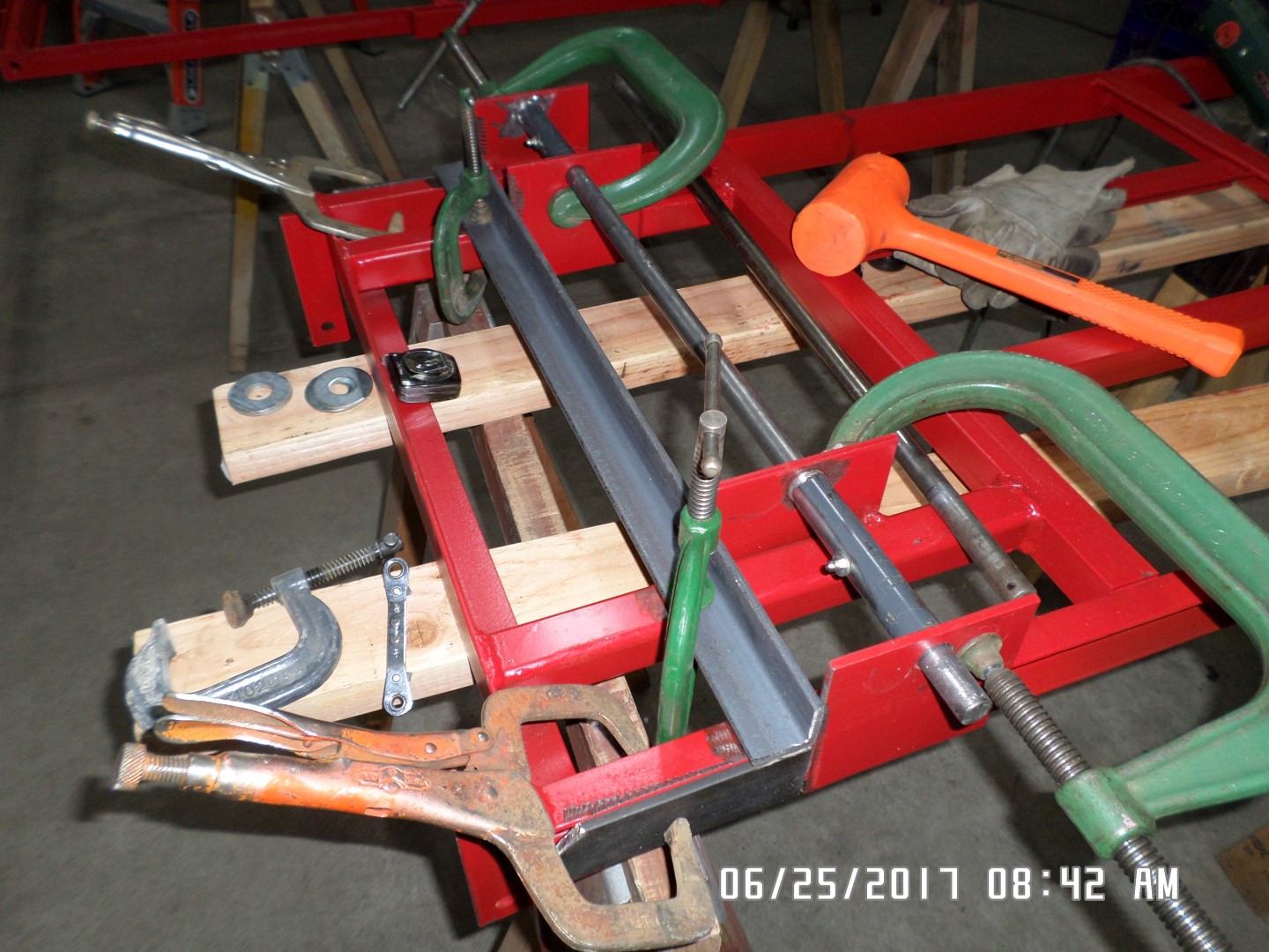

/ country UTV trailer review? #28

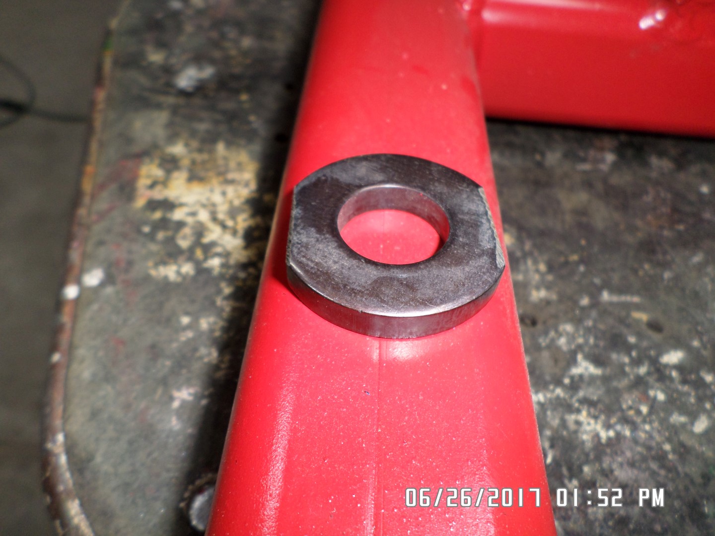

Now to the walking beams..... I ground the side off four 1/4" thick 3/4" washers so they would fit into the walking beam upright channel iron. I am going to weld these onto the walking beams to add to the 3/16" thick stock surface. This is where I think the wear will be and do not see the shaft with the new grease able tubes being much more use than maybe forcing grease out here where the real work is being done. First picture is one of the modified washers, the second is the washers being held in alignment so I can weld them in place via a big 3/4" Unbreako bolt. Anywhilst, I think this is needed.... and should make the whole shebang last as long as I will...... :)

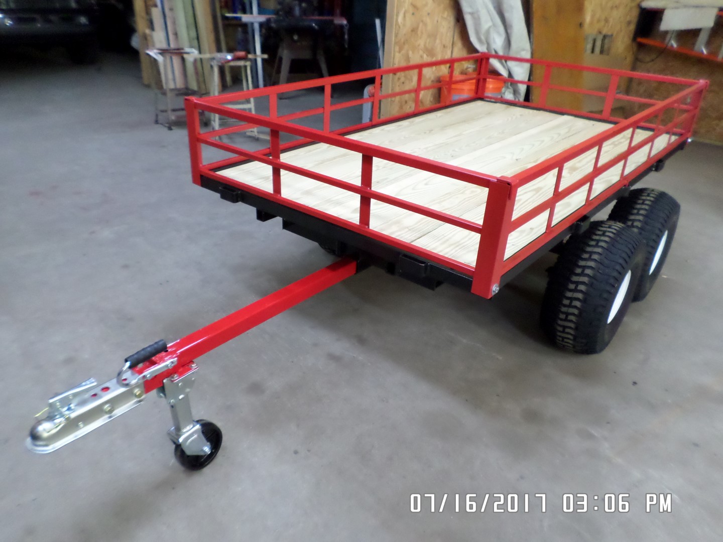

Final coat of paint. Have not finished the tongue yet, waiting for the 1526 to come so I can recheck height and length. Bought a 2" stainless ball to put on the drawbar. Most of the stuff I have to pull use the 2" ball.... May leave the side rails red.....

Jerry, Seems you are asking about the 2x2x.250 angle we added just behind the walking beam support plates. This runs 90 degrees from the trailers front/back. This was to help the sub-frame for bowing while under heavy loads and no relation to us using the trailers dump feature.
This trailer was really under built in my book.
Howdy..!!! I just ordered a trailer similar to yours, but has a 7' X 4' bed with metal sides [ 7740UTV-BR ]. I stumbled onto your rebuild, and will mod mine / paint it before I assemble it, My one question is why you added the brace on the side of the channel iron between the walking beam plate and the vertical angle the bed pivot on??? [ picture #1 of the frame upside down ] I do not plan on making mine tilt and will fix the bed in place. Basically going to use mine for firewood/out in the woods behind a tractor....

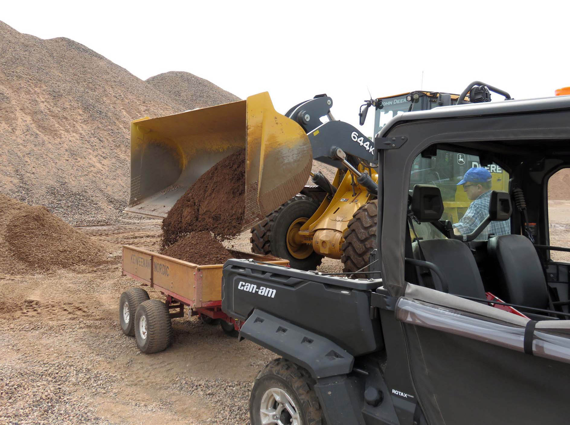

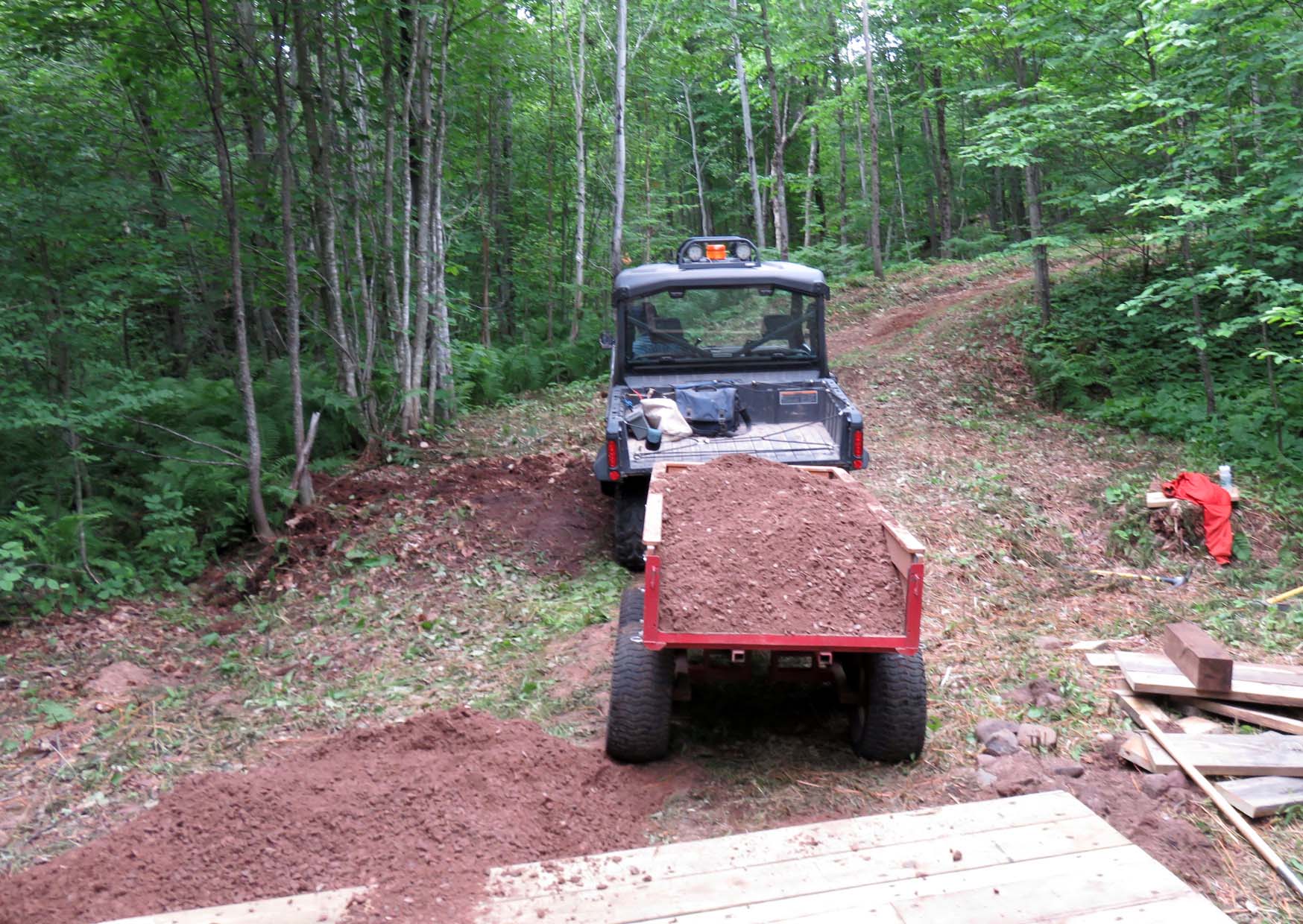

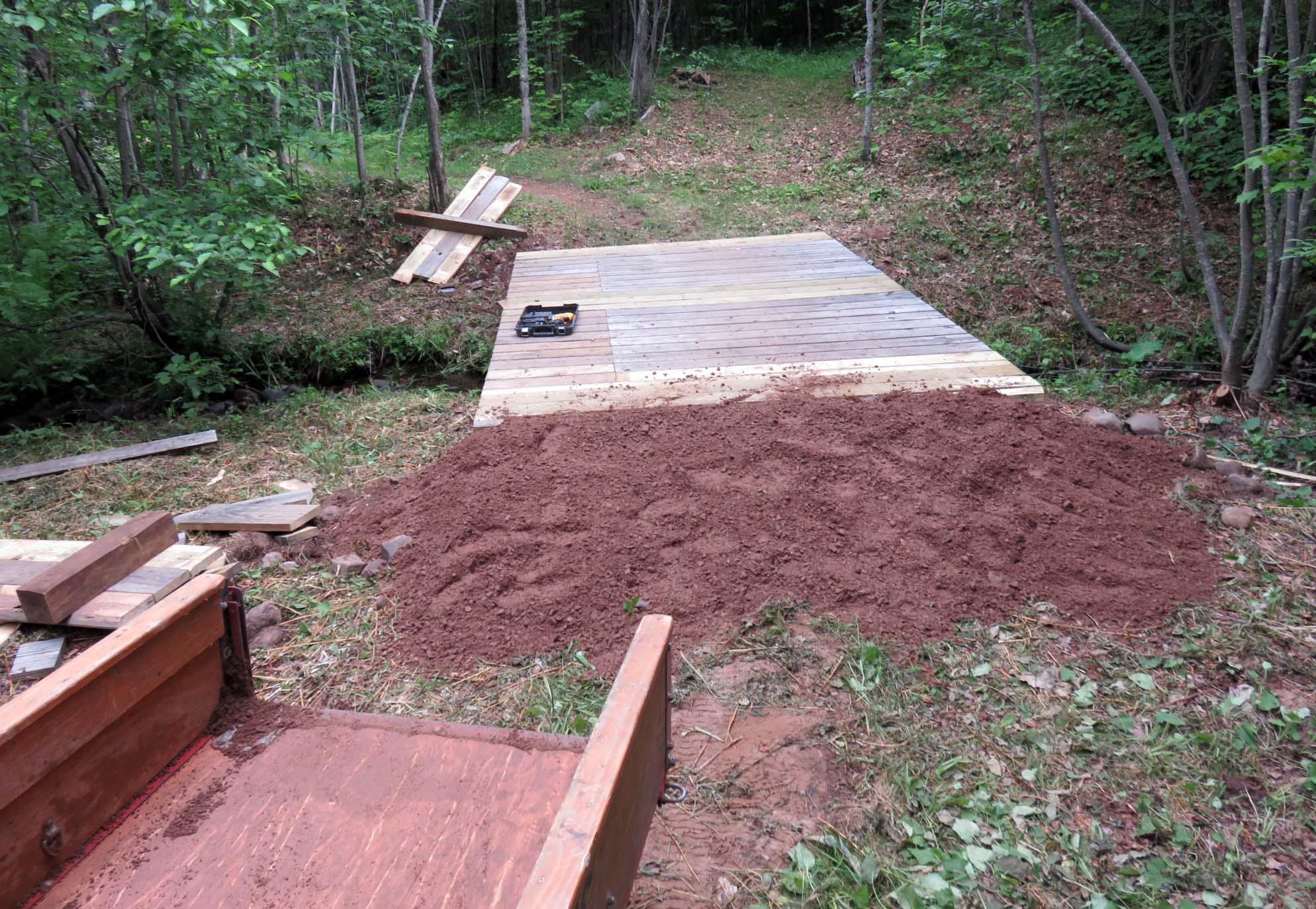

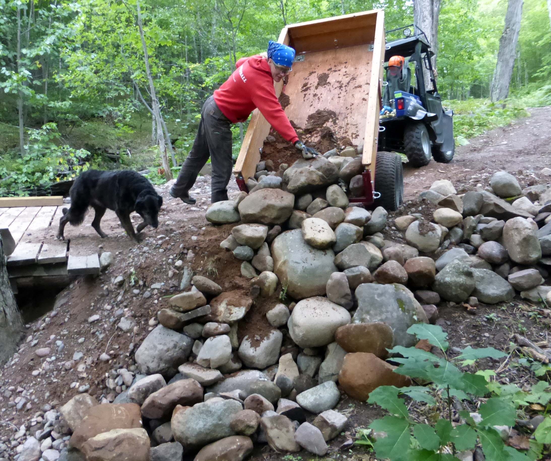

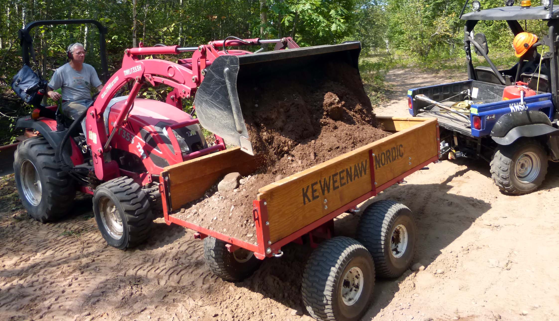

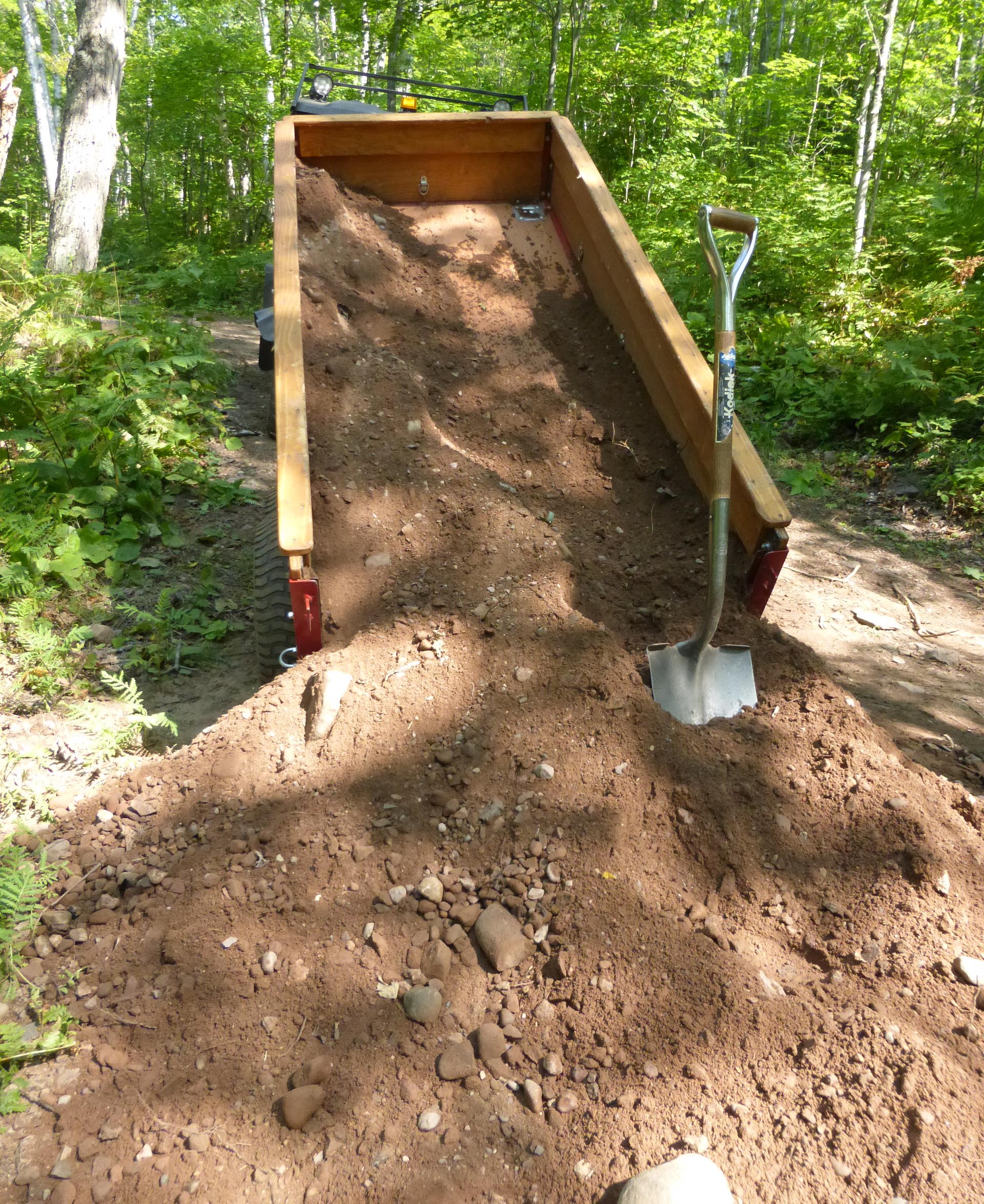

We used a tractor, but the problem is the tractor loads at the pit, so its not at the dump location. I'll attach a few photos of no real value.:)

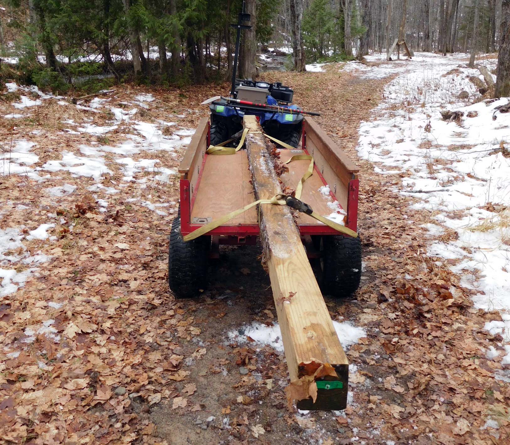

#40

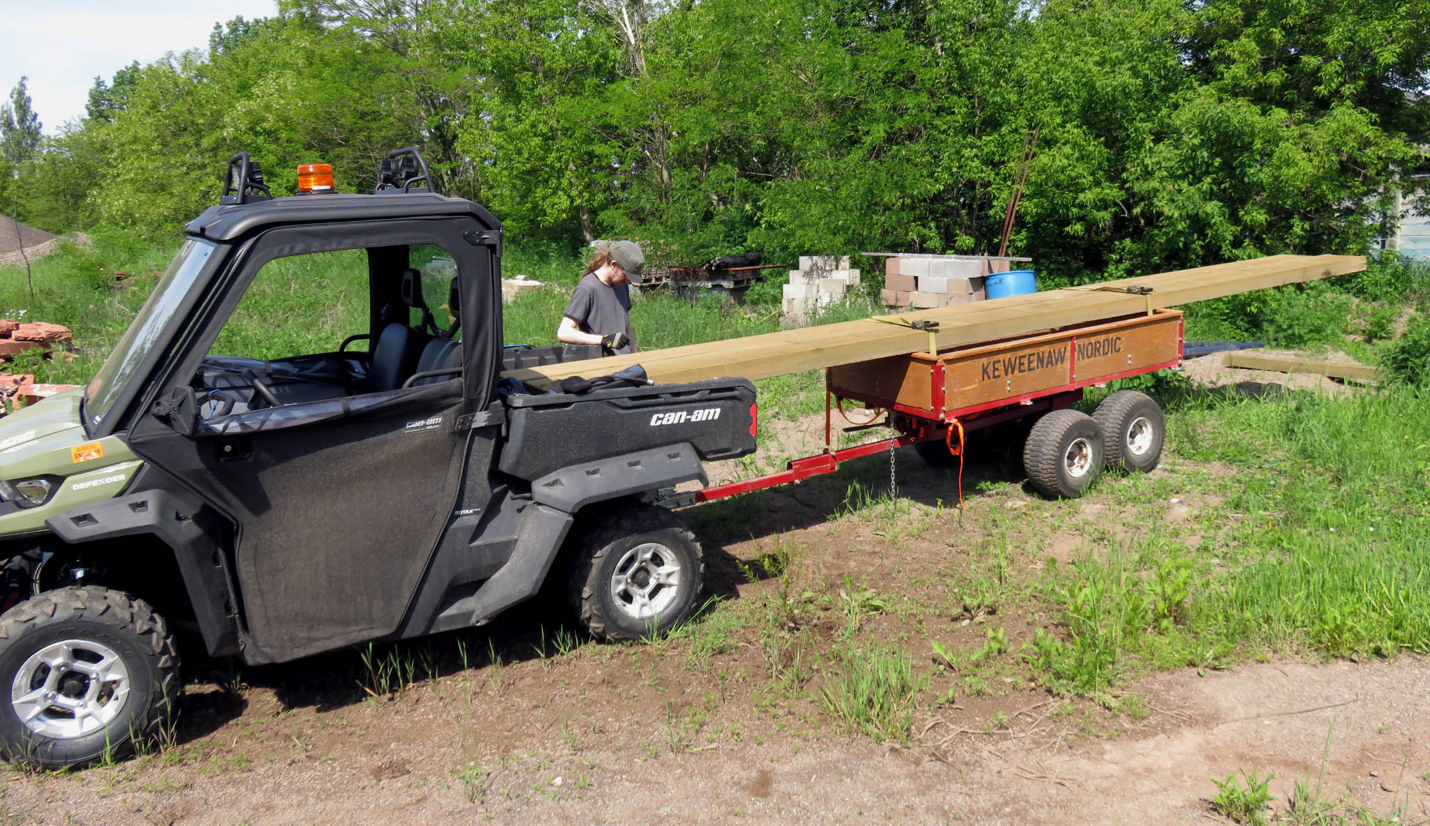

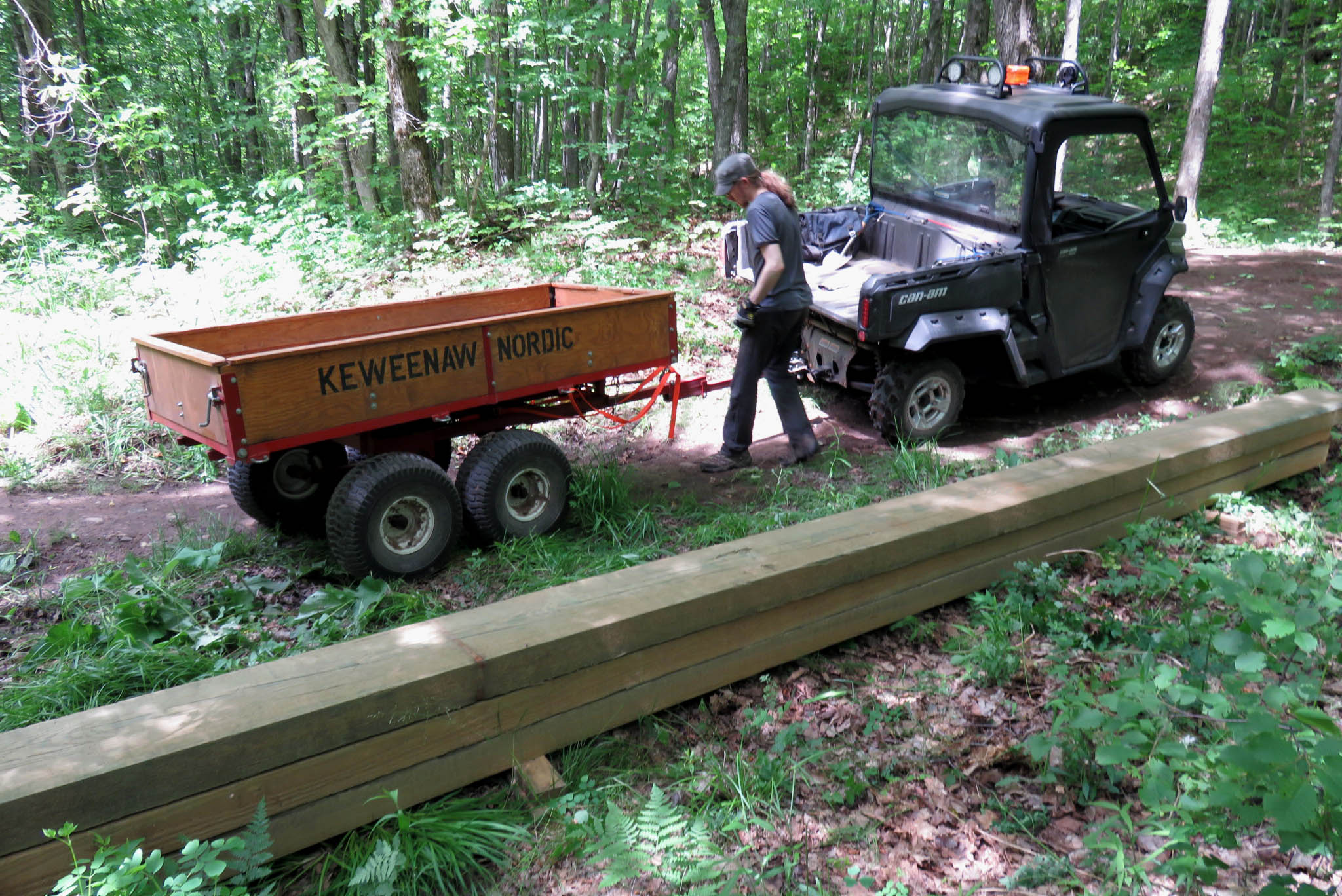

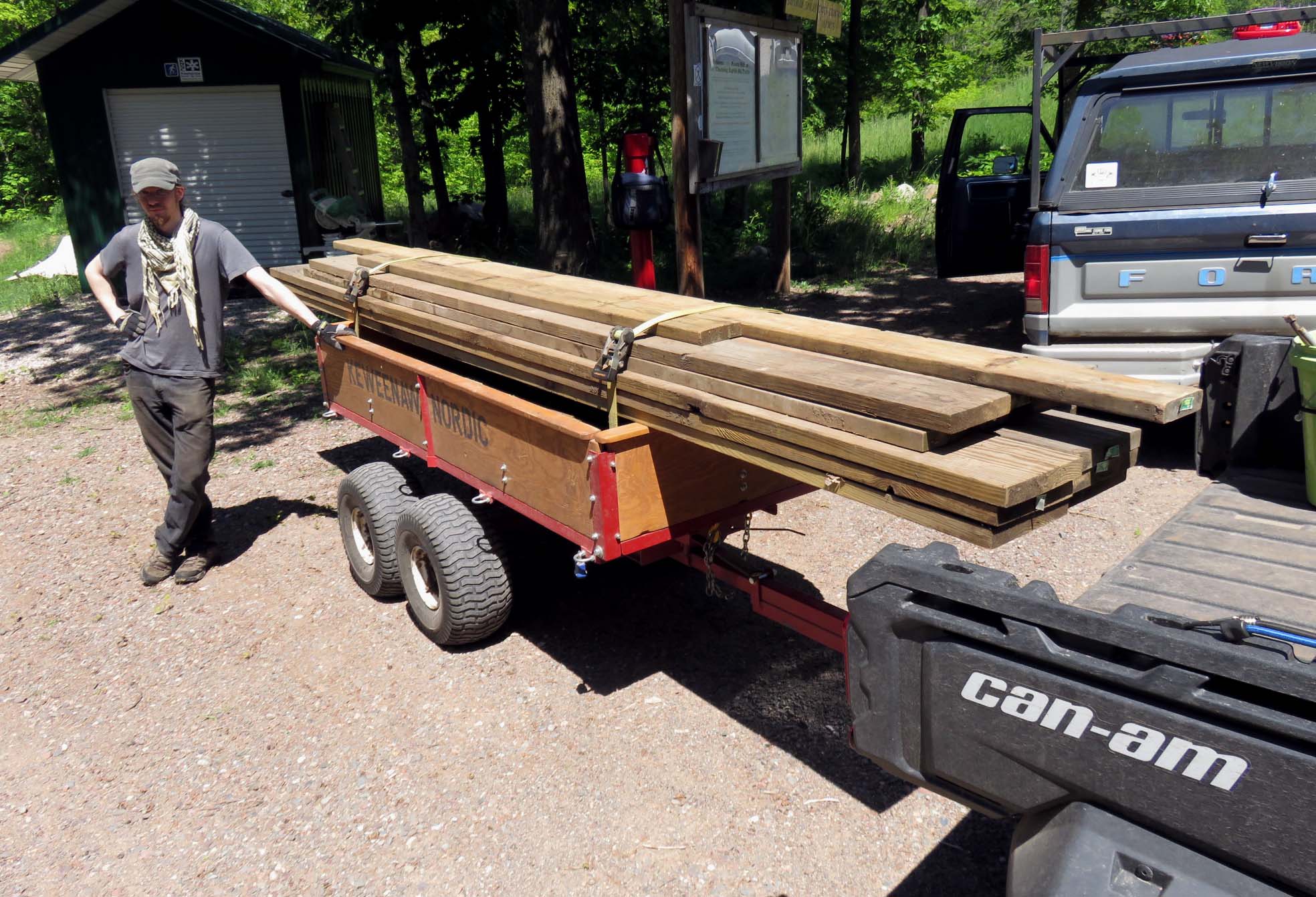

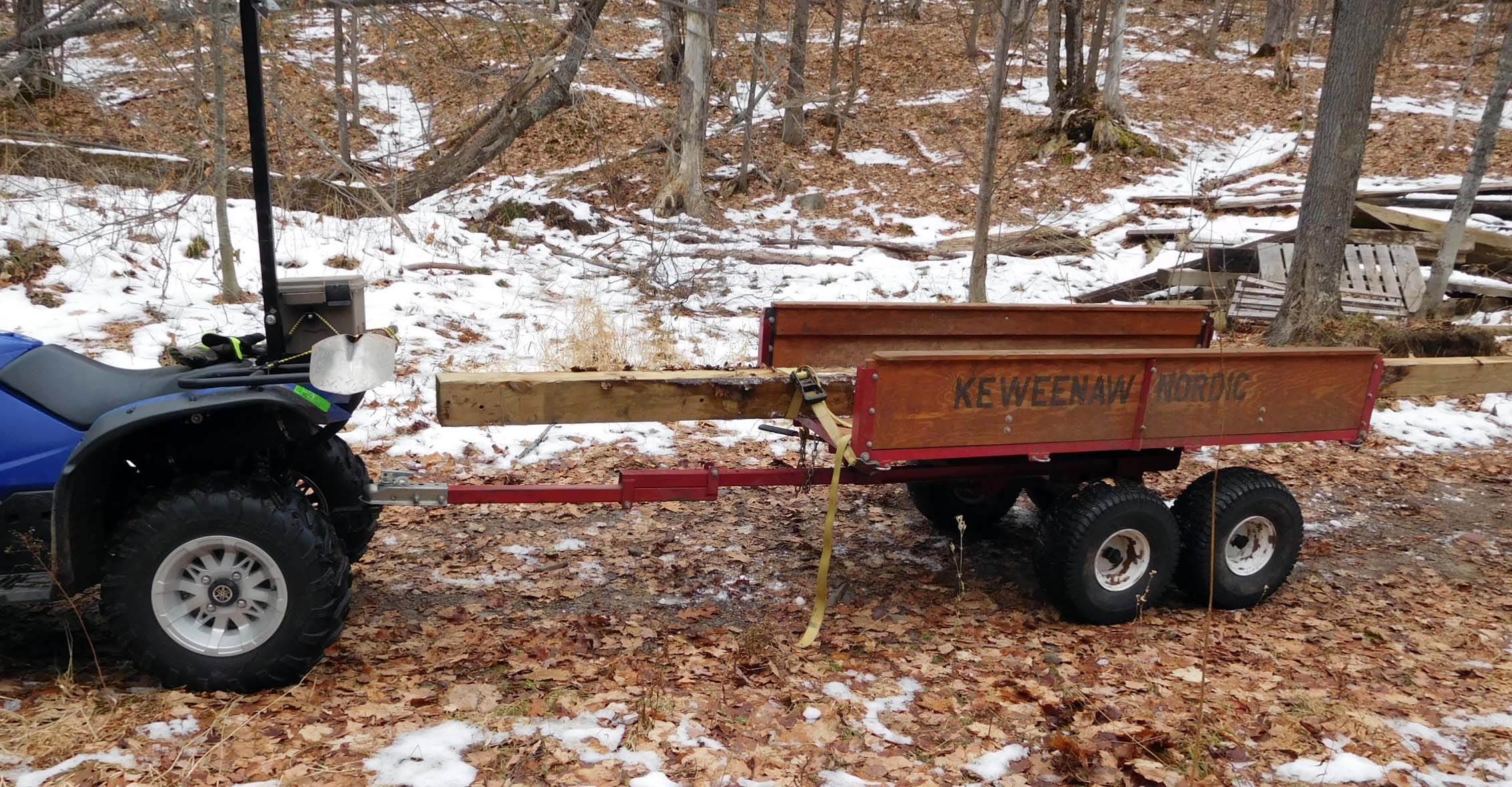

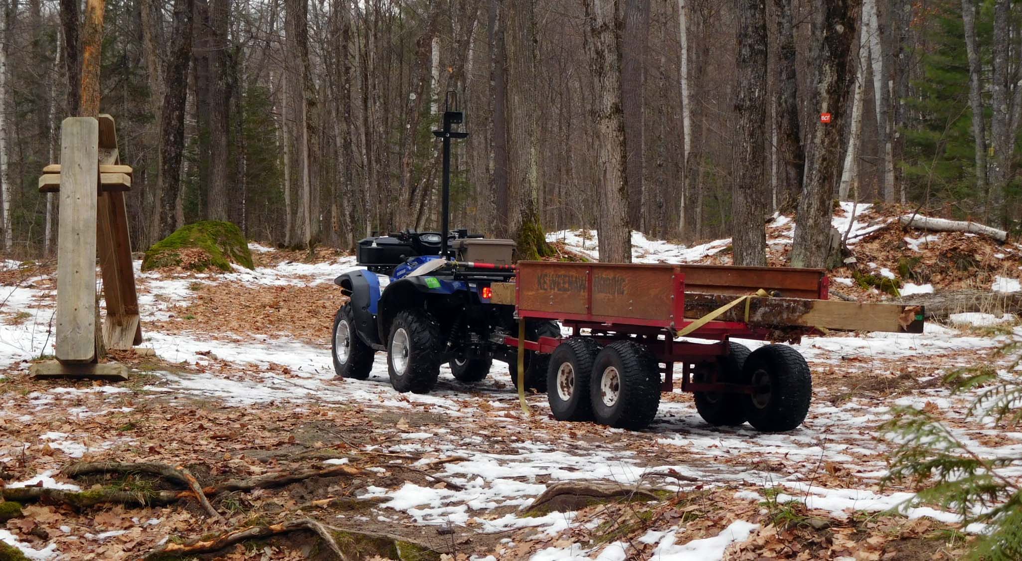

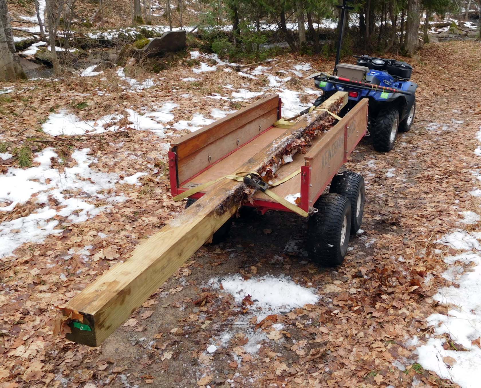

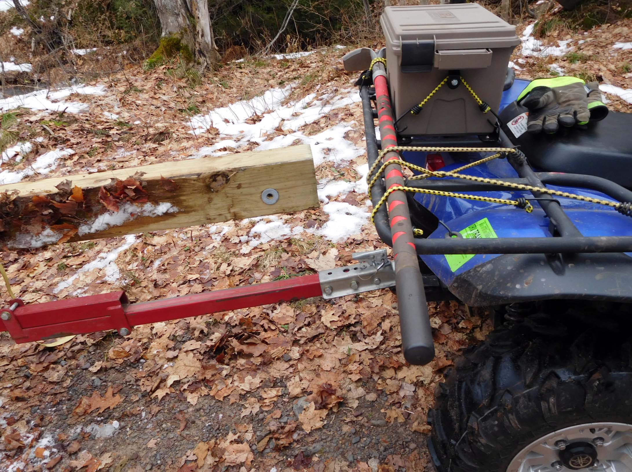

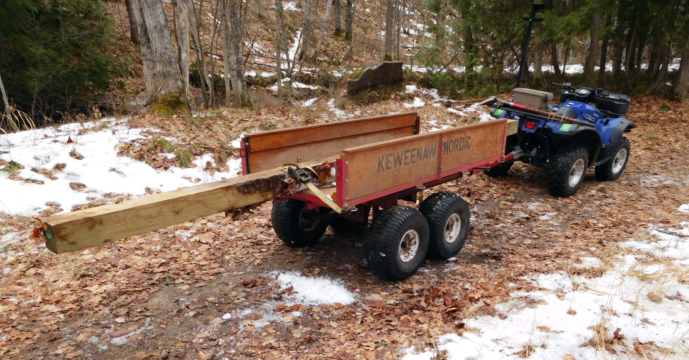

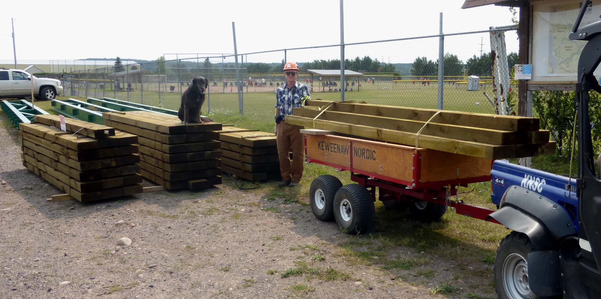

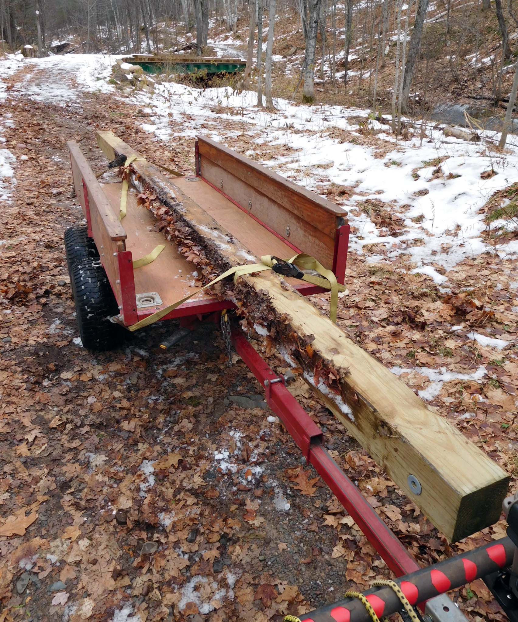

Here is a few recent photos of this trailer in action. This is a 16ft 6x6 we retrieved today and you may note, the trailer hitch was modified so as to be lengthened for hauling longer pieces like this.
