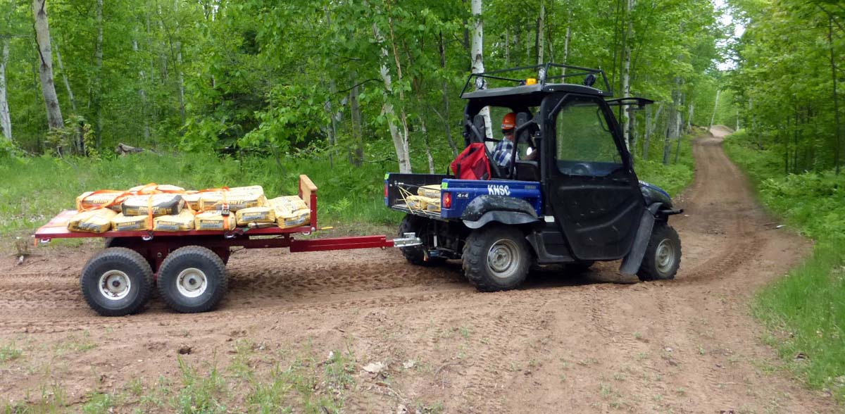

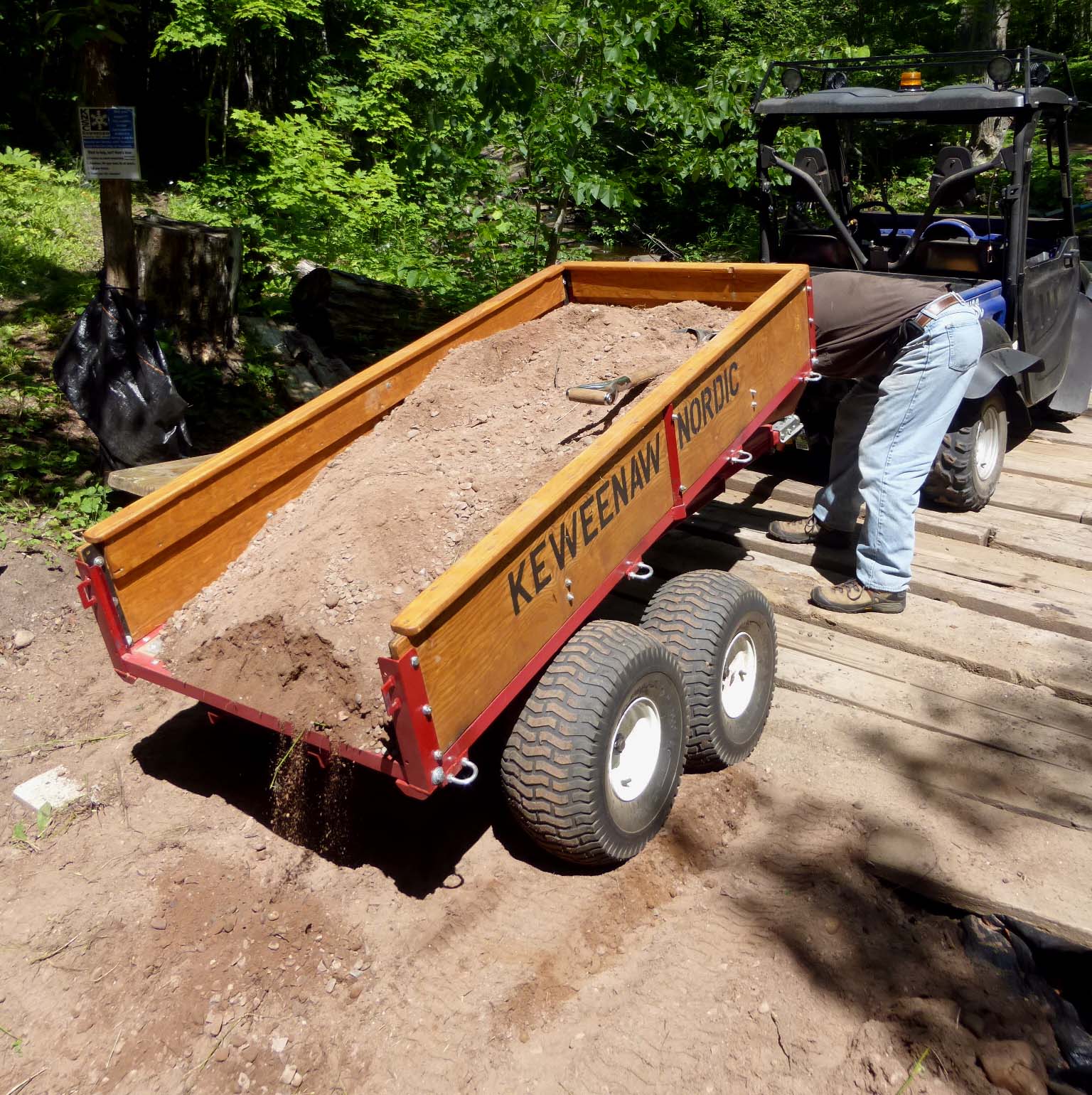

OK here goes. We got this trailer with a hydraulic lift accessory to help us move gravel and supplies to and from a remote work site. It had a pretty high load capacity which I'd now say is unrealistic. The tandem axle bearings (walking beam) was worn out after moving maybe 30 heavy loads 1/2 a mile. I know what you mean Oldpath! In the next post I'll show how we rebuilt that and re-enforced the frame some.

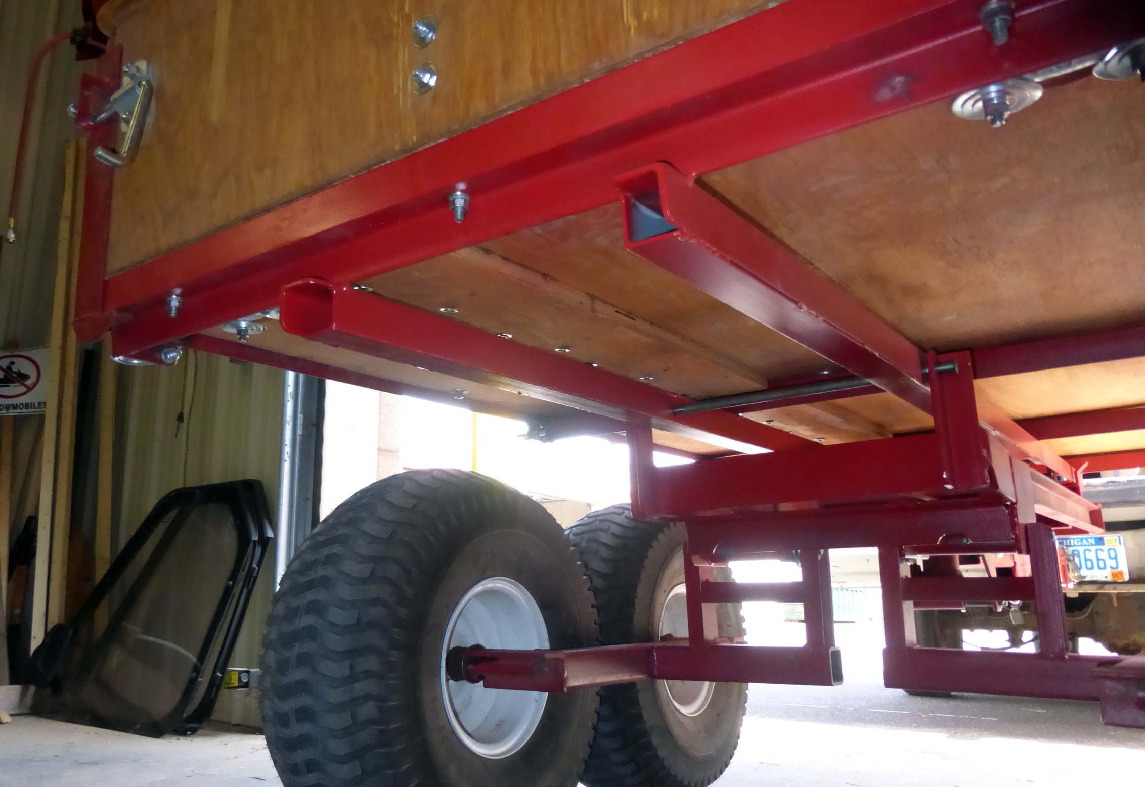

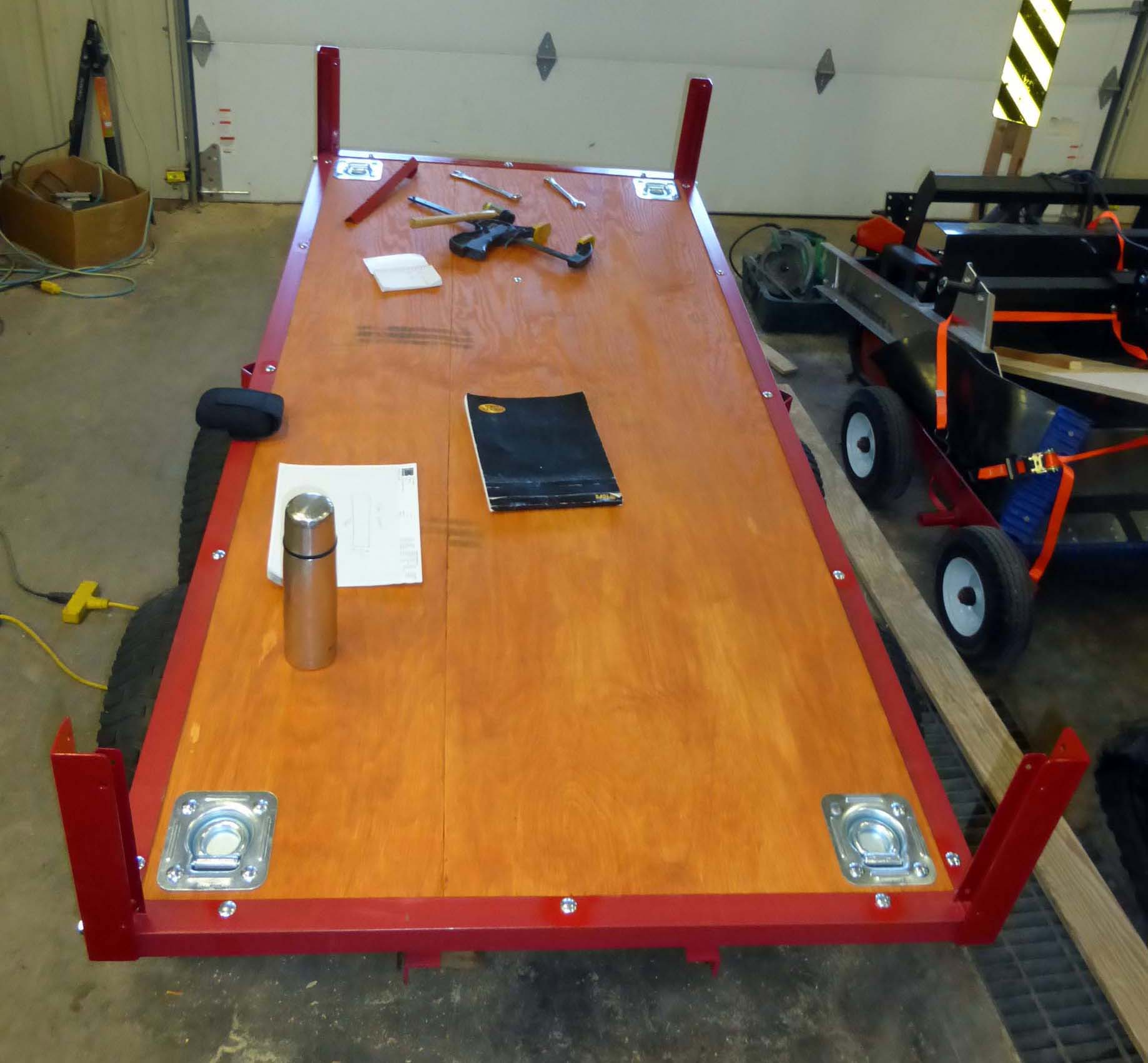

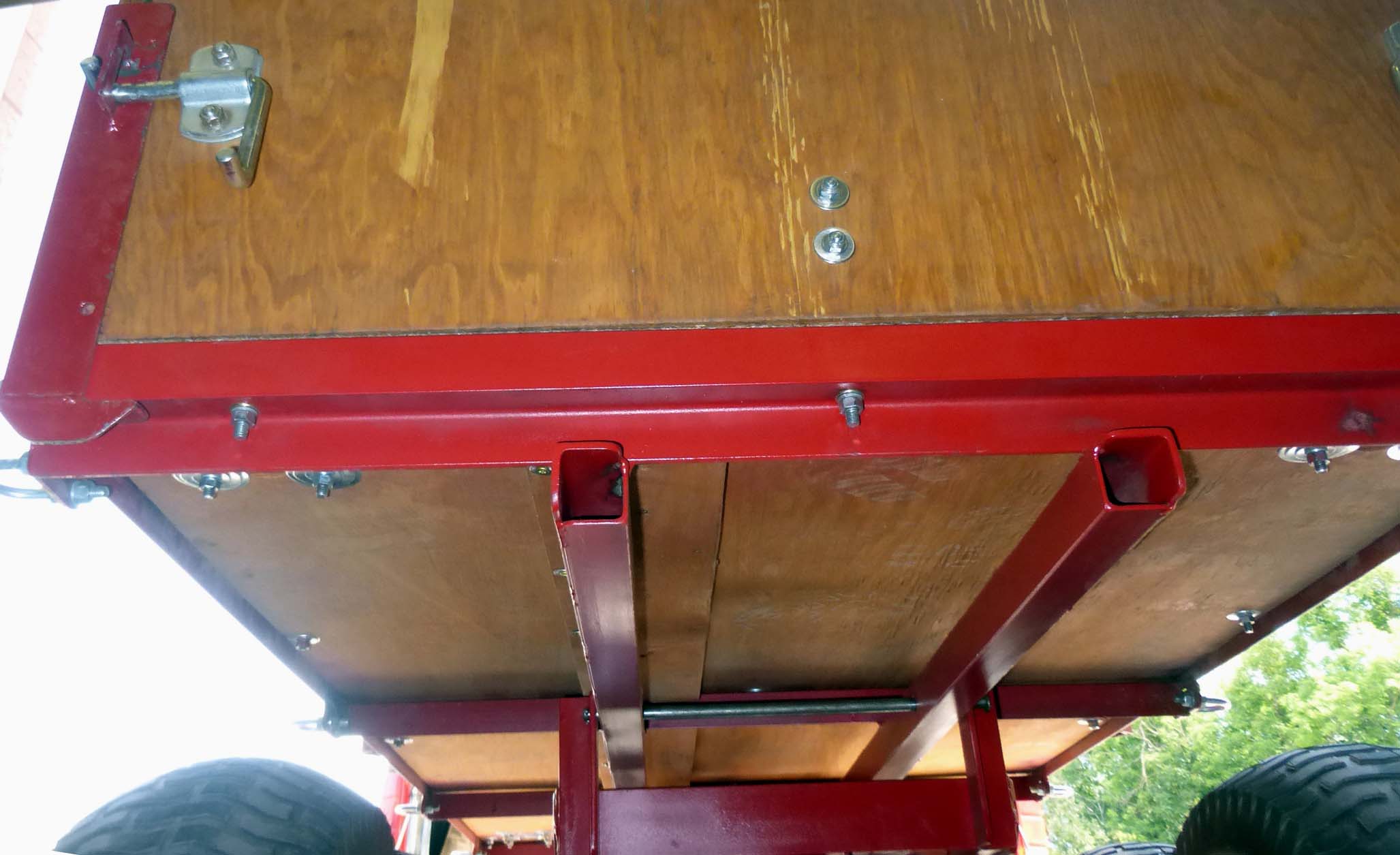

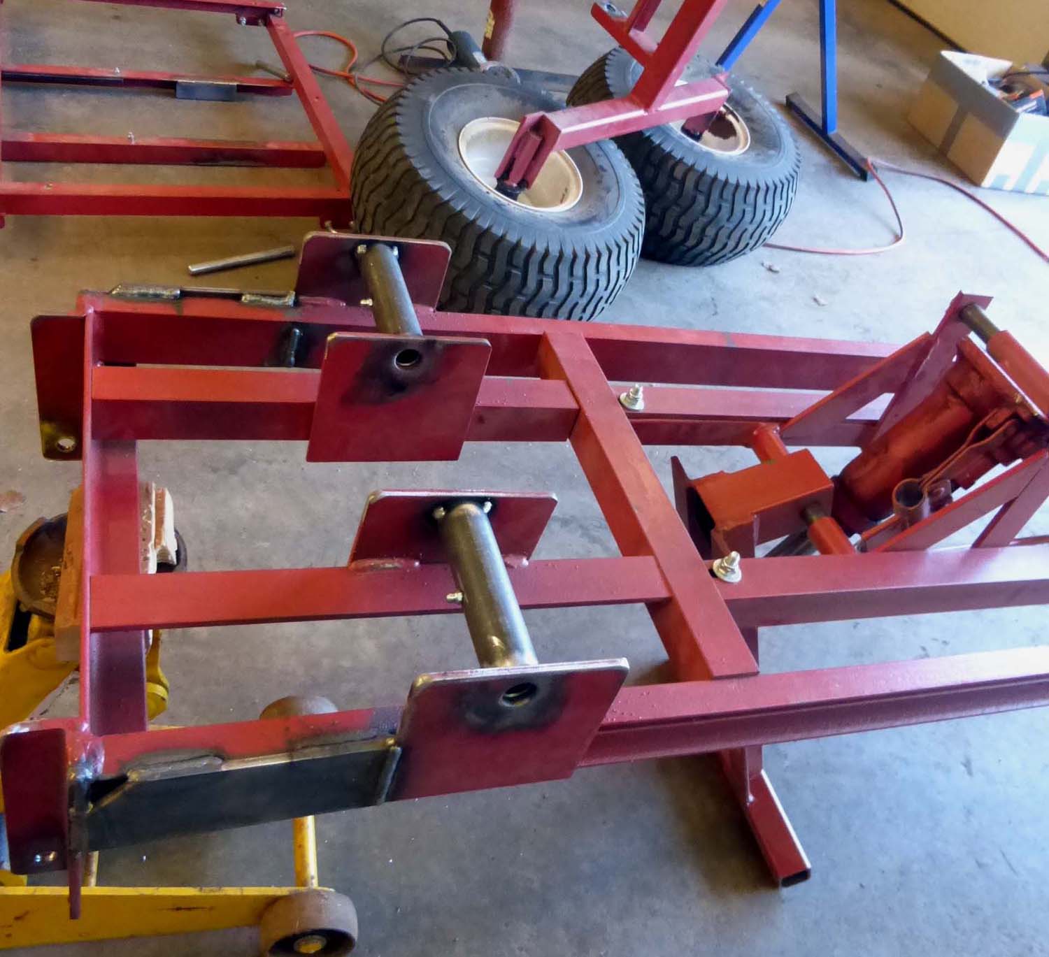

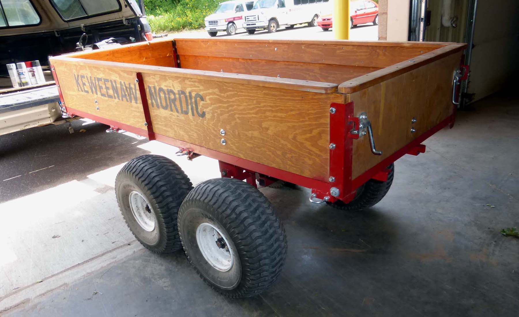

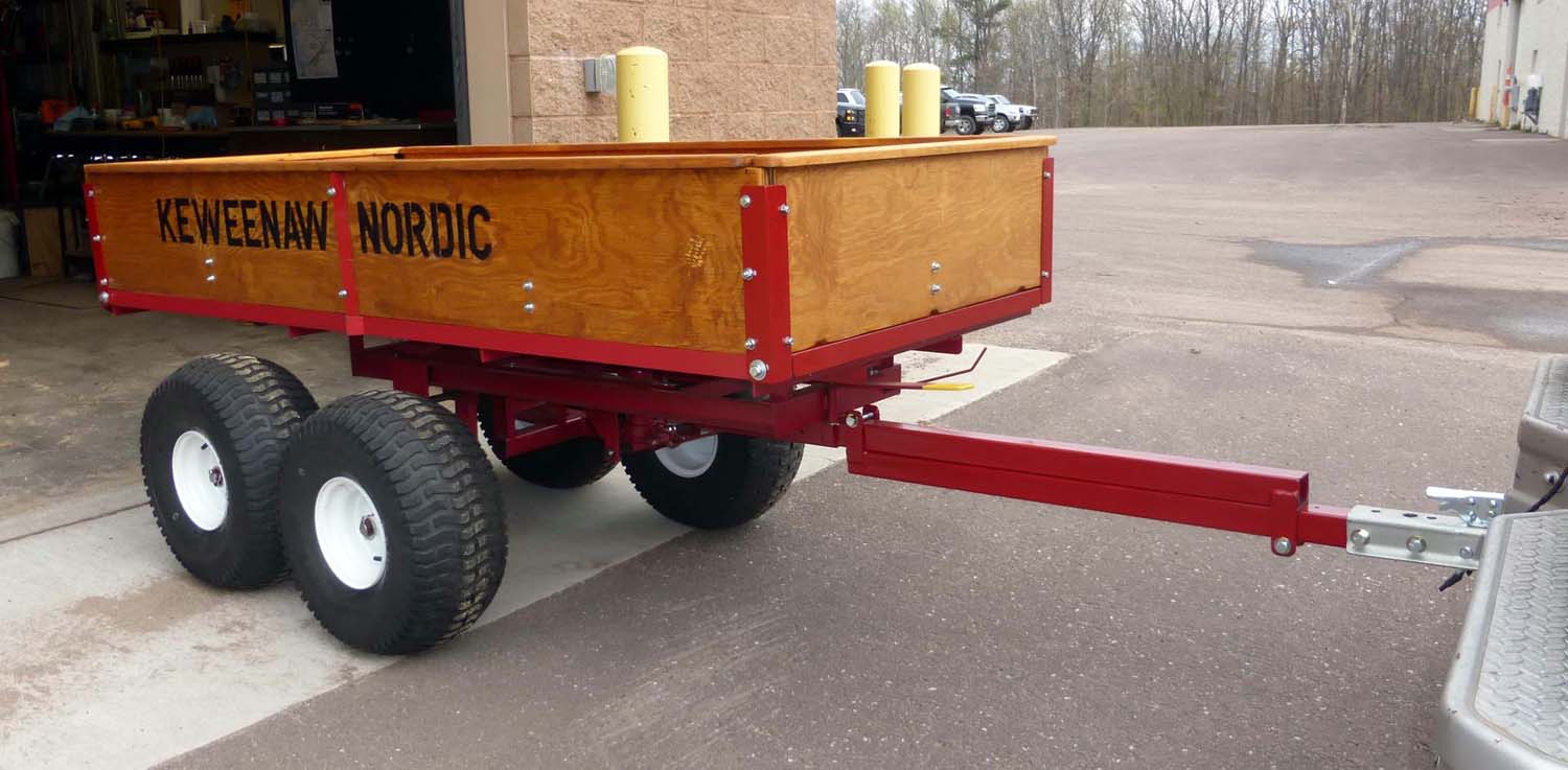

UTV trailer frame and walking beam rebuild
In support of the manufactures design, we were likely loading to its max at 2200lbs. We also had one operator who drove rather fast and the box frame got bent going over bumps which was made from 1/8" 1.5 x 1.5 angles. Then the walking beam axles were worn out as well, so they were rebuilt as seen in the top photo.. (frame is upside down) The 2nd photo is a chain we added when we realized the trailer would "dump" if not loaded properly or someone stood in its back. This chain keeps it from flipping up. In the "trailer frame" photo you can see we doubled its bent frame by adding another 1/8" 1.5 x 1.5 angles which make it into a square tube frame.
In the last photo you can see some of the many tie down loops we added. The "double tube" tongue was added because we sometime move 14ft decking which will not fit or balance on the trailer. This tongue design allows us to extend it when needed.

/ country UTV trailer review? #5
Nice bunch of photos, you showed what I wanted to see, and to be brutally honest in a friendly sort of way, that walking beam is a bad design. The square stock that connect both wheels is fine, it's just in the middle where it goes up to what looks like 8" to the pivot pin which in-turn is like an upside down T. With the walking beams like that it looses a lot of true walking beam movement and produces a lot more stress on the 1" pivot pins, know what I mean Vern, probably not, but over all the rest of trailer looks good.
I'll agree with the bad design of the walking beam but for a different reason. Its bearings that were just 1/4" plate with 3/4 holes punched in them, were waaaaaay to small to hold up. The trailer just wasn't made for serious loads or mileages. I'd call it a 1800lb trailer in its original format including that its box frame was so light. With all the revamping we did, maybe its now a 2400lbs trailer.

/ country UTV trailer review? #7
"Its bearings that were just 1/4" plate with 3/4 holes" <<<<<<<<<<< You diffidently made that better putting a pipe in between the 1/4" plates with geese fittings, was you able to up the pin size to 1''? I agree 3/4" is kinda on the small side on 1/4 plates, but anyways great repair job!
What you see in these photos was a Rhino what was subsequently retired (sold) and replaced with a can-am HD10 defender. If you care, its reviews can be read here. http://www.tractorbynet.com/forums/atvs-utility-vehicles/355357-can-am-2016-defender-hd10.html
The jack lift worked OK. We wish it went a tad higher and we also broke it once but wasn't to hard to repair. The walking beam mount pin remained 3/4 in size but what's not visible in the photos is the 4 locking collars we welded to the beams channels to lock the pins in position. The short pipes you see which got welded in to create the bearings, are dram tubing. Yes lots of messing around but by the end, the trailer was made much stronger or more durable. Not being able to weight the loads, we could have been moving 2500lbs.

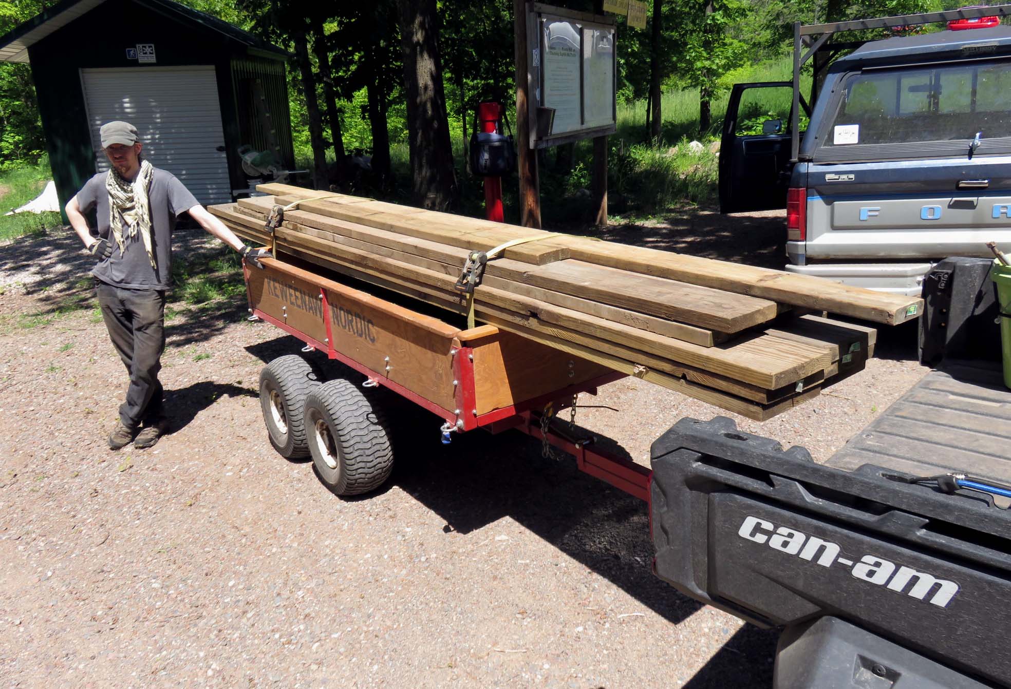

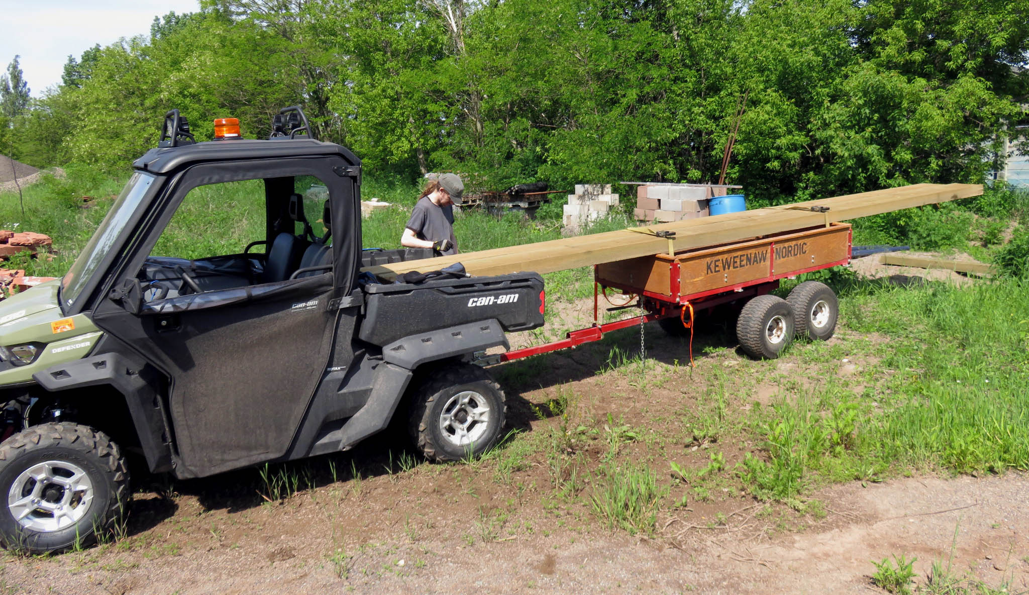

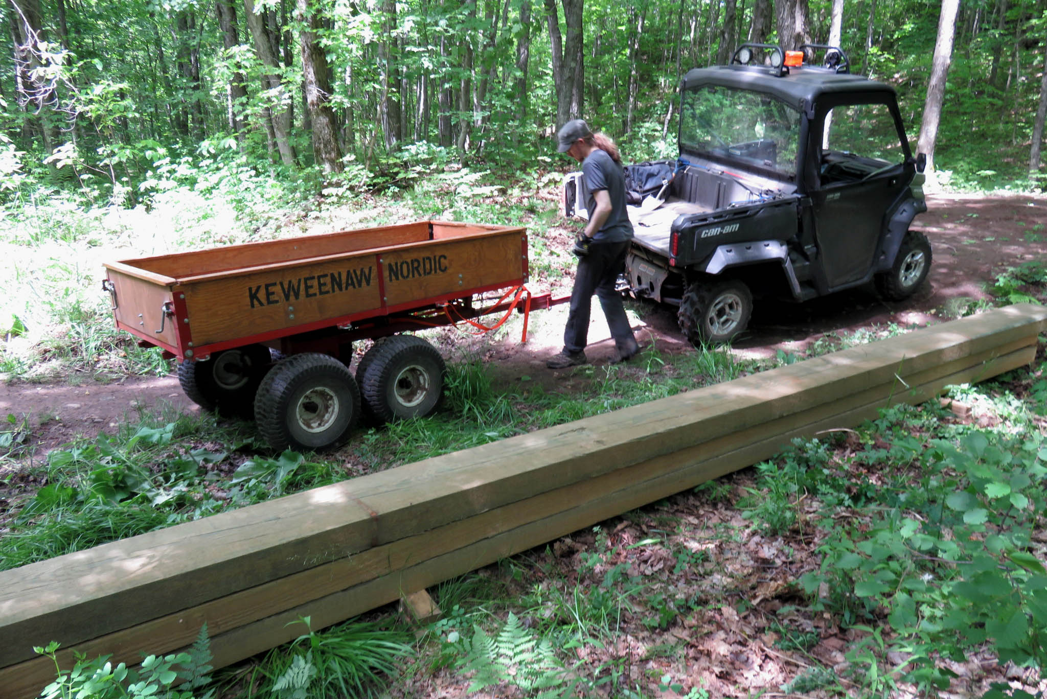

#14
Here is some loads we moved on Friday. No idea what they weighed. In the 2nd photos those timbers were 22ft long 4x12" full dimensional lumber. Yes we grunted getting them on.... You can see the adjustable hitch was extended to its max.

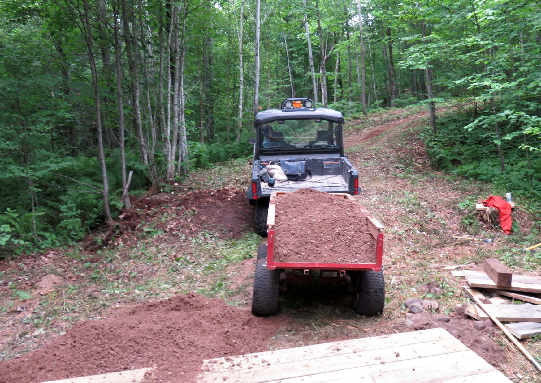

#15
This deluxe trailer made a few gravel runs this week. :thumbsup:

Thanks Dave. If you are moving serous loads with yours, you may want to watch the walking beams angle. Ours went squat, (center down, looking from the back) as the beams bearings wore out.
/ country UTV trailer review? #19
Howdy..!!! I just ordered a trailer similar to yours, but has a 7' X 4' bed with metal sides [ 7740UTV-BR ]. I stumbled onto your rebuild, and will mod mine / paint it before I assemble it, My one question is why you added the brace on the side of the channel iron between the walking beam plate and the vertical angle the bed pivot on??? [ picture #1 of the frame upside down ] I do not plan on making mine tilt and will fix the bed in place. Basically going to use mine for firewood/out in the woods behind a tractor....
