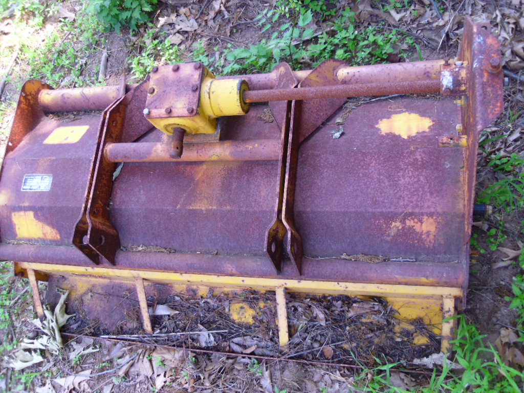

I bought this mower the guy said it was a john deere.
Looked at photos on the internet and Alamo said it was a mott KB48.
I had it sand blasted painted, figure out the pulley size to run on my massey gc2300 540 rpm.
Tryed it out today runs backwards. Needs pto to run counterclockwise.
What can I do now? any replacement gear boxs?
Please help
thanks
Al

If the blades are directional turn them around.

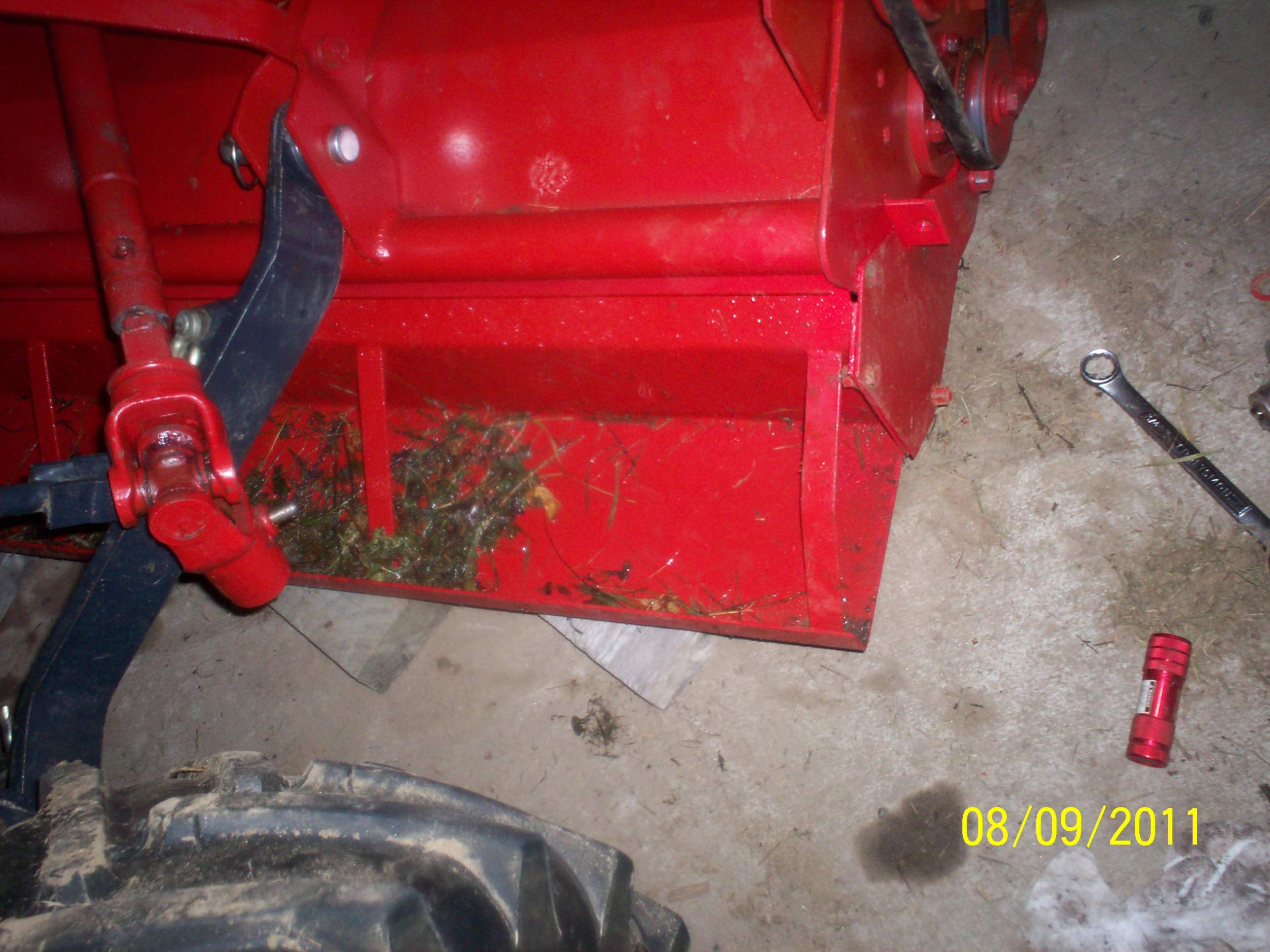

There is some kind of guard on the front.
When you mow driving forward it just lays the grass over.
It was really close to ground so I removed it.
That's when I discovered the grass shooting out toward the tractor.
I would like to drive the tractor forward and grass come out the back.
Any help in solving this would be greatly appreciated.
Thanks
Al

Sounds like it's turning the right way then. The blades throwing grass forward means it keeps carries the clippings along with it a ways, mulching it up. Pit the guards back on, but tilt the whole unit back some so they don't drag the ground. You want a gap so they don't lay the grass down quite so much.

The front discharge is fine, you just need to reinstall the guard.

Hello Al,
You do not want to run with the
guard off as it ment to be there for you.

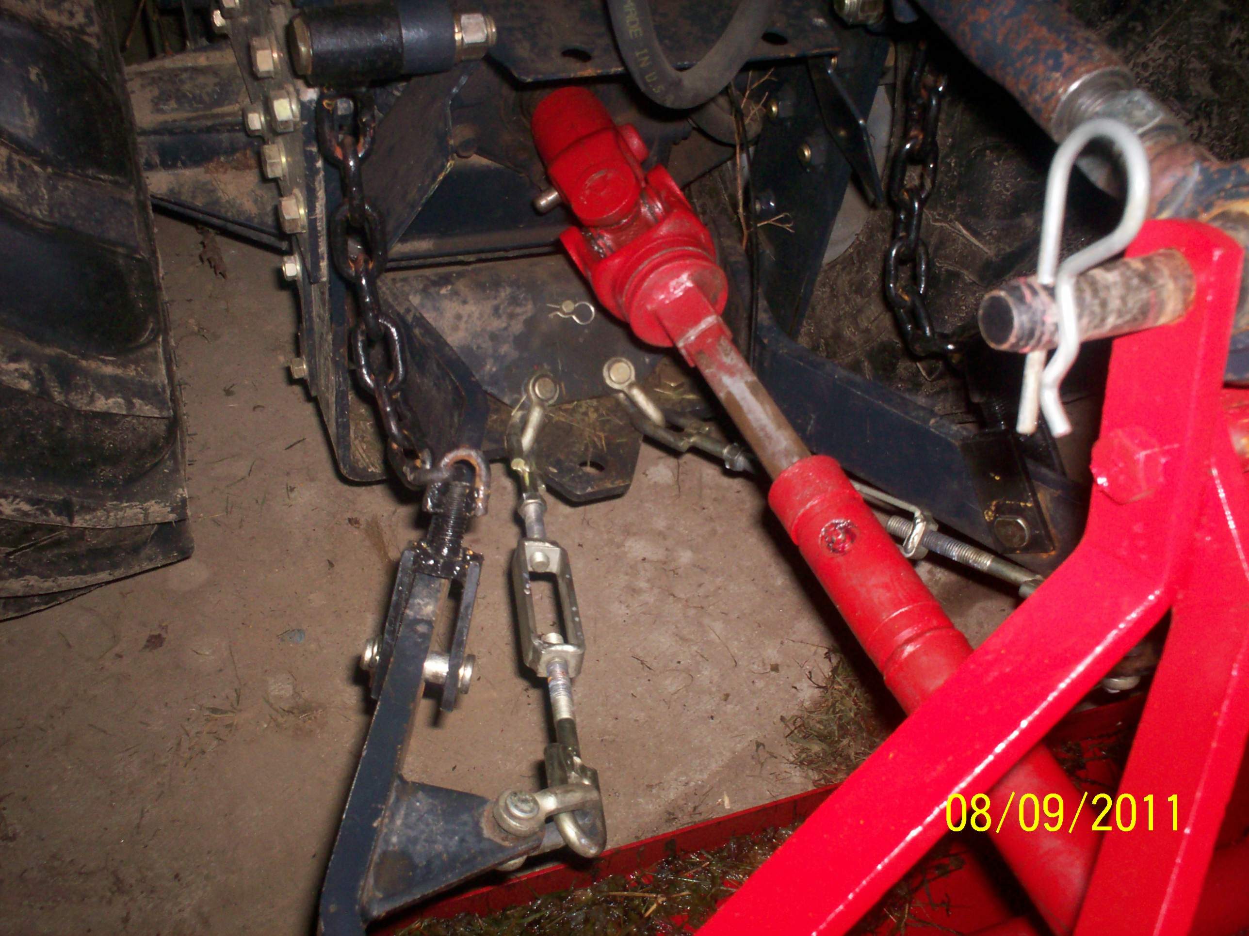

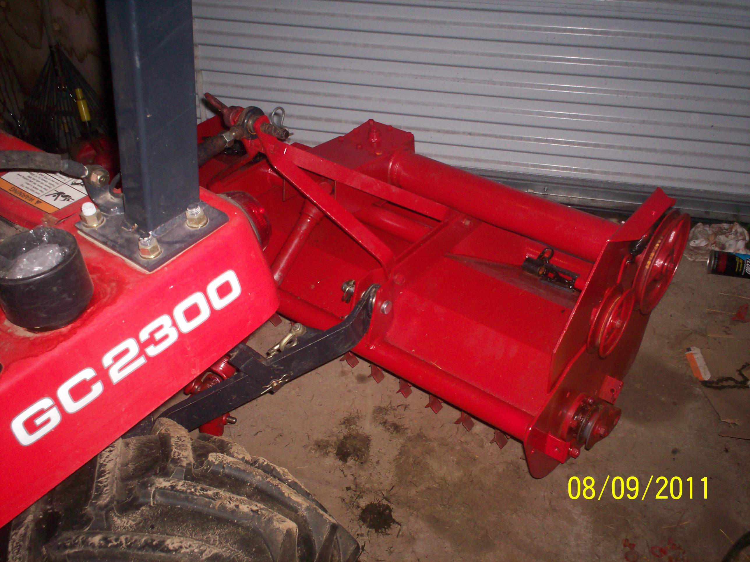

I don't know how to navigate this site and reply to each person.
I put the guard back on and moved to up so it is not close to the ground.

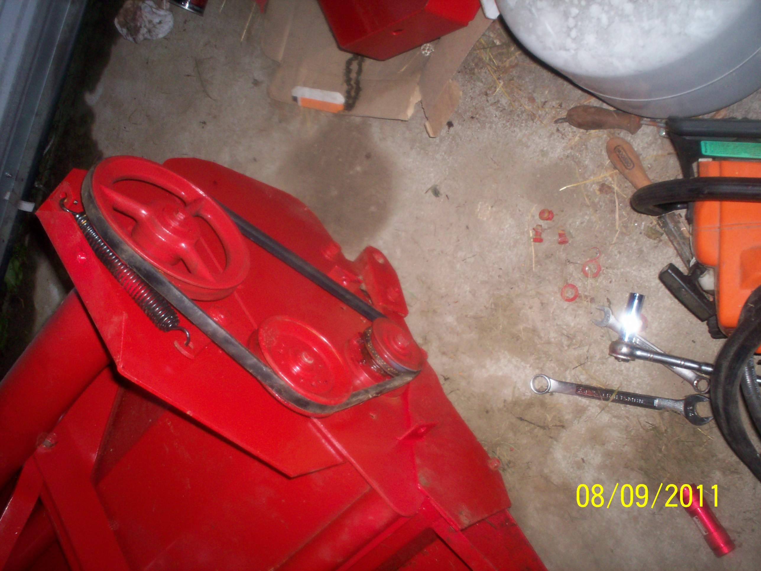

Started to mow good then stop belt is slipping/ smoking
The spring is brand new but it does not feel like a very strong spring.
had a fill nut for gear box put on it and home made lift chains.
part number of guard is 700384.( could see it in marker)
attached are photos, is it a KB48 see how pulleys are on the left hand side facing the tractor compared to going to the right.

Hello Al,
Your biggest problem with the flail mower is the
fact that the flail mower does not have any skids
and that is why it has trouble mowing and you have
to have them.
The flail mower must be riding on the skids and
rear roller both in order for the flail motor rotor
to come up to speed to mow properly.
Apparently someone removed the skids and did
not replace them. Please check with flailmaster
to see if they have skids that will fit if you cannot
have them fabricated locally.
Edit: Al the two bolts at very bottom edge of the side
plate in the picture you have provided are where the
skid shoes should be mounted most likely and someone
removed them unfortunately.

I do not have any pictures of the KB48 flail mower. I suppose its entirely possible that this flailmower with the forward discharge onloy rides one the rear roller. The skids are primarly to prevent gouging by the mowers side weldments in the ground while turning and to avoid nose diving the rotor into the turf by dropping in hole while mowing.
You may be fine with setting the cutting height with the rear hitch and locking the needle valve in place with the top link postioned exactly at the same vertical point the lower link arms are when attached to the mower lower link attachment points.
/ counterclockwise mott mower 48" #20
Or dropping the 3pt lift all the way down as I do, and tilting the unit back onto its rear roller by extending the top link.
