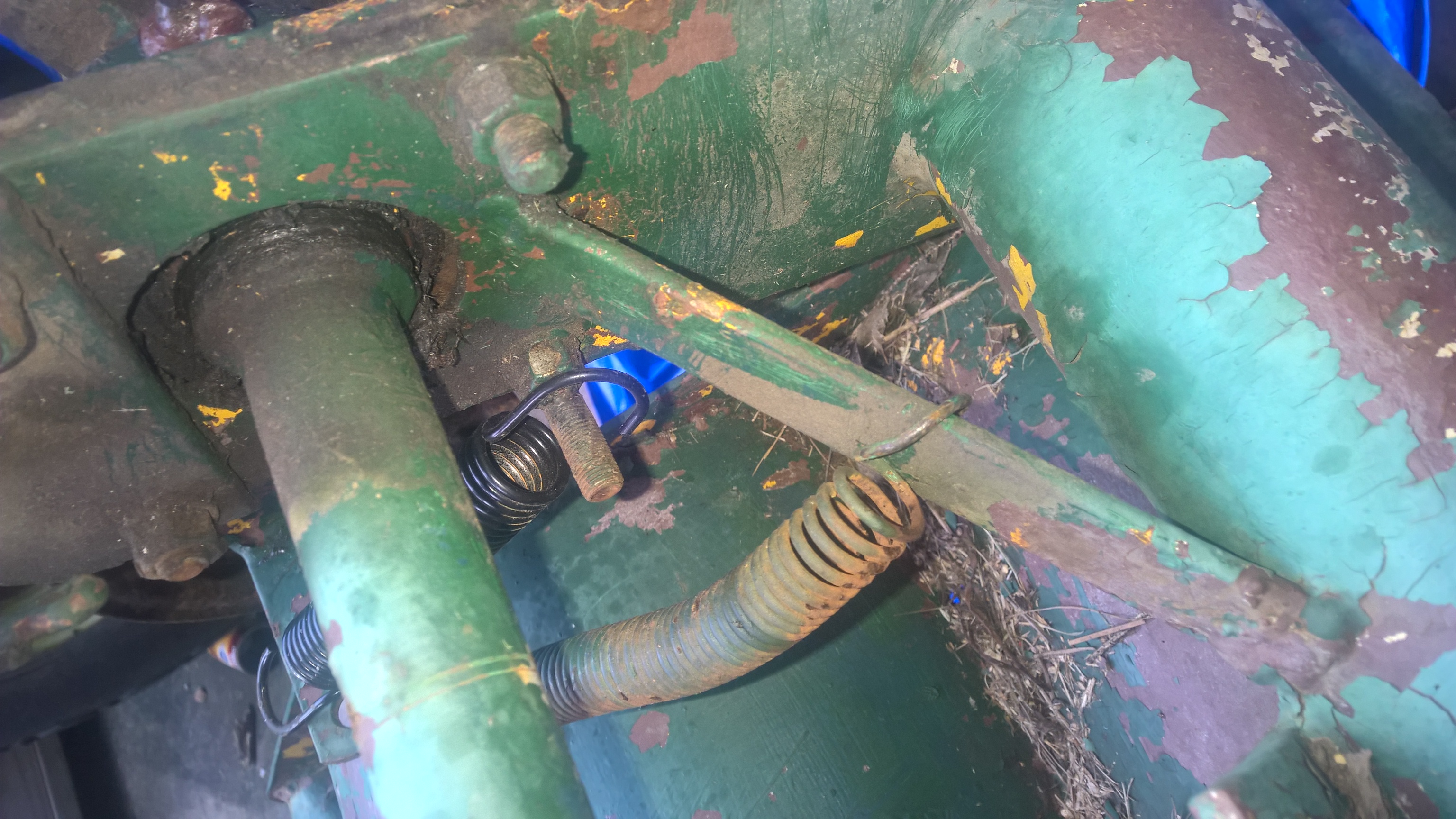

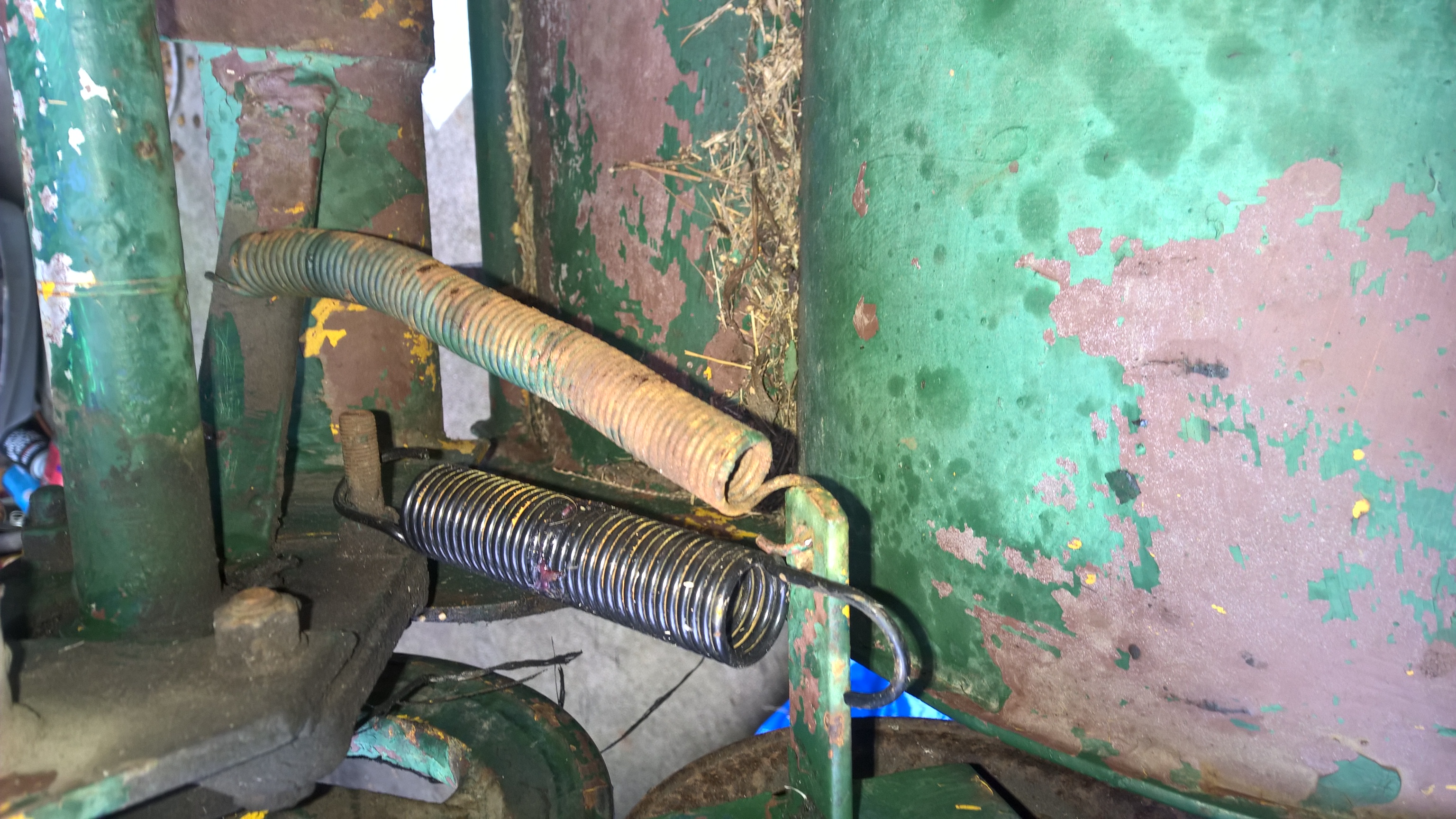

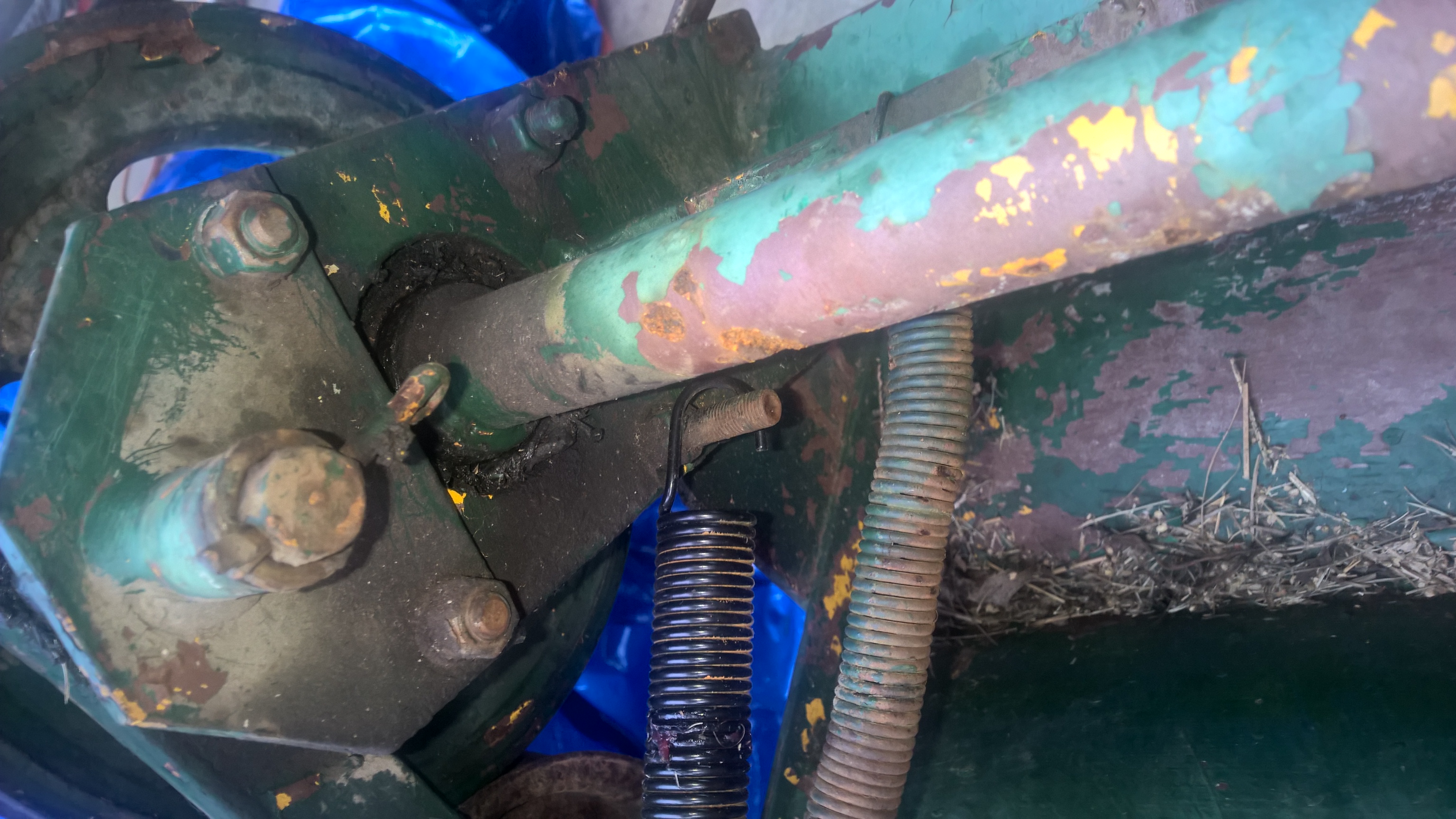

Based on your pics, it appears that you could attach a piece of bar stock to the end counterweights. Since you plan to use the heavier flails, a little more offset weight on the end might not be a bad thing.
As the grass wraps around the end of thr rotor, the pressure pushes it sideways through the OD gap of the seal washer. The piece of barstock on the rotor prevents the grass from wrapping into the gap at the end of the rotor.
The bearings in your pics are shielded. I don't think that seals will survive in this application.

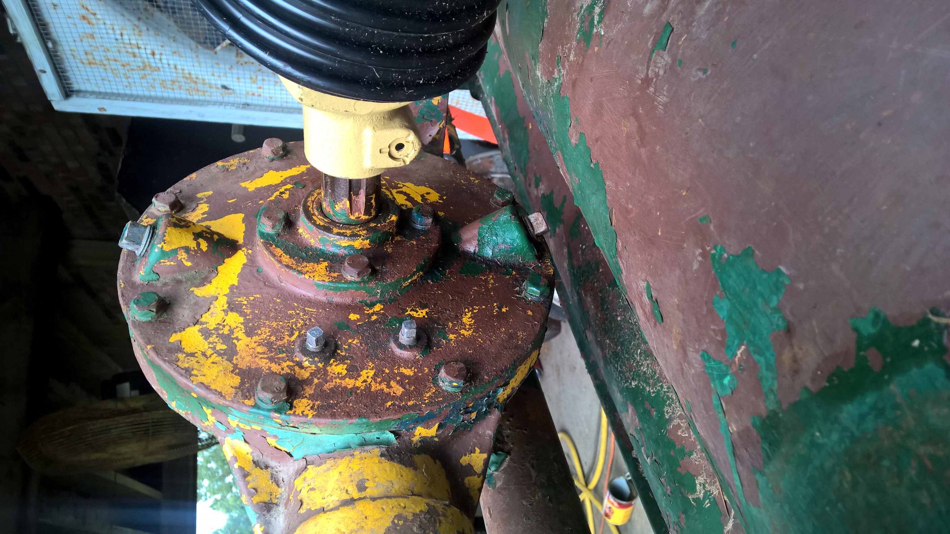

Hi Thibodeau,
I'm glad to hear that you're making progress on your tractor. That financial damage on the bill for the rebuilds seems reasonable, hopefully you will be up and running again soon.
I am leaning towards a solution along the lines of what you suggest, I just don't think I have the clearances to do much else. I just don't want to make the rotor unbalanced and create other problems because it ran extremely smooth.
It rained all day here. I have not had a chance to purchase the new bearings yet, hopefully tomorrow. I was going to replace the outboard bearing on the extension shaft at the upper pulley, but I did not realize it was a flange bearing mounted in a housing and sold as one unit. It's not cheap from what I can tell. I have seen bearing inserts for this bearing which are cheaper, but I don't know how hard that is to do or press in compared to a regular bearing. I have not pulled the bearing housing off yet to inspect the bearing to see if it's worn, it may be ok. I was just going to change it because I figured it was probably the same 206kl bearing as on the shaft.

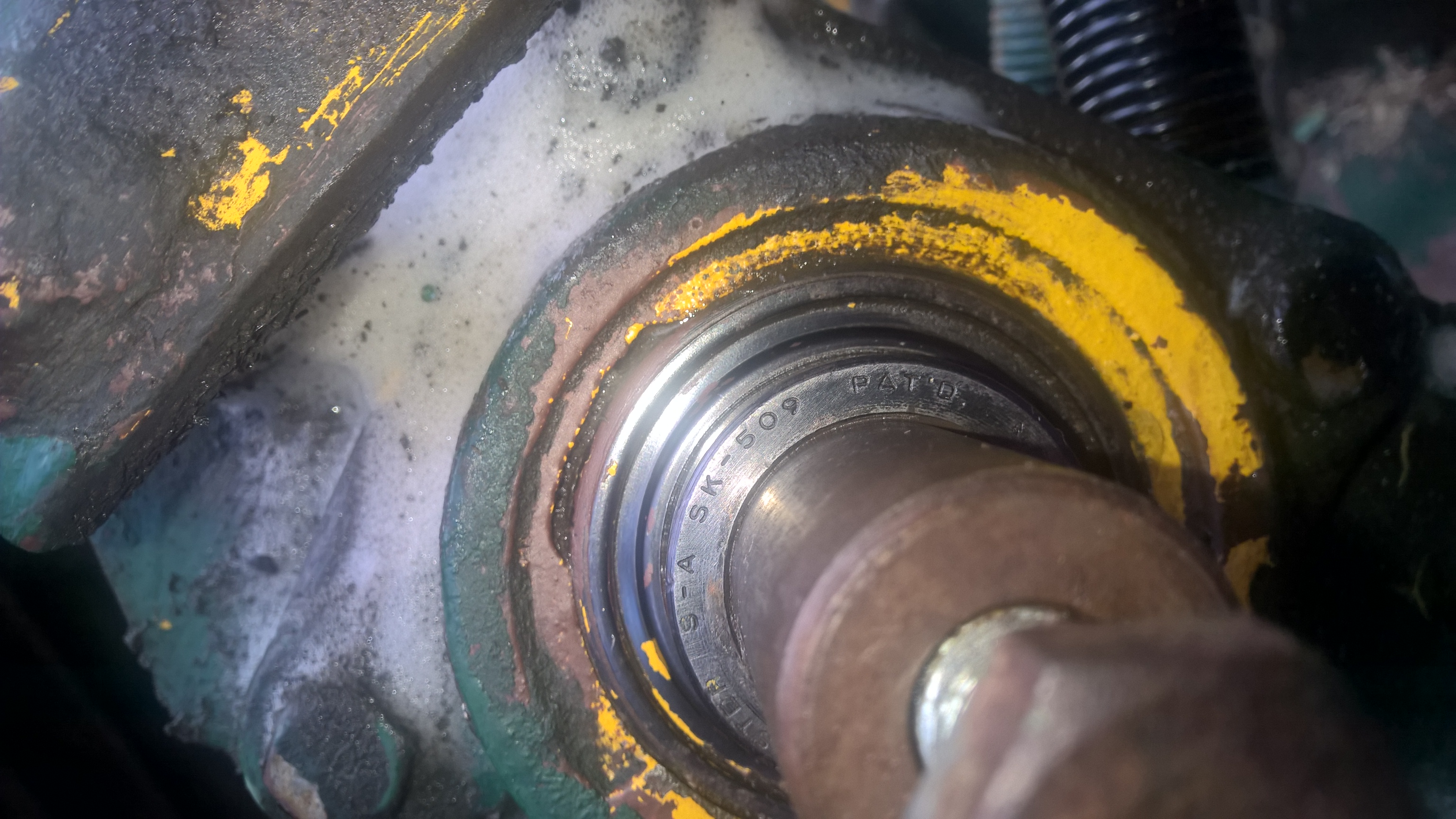

It is instead a Sealmaster S-A SK509
Also, I'll attach a pic of the gearbox to show the second highest plug that I filled the level to. As well as a pic of the spring situation. Originally, the long spring was attached to the triangular brace/bracket, it was just hooked on towards the bottom. You may be able to see a notch that it made over the years on the piece of flat stock that make the triangle. The spring did not seem to provide enough force.

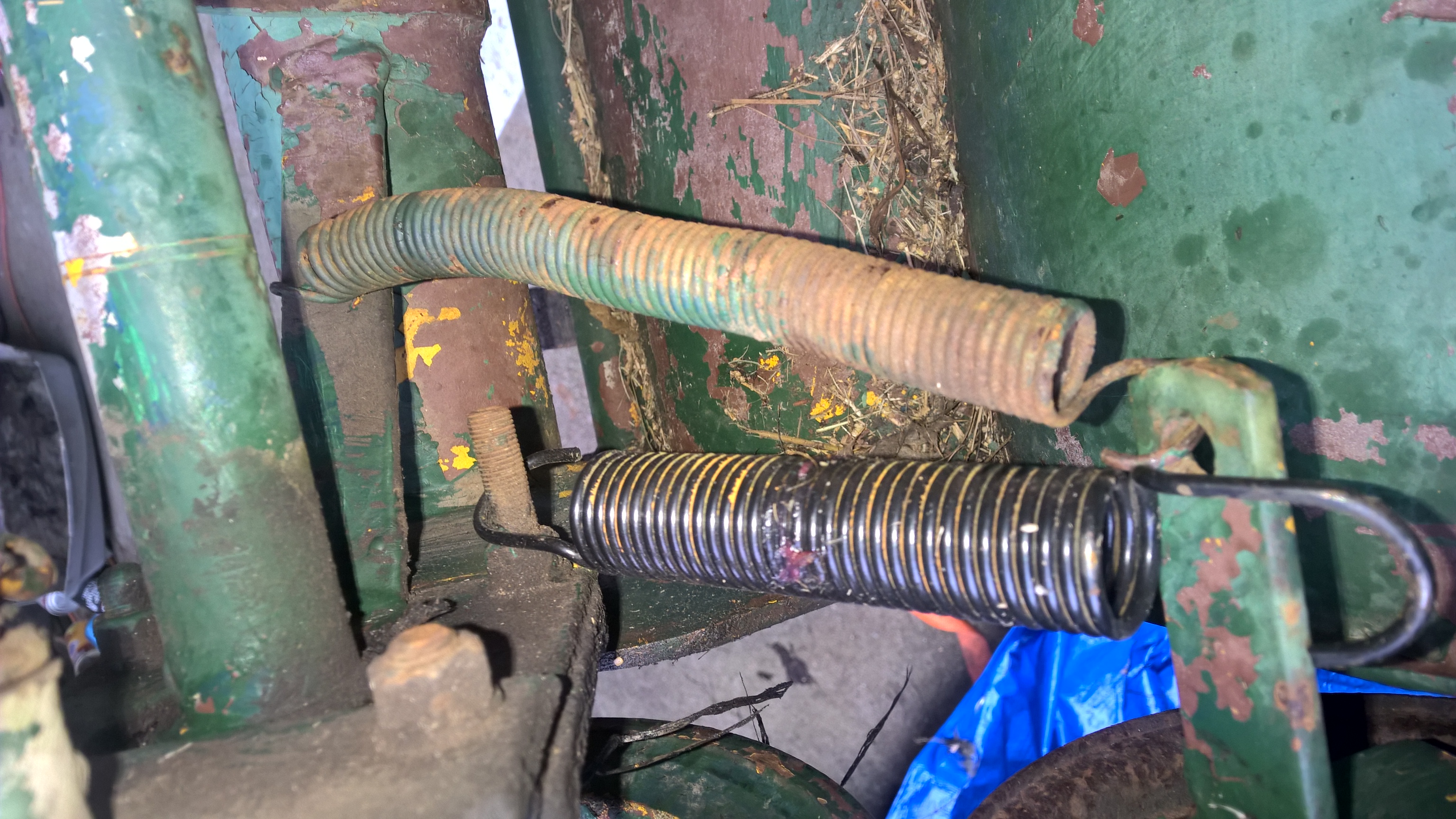

I added a second one, hooking it to the long bolt going through the flange bearing. All three other bolts are shorter, this on is longer and I thought maybe it was intentionally designed that way in order to hook the spring to the bolt, although I realize that is probably unlikely. But I don't see any other points to hook the spring? It seemed to be doing fine with this set up until the grass wrap/belt smoke.
Thanks again for all of the help.

The sk509 is easily removed from the housing. The outside of the race is ground with a spherical radius. Once the shaft is removed, use a punch to drive on the outer race 90° from the notch in three housing. The bearing will roll in the housing, and will lift out from the housing at the clearance notches. The bearings on both of my JD flails attach the same way. Hard to understand at first, but once experienced it is simple. It also makes the bearing self- aligning.
   / Grass getting sucked through the bearings on Mott F5 #29
Forgot to mention you will probably need to remove the housing from the mower frame to give the bearing room to tilt on the back side. In your pic, you would place the punch at the 4 o'clock position and drive the race inward into the housing. The bearing will flip in the housing due the the spherical radius on the outside of the race. The the bearing will lift out at the clearance notches. No reason to replace the housing unless it is cracked.

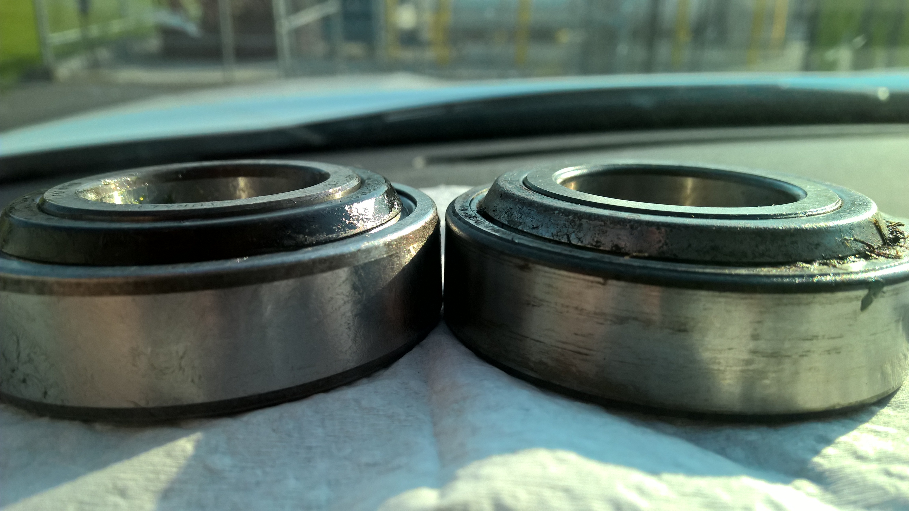

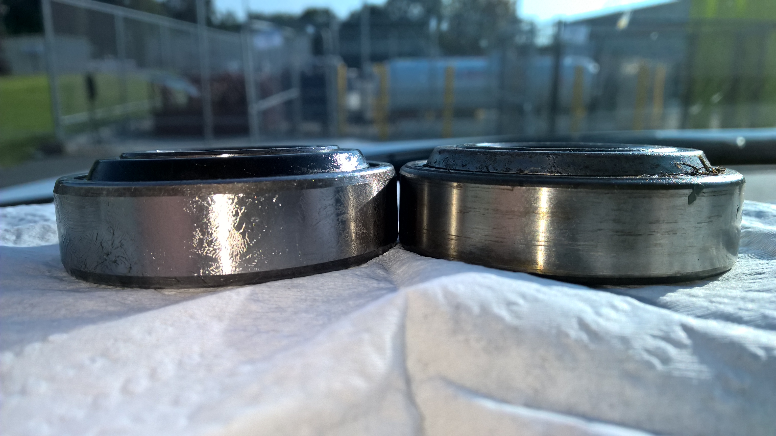

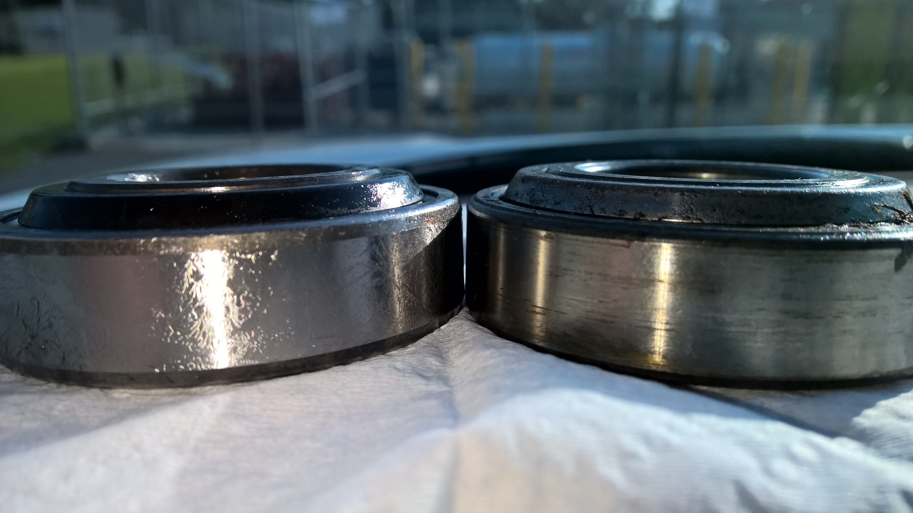

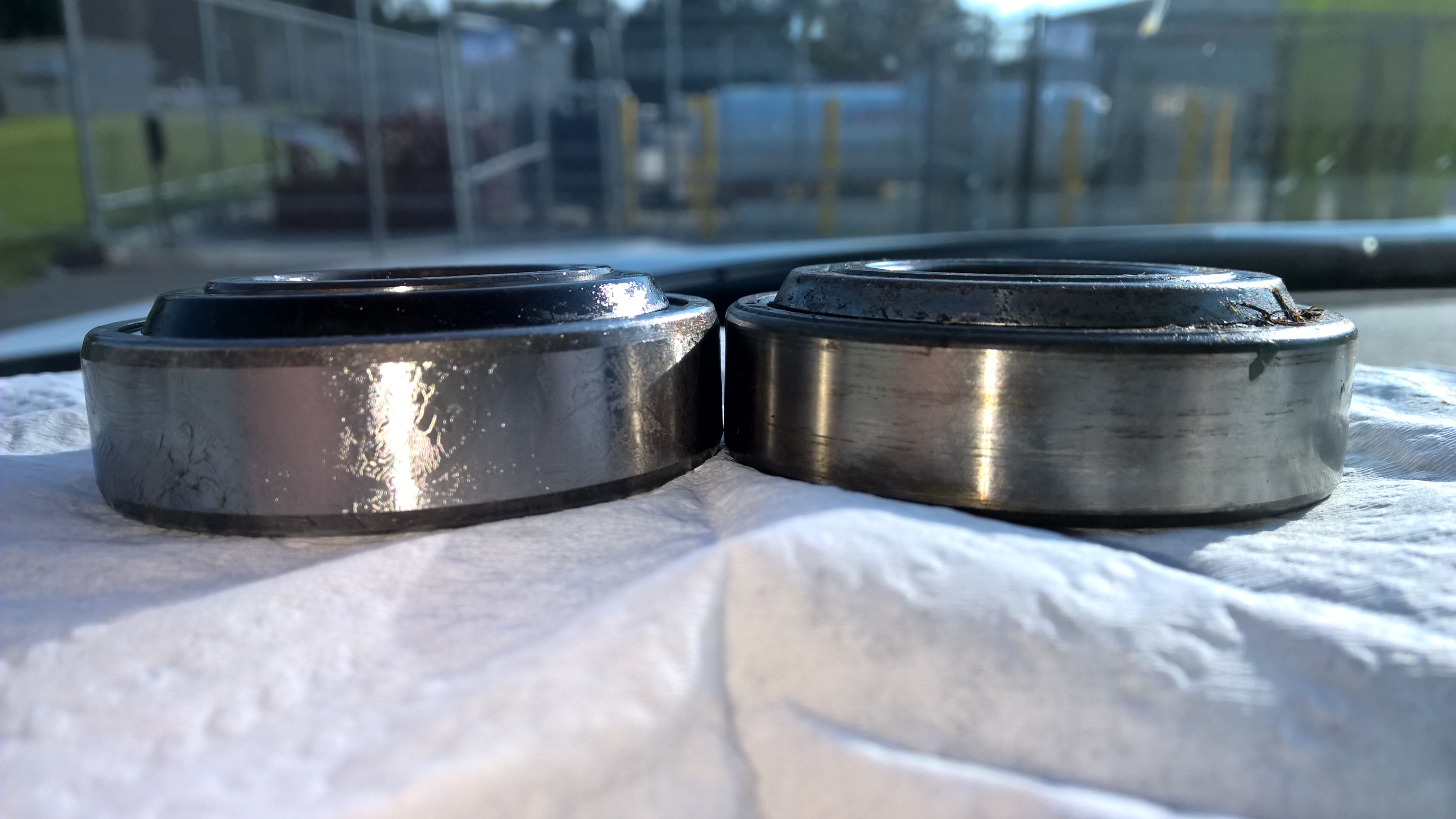

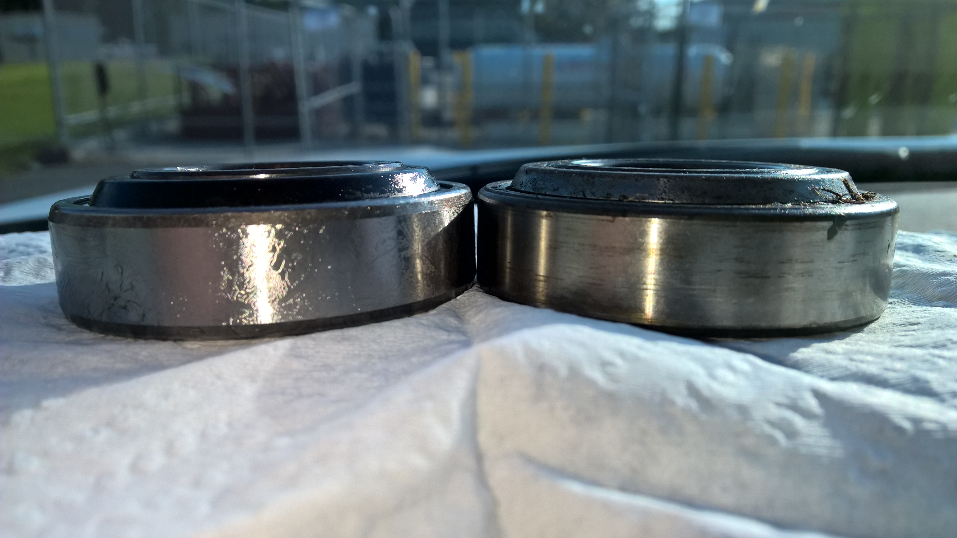

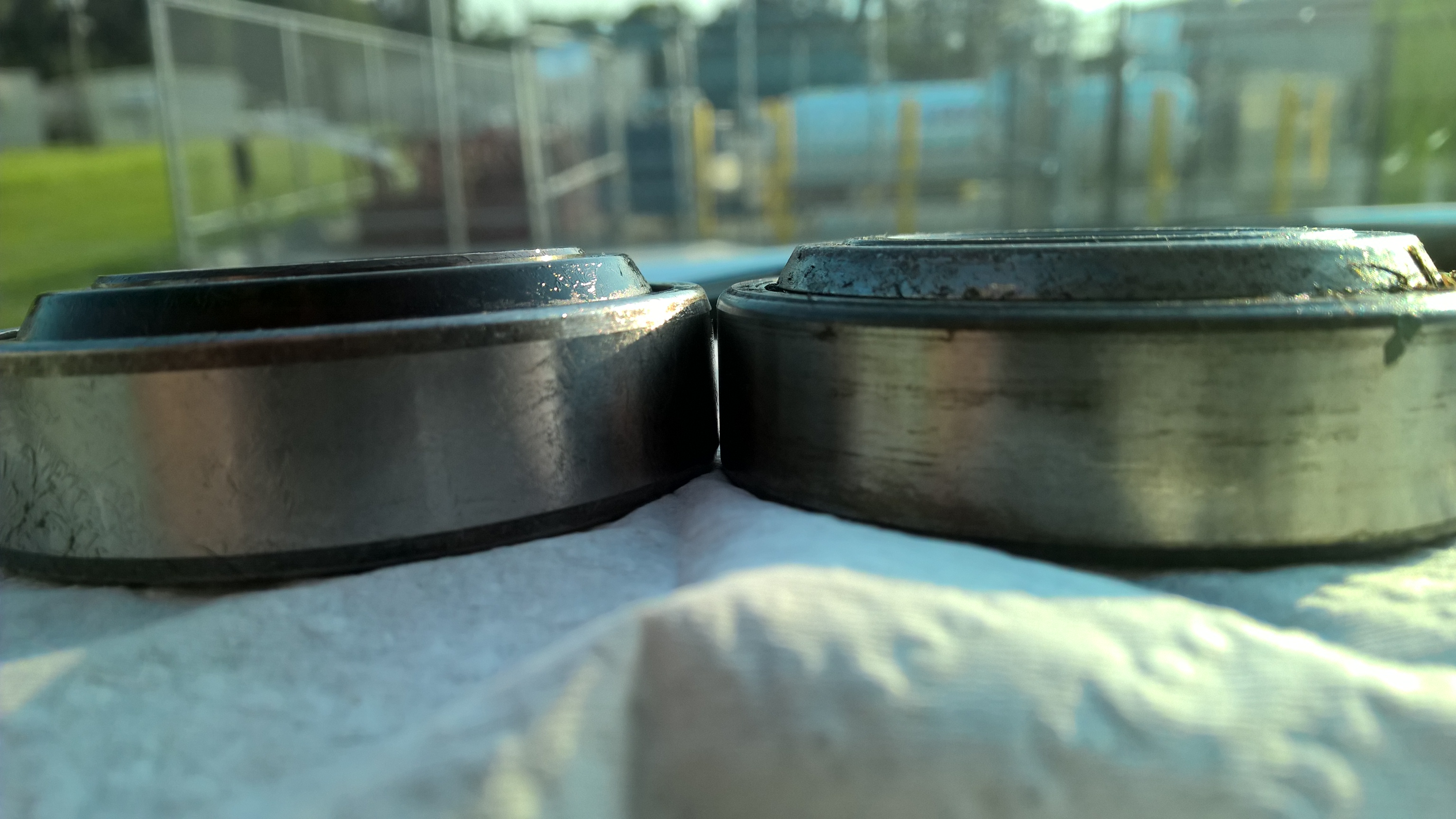

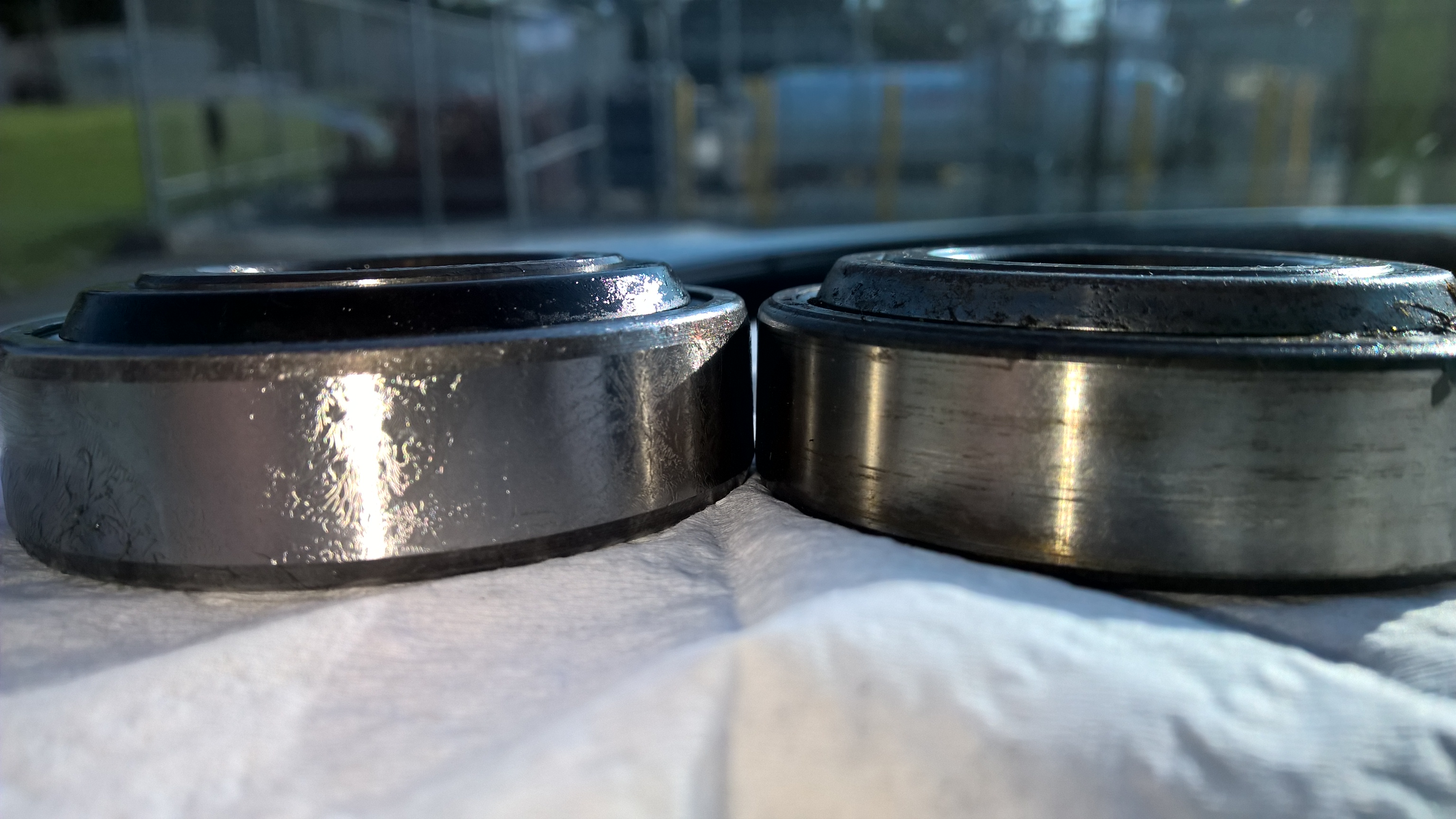

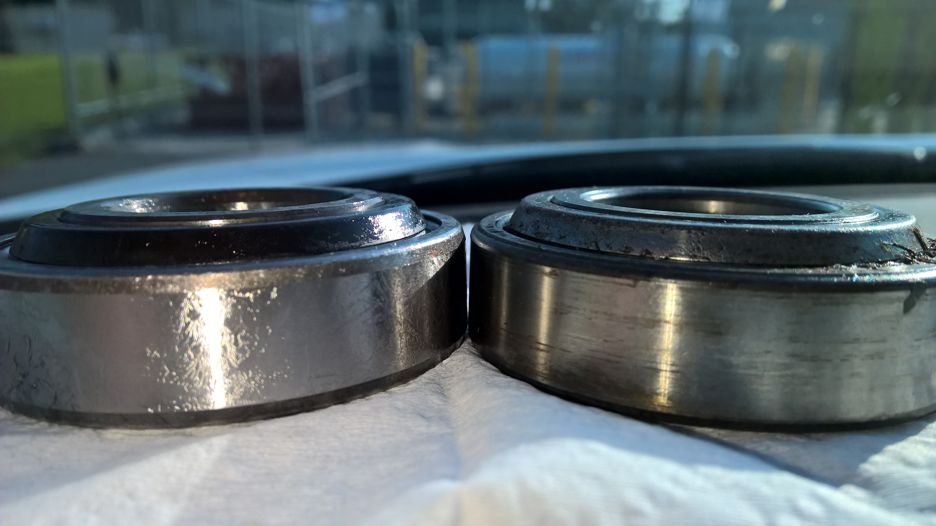

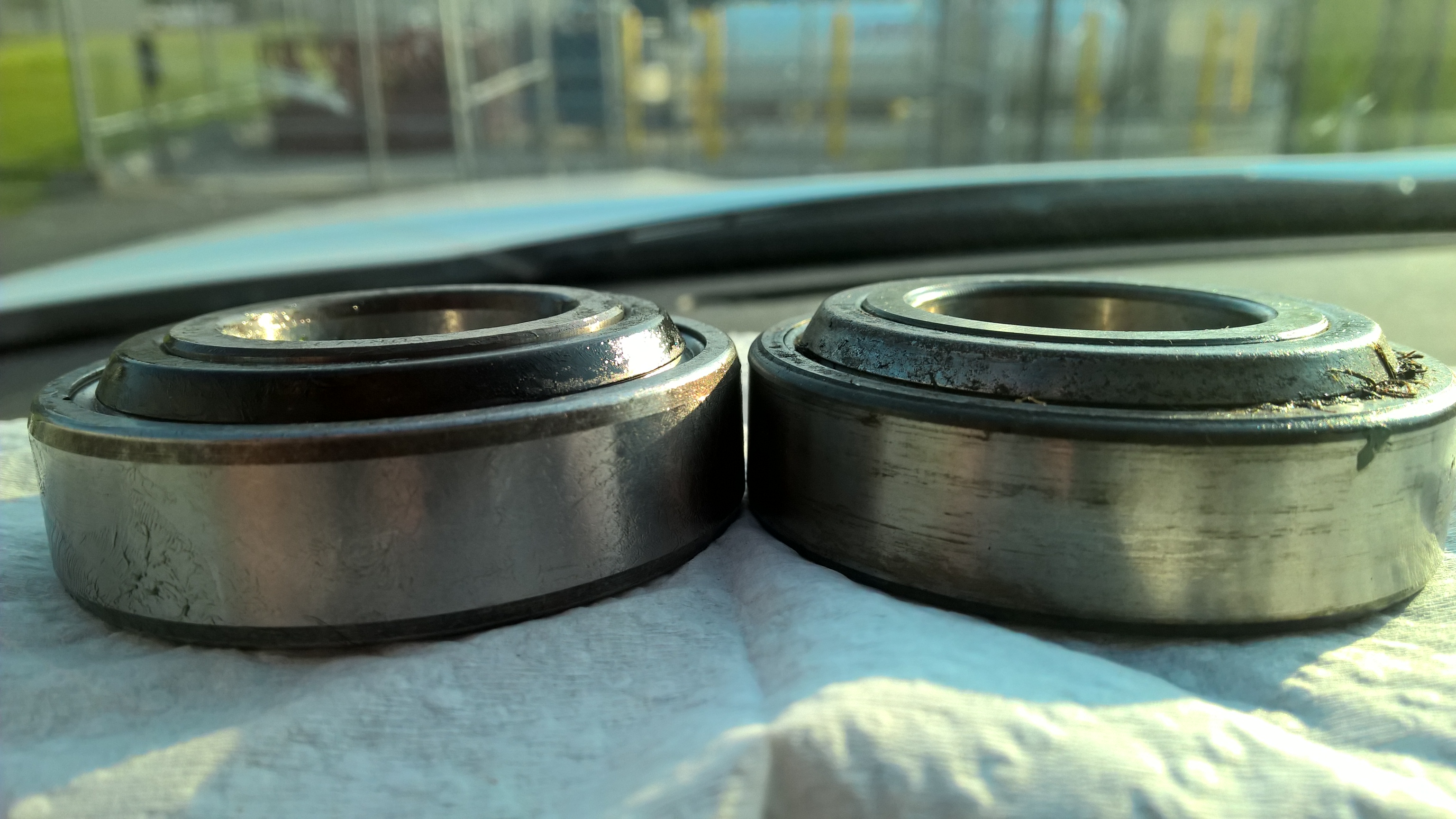

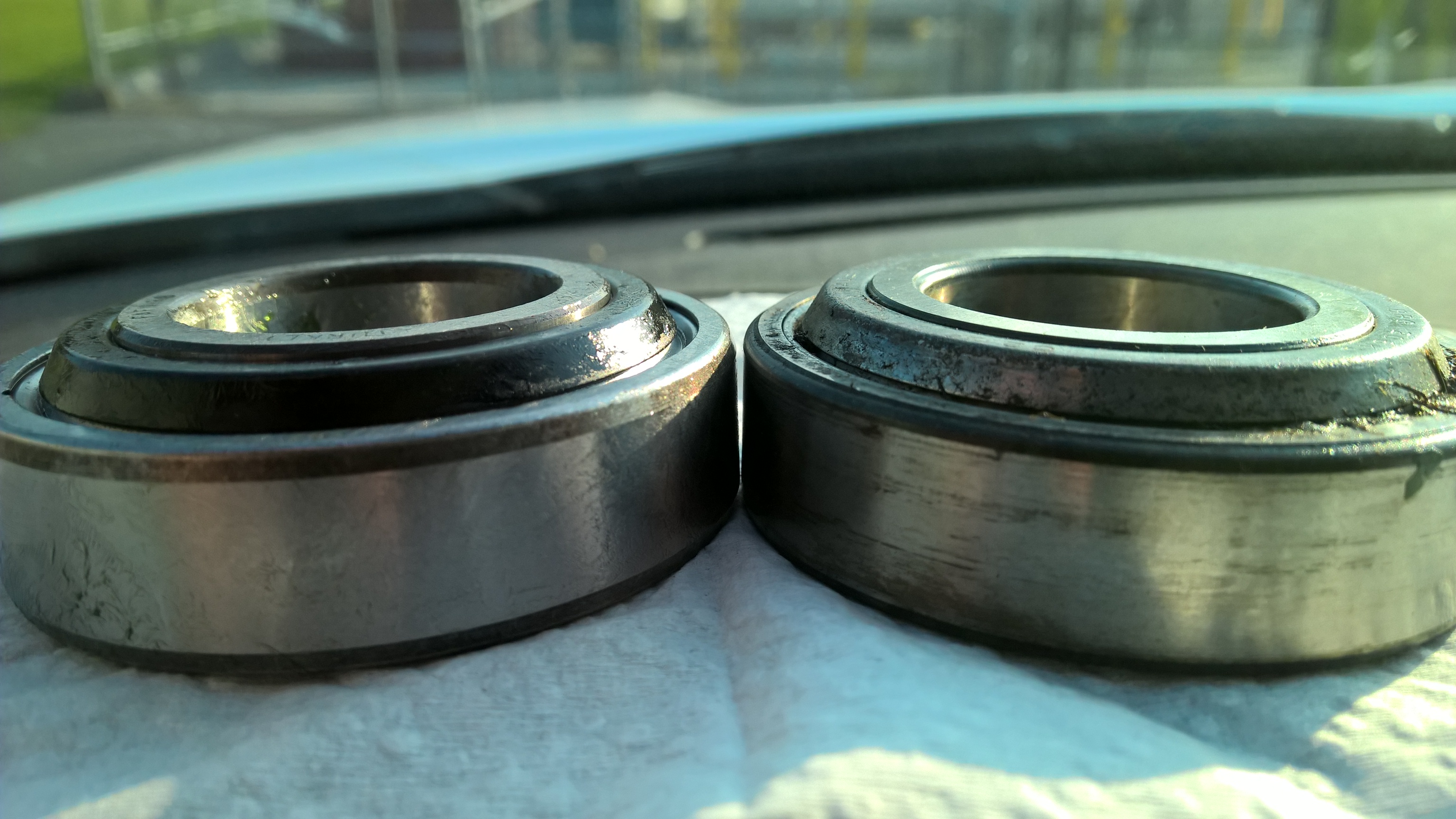

I stopped by the bearing supply to get the new bearing today. The sk509 number of the flange bearing apparently didn't cross with anything that they had or had heard of. I still need to remove mine and check it, I was just going to change it if the price was reasonable for the insert. He said that they would just need the shaft diameter to match it up.
They did have the Fafnir 206KL bearings. They close at 4:30 and were actually locked up when I got there but were able to let me in. As a result of being in a rush, I forgot to ask them if they had a sealed version as Leon suggested. I just handed them my old bearing and they gave me two new 206KL bearings. I will call them tmw about the sealed version because I will probably not have time to put these on tonight anyway.
But when I left, I noticed that there is a difference in the bearings. It is slight, but it's in an area that is critical to the grass wrap issue. I will include some pics. The inner race of the new ones protruded slightly more than on the old ones. Which would in turn push the seal washer and cutter shaft that much further away from the bearing housing collar and open up the gap around the seal washer and the bearing housing collar, making it easier for grass to get inside.
I wish I had looked closer at the original bearings before I pressed them out of the housing. Is it possible that the original race protrudes less because of beating it out of the housing with a hammer? I didn't have to whack it hard or anything, 3-4 taps for each bearing.
Also, the box for this bearing say Timken 206KL, but the nomenclature on the bearing is a little different. The bearing has :
206-L WR Z17 SFA then another spot says Z17-AF TURKEY
The back of the inner race says 206KLZ17P
I realize that the Z indicates one side shielded, but wasn't sure about the rest. And it doesn't mention the C2 tolerances etc. I think I read that post wrong and/or misunderstood it anyway. I thought that the higher the number..C2 C3 etc, the tigher the clearances. But apparently the lower the number, the tighter the clearances. So a C2 is tighter clearances apparently and a C3 is looser. Possibly Mott wanted tighter clearances due to the balancing/vibration of the shaft?
Regardless, I don't know what the new one is rated at, or if it matters??
