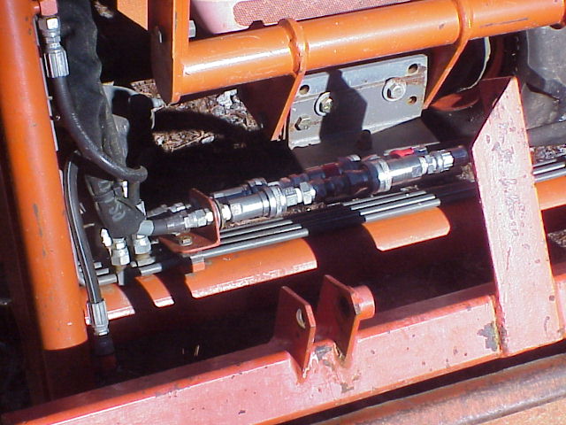

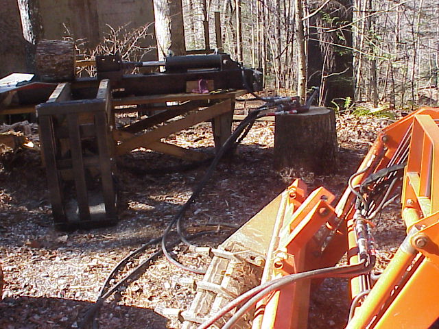

First I am sorry I was not able to get to this point any sooner...but I have been able to reduce some of the mystery...
The Cross two spool valve works both the splitter and the log lift cylinders flawlessly when connected to the K_ubota hydraulics via my grapple remotes with the valve lever in detent...!!! I am going to test the Prince two spool using the same just to be sure that both the two spool valves are both in working order...(pics below of the Cross valve setup)
Now that leaves two questions...is it something with the original single spool valve that is different or is there something in the DW circuit??...All three of the valves (both the original single spool and the 2 two spools) have fluid running through them when the DW is running...
At any rate I am working on ordering what I need to try and use the backhoe ports to run the splitter/lift...

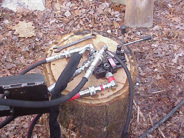

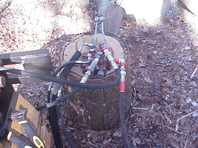

The 2- 20' hoses connected to the grapple remotes:
The Cross valve:
Overall view:

well, at least you know its not the valves. Something dont look right with the connections in this picture http://www.tractorbynet.com/forums/...1452543934t-could-air-cause-issue-hookup1-jpg. I assume the hose with the red tape is your pressure hose to the splitter since you said you put red tape on the ends of the P hose. You also said the return went straight to the bottom of the tank. I still feel you had something blocking the return flow. If you have pressure on the red ended hose and the return goes straight to tank, something dont make sense. As long as you have it working thats all that counts, but when the weather warms up, I still want to stop by, and I might just bring my fishing pole.
/ Could air cause this issue???
#88
I can't really see exactly how the end of the return line on the DW connects to the tank...it goes back to about the center of the machine/tank there is no easy access to get a picture etc...but I do know that when I connect the 20' hose (from any of the valves) that I normally connect to the (DW return) line...does pump fluid back to the tank...I tested this by watching the fluid flow back into the fill port (rather than the return line...when the DW is running there is always fluid flowing through the two (auxiliary) lines I have been using...either just connected together or through any of the valves...
BTW...there may have been a fitting with red tape that was just an improvisation to make it as simple as possible to test both the two spool valves without changing out more fittings than required...I'm fairly confident I don't now and never did have anything connected wrong or there was ever an issue with the QDs...(at least after I had checked everything at least a hundred times...!)

When hooked to the K_ubota hydraulics the Prince valve works as flawlessly as the Cross valve...no issues...both cylinders perform great...!
Prince valve:
With both cylinders working fine connected to the K_ubota...I shut it down and moved the 20' hoses to the DW...both the cylinders lock up exactly as they have been...
...I have a couple of short low quality videos of the lift cylinder both working (off the tractor) and when it's locked up connected to the DW but I can't seem to upload them directly to a post...
Besides eliminating possible causes...I at least got to try out the log lift and am more than happy with it's performance...even with the lower GPM of the tractor...just hope either the BH or the PB ports (on the DW) will work with one or the other of the two spool valves...
