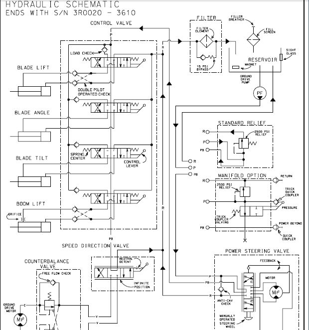

You don't by chance have the schematics for the DW Hydraulics? What model is the DW?
Kim
I think this is the correct one...this image does not show the trencher hydraulics...it also does not include any auxiliary circuit...
The P, R and PB are there but not the auxiliary port on the manifold the backhoe is currently connected to the P and R ports shown on the schematic...

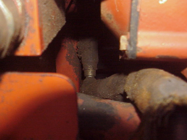

About the "something" I mentioned after this morning's experience with the "return" line...here is the best I could do to get a pic (without rigging up a klieg light!)...of what the original return line (or at least was originally connected to the tank/return side of the original valve)...is connected to before what I believe is a T at the bottom of the tank...The pic shows what I have been referring to as the auxiliary return line as per the way it was connected to the original auxiliary valve...I pulled the abrasion shield back as best I could...This may be entirely irrelevant and the pic may be of just a typical #10 ORFS connector??...here's the pic:
Something else that may or may not be relative is that the line of the connection in the picture (end that can't be seen) has some free movement at the (T) end like it is connected to some type of swivel pressure fitting...there has never been any leaks there and I have only noticed the movement when connecting to the line...
...This is the same line that was deadheaded this morning (again, the same line that was originally connected to the tank/return port of the original valve...FWIW...

Is that all you have?
Not all...is there a particular section ?...I have nothing that shows the auxiliary circuit...as for changes in years etc. for a 3610...what I posted matches my machine the closest...
FWIW...When I got this machine it came with another auxiliary circuit that did use a two spool valve...it was installed in the BH circuit (from this two spool valve's PB to the BH)...one spool controlled the front blade (up/down) and the other spool allowed the operator to creep forward or backward through the hydraulic ground drive (depending on the gear transmission) from the BH station...The point is...I can't find any of these auxiliary option ports on any schematic etc...there are also (capped off or plugged) OEM ports all over the machine for different option/auxiliary attachments/applications etc... but none of them (ports) appear on any of the schematics I've found...!

So, are you connecting to the "Manifold Option" ports?
Aaron Z
No...the (auxiliary) ports I have been trying to get a two spool valve to work on is not on the schematic (or any I've found)...
...See the second pic in post #49...what I have been using for a pressure line is marked with a band of red tape...it comes off the manifold between the pressure and PB ports...

After re-looking at the schematic...if this (circled in red) is the port I have been using as a pressure line it may answer a few questions ??

/ Could air cause this issue??? #113
Kind of looks like a QC that is not plugged all the way on doesn't it?
#114
What it looks like to me is a typical ORFS connection...but what is interesting is while the connection in the picture is rigid...there is some free movement at the other end (where I can just barely see) appears to be a Tee (previously mentioned)...this is the interesting part...the movement is such that it would surely be leaking if pressure was not preventing it when the machine is running...but this is the same line that was originally connected to the Tank/OUT port on the original single spool valve...
