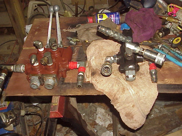

Below is a pic of the original and the Cross valve...they are set up for testing so the configuration of the connection ports may seem odd...all the valves are clearly marked for P/IN T/OUT and plumbed accordingly...

Thank you for the picture. Are the 2 male fittings on the left going to one cylinder, and the 2 female swivels on the right going to the other? If so that looks good (other than the teflon tape). If the red tape is on the supply in, then that's good too. What's going on with the back to tank side? It looks like a tee there? You want to avoid using galvanized pipe in hydraulic systems because it can shed galvanizing and damage pumps and valves.
Teflon tape is not recommended because of stray tape clogging suction screens, filters, and it can cause problems with valves sticking. If you leave the first thread bare, it won't be a problem until you take it back apart and reuse it without getting all the tape cleaned out. None of that is causing your problem though.
Kim
There are no T's...I did use one galv. bushing (low pressure side) in a pinch for testing the Cross valve all the rest are steel...I am aware of the teflon tape debate and am always careful to hold it back...and when reusing anything I clean them carefully...
The two male fitting are JIC connectors for the two 3/8" lift cyl. hoses...the swivel connectors are 1/2" pipe...I was not using QDs on the lift cyl... by reversing the gender of the QDs on the valve and on the pressure and return lines (20' hoses) I have eliminated the possibility of a mix up...
