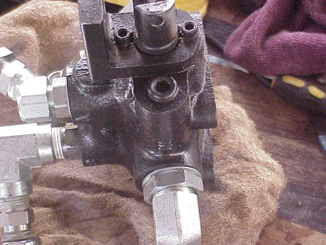

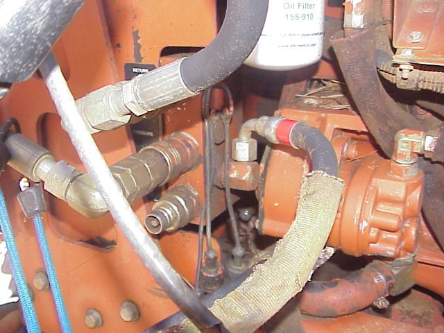

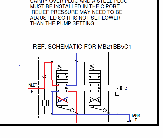

I would also like to see a pic of how the lines are attached to the DW.
I know you said you are 100% sure that the hoses are hooked up correct. And the pictures on the valve do show the inlet and outlet correct (red tape inlet is on the side of the casting with the PRV). But that dont mean its right at the DW.

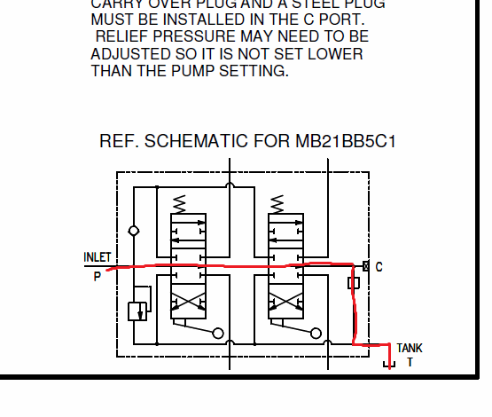

What you are describing is exactly what would happen if you were to try to supply flow in the return port and have the inlet hooked to tank. Because there is a check valve on the pressure port that will allow flow INTO the valve, but NOT out. Its to protect other things in the circuit from flow going the wrong direction when the pump is off, and gravity is acting as your pump.
So if the inlet and return lines are crossed on the DW, with the open center valve, fluid passes through valve (only reversed, flow going from tank port and out the inlet port and back to the DW). But as soon as you open a lever, a passage is opened to allow flow (from tank port) into the cylinder, but wont be able to return due to the check valve in the pressure port.
The single spool may or may not have a check valve. But the diagram of the 2-spool certainly shows one.
/ Could air cause this issue??? #45

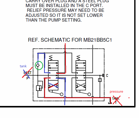

See if this will help.
If you have inlet and tank reversed, with both levers in neurtal there is no issue. Fluid can flow freely from tank to port or port to tank. It dont care which way it flows
The way the valve should work...
And if you reverse the pressure and tank lines
Notice there is no issue supplying the fluid to the working port and on to the cylinder even if it is being supplied from the tank side of the valve. The problem becomes that check valve (circled in green) that prevents fluid from exiting via the pressure port.
This describes your symptoms to a TEE.

As I said, that single spool valve may not have the check valve in there.
If the two spool valve didnt have that check valve on the pressure side, you would be none-the-wiser and everything would be working even if the P and T were reversed. Only thing is the adjustable PRV valve wouldnt work and you would be operating at whatever the PRV of the DW is set to.

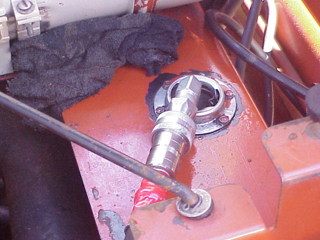

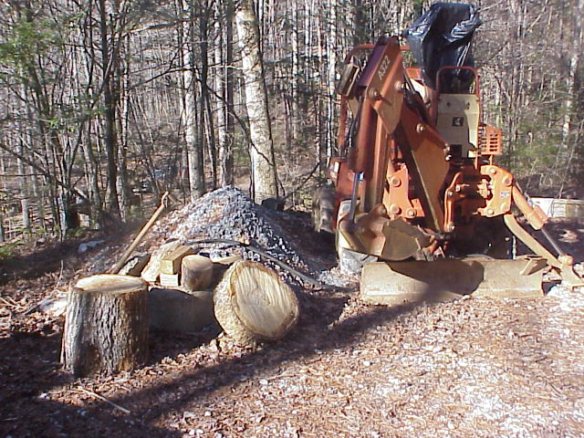

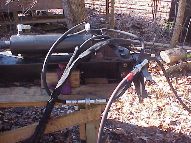

Again, thanks for the time and perspectives...After I post these pictures I will try and make some short videos of what is happening...
...that single spool valve may not have the check valve in there...
This is the top of the original single spool...it appears to be just a plug where a PRV would normally be...?

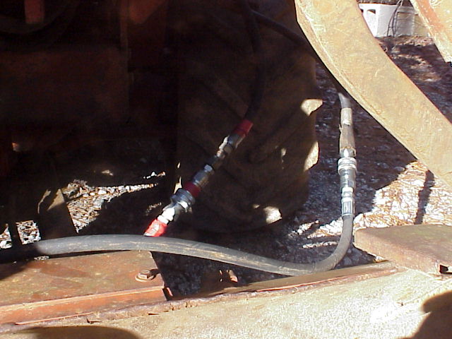

Here are the connections to the DW, (the open bottom QD is Power Beyond) the return line goes to the bottom of the tank:
Here are the QDs that connect the original hoses (they were connected to the original valve on the DW) to the 20's hoses:

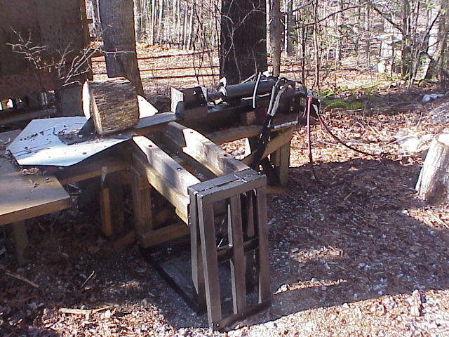

This is the working end:
And a couple of of overall views:

Well if it is indeed pressure, it is clearly returning with valve in neutral.....otherwise the DW would really be bogging down.
So pressure to valve and return from valve is okay. Just wont return when valve is shifted....HMMM
the internal passages to return the fluid from the cylinder to the tank hook direct to the same passage that flows to tank when valve is in neutral. Are you absolutely sure there is no PB plug in there and you are hooked to the CORRECT tank port on the valve?
May cost you a little fluid and be messy, but what happens if you UNHOOK the tank line from the valve, use a bungee cord to pull a lever, and fire up the DW?

Try this,
Put air to the P port and PUSH the lever. Make note of which port gets air coming out.
Now put air in the work port that did NOT get the air coming out, and move the lever same direction. Make sure it comes out tank port. Do the same thing for the other work port and PULL the lever this time. Confirm that air is coming out tank port.

Try this,
I assume you mean on the original single spool?
/ Could air cause this issue??? #59
No. Do it in the two spool. Basically air test the return to rank circuit
