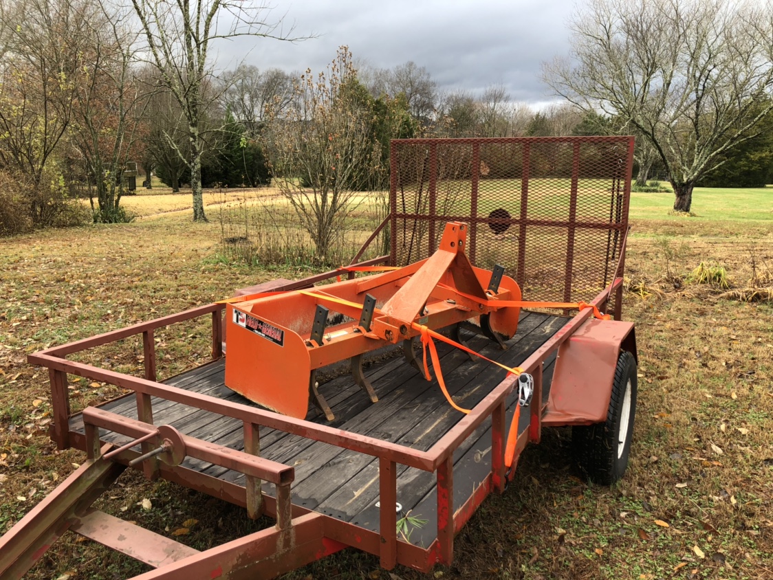

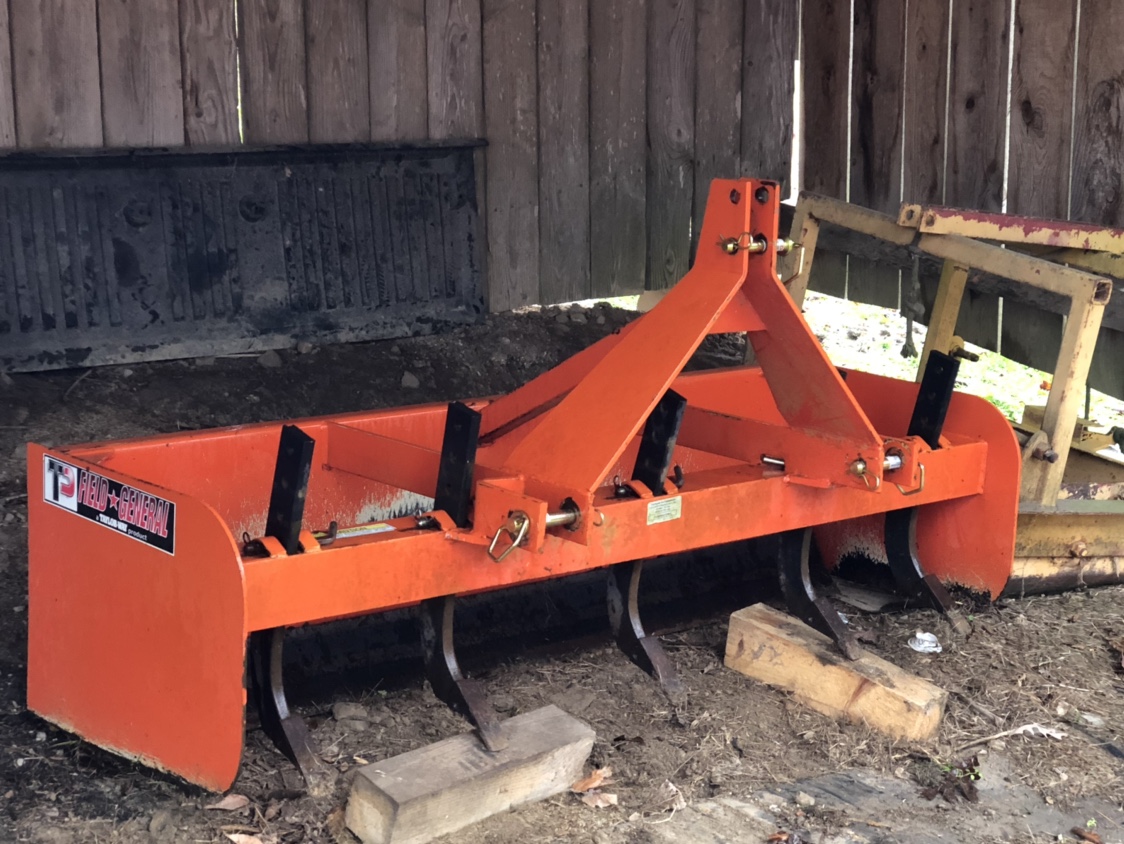

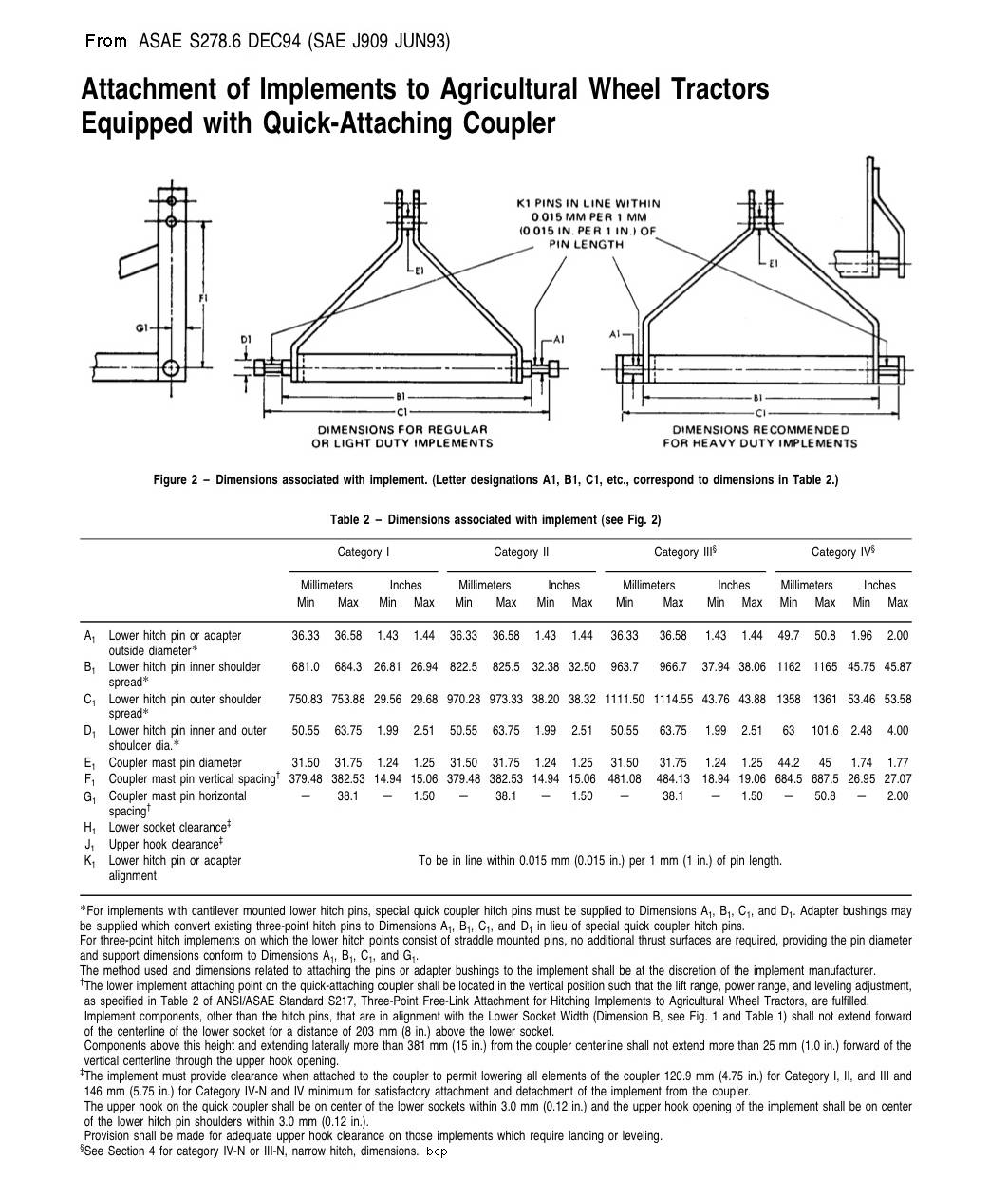

Can I set this cat 1 box grader up to work with a cat 2 quick hitch? I’ll be using it with my Kubota M7060.

Not likely. Further, the 7060 is capable of turning that box blade into scrap before you can get your foot on the clutch.
/ Converting cat 1 to cat 2....box grader #4
I agree with RickB, way to small and light duty to be using behind an M7060. Save yourself the hassle and frustration and get a unit that belongs behind a tractor of that size and capabilities. ;)
/ Converting cat 1 to cat 2....box grader #5
If the width is right just slide on bushing over the cat 1 pins and be happy, you won't tear it up but probably not wide enough

The Cat II quick hitch is the real show stopper here. Of course if the OP has torches and a welder anything is possible.
/ Converting cat 1 to cat 2....box grader #10
Inode, it appears you already own the box blade. Yes, a higher HP tractor could cause it to bend, however, if you watch what you're doing and go slow you can easily determine what will damage it before it happens. Spend $10 and buy a couple of bushing for the 3pt pins and one for the top link and see how it does. CountyLine Category 2 to 1 Lift Arm Bushing at Tractor Supply Co.

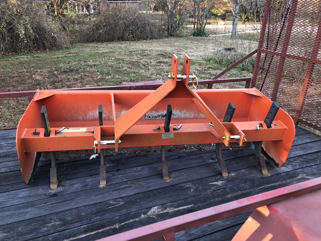

The box blade was given to me. I thought I’d use it before purchasing a class II. The blade is 5.5’ and my m7060’s rear tires sit at 6’ in width. In moving it around, I’d guess it weighs 500-600 lbs. I had been looking at a Land Pride BB3584.

Unless you are going to do a lot of grading it will do fine
/ Converting cat 1 to cat 2....box grader #14
Take it easy, keep throttle down, and what you have will work fine. Just take your time. Enjoy. Merry Christmas
