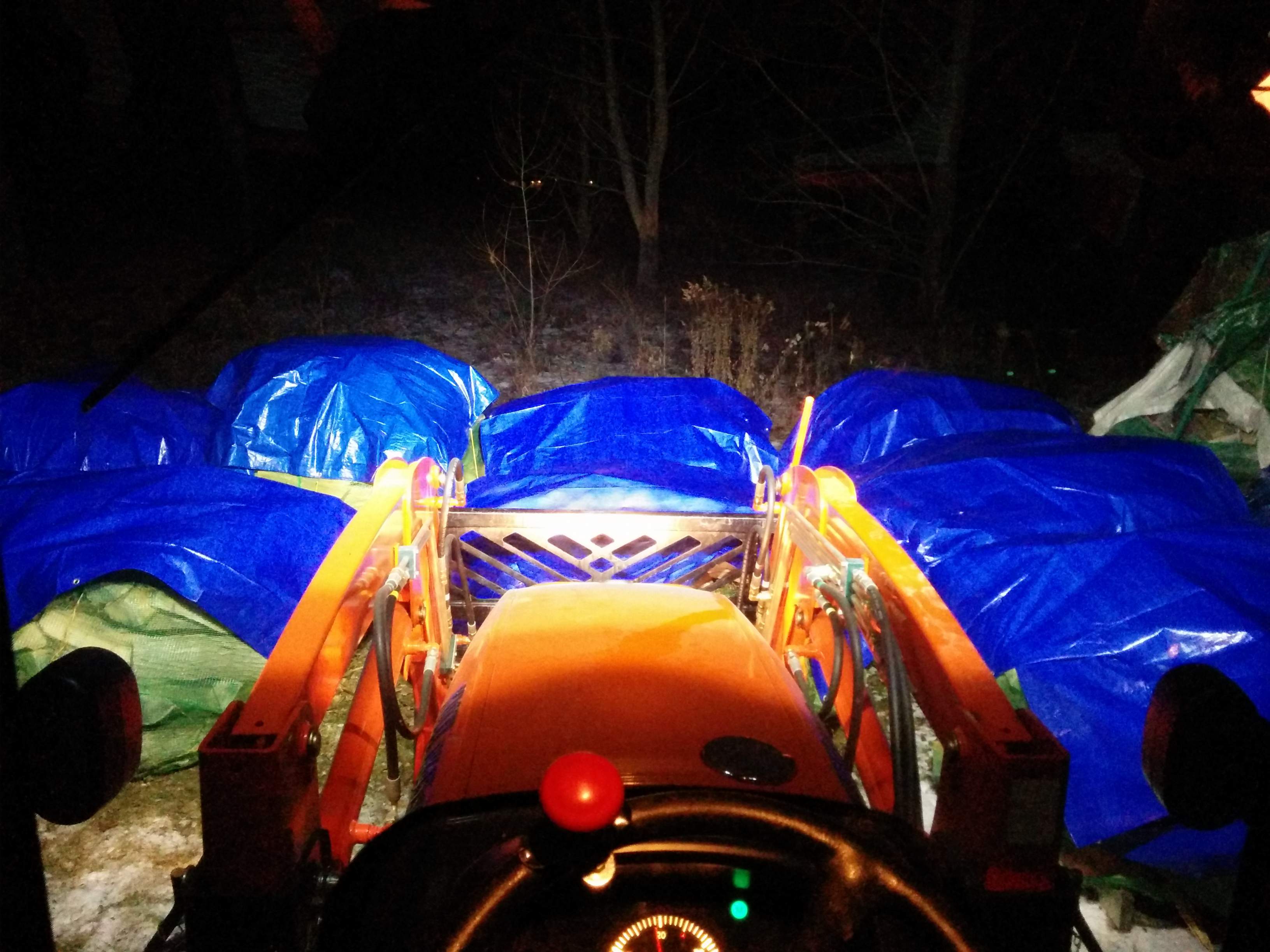

6' X 8' on sale at CTC for $2.99 today, I'll pick up about 10 of them tonight.

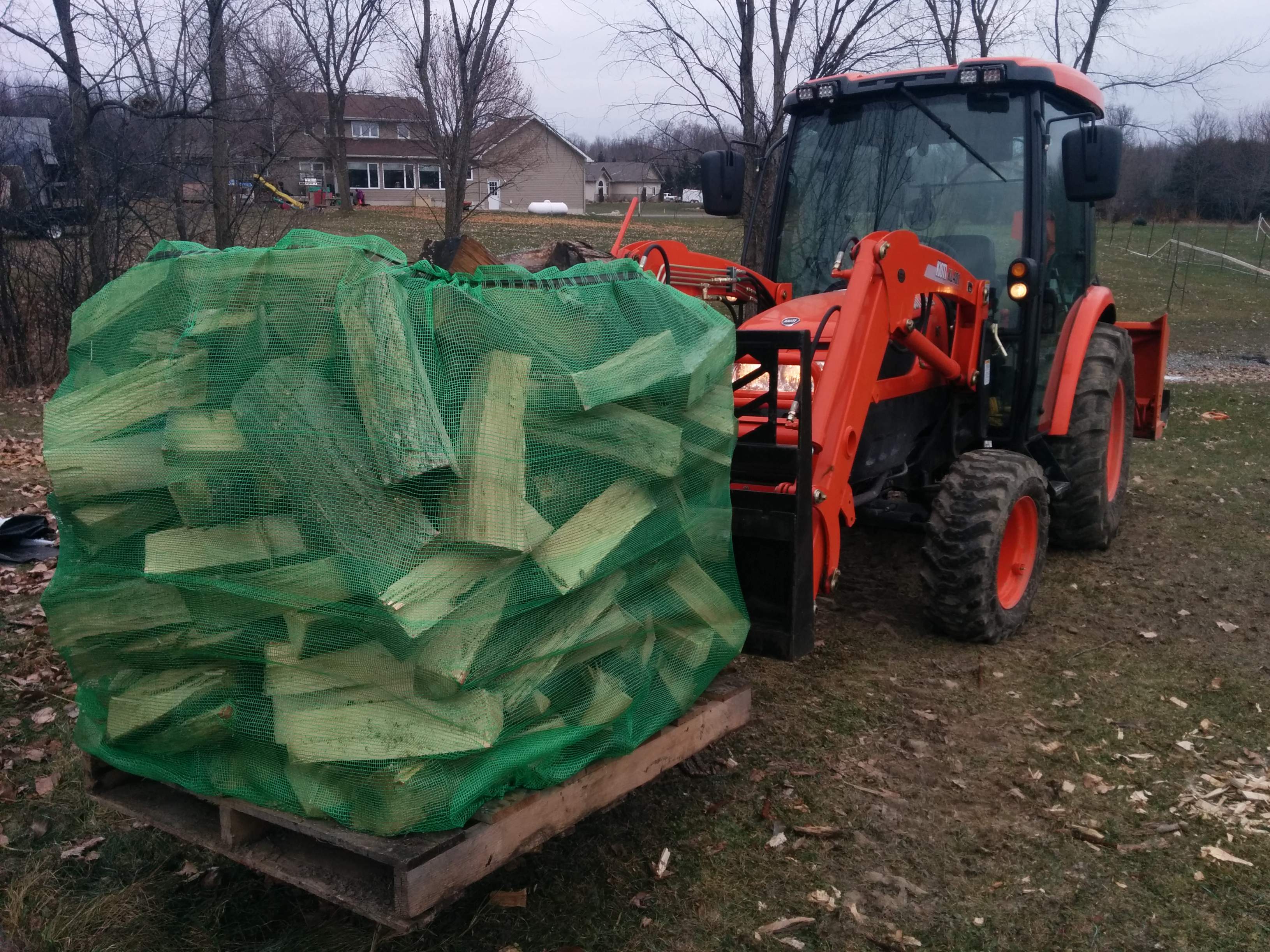

I call to order, no online shopping option I know of. They are sold in lots of 200. The first time I bought bags he was good enough to break a lot and sell me 50. The second time he sold me 100. I'll likely buy more this year or next but will be buying a full lot. It sounds expensive (heck, it is expensive) but if you look at an extra $3.50 per face cord, it's not too bad. I pay about $35 per face cord to block and split my own vs $120 per face cord if it's cut, dried and delivered, so it's easy to justify that cost.
Thanks, I actually dont' think it's expensive - heck I was thinking of investing in fabbing multiple racks/cages to handle the 12-16 face cord we burn each year, so this is obviously cheaper. Although it does hurt to have have to buy a lifetime supply of bags!
I think wet, I'd have to lift those with a 3 point fork, but I think the bucket could do them dry? Am I crazy thinking that?

I don't think an L2250 will be able to lift a bag full. Unfortunately, the bags have to be full, so I don't think it's going to work. You need to have more than 2000# lift to do it, my CK30 with about 1300# lift wasn't even close.

How come they have to be full? Couldn't you just twist them off and tie with a wire?
I'm pretty sure our manual says there's slightly over 2000 lift with the 3 pt. A quick search of the internet says 1875#. Well, going back to my earlier thought then, 2/3 of a face cord...
We generally don't process much green firewood. Standing dead, or laying tops from a friend's 5000 acre spread. I only mention that, because the weight of those pallets will change alot with the moisure content....
Your supplier had this bag which holds approx 1/3 of a cord - should then be under the 2000lb mark.
Anything like that would work so long as I can lift it.

If they're not full, they fall over or spread wider than the pallet and spill over the sides. Believe me, they have to be full or it doesn't work and even then, you have to worry about them slumping over time. The bag in your picture is 1/3 of a full cord, which is the same as one FACE cord and is the same as what my bags hold. Those ones are just a different style, heavier material, reusable and more expensive. I'm not sure 2000# lift will cut it but I'd guess it's an absolute minimum. When you're lifting something that far out in front, it's a lot harder and you need a lot more lift. My tractors will lift 2700# to full height and almost 4000# of break out force. I can only lift these bags with the snowblower on the 3pt for ballast (about 1500# + my tires are loaded) and the rear still feels light and I often need 4 wheel drive.
I have 48" pallet forks. Notice you can't seen the ends of them poking out of the pallet in the picture. The pallet is 50"+ in front of the FEL's rate lift point

Nice stack
Looks like the stacks the guy delivers around here. He crosses the crosses the corners so it holds nice and square. I like the tarp for a hat. lol.
Get the cheap PA tarps when on sale. IIRC the white really cheap ones are something like $3 or 4 each.
If you watch the sales, you can find them at TSC or Crappy tire that cheap too
HF has a coupon for a free tarp. No purchase necessary.
Best I found was 6' X 8' for $3. Bought 10 of them and 80 mini bungee cords. I only got 8 pallets covered, but that should get me through till the snow is almost gone. These tarps are a little too big I think, 4' X 4' would be a lot better, I'll keep my eyes out for them. I'm not stacking the ones with tarps, pretty sure that would destroy them

I guess the bag being in the bed of that ranch cart threw me off - I mean, who would believe they can handle 2000+#!! I was thinking those bags were less than that. I think you understand what it is I'm looking for, a bag that holds from 1/3 to 2/3 a face cord. I'm pretty sure I can handle 2/3 face cord pretty easily, low to the ground. Certainly with a 3 pt fork, but we would need a taller wood shack to get the tractor that far in. I could reach in with the loader and forks I'm pretty sure.
My tires are also loaded, and we have a stout box blade always on. Dunno what it weighs, but I've been considering building some structure on there for additional weight for dragging the driveway. Loader breakout for BF400G loader is 1650# and 900 lb lift to full height.
Is the breakout number based on stall of the hydraulics, or is it the point where the rear end comes off the ground? Lift ratings typically with unloaded tires, or loaded tires? We don't have a manual for the loader, I've thought about buying one but they are about $30 on ebay...
Maybe the answer for this tractor is to build some pallet-crates that will hold loose wood around 2/3 face cord, low to the ground, and see if I can manage them. That would be a good size for the garage as well. At least I could get an idea of what is manageable.
