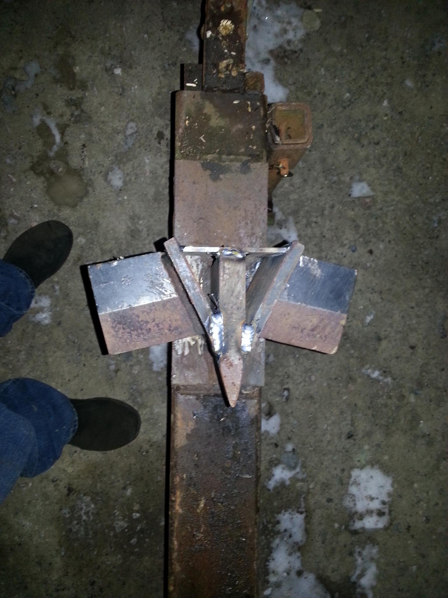

Hard to see in your pictures, but one thing I learned with my crosswedge setup, is to have the secondary spit (horizontal) happen further back than the primary (vertical). I just rebuilt my setup from a drop on from Northern Tool, to a permanent welded setup. It made a HUGE difference in how it works!
This lets it get good and popped in the Primary direction before it loads the hydraulics again with the Secondary direction.

my horizontals are back, just not as far as Id like (design screwup on my part).
Yours seems to work well
