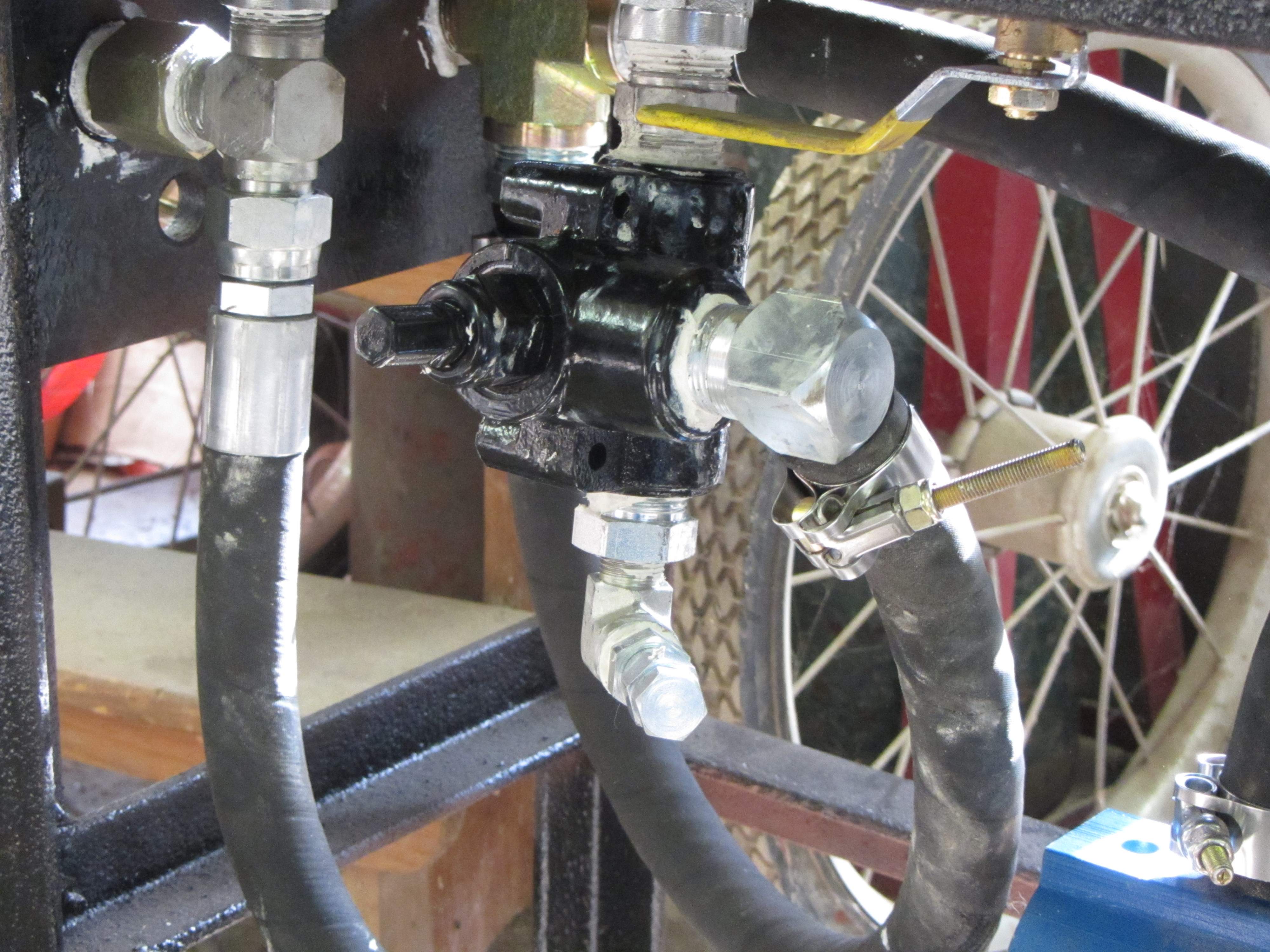

You may not be aware, but the retract detent should be 300 PSi under relief, with the forward detent 200 psi under that. I found this out after i was screwing with it and got it all messed up. So the forward detent was pretty much set right before i messed with it.:mur:

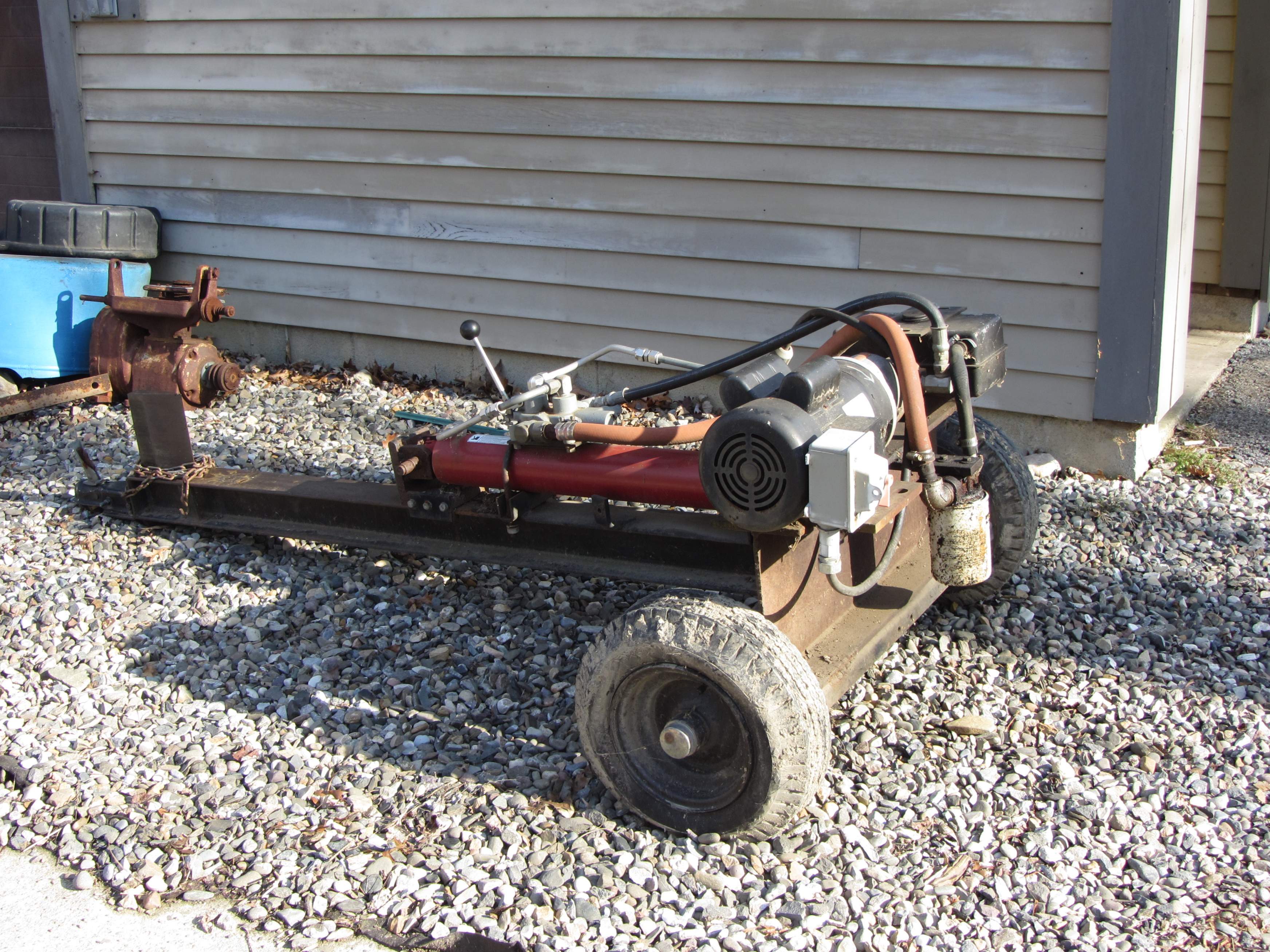

Took a few pics of the adjustment location if you were unaware, and the leak. Dont call the EPA:D
Little Valdez
Oil on punp
Adjustment

Attached is the paperwork for that valve.
I have noticed that finicky adjustment. This is funny. The valve is rated 3000 psi max but the max detent is 2000 psi. Then the actual detent settings are below 2000. I guess they could be raised a bit . Oh I just figured it out, if you hold the handle manually you can reach the relief setting. I did read somewhere that someone set the detents higher and blew out the seals.
" but the retract detent should be 300 PSi under relief, with the forward detent 200 psi under that" under should be over
I think you have this a little confused or maybe it's me
Relief 2 200 psi higher than relief 1 and 300 psi below relief So if relief is at 2000 than detent 1 which is retract is 1500 and relief 2 is 1700. The net of this is that the ram will stop at a 1500 psi spike. As you said maybe when it heats up the spikes go away. I am still confused as to why it just stops and does not retract when spiked. I guess it's all in the detent springs and ports.

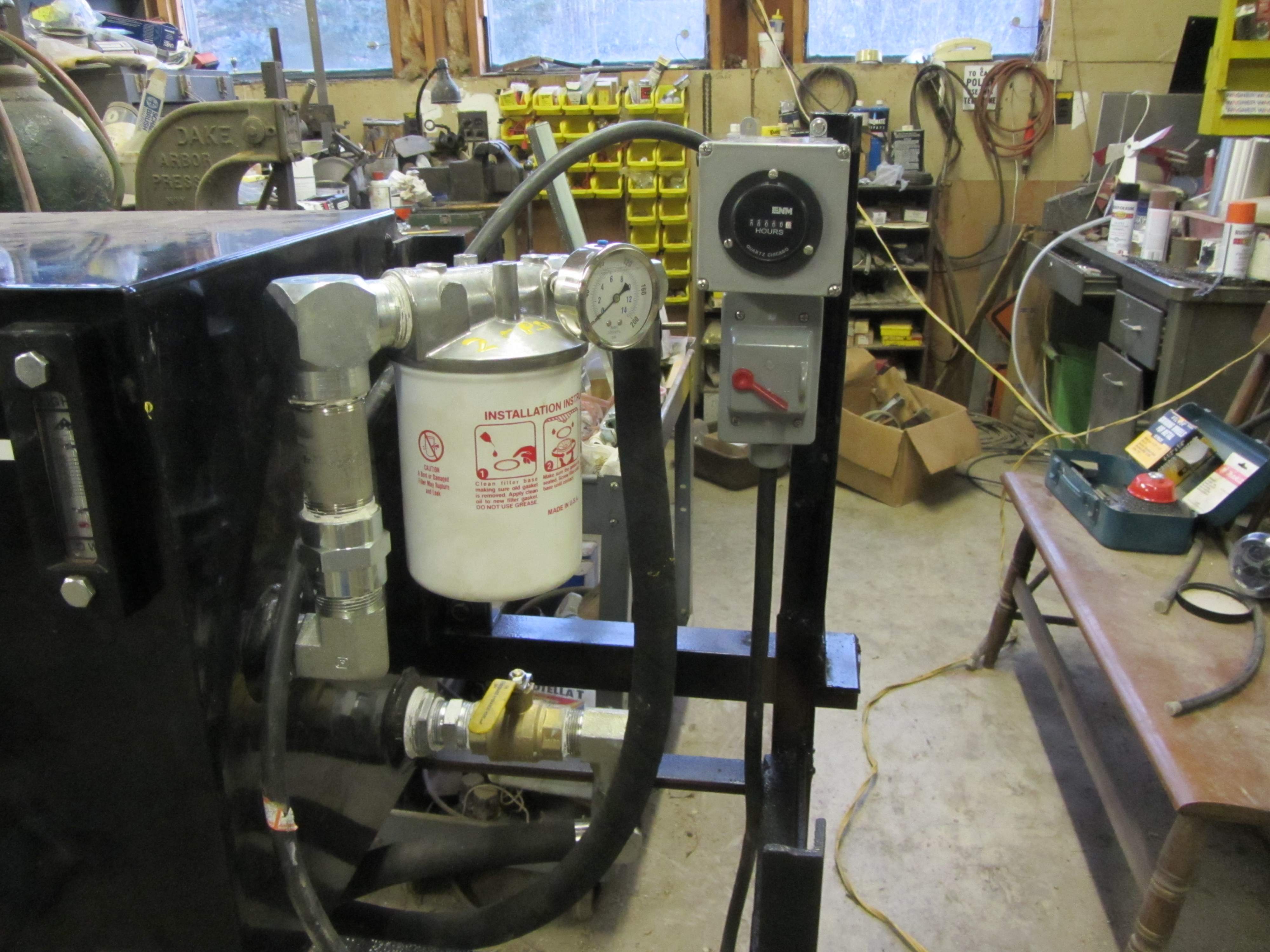

More observations

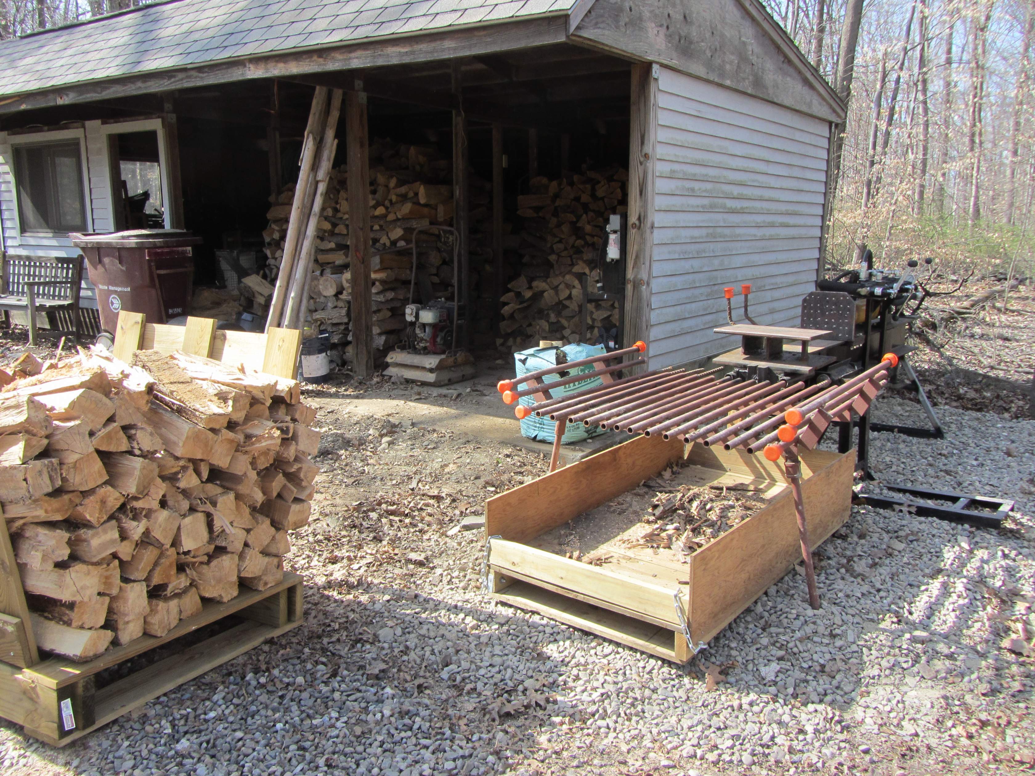

Hour meter is right on the money. Time goes by fast when splitting 10 hrs on it.
Need a debris skid for underneath it . I fill firewood skids so fast the forks are always on the tractor. Even though I have a skid steer front adapter it's a pain to shovel debris into the bucket. If I have a shallow skid with sides and a removable end door I can leave it under the splitter grate. Won't get it all but most. The move it and dump it with the forks. Oh yeah have to figure out how to not dump the skid at the same time.
Lets see what else. Filled all my firewood skids. Now that's a problem I have 40 rounds to go. Maybe 6 skids but I only have cover for 3 more . I guess loose in the wood shed. Bummer.
One more thing Cold oil does not like to go through the filter. Bypass is 25 psi When it runs for 15 min or so it looks like it is warm enough to go through the filter and at maybe 70d the back pressure is zero. After an hour and 45 min the tank was at 80d the filter was warmer than that and the motor was cooler than the filter.
Looks good to me except for lack of skids. I got to move this thing to its permanent home. I finally split all the rounds that were in the way of installing the outlet out there.

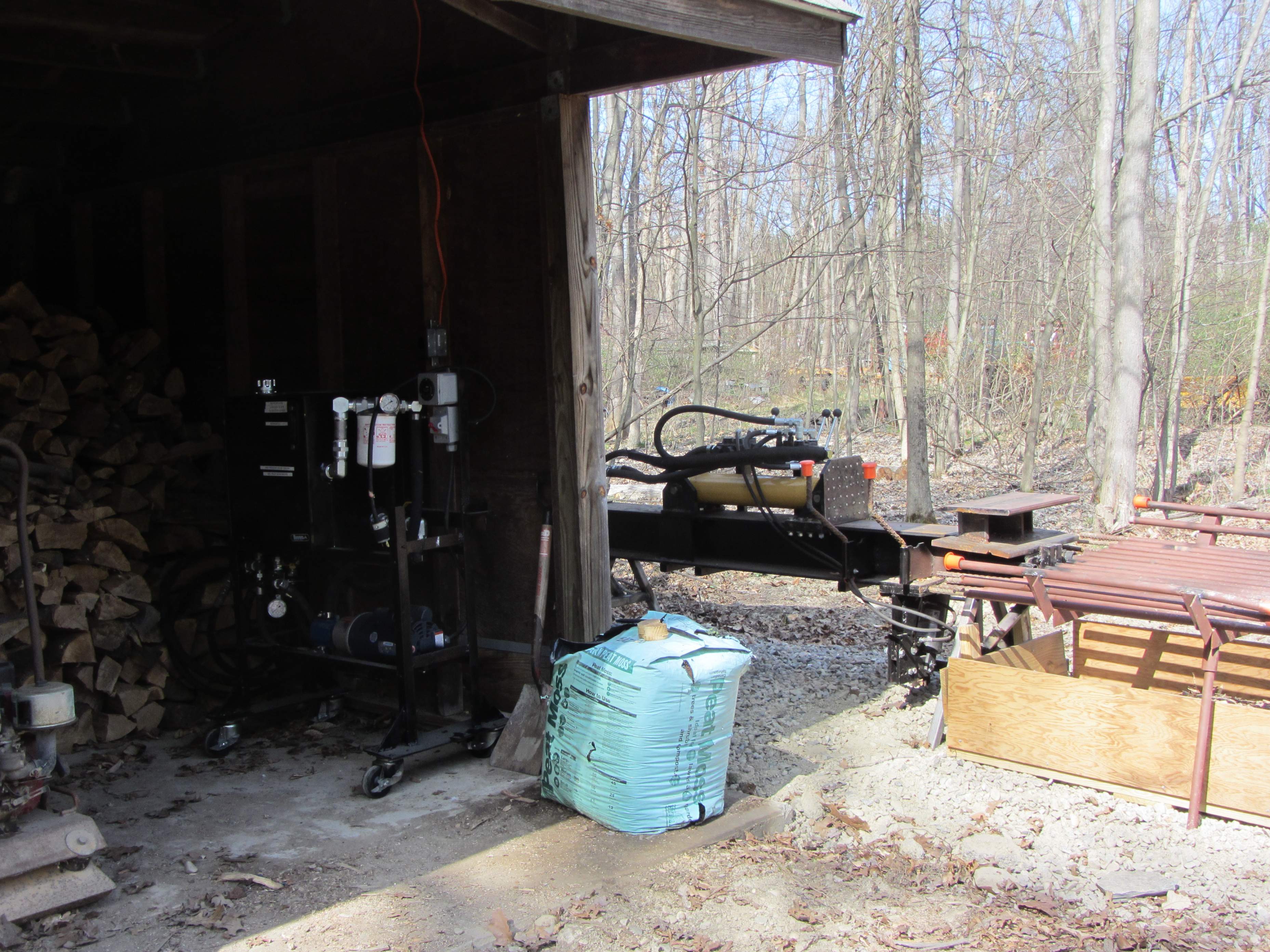

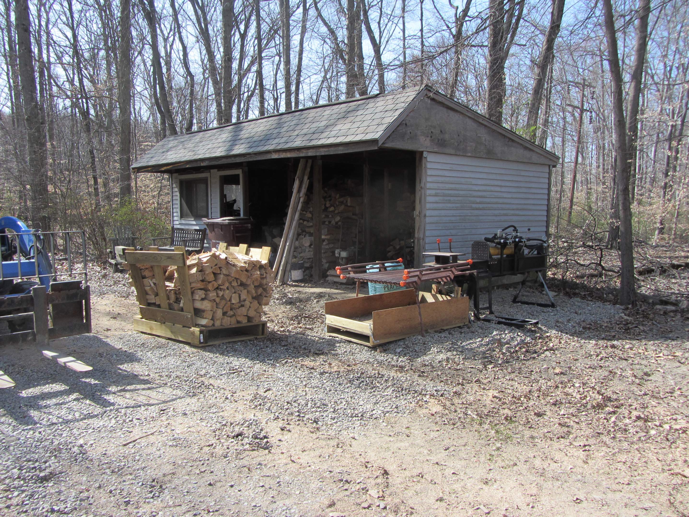

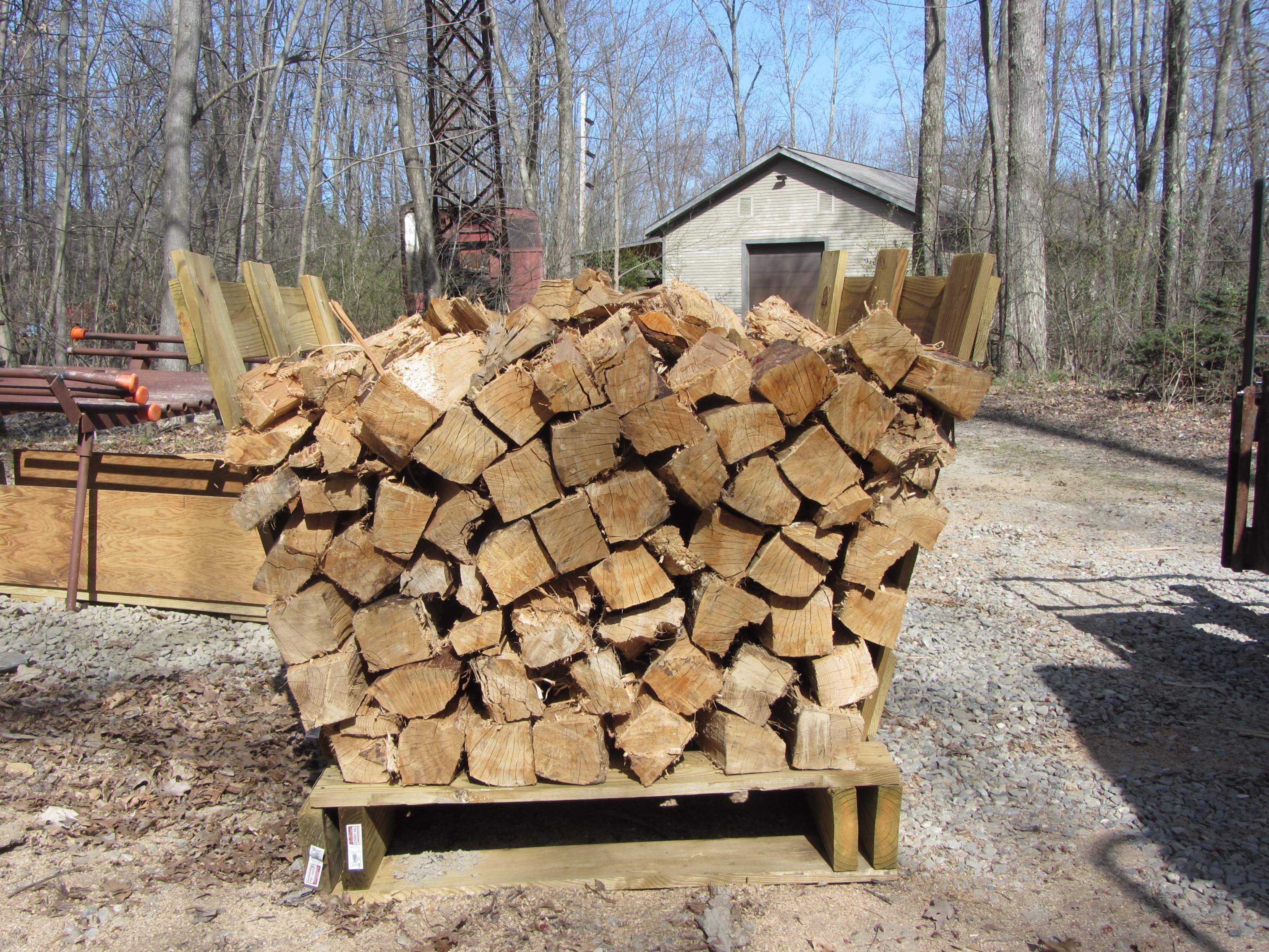

Last post with final pictures. Unless something blows up.
Splitter in its final home at the wood shed. I realized that if I have to weld on it I have to move it back to the shop. uh portable welder????
Power pack is inside , beam outside. The skid is 3 x 4 x 2 1/2 high about a 1/4 of a cord. That is all my loader can lift. Notice no bark on the splits. A full skid of 4 x 4 x 16 will fill the trash skid under neath. Some kindling slips through but the split wood is nice and clean. I have 8 skids filled like the one you see, all oak from 1 tree. I was thinking about a concrete pad but figured I would get sticker shock. I had the gravel around and put down some geotextile I also had around. It's a little harder to clean up on gravel than concrete but that is life. Lets see have to get my wife to move her peat moss bale, or rather tell me where she wants it. I decided to ignore the valve problem for now. Maybe it will fix itself or I will get used to it. I also have to put in some kind of fence rail so I don't spend any time under the crane boom. I don't worry about it coming down but I also don't like being under it on purpose.
I actually have 20ft from the splitter to where the end of the boom would be if it came down. Anybody ever taken one down by cutting the cable inside the cab where it comes off the spool? All the action would be out side then. I would really like to use an explosive cable cutter and be far away. Off topic sorry. Ok this was a great story and fun to build. Thanks everyone for comments and looking.

/ Woodsplitter build #2 #156
Nice looking shed. I think im going to do something like that this summer if time allows. It sure beats dealing with tarps all winter.
Good idea on the box under the splitter. I got a ton of splitter trash piled up under mine. Im going to have to wait till it thaws out and push it into a pile to burn. Your system seems easier to keep clean.
#157
About the trash box. The chains hook on the back of the fork attachment and the front door lifts out. So other than getting on and off the tractor a couple of times I can dump the box with the forks.
The shed was supposed to be my wife's garden shed but she discovered she hates mice. Oh Well. I have to finish the siding and stain it. Been ummm 18 years. Maybe next week.

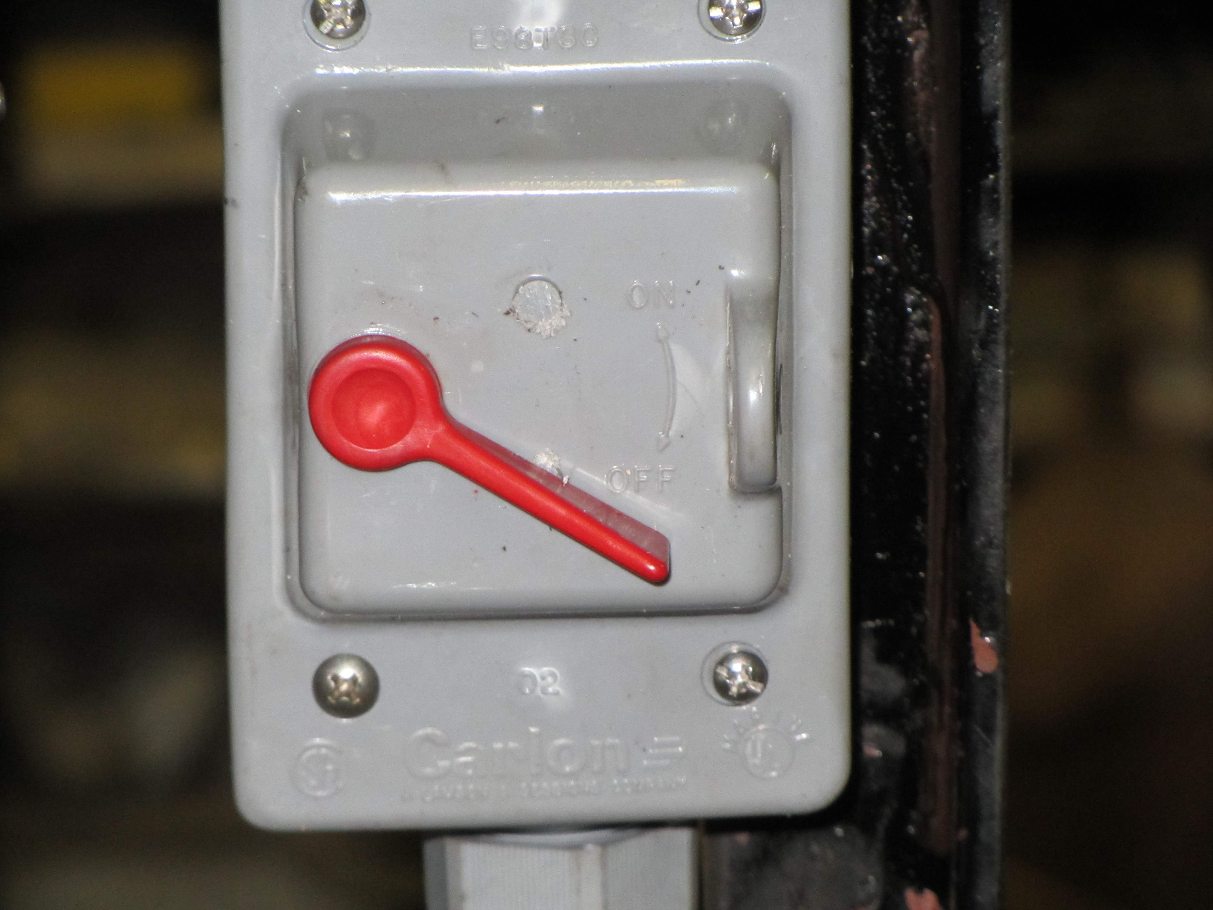

I can't believe I did this. Splitting season is coming. I walked by the splitter and just for hahas turned it on. Ran.
Good Then I looked at the hour meter 3650 Holy $$%^&. Long story short I tied the hour meter across the line before the switch . Since it was plugged in it just kept racking up hours. I decided to try and remember to un plug it, but as I type this I know I will forget so I think I will rewire.
