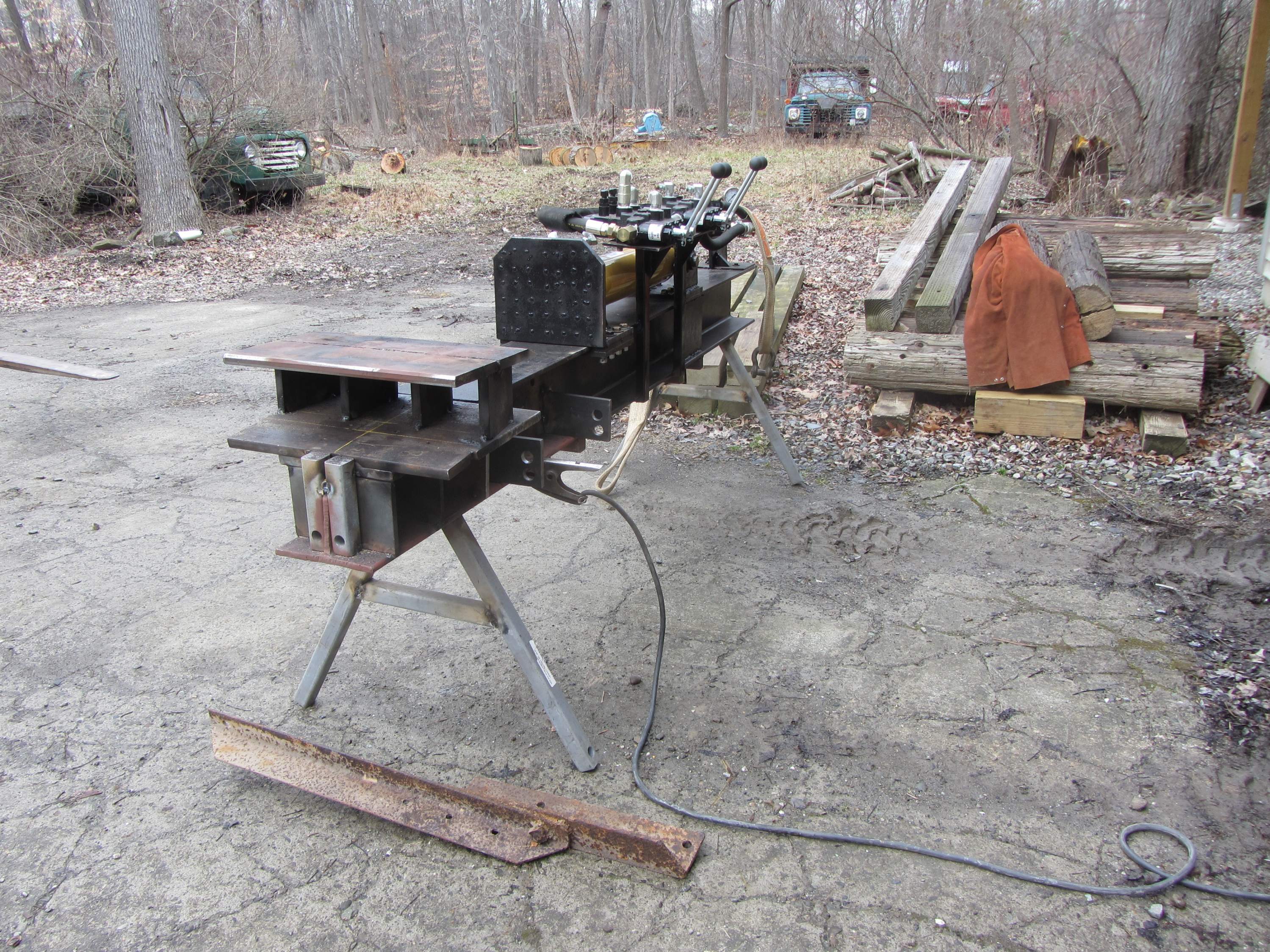

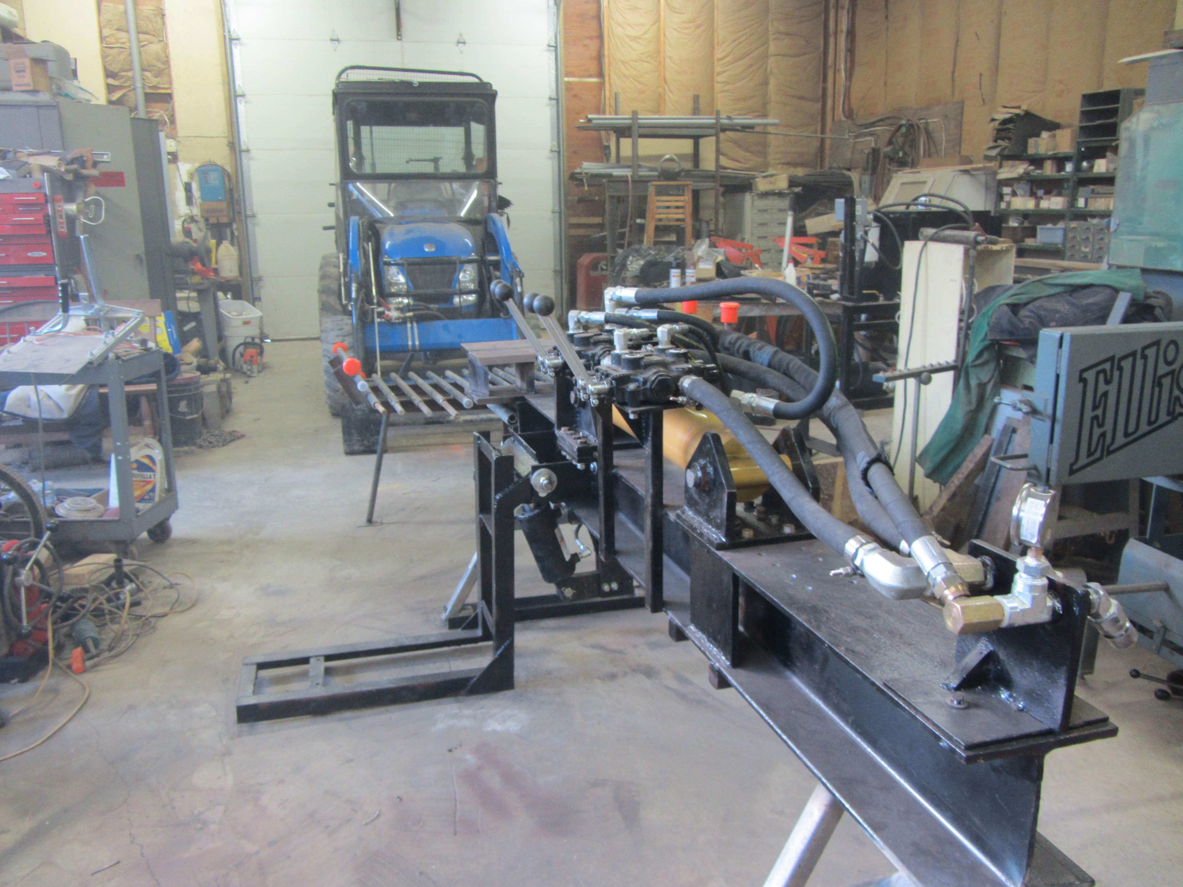

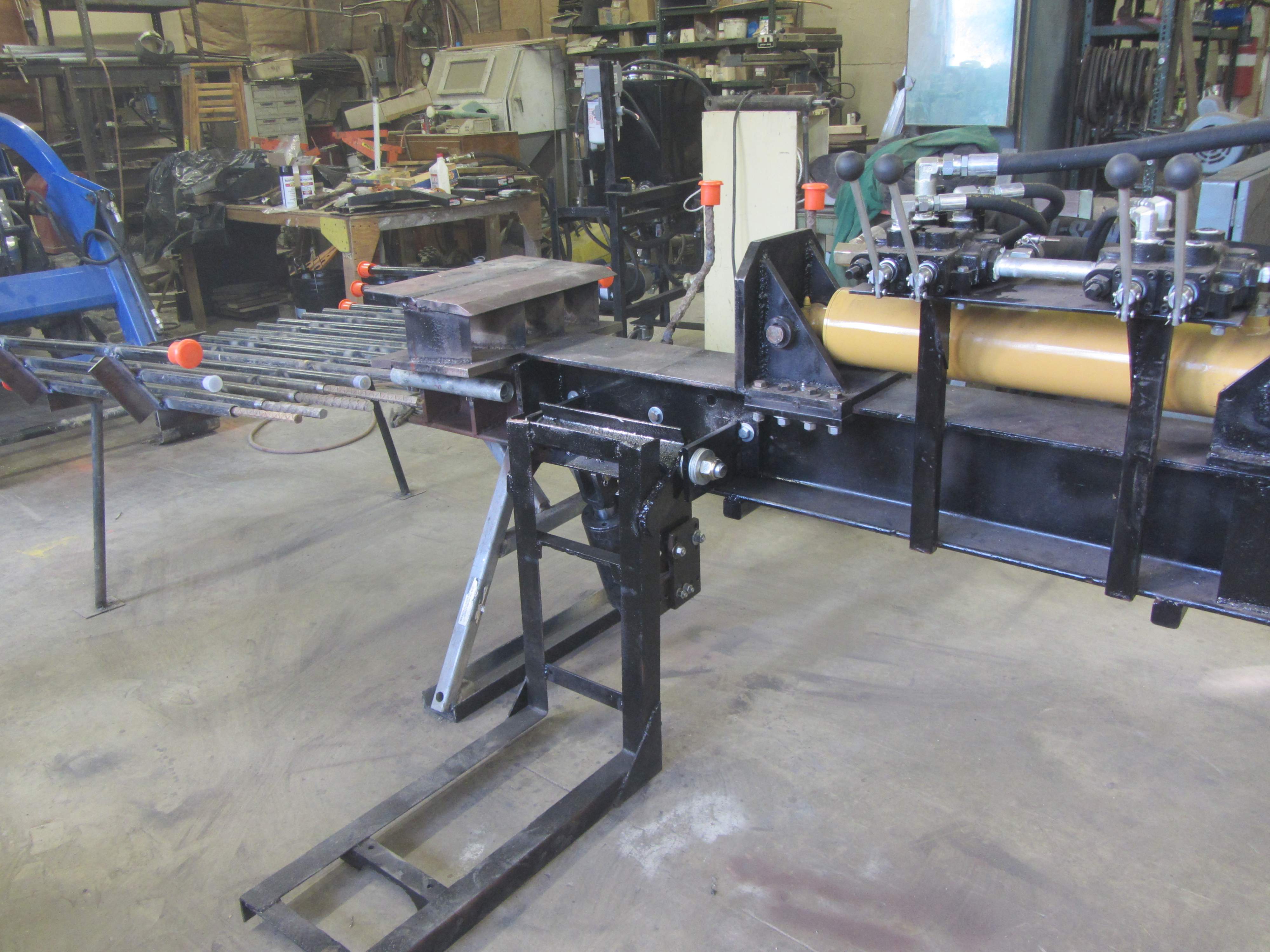

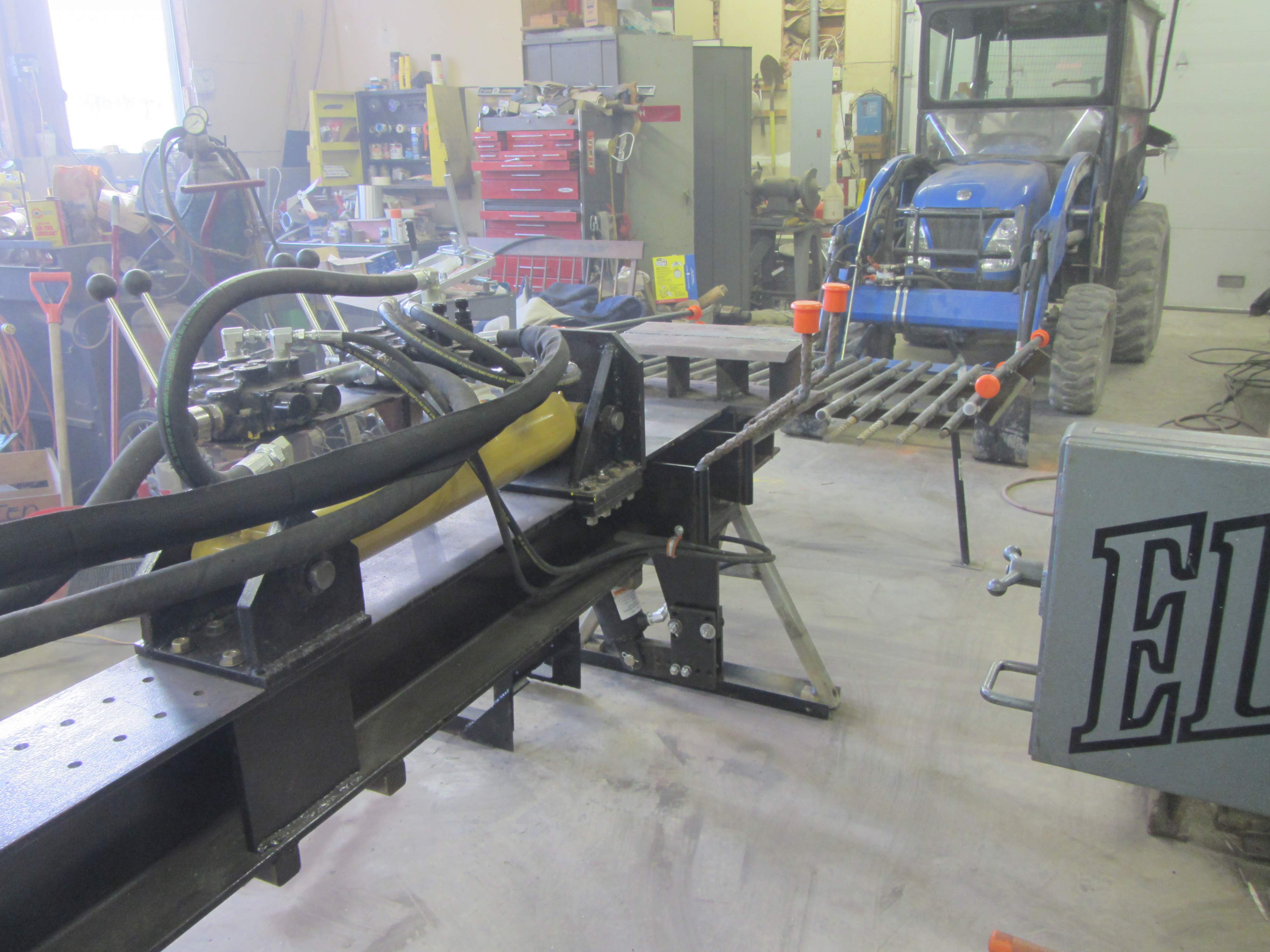

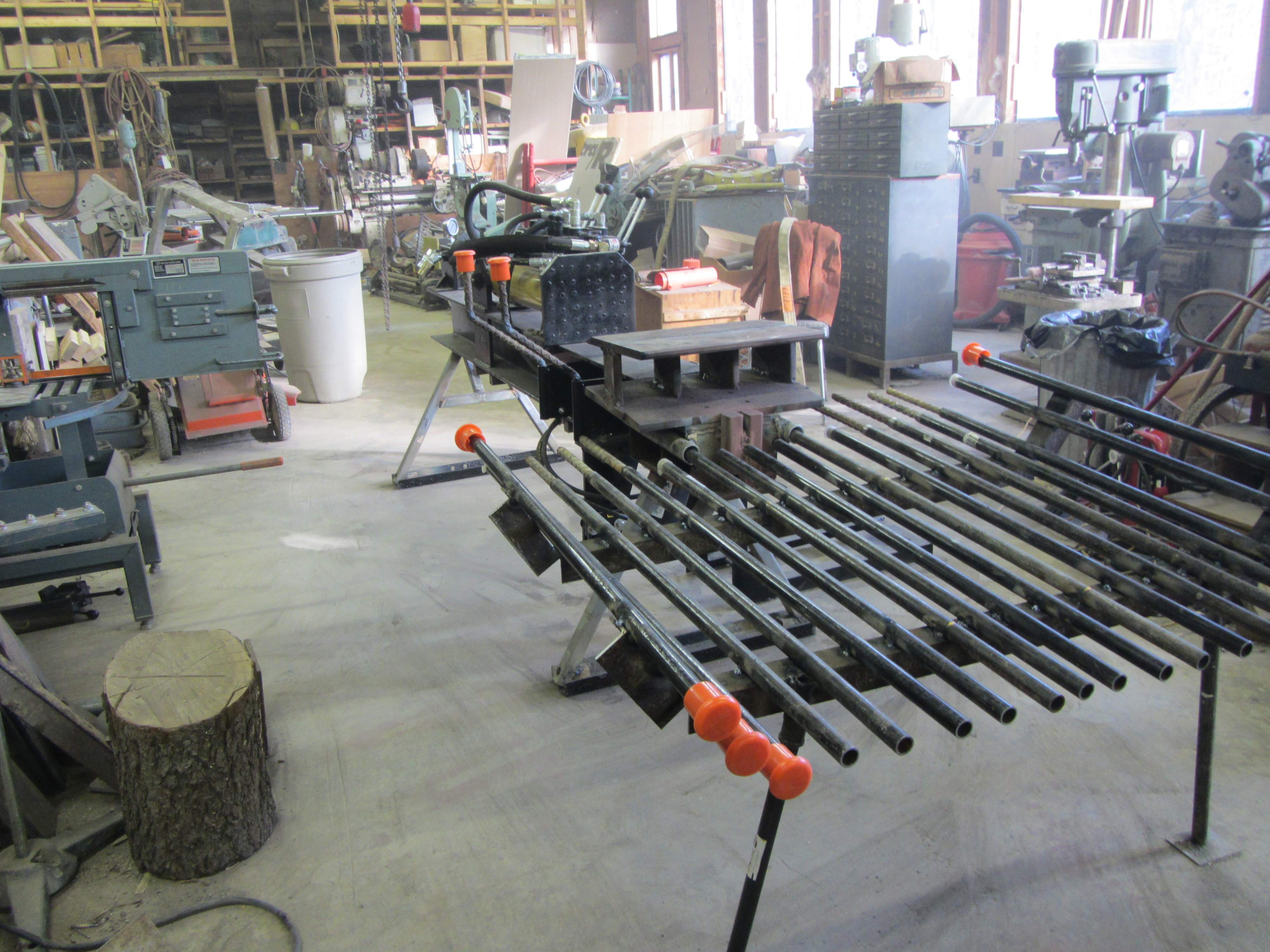

February 7, 2012 3pm Construction complete. Mostly. Maybe in the spring I will paint the outfeed table and make a bracket to take strain off the filter.
And fix what ever lets go.
Another day or two take it outside and run it. Probably even split something. I certainly have enough big rounds around.
I started this on 11/16. That's the day I picked up the beam. 12 weeks and 1 day. I probably worked on it 4 days a week 4 hrs a day. Lets see 4 x 12 x 4
192 hrs plus today. 195 hours. Or more. What else would I do in the winter.
Couple more posts and maybe a movie.
Forgot one thing Have to add a pocket for my Hookaroon.

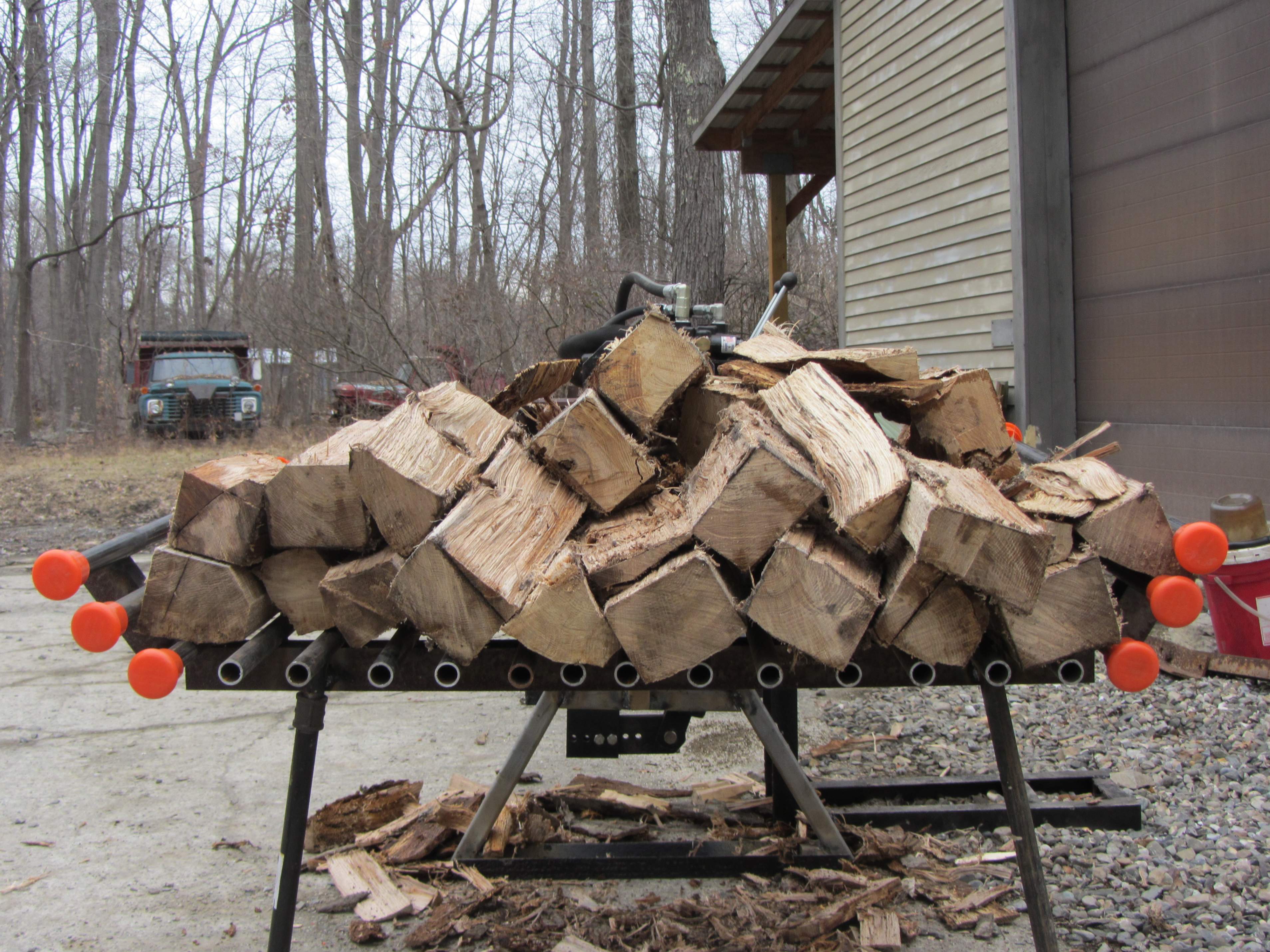

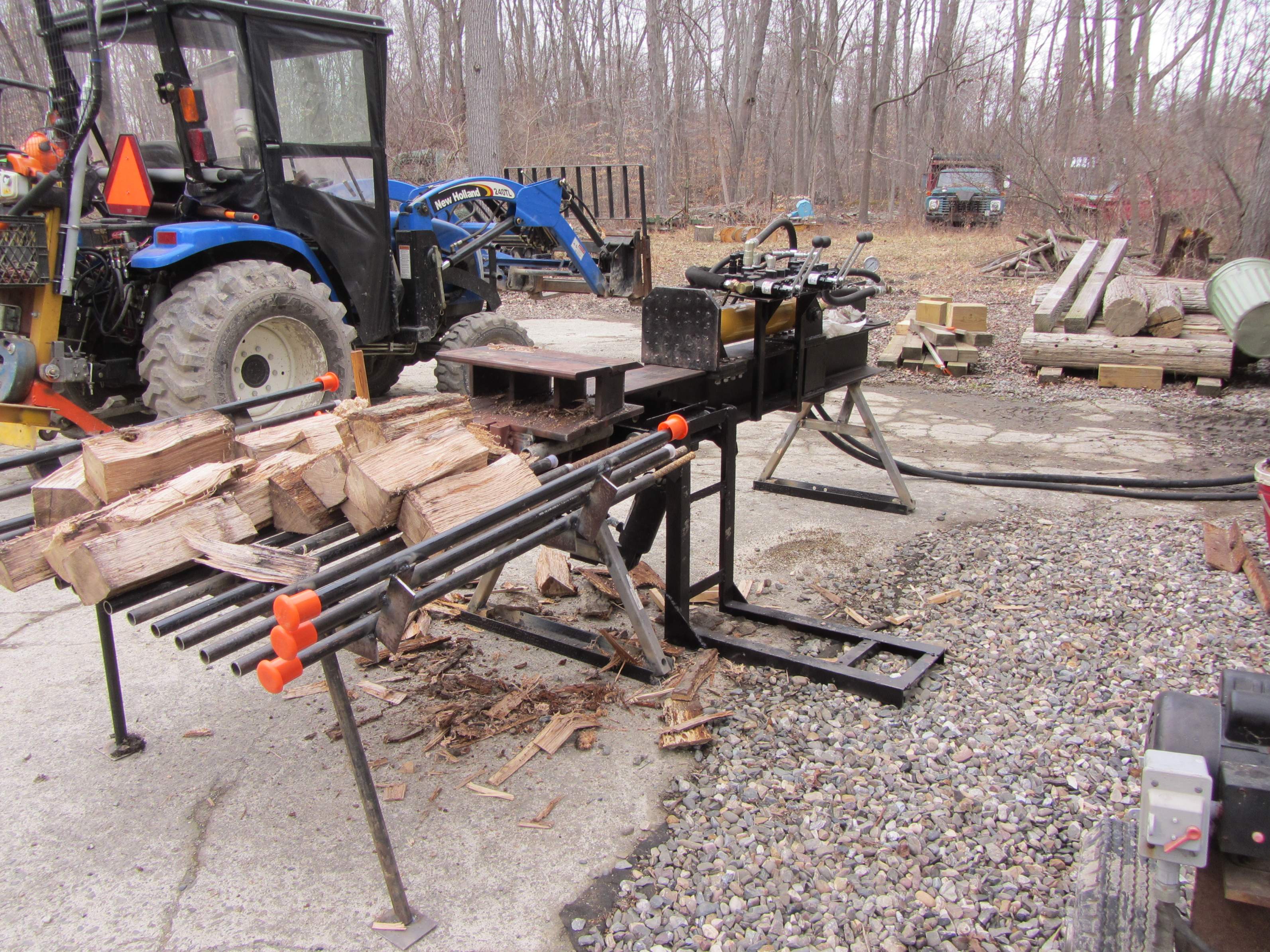

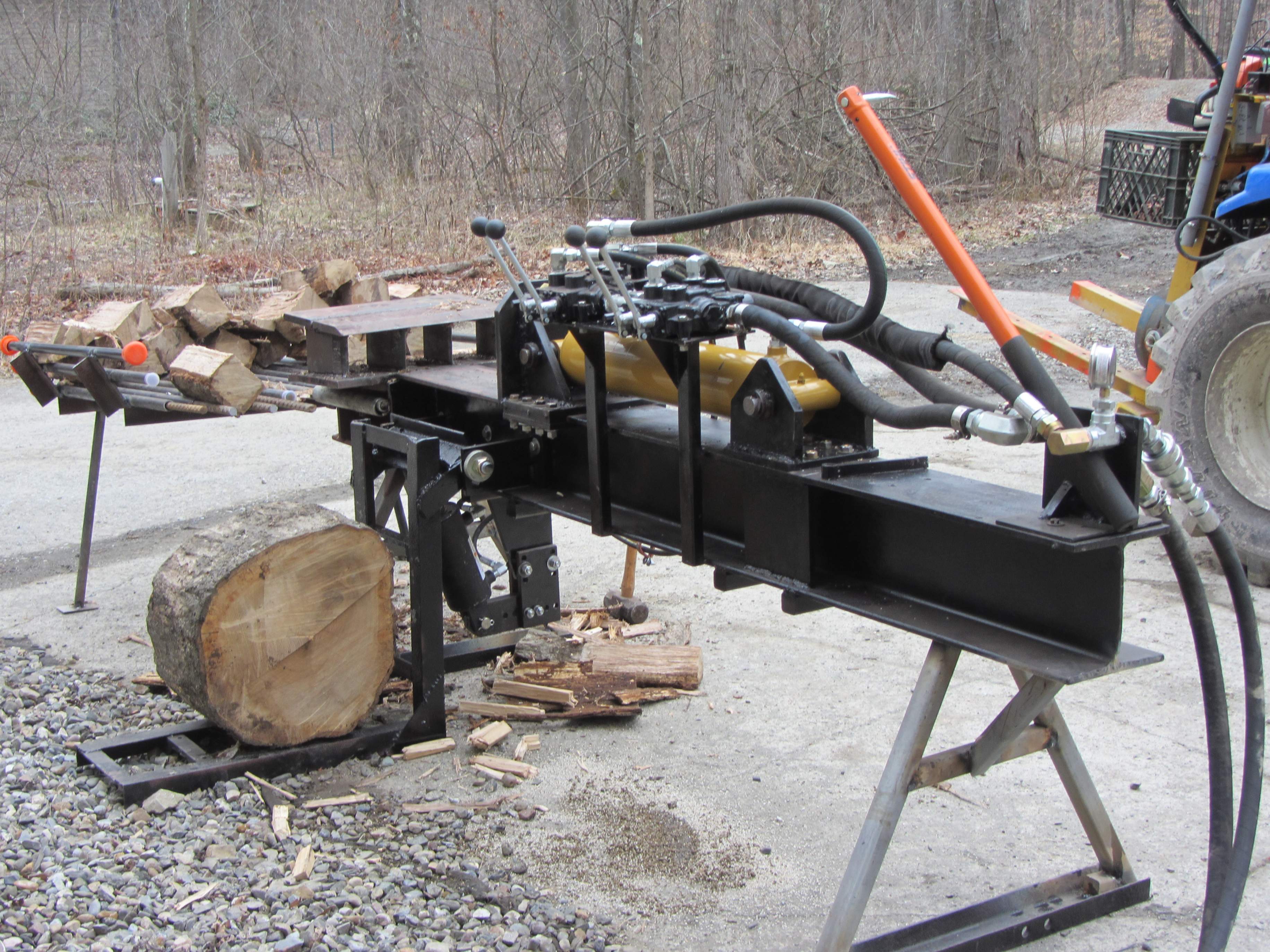

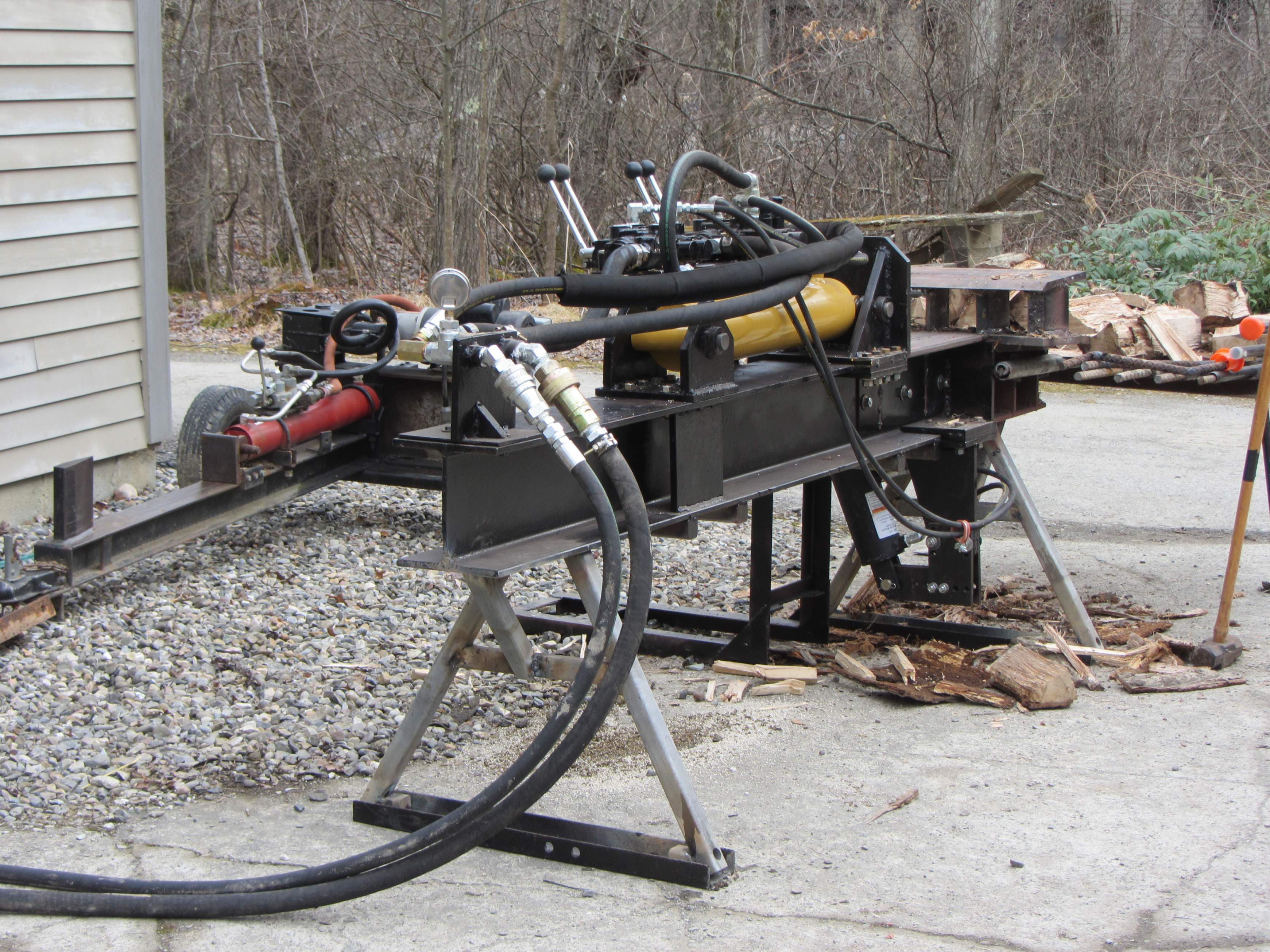

I split wood today. Good news and bad news.
Good news first. Motor works fine luke warm at most. Log lifter works fine after I tightened 2 hose fittings I forgot about. You can imagine the bummer around that little mistake. Ram works fine. IT SPLITS
Bad news. Some easy to fix. Like loose fittings. Other than that no leaks.
First picture The first nut on the sled hit the weldment that holds the log retainer. By a 1/16. Ripped them both off. The fix is easy . Trim some off and reweld.
Rest of the pictures are self explaining. The pile on the table is from 2 22" rounds. I thought 4 x 4 would be too small but they look good. Those rounds are from an oak that came down 2 years ago. Cut it off the stump a year ago, hauled it out and cut it up last fall. They are still full of water.
Now the really bad news. The first pass splits perfect. Second pass, too much friction in the boxes and the cylinder pressure goes over 2000psi relief. Ram stalls. It took me a little while bit I finally figured out a pusher block, 2 x 4, and push it through each box section to clear the boxes. Then pull the round back . I am going to raise the pressure and see what happens. I already noticed that the detent pressure relief will stop the ram before the main relief is reached. IF you hold the handle down you can bypass the detent relief. But that defeats the purpose. Anyway I can split rounds into 4 inch square firewood with out lifting the rounds in. IT 's not perfect but it splits faster than I used to be able to do . And not lifting those rounds is a big deal. I have a movie of the lifter lets see if I can get it here.
Not great but I had the camera in my left hand and a valve handle in my right hand.MVI_0201.MOV - YouTube

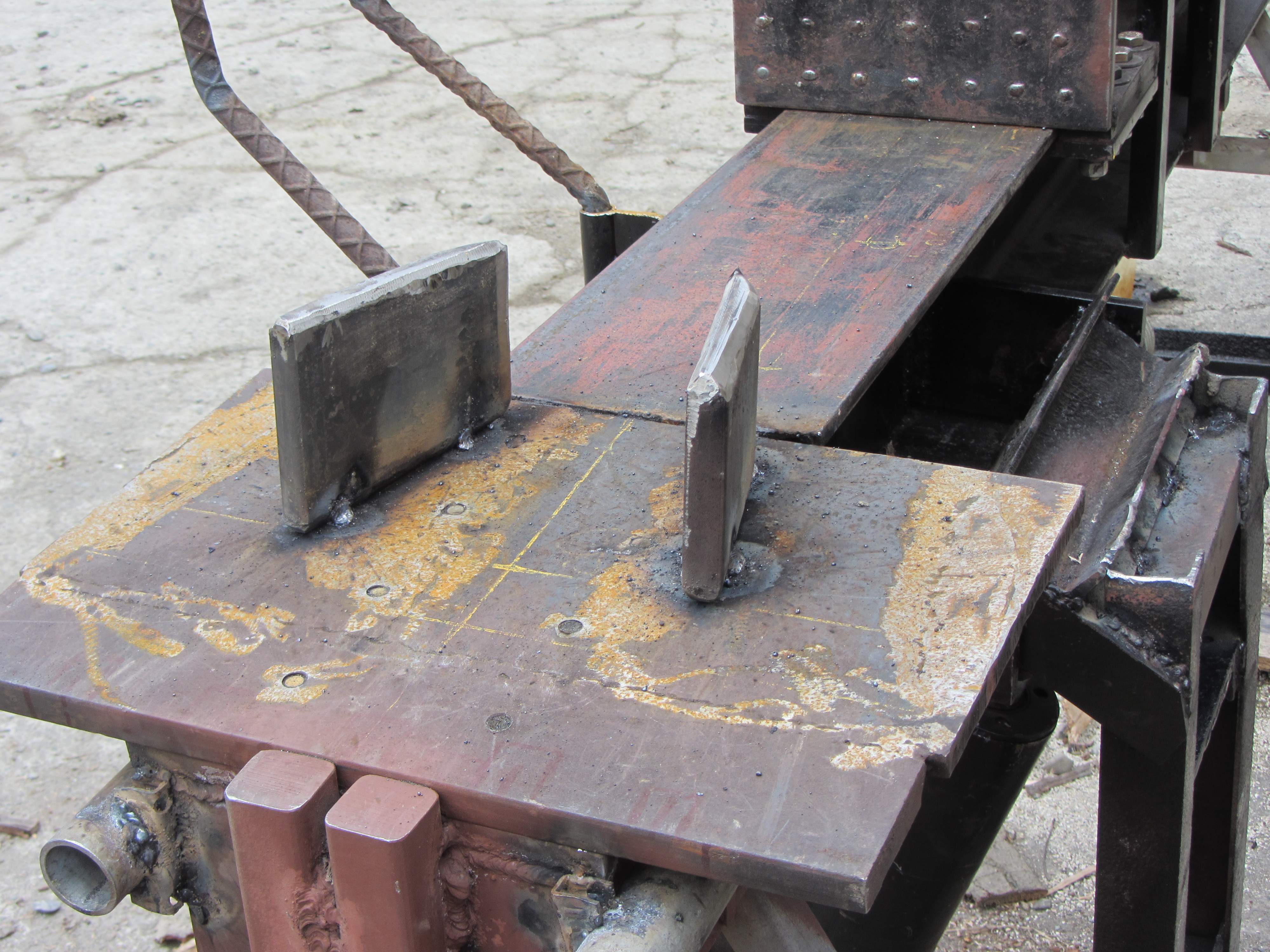

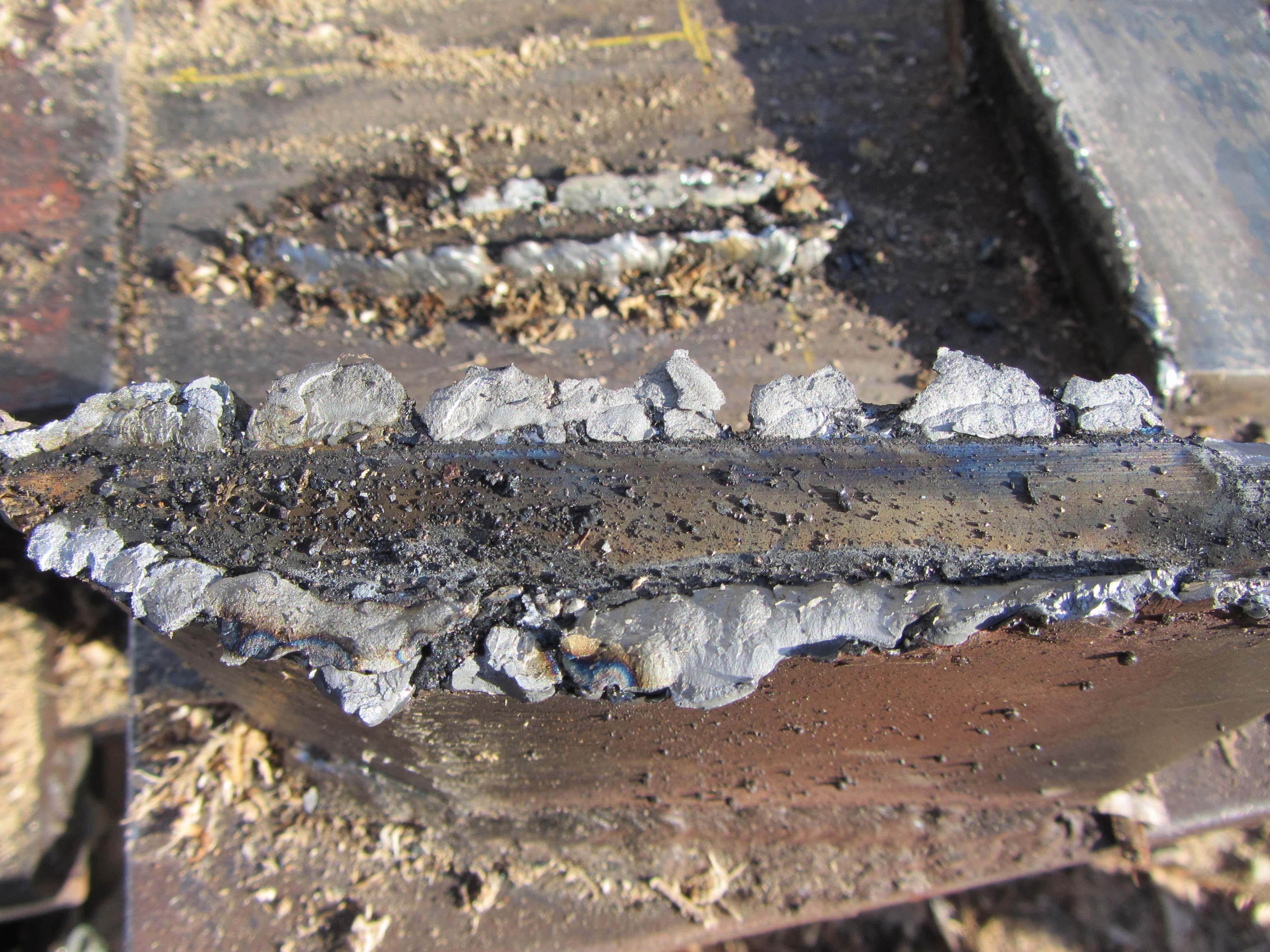

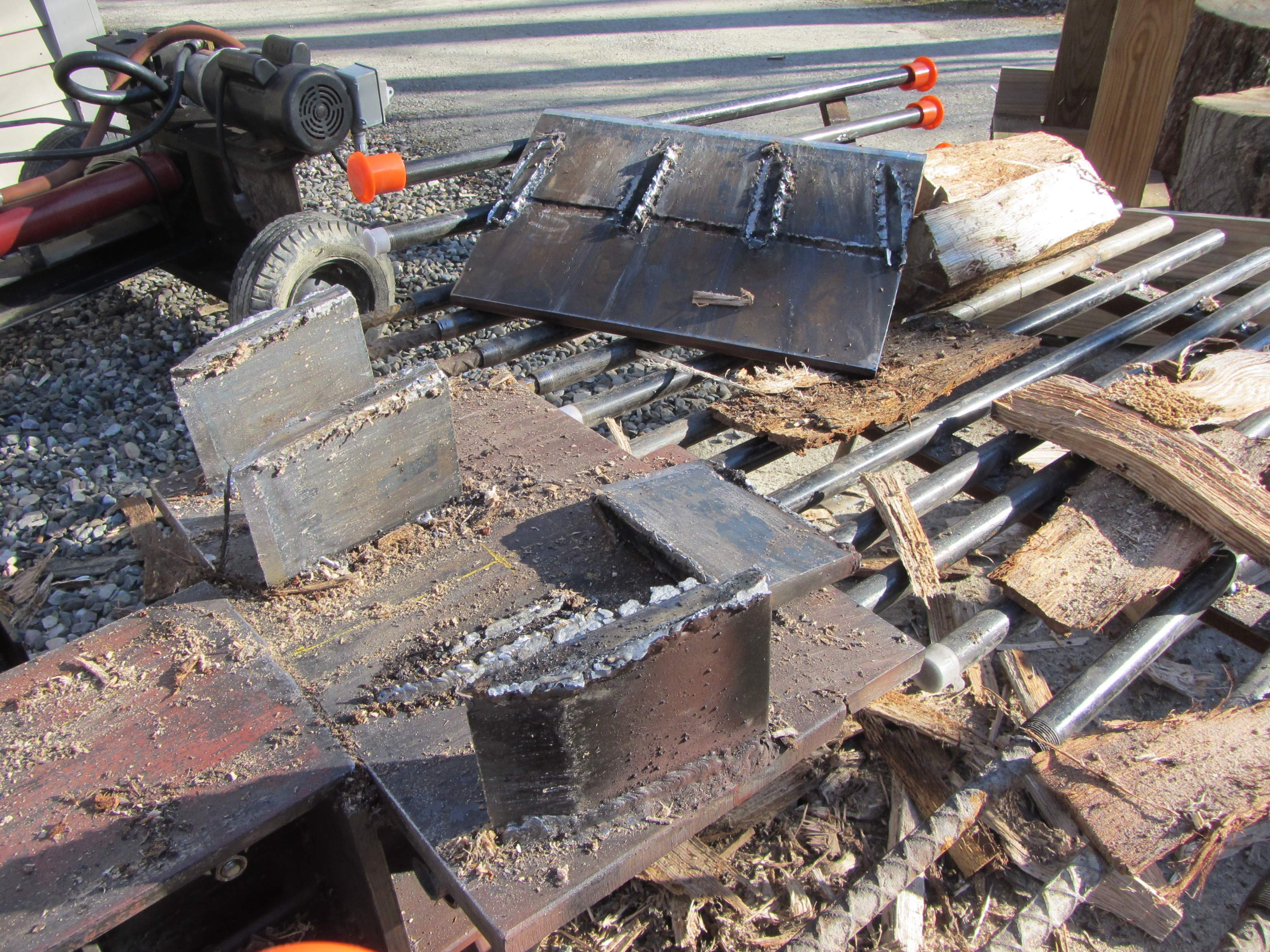

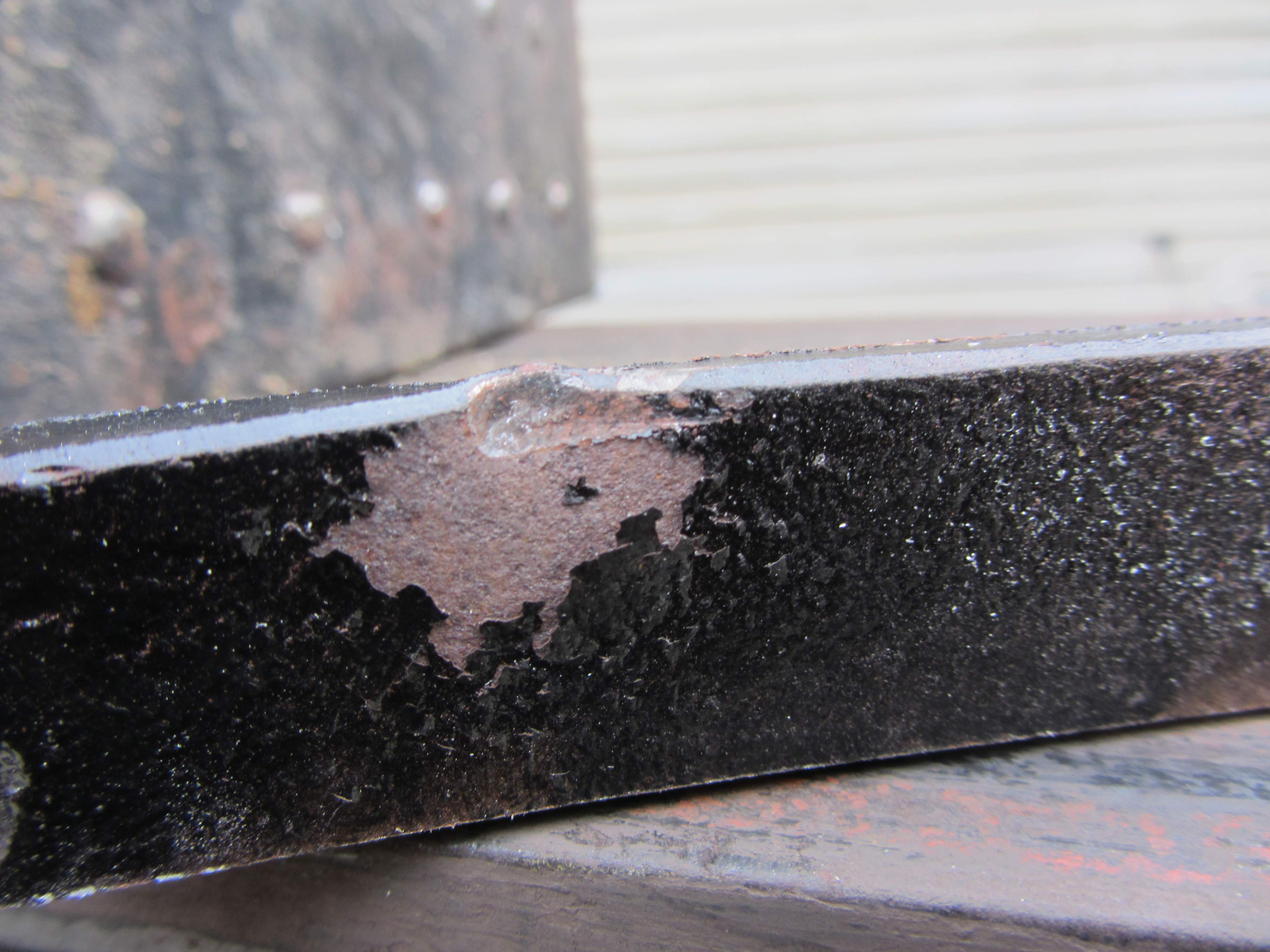

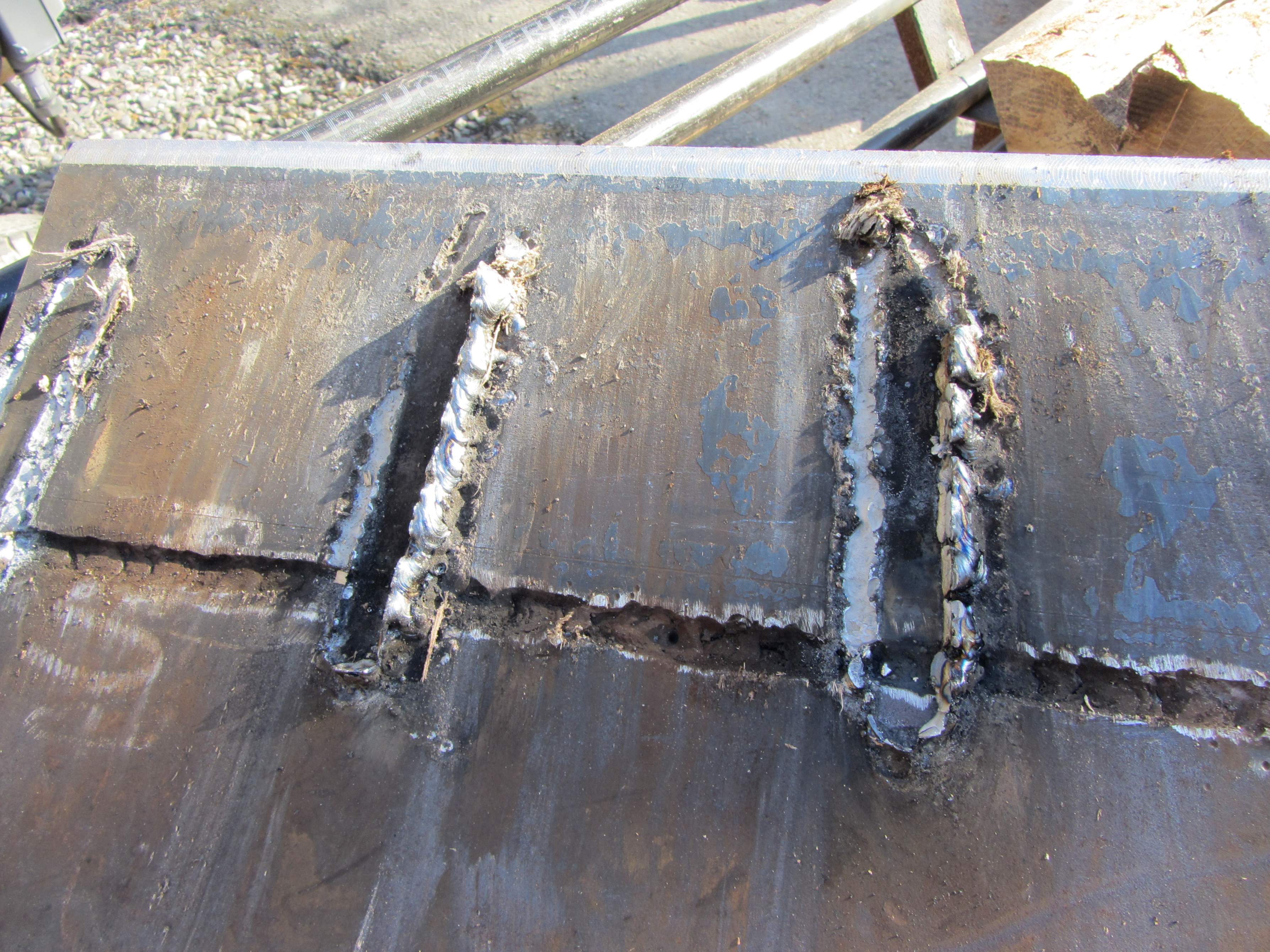

Ahh Don't have to worry about cutting out the welds on the box. I did not even have to raise the pressure. 2000 psi did it Got stuck on a knot while I was deciding how high to raise the pressure. The top weld on one end plate tore out and I decided to have the machine help. Pushed one more piece throu and the rest tore out on the top. The two center plates tore out and a wiggle broke them loose. So now I don't have to worry about how to take it apart. The good news is everything else held. One thing I learned is to have all steel parts clear anything that moves no matter what. Like when the log lifter is up and the ram comes forward , nothing should interfere between the two in any position. Right now the sled will hit part of the log lift if I forget to lower it. Ask me how I know. What I have to do is figure out how the put the box back together . It may not be possible but it sure makes nice fire wood. While it is apart I think I will make another base plate for a Tee wedge in case thats the only way to go.
Looking at the pictures I am thinking maybe just two verticals, let the outside run big. Would be 4" high and wider.

/ Woodsplitter build #2 #113
Well, thats one problem solved :thumbsup:
I noticed on your welds.. you had no penetration. No bevel and not enough heat.
You need to bevel them right back before welding and crank up the heat. Try and aim to get most of your heat into the horiz plate. Theyre pretty thick. Try something like a 6010 for your root.
#114
I did not bevel the verticals. I thought there would be enough section through the fillet. I guess not. I think I am going to put it back together ????? can't decide. Either 2 verticals or a skinny center vertical and the the ones I have one on either side. Skinny would be 3/8 I guess . I need to think about this for a bit.
I have a Lincoln tombstone 225A AC only I used 5/32 6011 for the root welds at 145A. The guys in the welding forum said I should bring it someplace to get it welded. Another guy suggested slotting the top and bottom plates and welding from the outside to eliminate binding on the welds in the corners. The slots are interesting. I would have to make new vertical plates . It's a thought.
/ Woodsplitter build #2 #115
I wouldnt go slotting or making anything up. You should be able to get your rod in there and get a good bead. Even if you got to bend or use stub rods. Personally, I like the Burnard Short Stub holders. you can get them into some pretty tight places.
A bevel is a must. With the proper bevel i dont believe you'll have any further issues. You really got to drive the rod into the plate and let it fill the bevel, otherwise your just on the surface.

I tacked 2 verticals in place this morning to the bottom plate but after reading the previous two comments I am going to rip it out. The vertical are 3/4 thick and they were all tapered originally out more than the thickness. The bottom plate also drops away, 1" in 12" . The top plate is level. The splits expanded quite a bit.
I just measured some A lot of 4" in one axis and 4.75-5 on the other axis.
The opening was 4 x 4. I don't know for sure which was horizontal and which was vertical. I think the 4" was vertical. I know the splits had to go about 5" before they were loose . Anyway I think what I am going to do is put in a center wedge thinner, maybe 3/8 and then the two 3/4 ones outboard . That will reduce the compression on the boxes. 2 boxes would be better than 1.
I also fixed the log lifter so that if it is up the sled won't hit it. My welds can't all be bad. When the ram hit the lifter two 1/2 plates bent but the welds held. They also held when I jacked them straight. I have an oxy acetylene torch but I don't like to use it unless I really have to. Gas is expensive.
