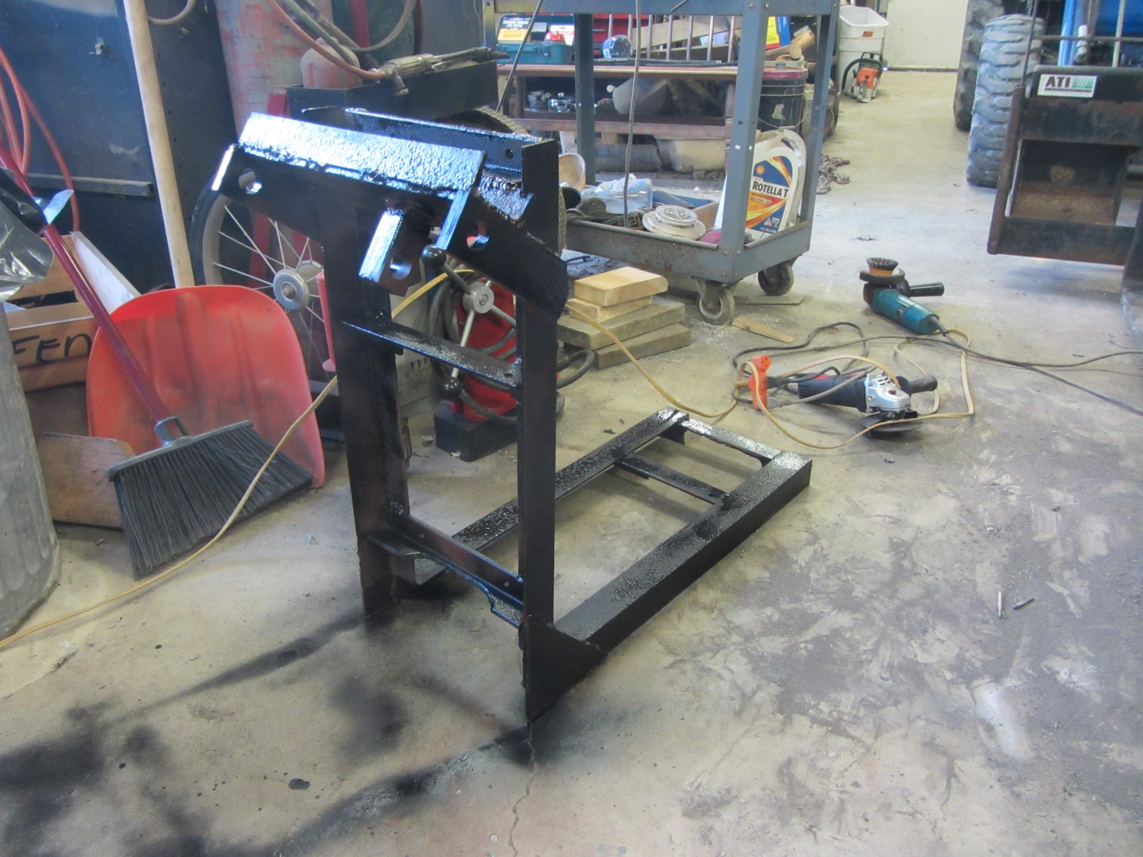

My usual couple steps forward and one step back. Put casters on the power pac. Not for off the road speed racing but just to move it around in the shed after forklifting it out there, full of oil. The shed has a concrete floor . Had to drill and tap 16 5/16 - 18 holes to mount the casters. The bolts came with the casters but were not long enough to put nuts on the back. So buy longer bolts and use up 16 nuts , lockwashers and flat washers or tap 16 holes. I went with tap. Still don't have the gage but tracking says it's out for delivery. In the meantime I decided too many threaded fittings in the line to the relief valve. IF I ever had to take anything apart I would be unscrewing pipe fittings for ever. Besides I had to turn the last, or first, depends how you look at it, another 360d, which I did . Would have leaked for sure. So I had to order another fitting 3/4 jic female nut thing , Acts like a union. That will allow the relief valve to come off with out all the rest of the fittings. A lot cleaner.
Then I was going to do some welding but I got distracted by the quick attach latches not working easily. Works better when they are greased. Then I got more distracted by the fluorescent lamps right over my bench going dead. Only 20 years old can't imagine why. Got 2 bulbs down at the Depot, still dead, must be the ballast #$%$#. So then I pulled out the flotation feet under the beam legs and wire brushed and primed. That's it for today.

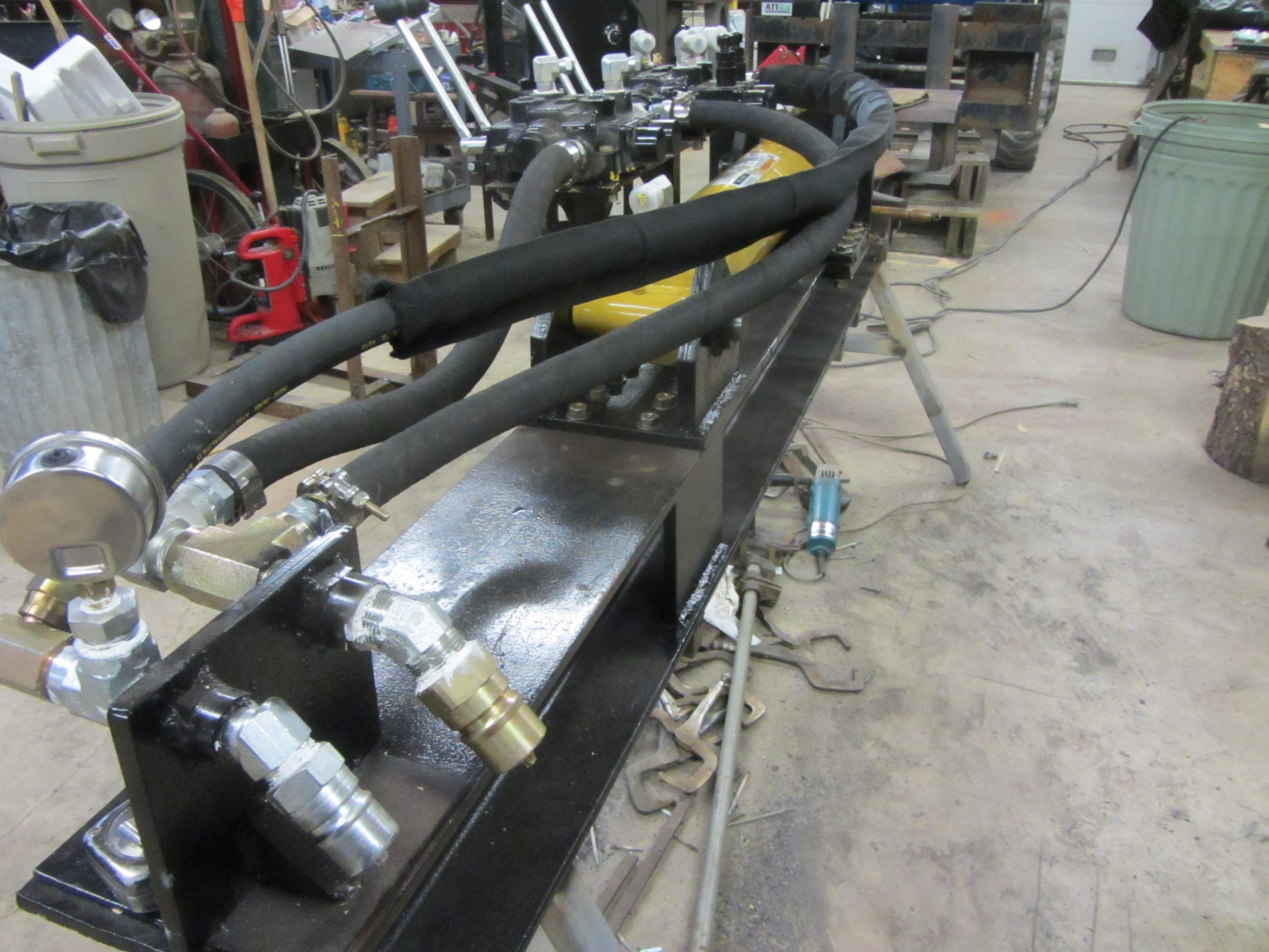

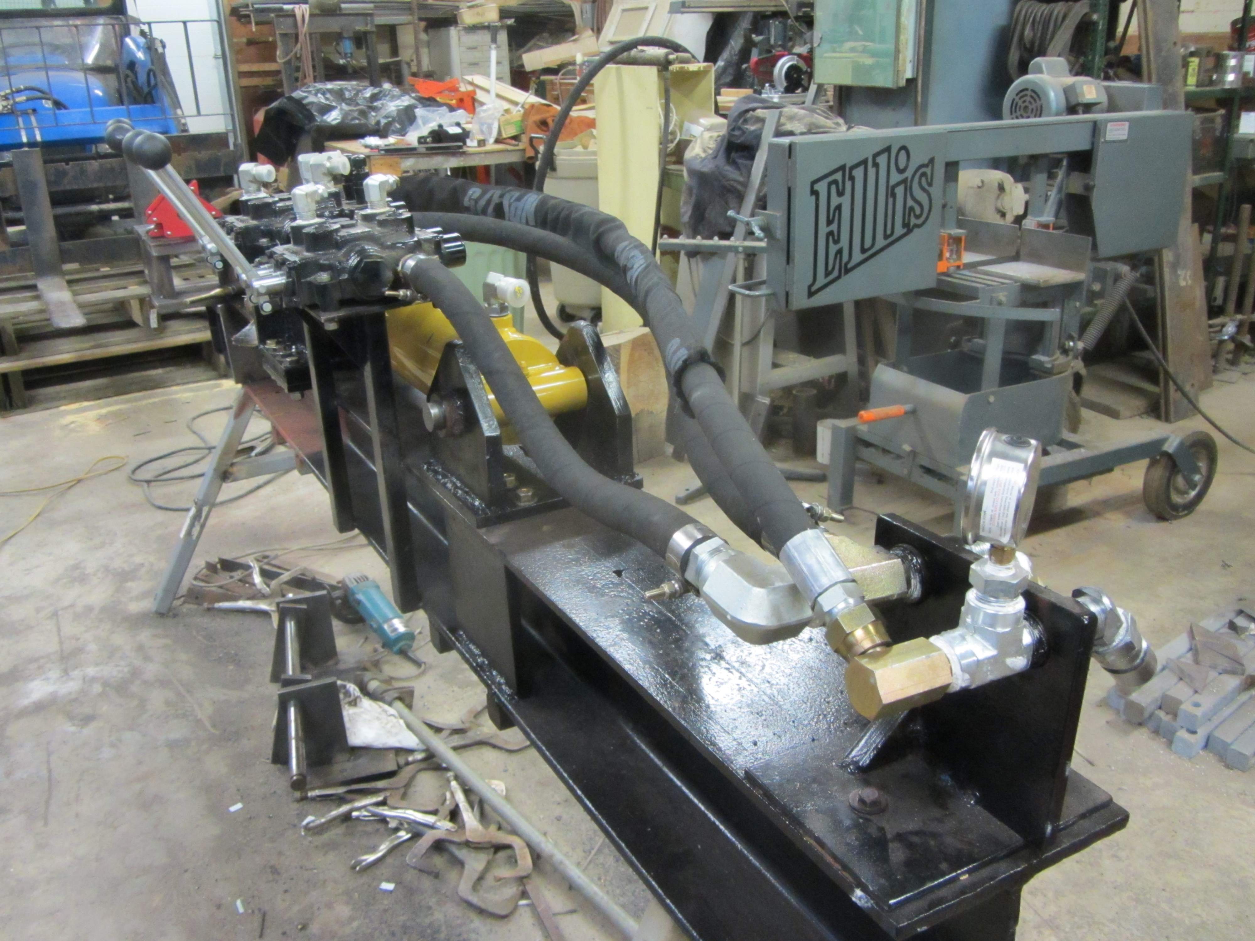

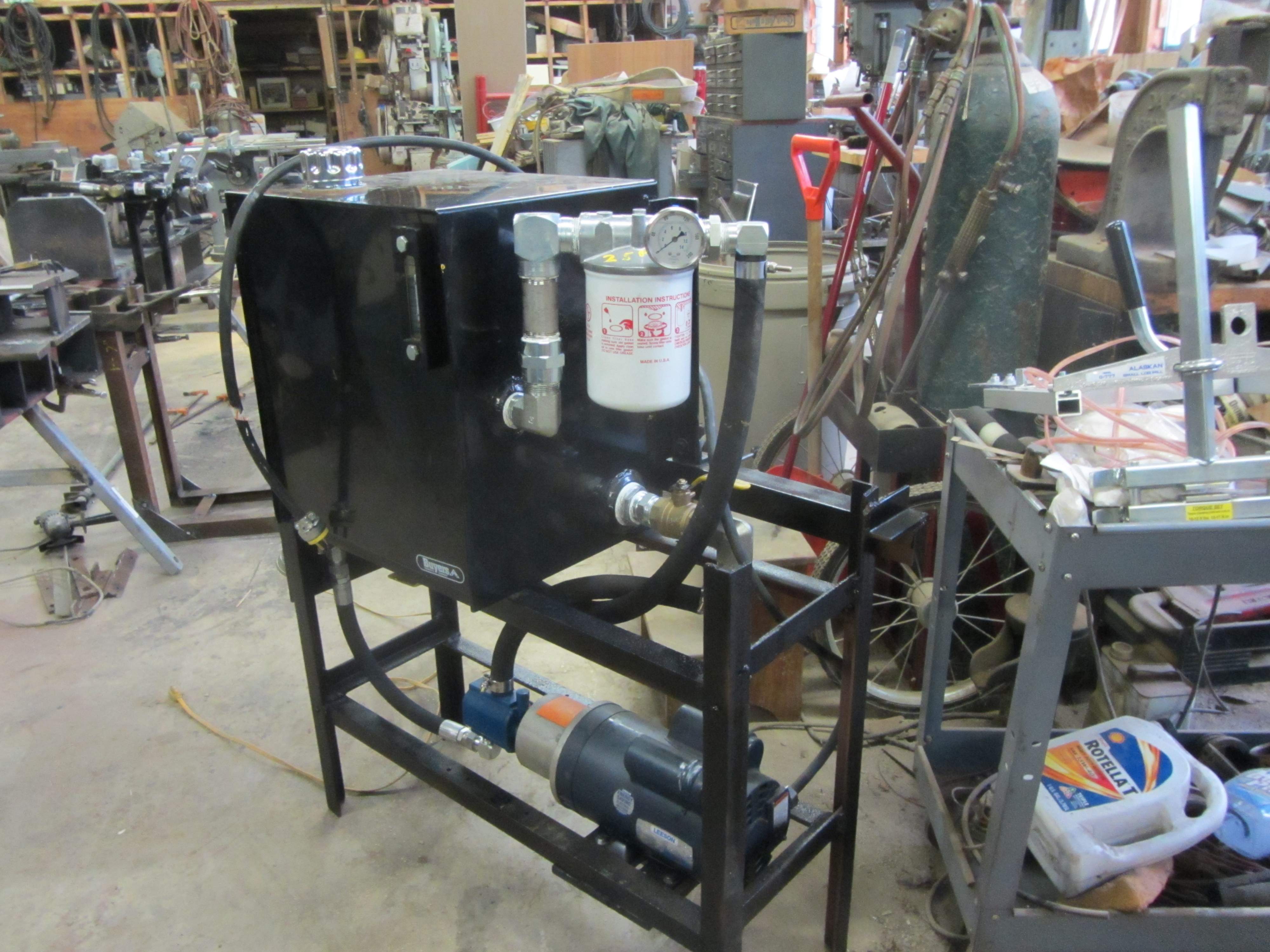

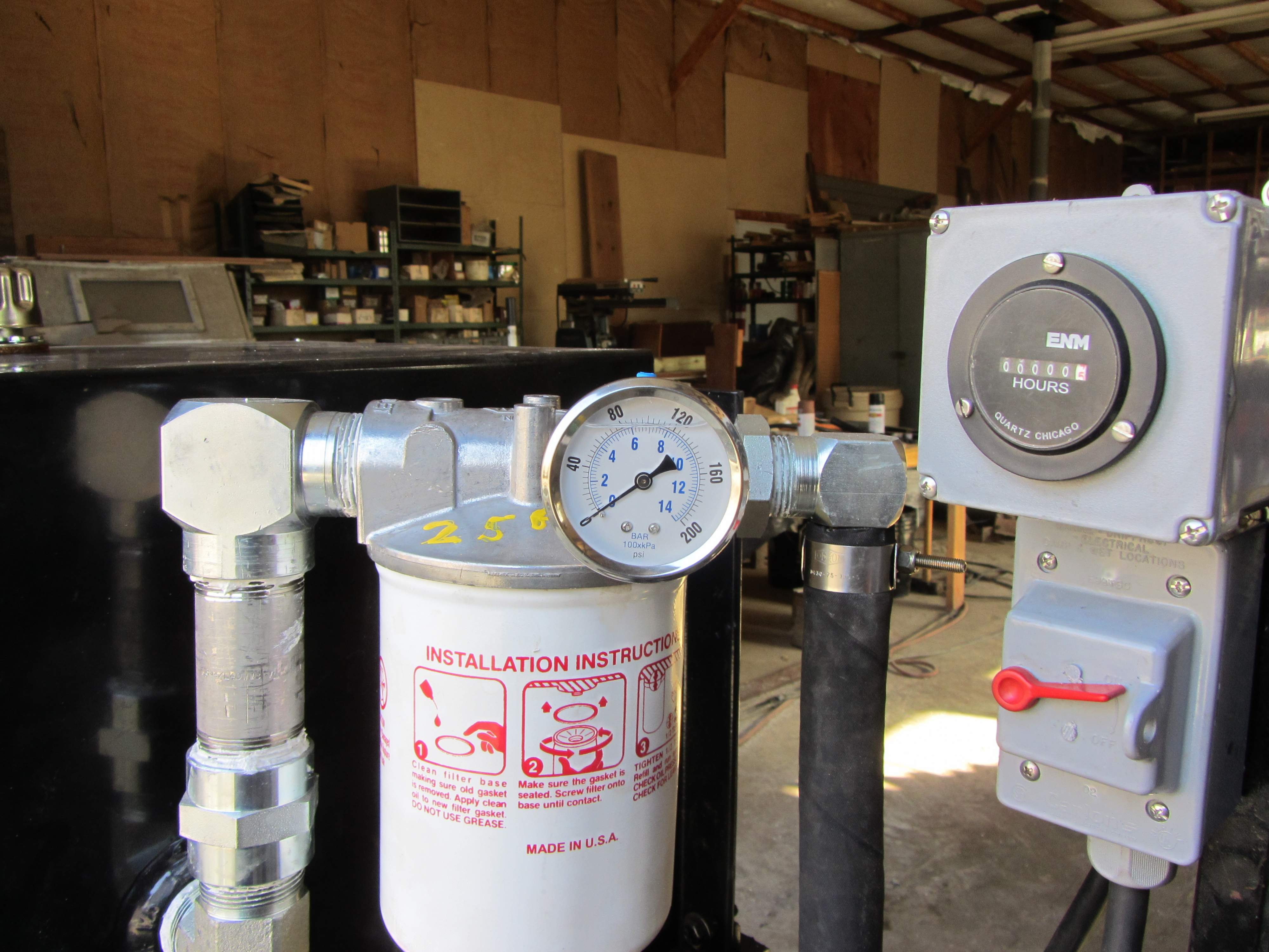

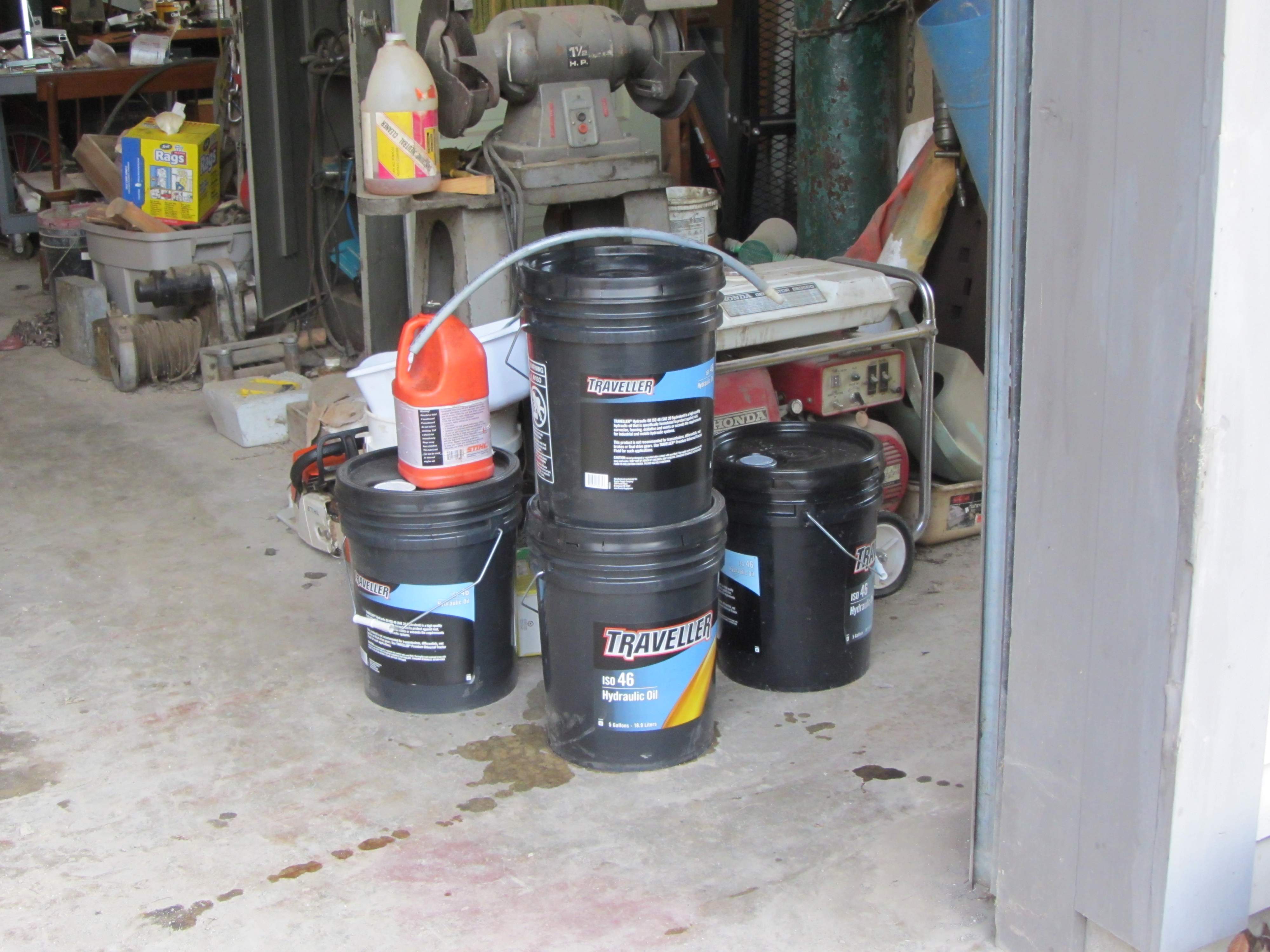

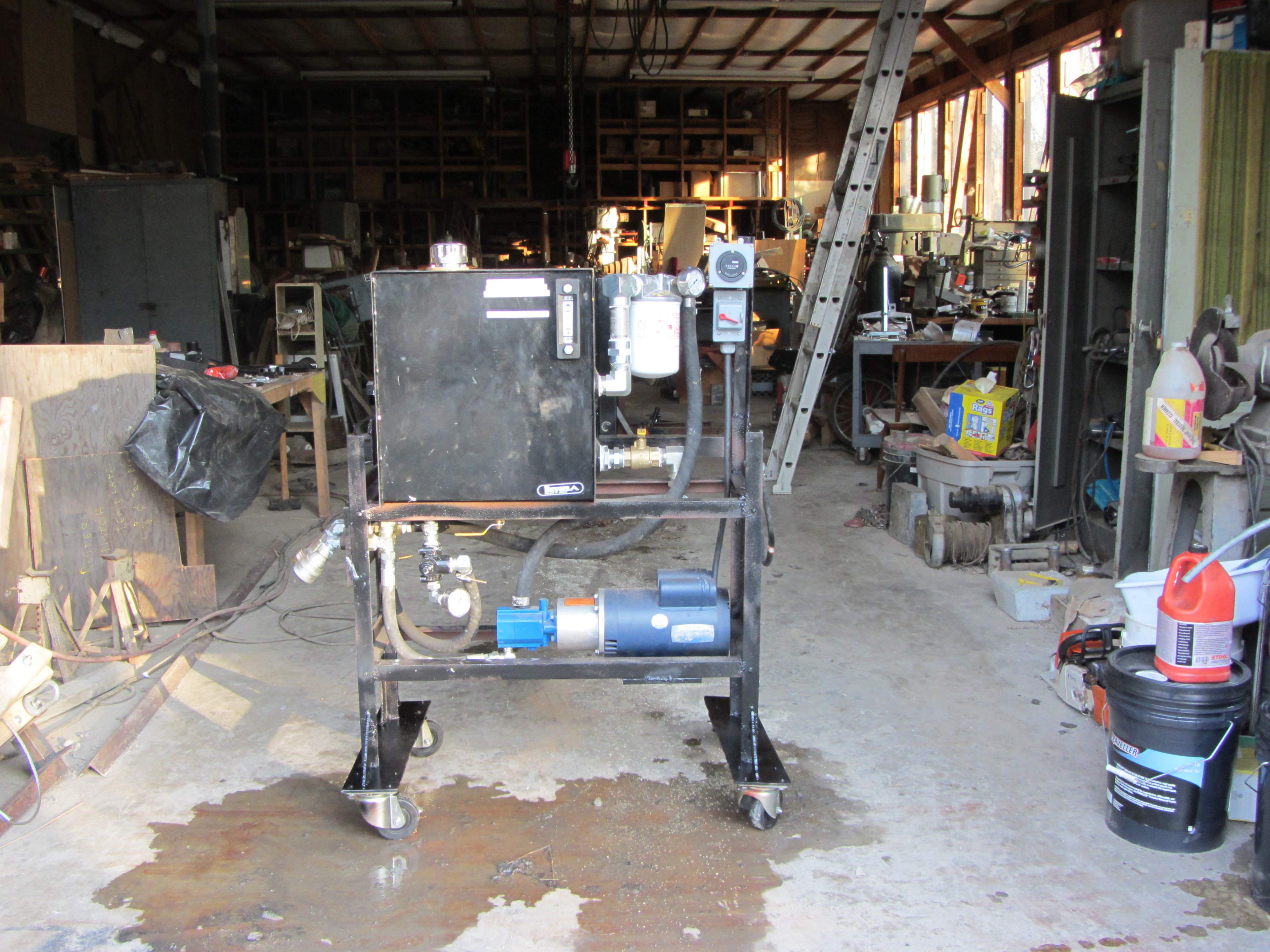

All right The pump package is finished Ready for oil I got ISO 46 oil good efficiency between 0 and 60d F. Should be ok. Who wants to split wood colder or hotter. Maybe oil tomorrow and let it go over the relief valve at 300psi for a while. Let all the little bits make it to the filter. Everything coming back from the beam will return through the filter. The casters are really nice for pushing it around.
Rain tomorrow. I can probably weld on the beam just inside the door. Although it will be in the 50's on Friday.
I forgot to mention that the electrical switch is a 2 pole 30a switch . It is the biggest switch I have ever seen that looks like a normal wall switch. Should handle the 20A load with out any problem at all. Currently I have a 220 15A plug on the line cord. I will probably change that to a 30A plug.
The line cord is 12g but pretty short so I will leave that. I am debating with myself on the out let in the shed. I have run my other splitter off a 12g ext cord from a 220 outlet for 10 years. I want to put a more permanent outlet in and I am trying to decide between 10g romex or 3/4 PVC and pull some 10g pump wire through it. It is all 8ft off the ground and under a roof. PVC is the right way. The feed to the shed is 10g and terminates in PVC now.

/ Woodsplitter build #2 #87
Bit the bullet and use the PVC conduit. If you don't some day you will probably be wishing you had.
Nice build!

Put in 18 gal of oil. Turn the pump by hand for a bit. Backed out the relief valve. Plugged it in. Held my breath and turned it on. 500 psi ran for a while.
All seemed good. Took a breath. Cranked up the pressure at 2400 psi the 20A CB popped. Not unexpected. At 1900 psi it runs on the 20A CB. Then I noticed an oil drip. It was coming off an 1 1/4 pipe. I almost had a heart attack BUT it was a 1/8 pipe plug ,second port for the return gage at the filter.
I never even looked at that fitting other than to notice it had some kind of red sealer on it. I have a spare 4 way out on the beam. Reminds me to use pipe dope on the plugs. The return gage read zero as it should.
No pictures you will have to take my word for a line cord, a gage at 1900 psi and another gage at zero
Swapped out the cb to my shed for a 30A. Now I have to wire out there.
I suppose to test the beam near the shop I will have to run it at 1900 psi. OR make an adapter and plug it in my welder outlet. Think I will do that

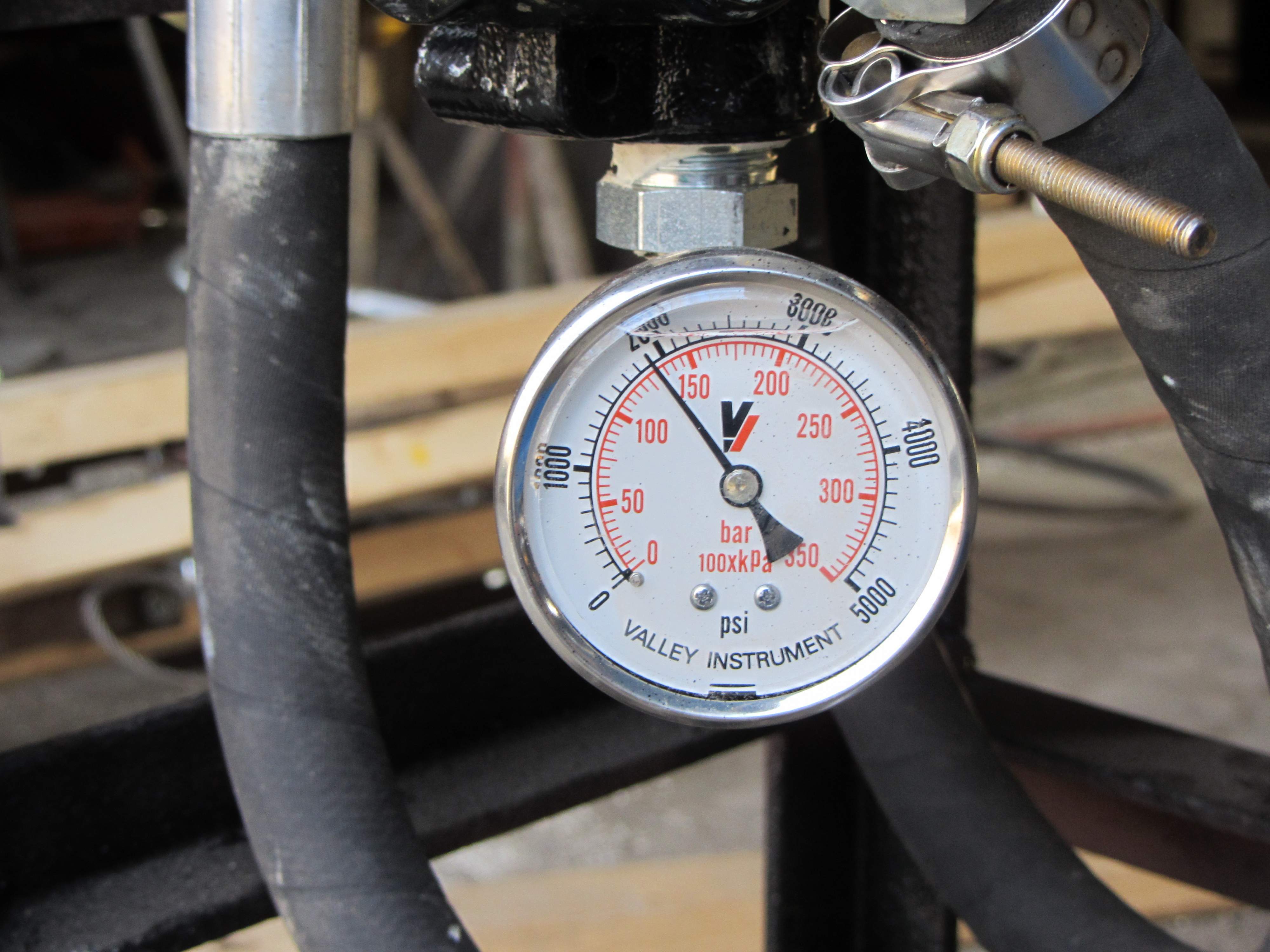

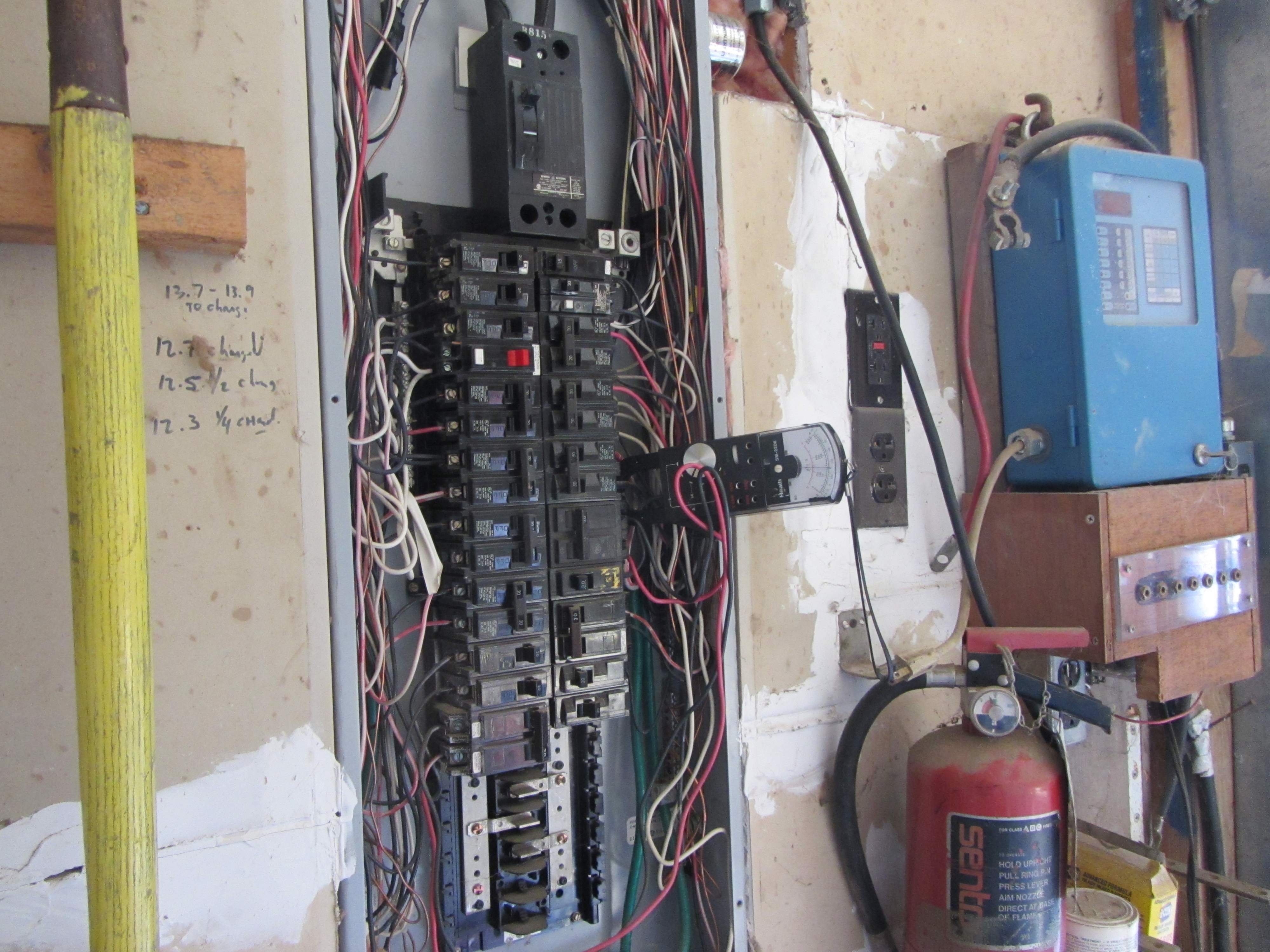

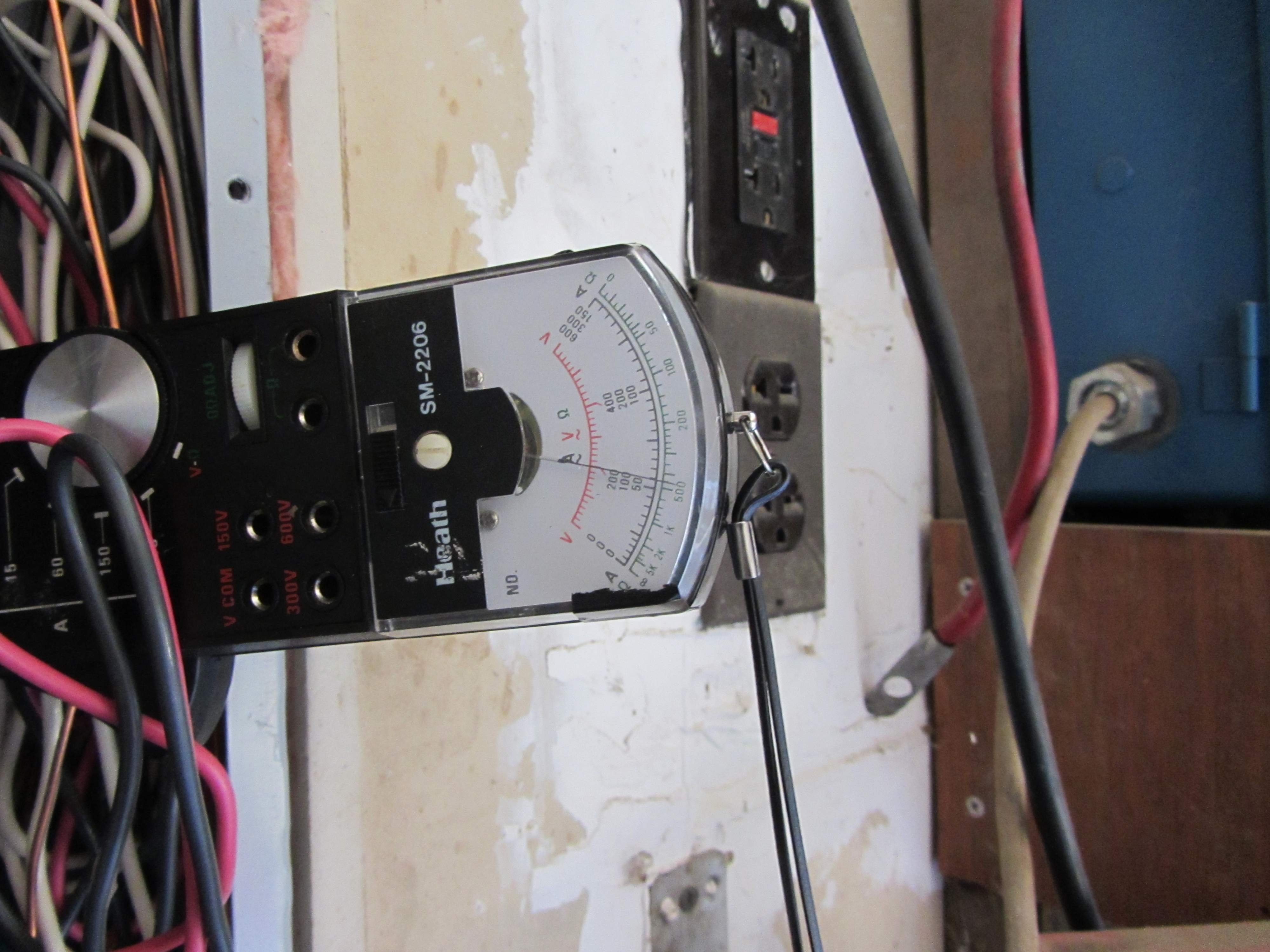

Pictures Running on my 50A welding outlet
The 10ft 10g line cord stayed cold The 12g pigtail to the motor stayed cold
The filter was getting warmer.
Amp meter on 60A scale
1900 psi at 21A
2500 psi at 25 A This is where I wanted to leave it but after 3-4 minutes the thermal cutout in the motor cut out. Motor was hot. This was going to be a safety setting for the pump. I set it at 2000 psi . I will have to see what happens when the beam is connected and most of the flow is at 600 psi, although the flow is higher.
I can always go to a ,shutter, fossil fuel fired engine.
The hour meter seems to be running fast. Don't know how that can be , they clock off 60 hz. I will time it with a watch some time. Maybe I am having so much fun time just passes.
Edit: What am I thinking. Set the relief at 2500. It's a safety. I don't care if the motor stops 5 min after oil is going over that valve. It should never happen. I can set the valve on the splitter ram cylinder to the minimum that works.

You guys forgot to tell me that the difference between a 20" cylinder and a 24" cylinder is 8" not 4". I had to unbolt the cylinder anchor , unbolt the hydraulic tailgate , put the mag drill back up there and drill 4 more holes. I debated with myself for a while whether or not to bother but I finally decided to do it. Also finished, almost , the mount for the log lifter. Needs some right angle braces but I need to put it together to see where they go. Finished the mount for the off side log stop. Just going to stick bent 3/4 rebar in those pipe sleeves with those orange caps on the ends.
Started thinking about the outfeed mount. Looks like 3/4 pipe will slide nice and loose into 1 1/4. I have to find a couple of feet of 1 1/4 pipe somewhere.
It was cold today, well 33F and once I got the shop warm I did not feel like opening the door to take the tractor out. I wanted to collect some amps vs PSI data points. Need the space to get the pump unit closer to the welder outlet.
50d F tomorrow , good day for that .
I plotted the 2 points I have and the theoretical lets see if I can attach it. The 2 points in green are real measurments. The others derive from the PSI x gpm /1714 = hp and then converted to kw and then amps. They are not too out of line from each other . I am curious to see what the rest of the real numbers are.
One of these days I will move the beam outside and leave it there Then I will have to run it

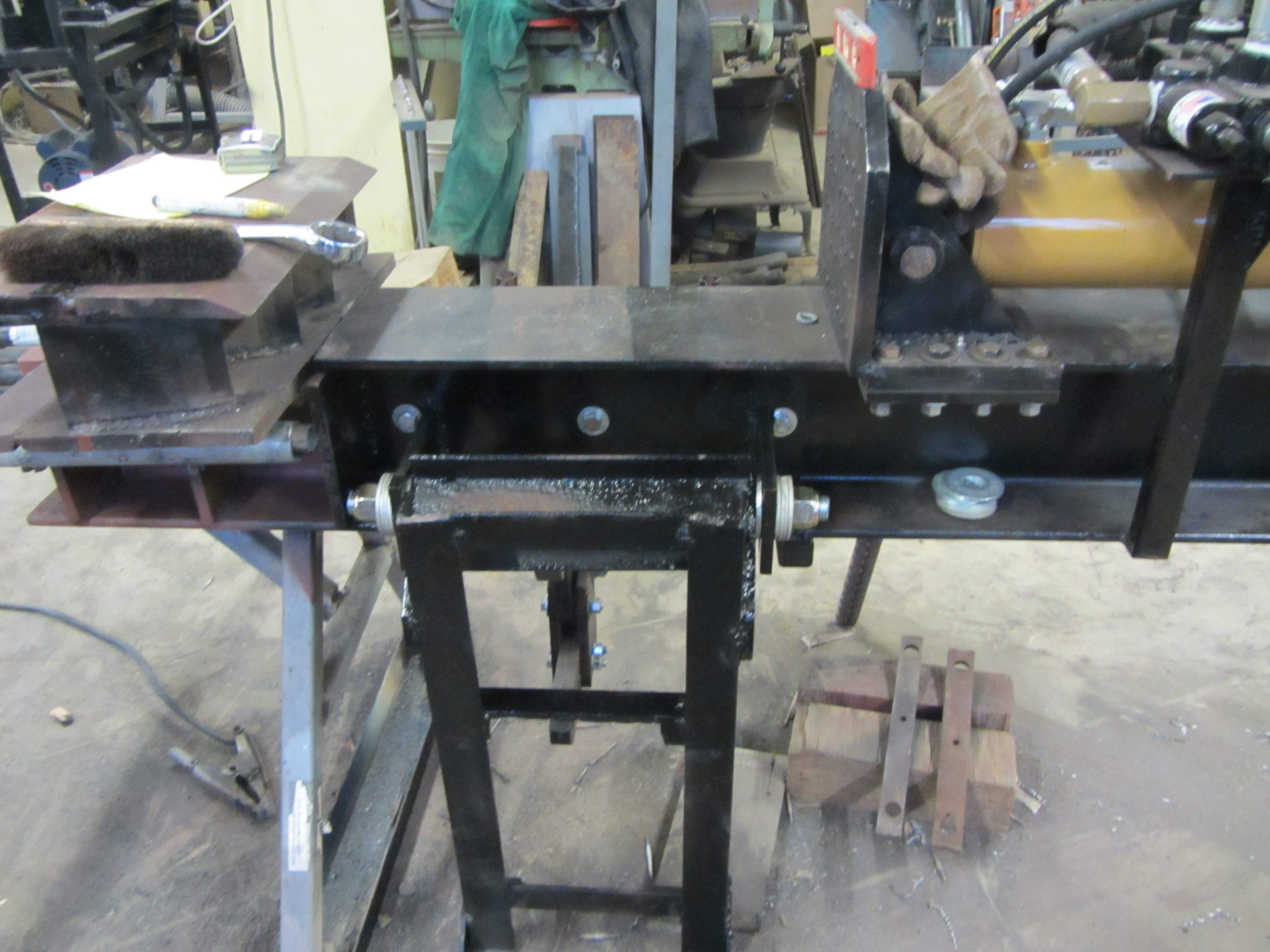

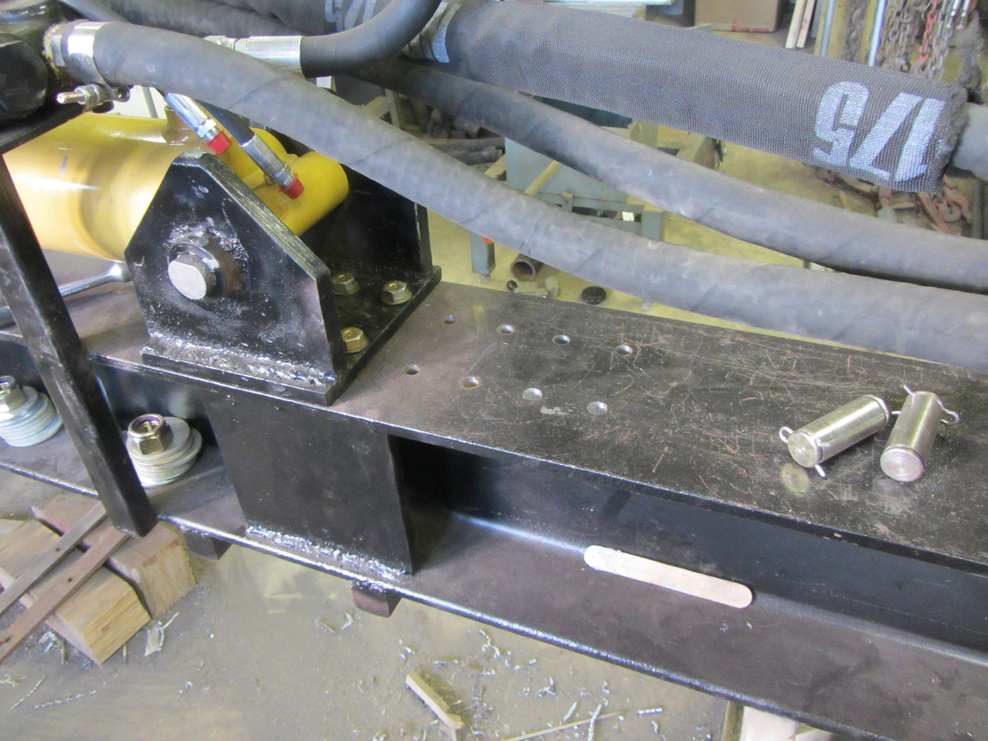

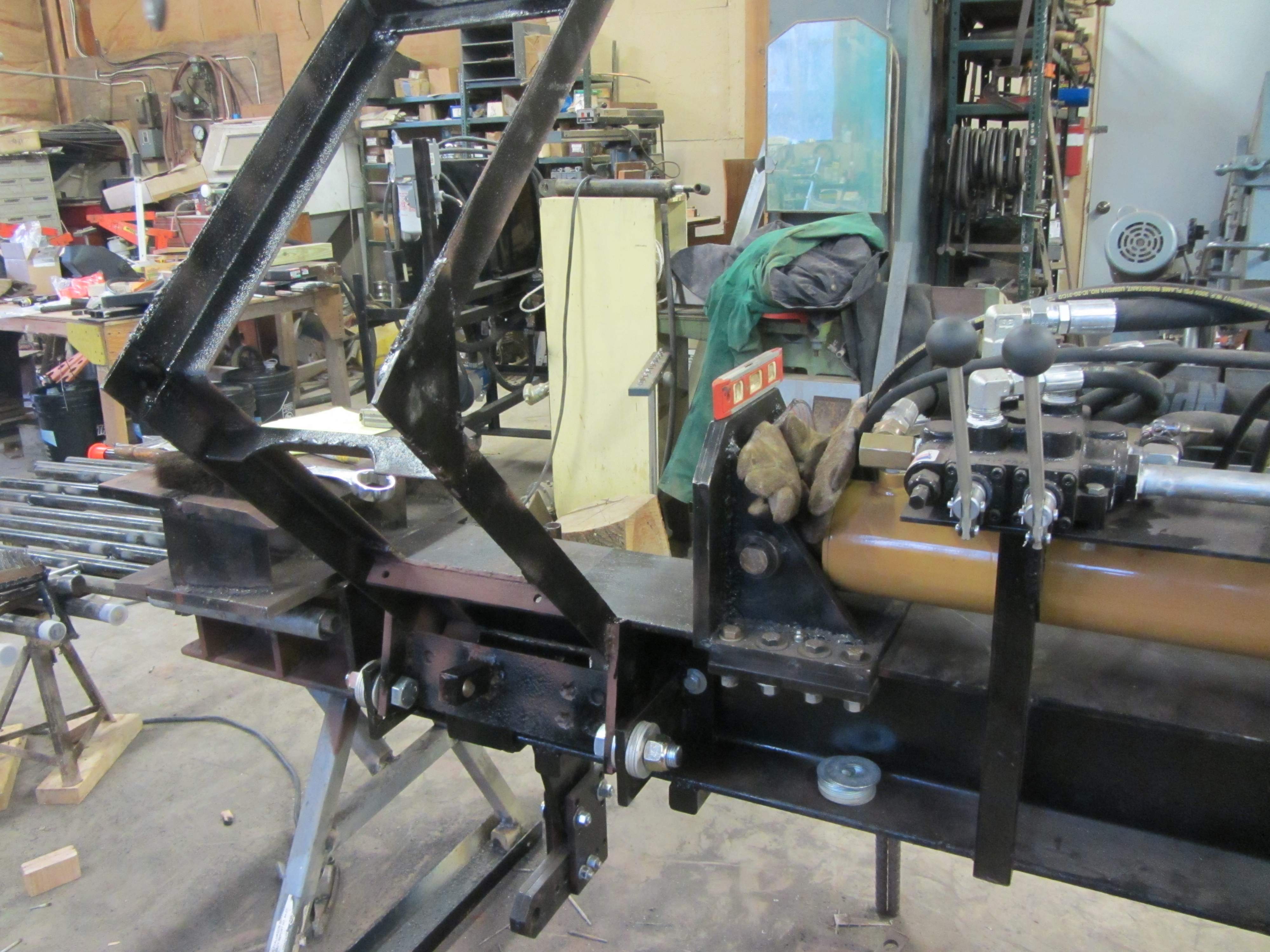

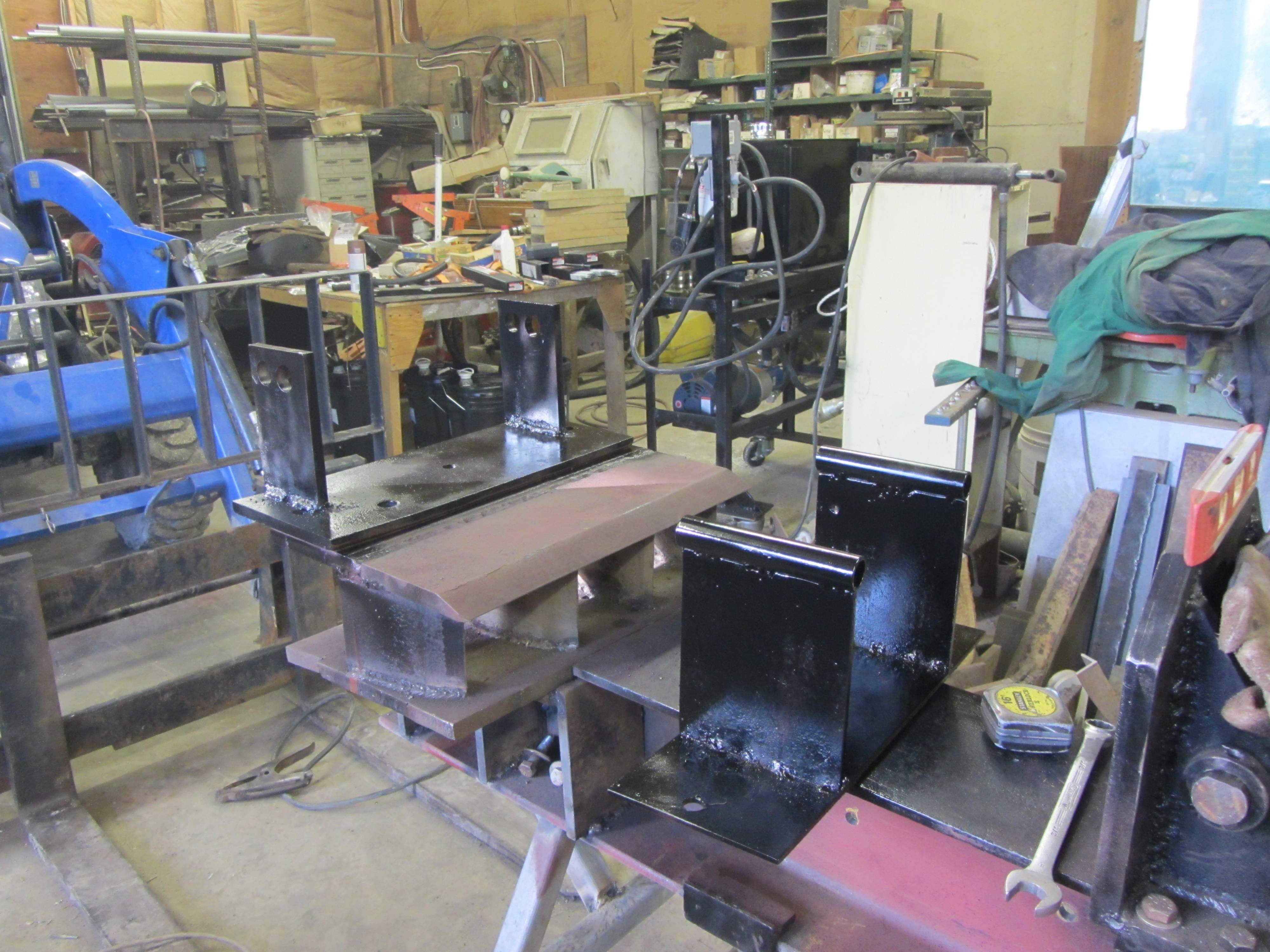

Almost there. Bolted on lifter bracket and off side mount. Bolted in the lifter. This is the first time those big nuts have been on the pivot bolts. The up position with out the cylinder is the travel position. IF you look at very first pictures you can see forklift pockets. The left hand one ended up under the log lifter . That why the cylinder push point is off center and why there is a travel position. I am going to run the lifter one more time on air to make sure up is slightly beyond horizontal.
Also got the out feed table going. I worked till 5pm today IT was warm out but it was 2 hrs past my quitting time. So of course I managed to goof up a few things. Lost track of my tape measure and the angle iron is an inch longer on one side than the other, Also welded a bar right over the bend slot on both sides. I can weld on an inch if I need to. Cutting out welds is what grinders are for. IT is heavy , I will need legs at the end, Pipe and pads. Good thing I have forks for my tractor. Those orange things are rebar caps. I got 10 for $5.

/ Woodsplitter build #2 #95
Bob are you going to put a lip around the outfeed?
I have about a 6" lip around mine and it does a good job keeping the rounds from shooting off. Something to think about.
#96
Yes I am Just got late and I was tired of bending over. I think I have to extend a couple of the inner ones back past the splitter
