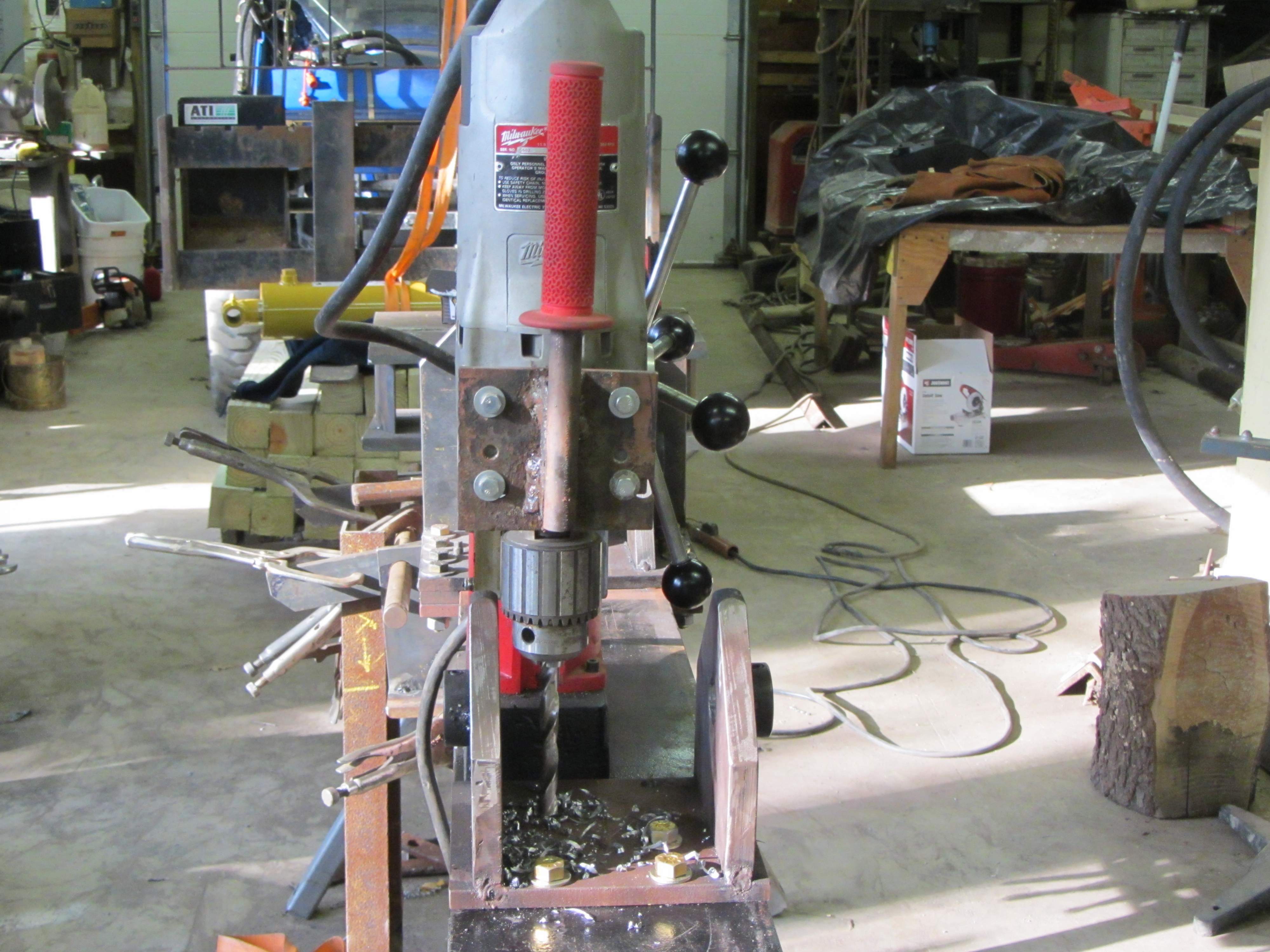

I think I am done with 1" diameter holes. Actually 1 1/32 is what I use for 1" pins. I bought a special drill for that. My drill press does not like anything over 3/4 so all those big holes have to go on the mill. Sometimes the vise and sometimes clamped to the table. It's a bigger deal than just jumping on the drill press. So 4 hours today. I have more time in the lifter than I have in the beam and ram. Feels like it anyway. I was tacking and something got around the hood and around my safety glasses and hit the corner of my eye. Never had that happen before. If I tell my wife she will make me go to the eye DR. Not yet it's way off in the corner , I will see what it's like tomorrow. Besides I still got the drops from the last time I got something in my eye, which was the end of the bottle of eye drops. go figure. I will try for pictures tomorrow.

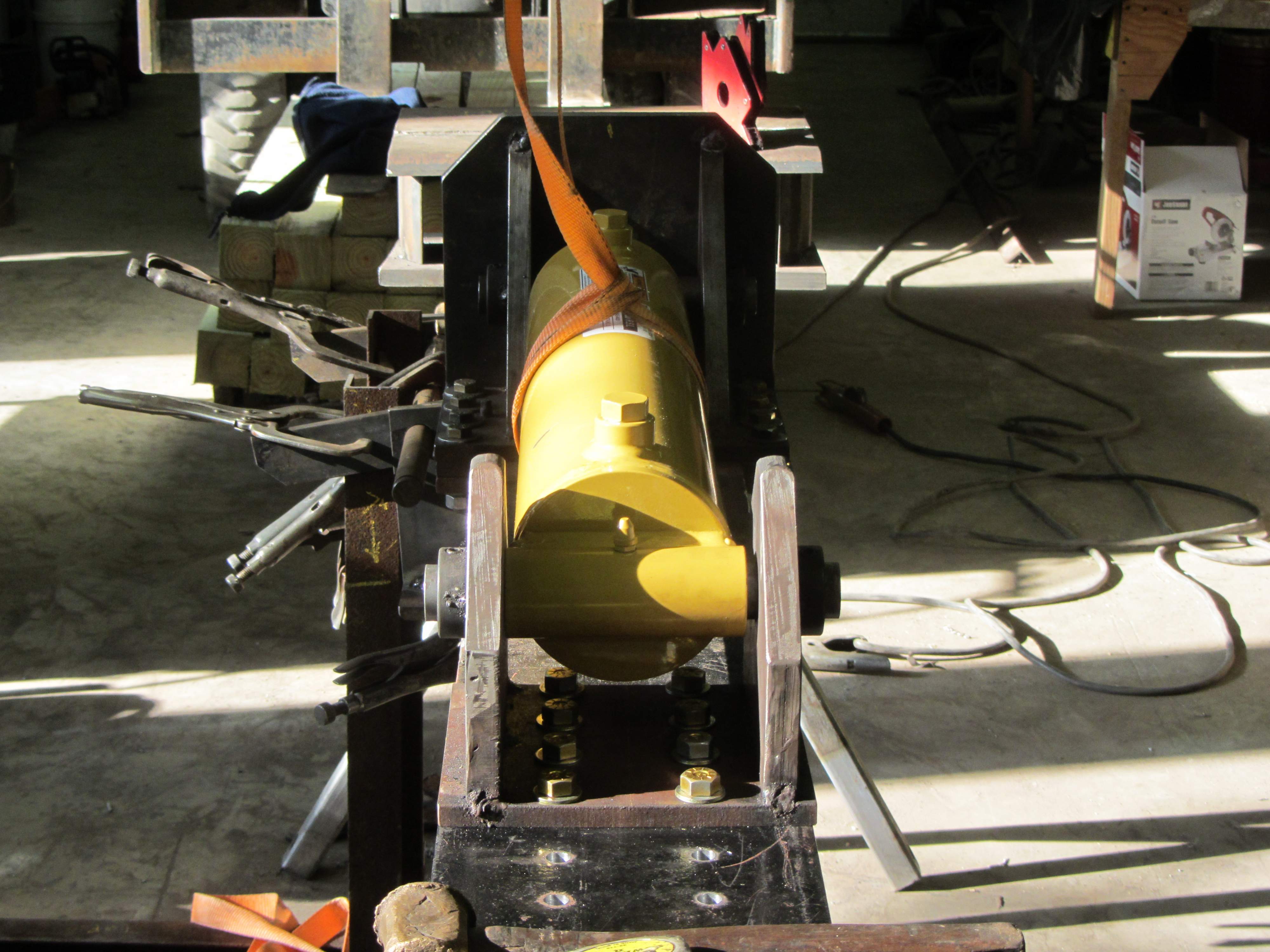

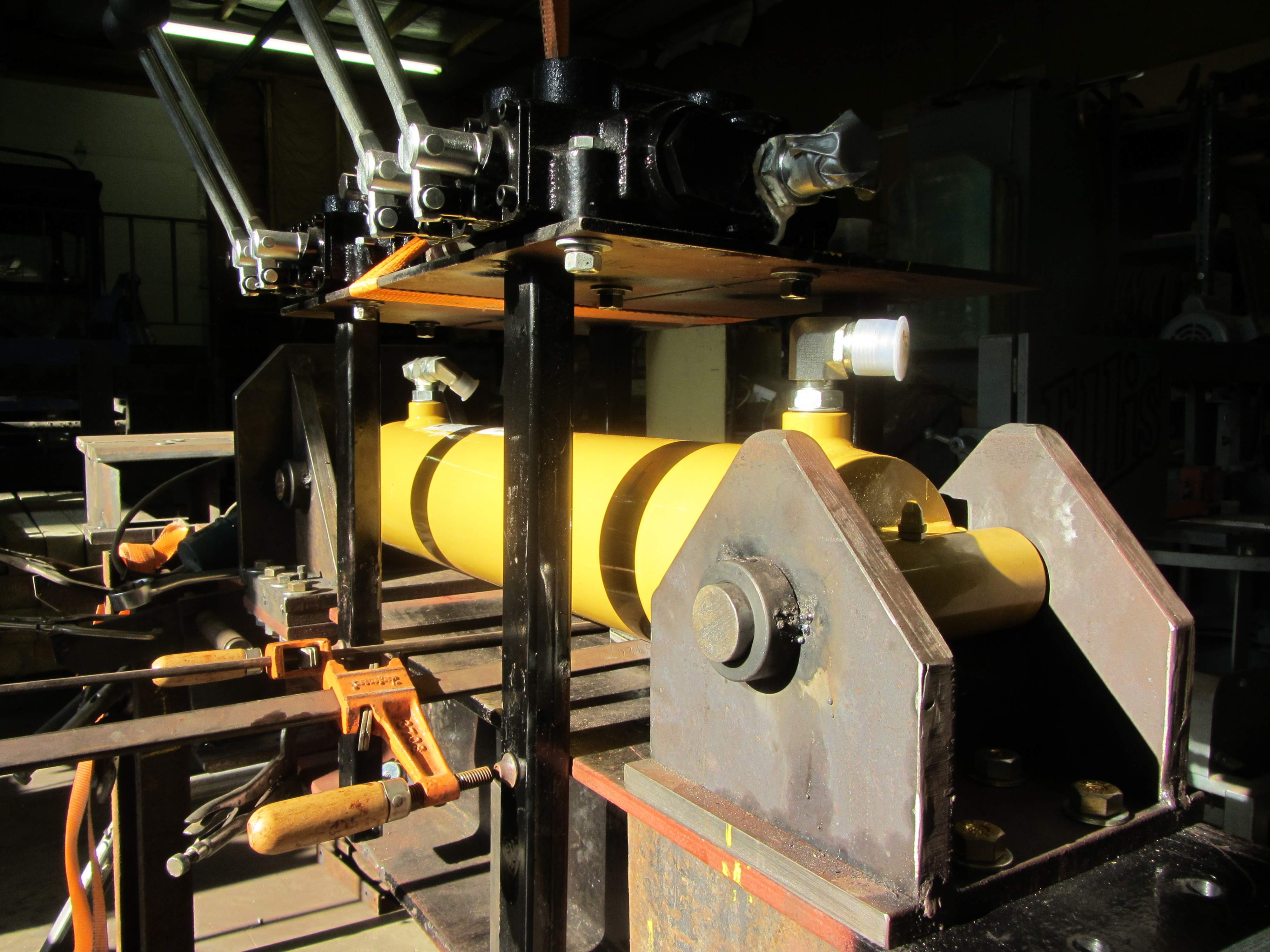

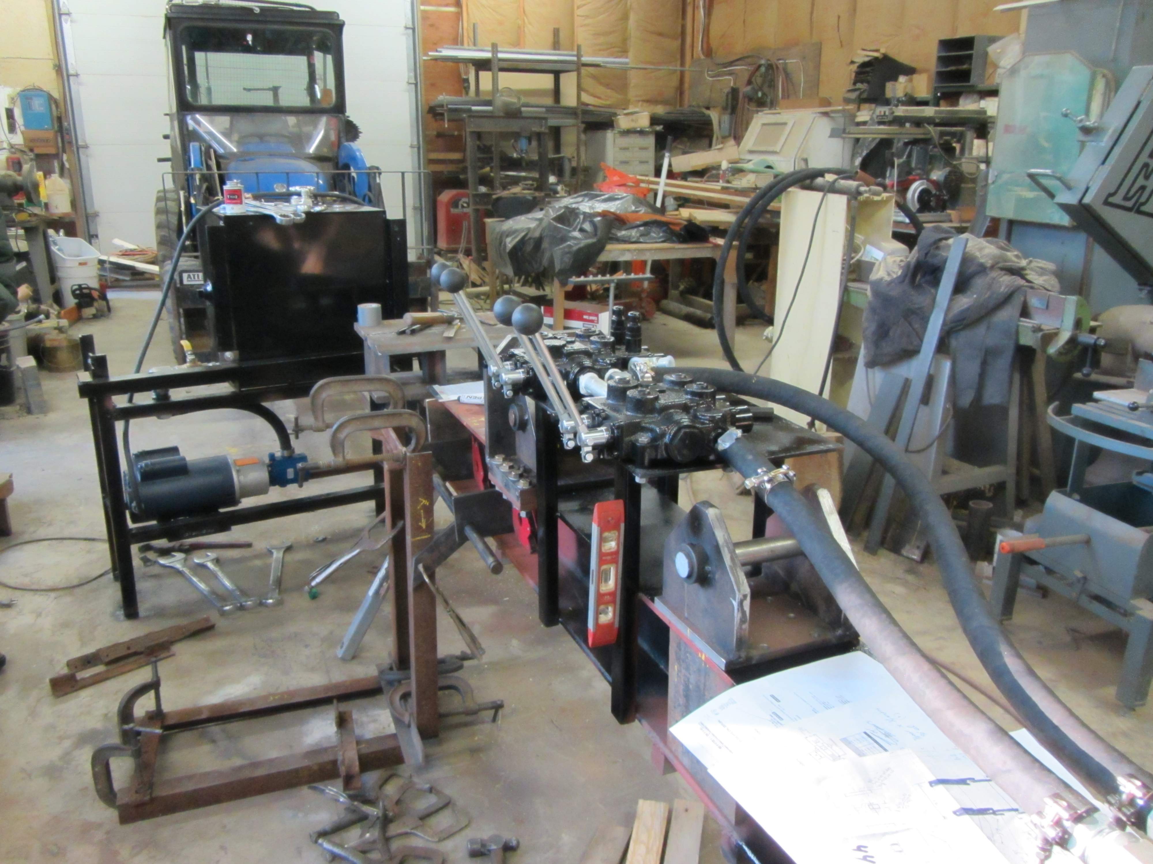

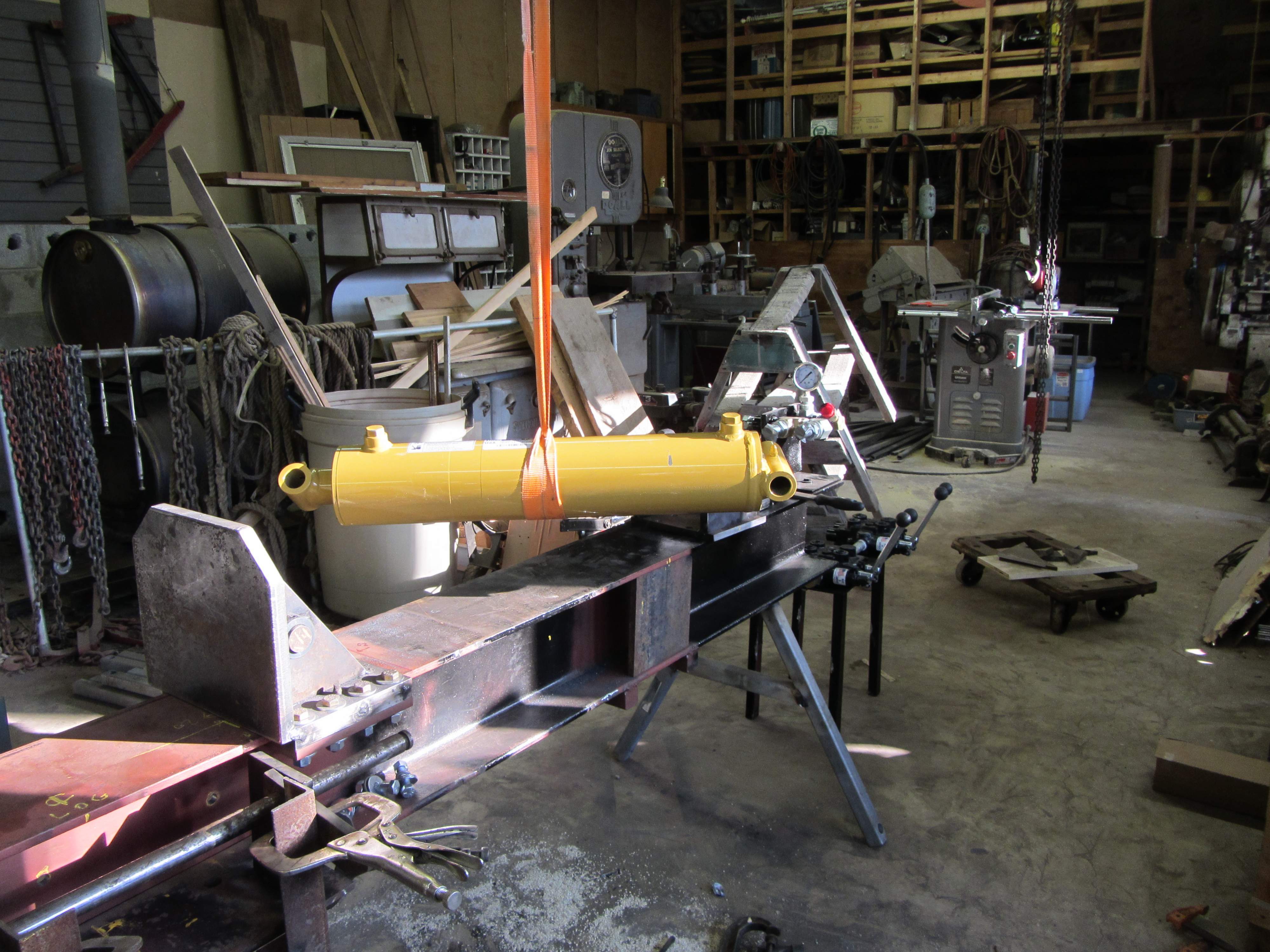

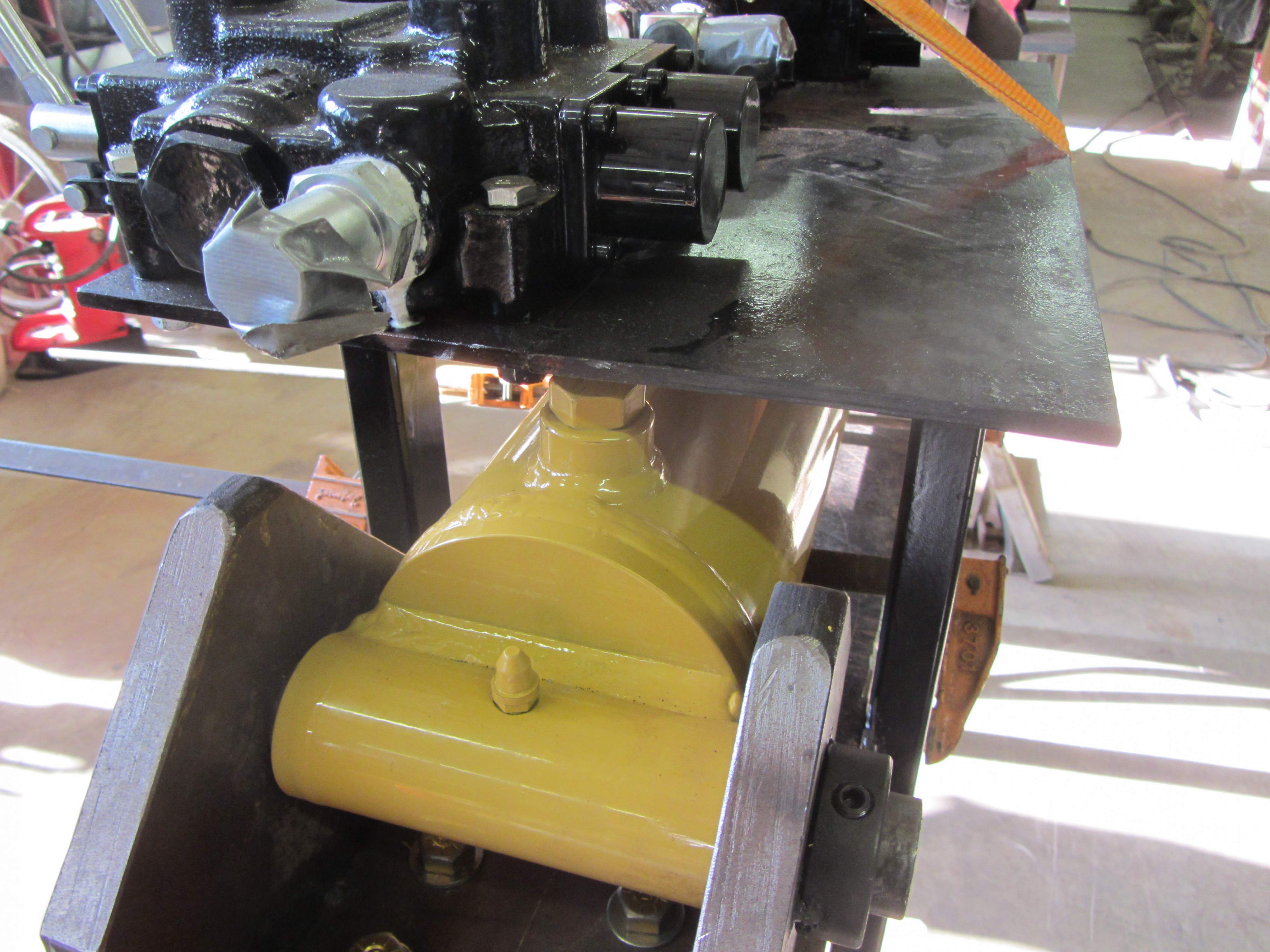

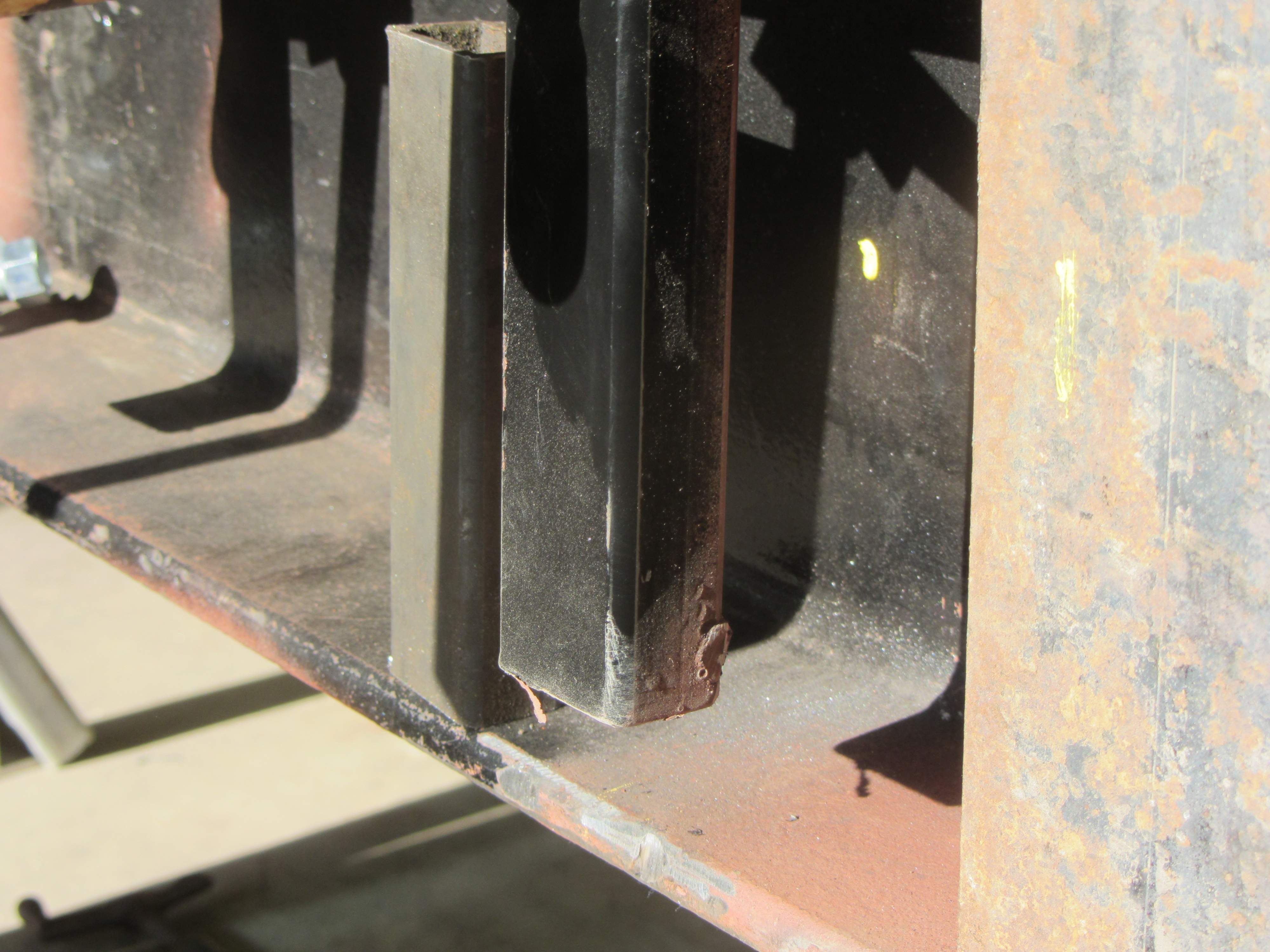

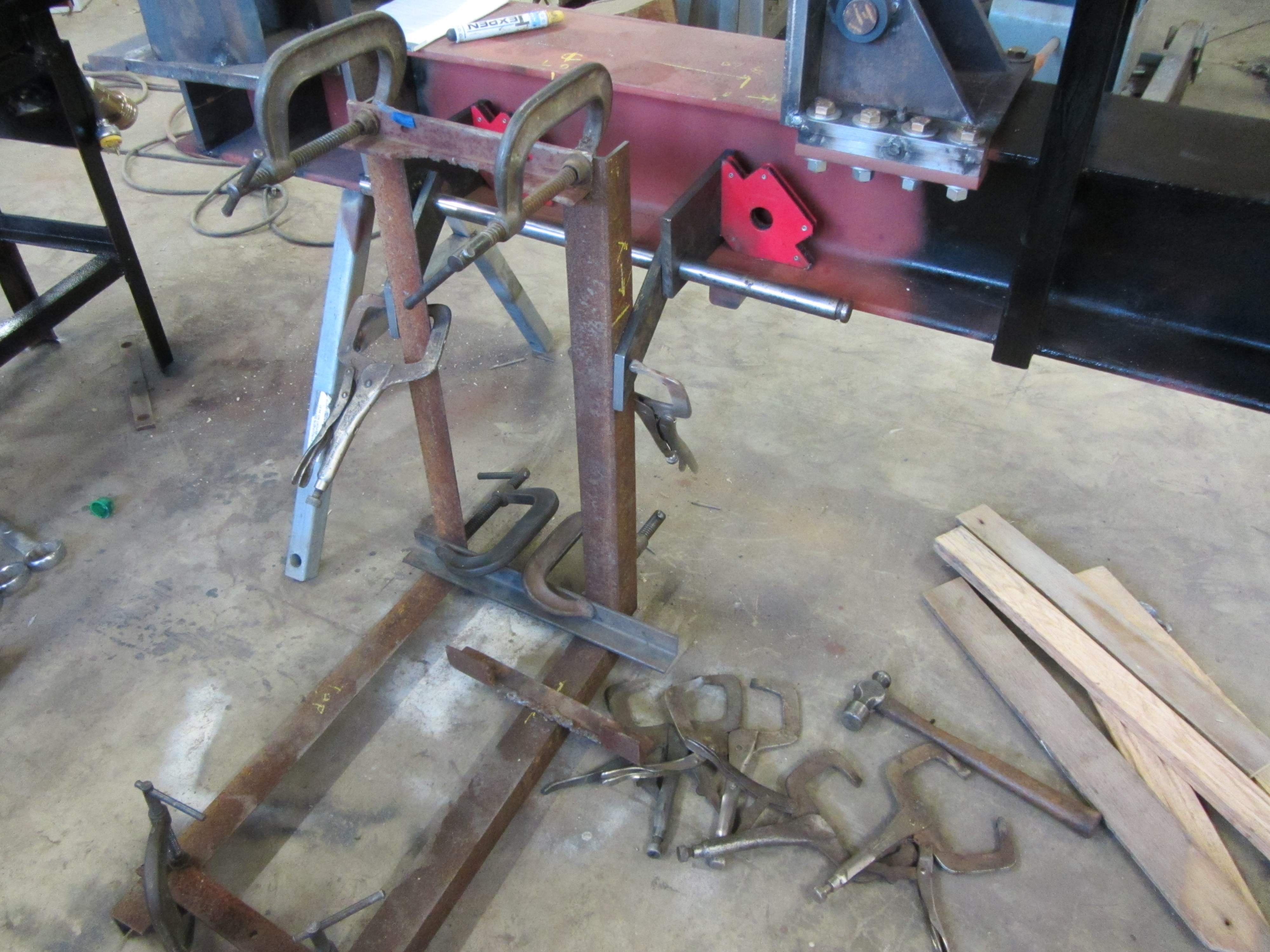

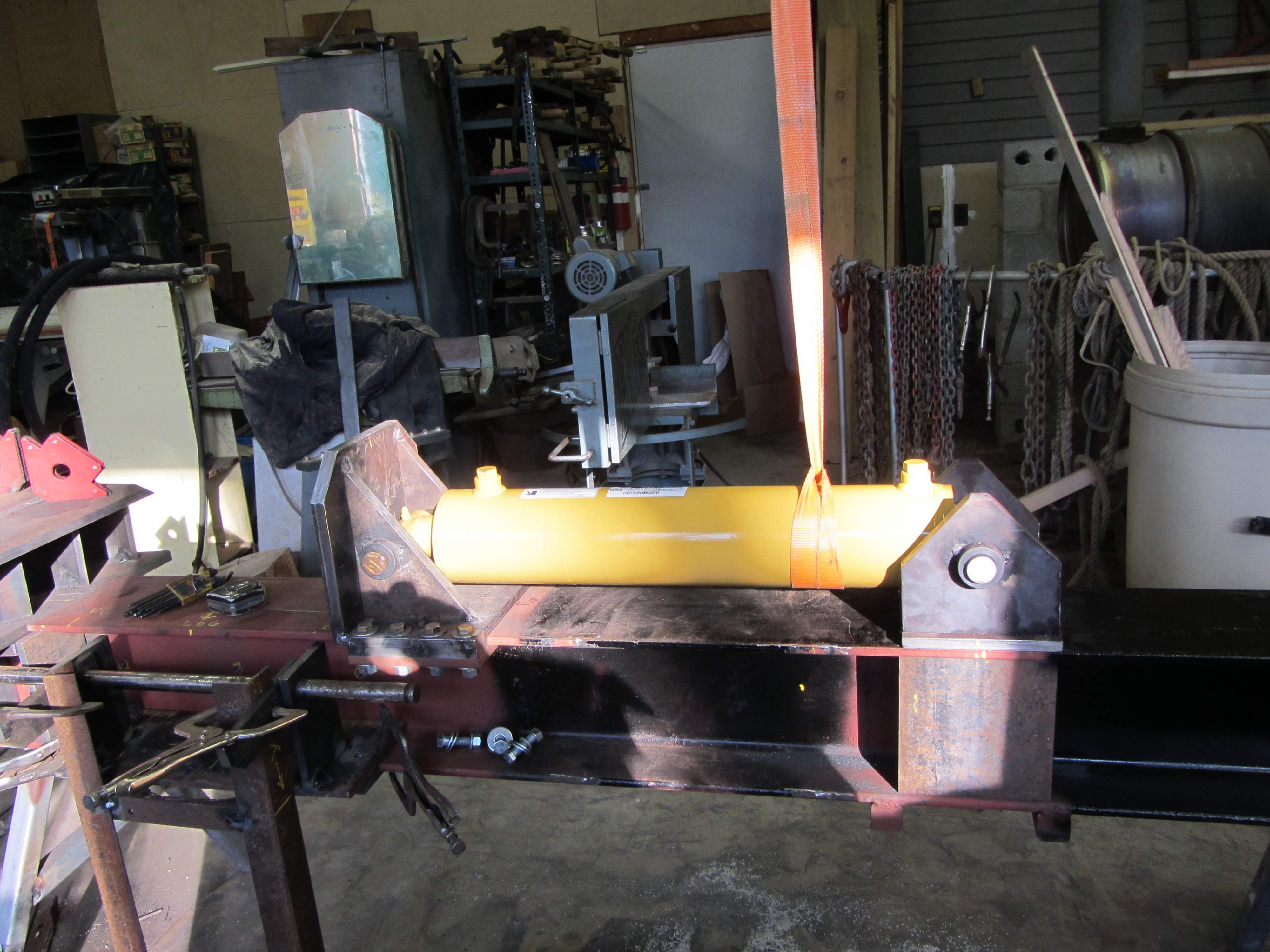

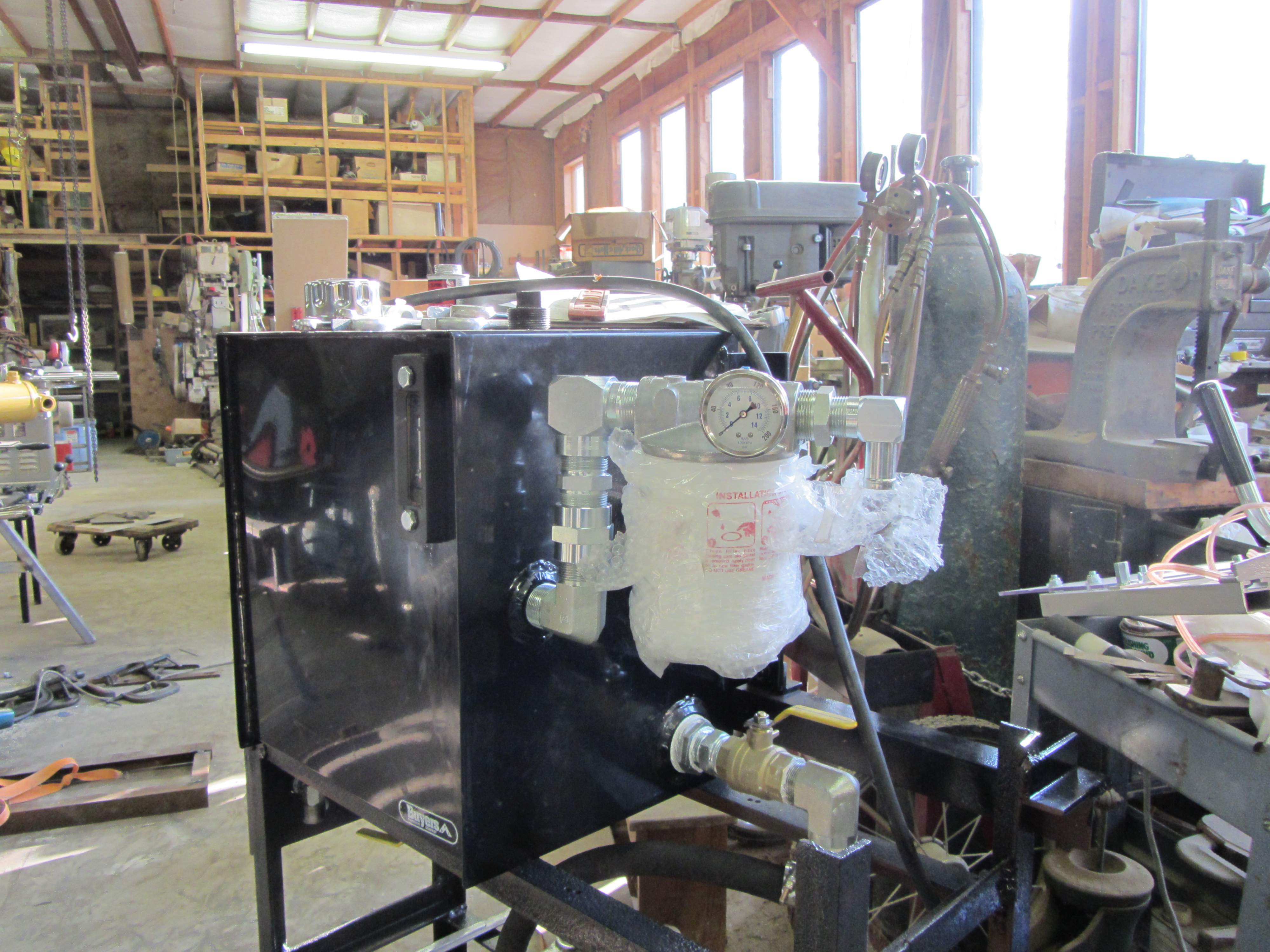

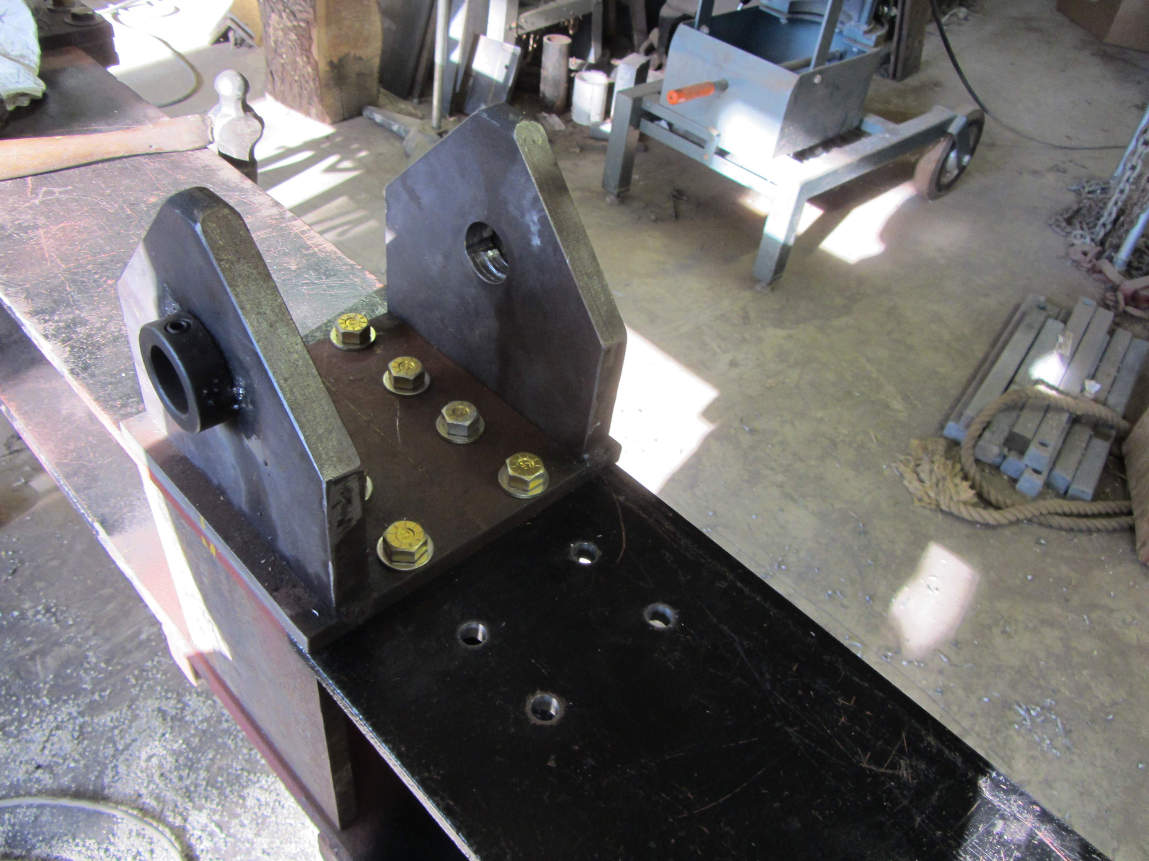

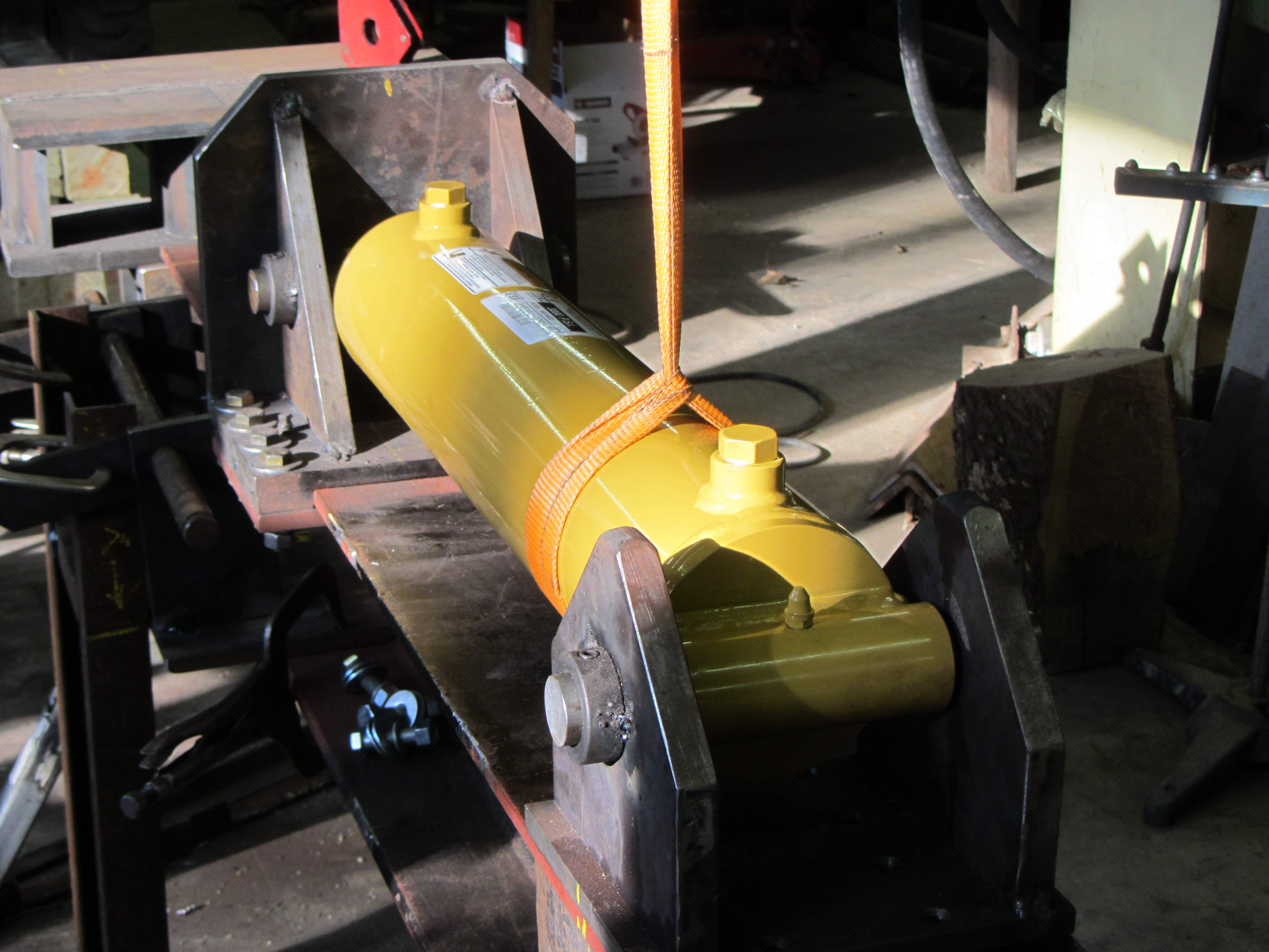

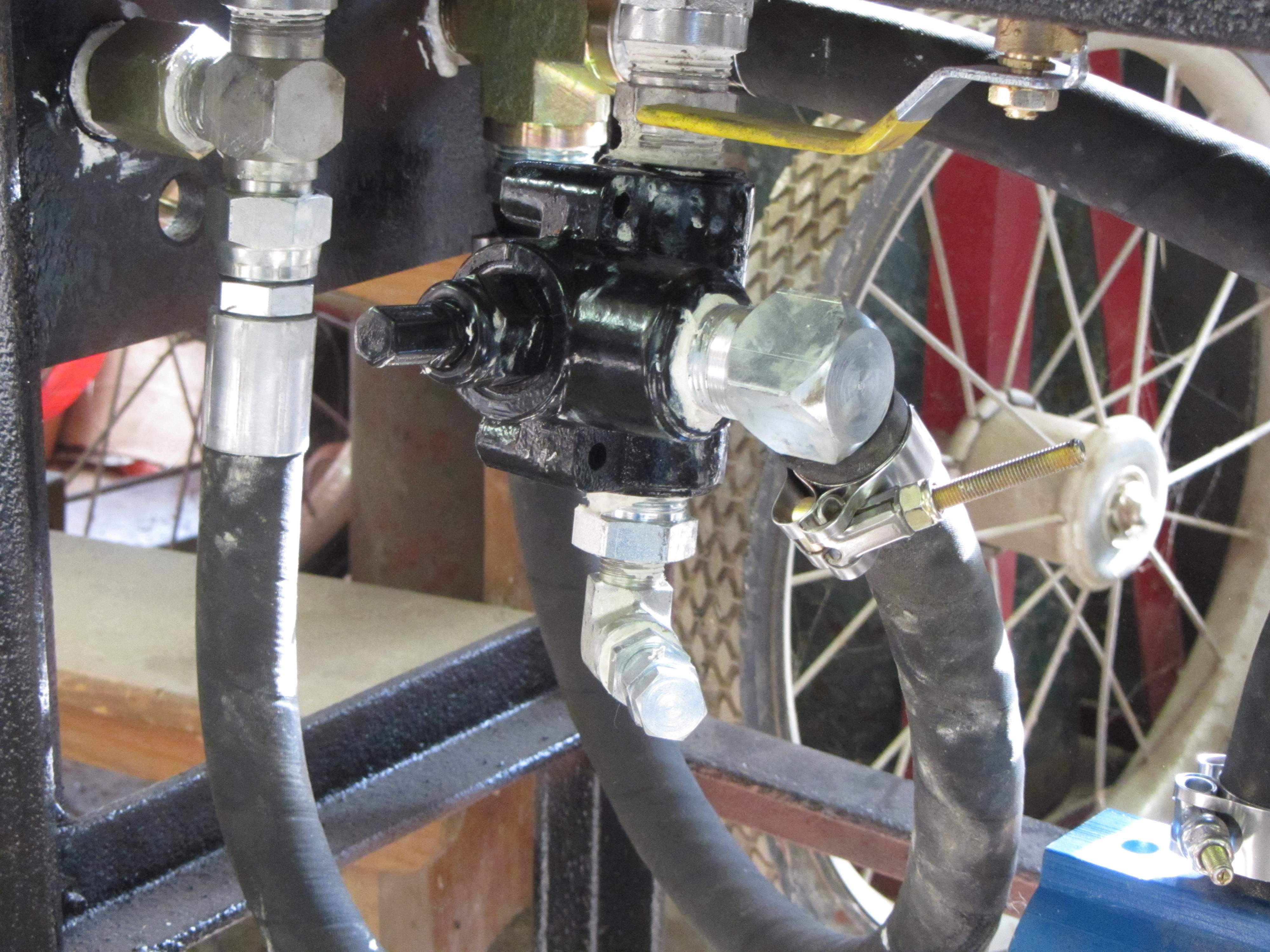

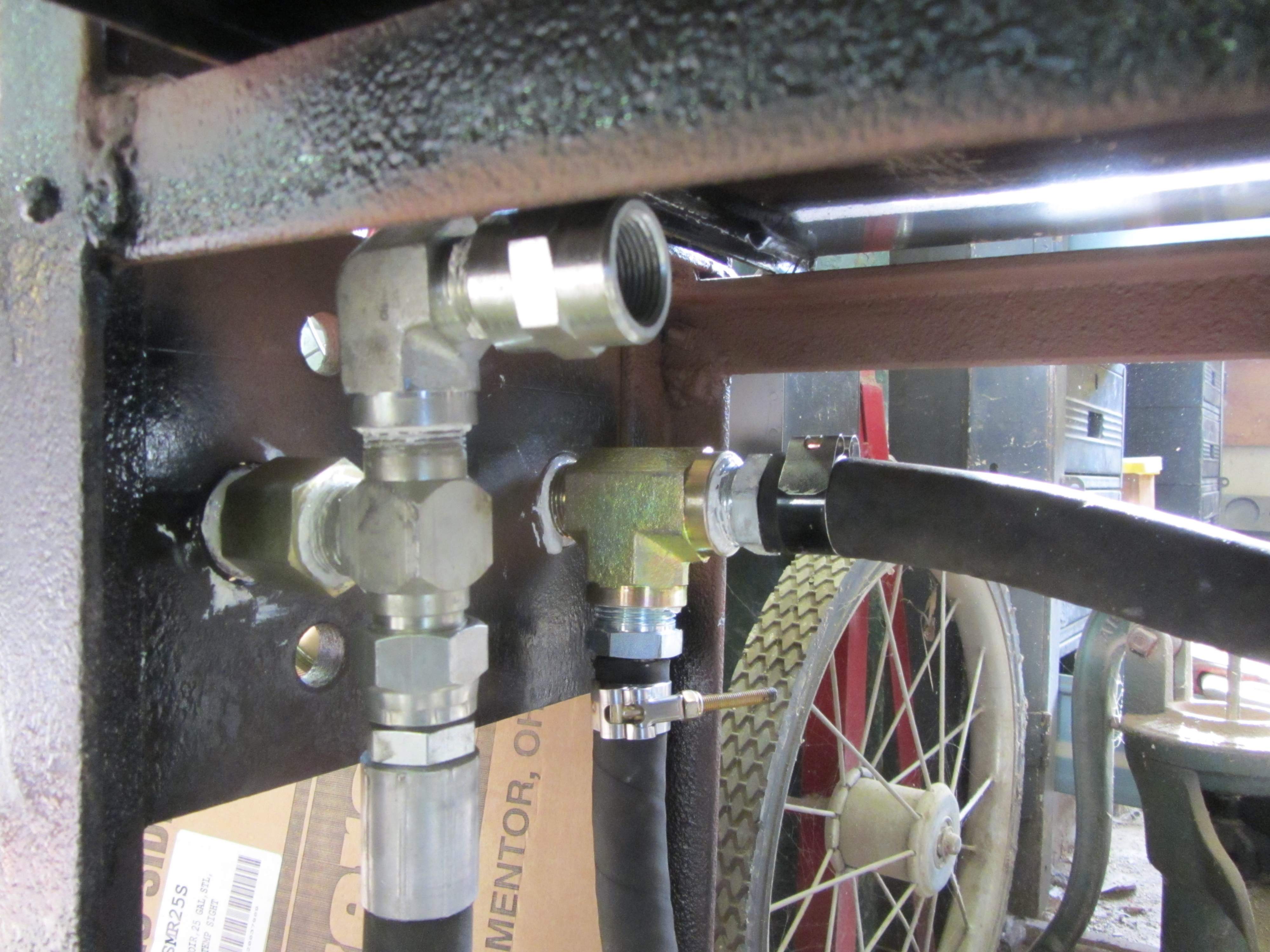

pictures today maybe 4 steps forward and 1 step back. Soon I will own stock in DHH.

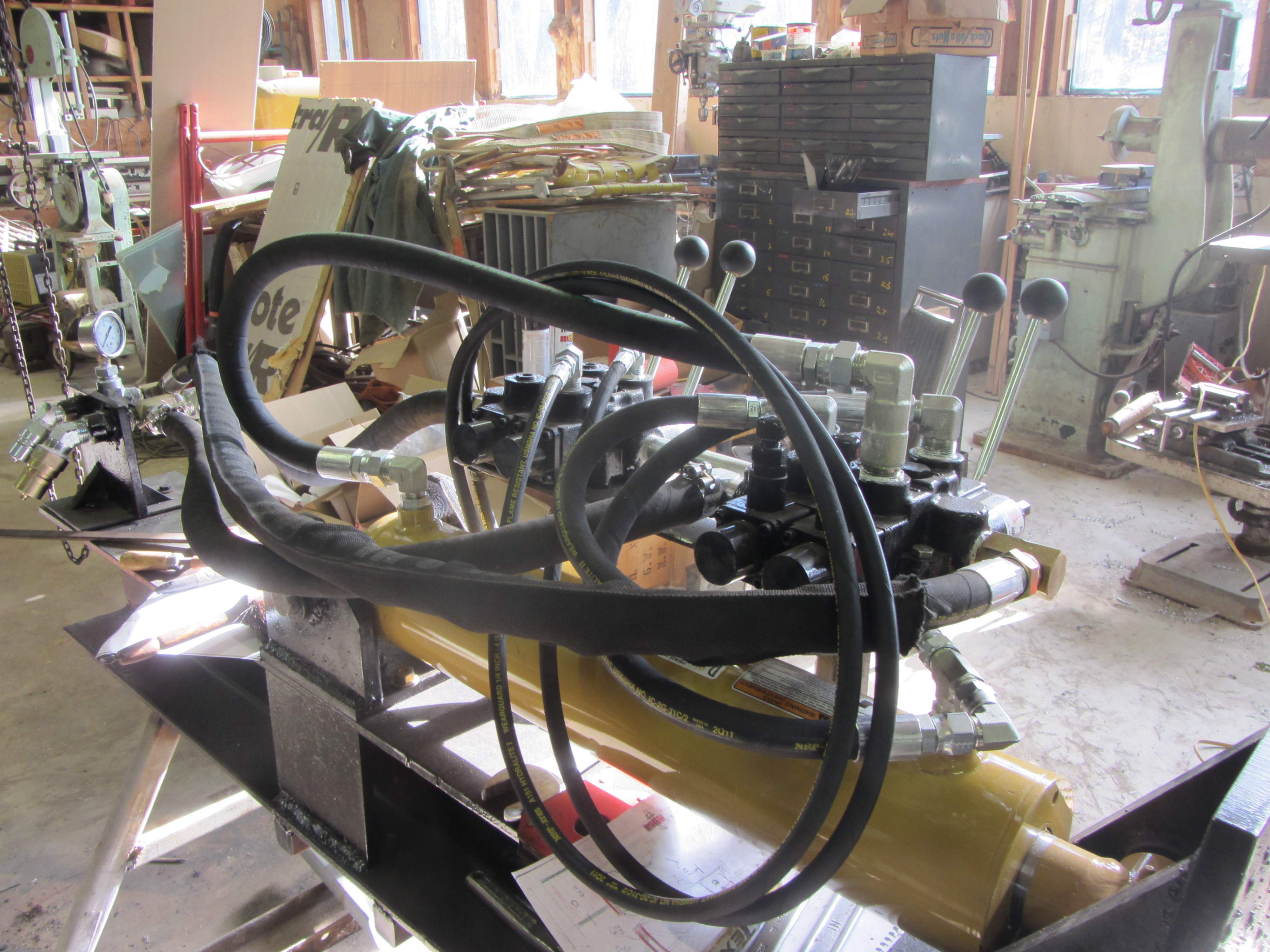

First picture all the hoses on the beam. the 1/4 are just folded over. They go to the lifter. The main cylinder hoses are probably 6 " to short . IF they leak I will get ones 12" longer.
Second picture relief valve for the power supply. This was an engineering change so of course I am placing the 3rd fitting order .
3rd picture The space I cannot spin the valve in. I guess I could have taken the cartridge out of the housing but then I would have to put a perfectly good valve back together. I always make this mistake, think I am going to get exactly the fittings need, then get fed up and get extra, then trip over the extra , they are never right for the next job anyway, then I get extra again. Most of the time to get to DHH $20 min.

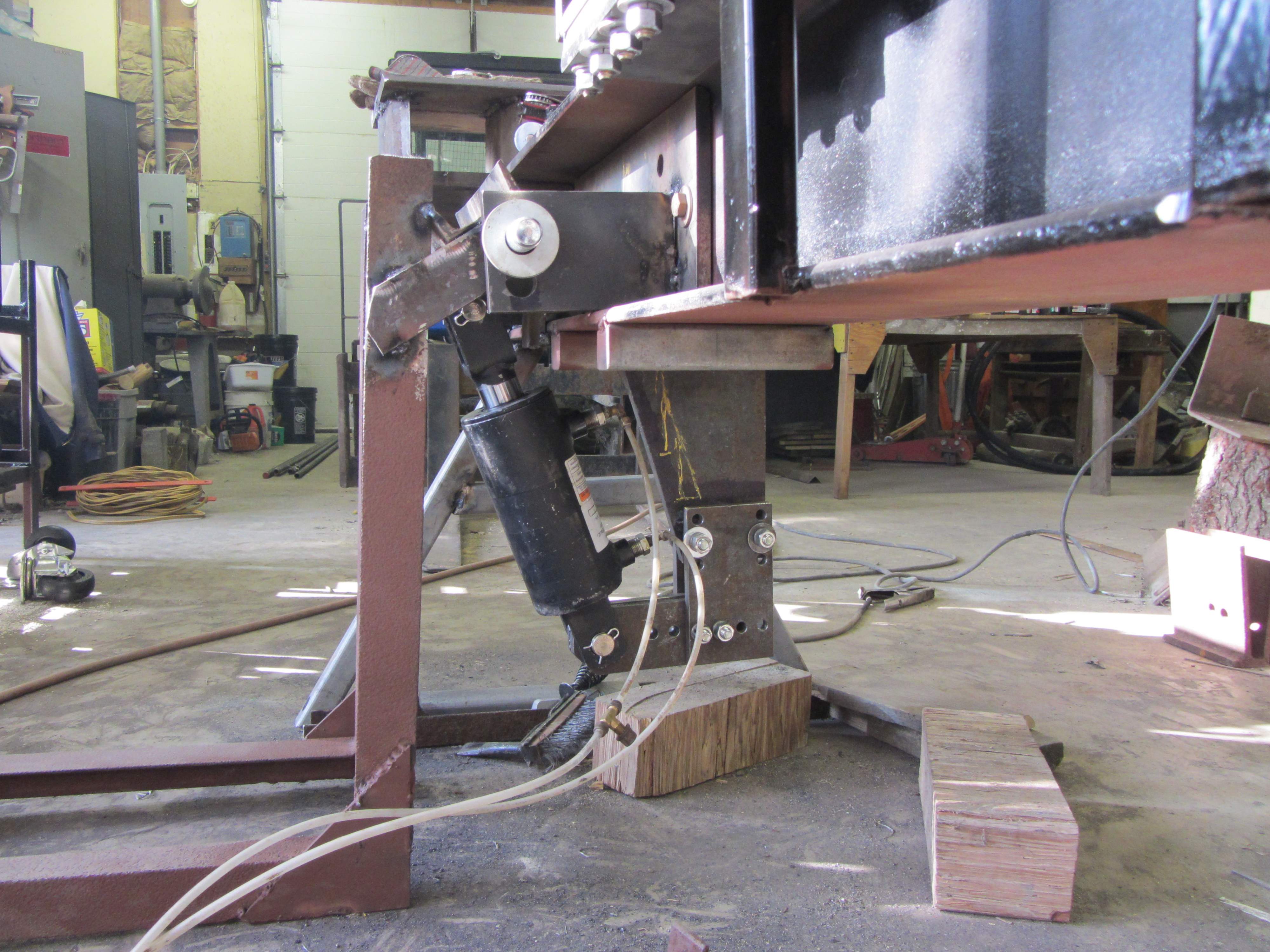

4th picture Finally found the right spot for the cylinder anchor. lifter down

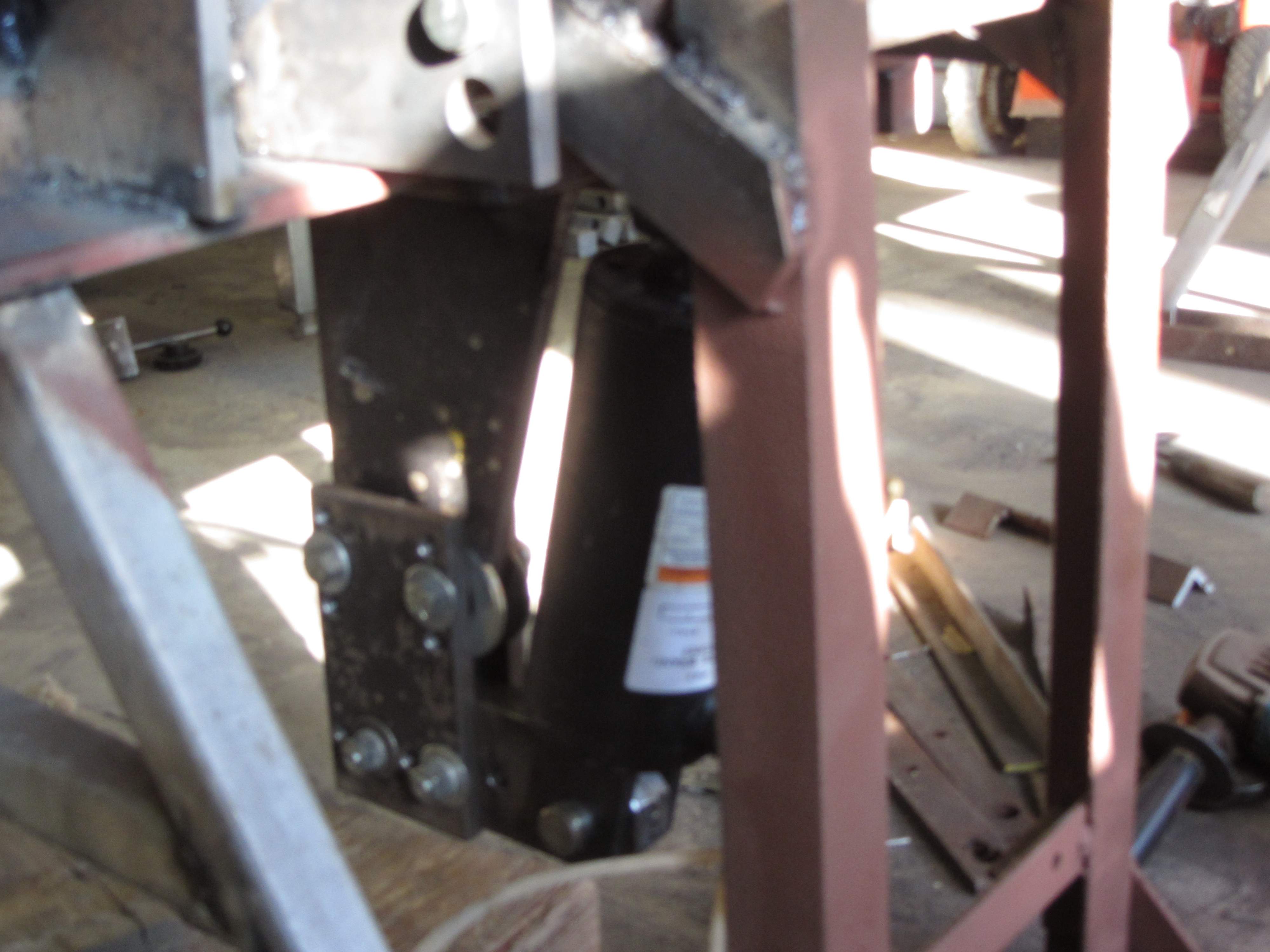

last picture lifter up.
Lot of give in the cylinder anchor with 80psi on the 3.5 " diam cylinder . Used up an inch of travel before the lifter started to move. Of coarse it is clamped mostly. I still want to bolt it in and it is pretty impossible to drill any more holes in the beam now. Well not impossible but ugly. I could weld clips to the beam and bolt to them. I sort of have that started but I don't like it. I need a rest. Tomorrow is an all day volunteer job. Handrail posts on an Appalacian trail boardwalk. last last picture

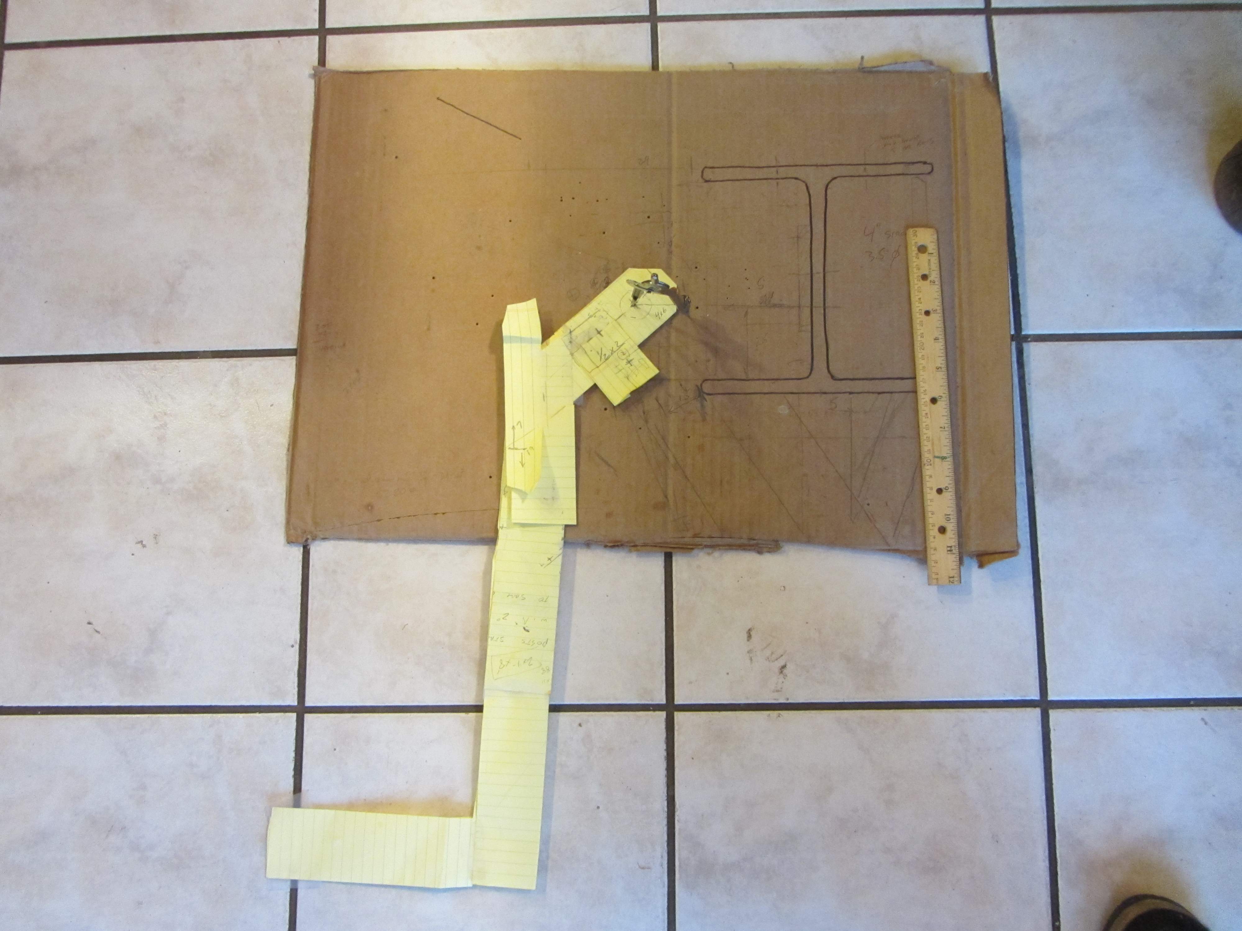

Big step forward yesterday. The log lifter works with air. I took a movie. Lets see if I can load it. My Son in law did the last one. While I am trying to figure that out 15 gal of hydraulic fluid and 40ft of 3/4 pipe for the out rack. Got 10ft a week ago. Finally changed the blade on my bandsaw. I have never had a pile of metal chips this big. Second photo is the cylinder mount for the log lift.
I finally sat down and made drawings of each part. I put the pieces in the mill and put the 1/2 bolt holes in on a grid. So I could move the pieces around to make adjustments and have all the bolt holes line up. Took a couple of hours and it was worth it. I moved them twice to get it where it is in the movie. You can see that I have way more lift than I need so I am going move the cylinder back 1 hole so it will not go so high. OF course it will go lower then but I can put a collar stop on the shaft. I also want to get the hose fittings on the back side. That may require some rework in some of the plates or maybe just 1 plate. The main vertical is just tacked in .
Sorry about the focus. New camera it wants 1/2 down on the shutter button for , I guess 1/2 second before pushing all the way down.

Lifter looks good. I think you may have a bit more travel than you need however. I go just to slightly above the horizontal with mine. If you move the base of the cylinder more horizontal, not only will you reduce the vertical travel, but you'll gain some leverage for the lift. Its going to be quite a push as its set up now.
For layout, i do all my designs in Solidworks. It sure helps getting angles and positions right. You can simulate all the range of motion.
If you might want to give 3d modeling a try, have a look at Sketchup. Its free.

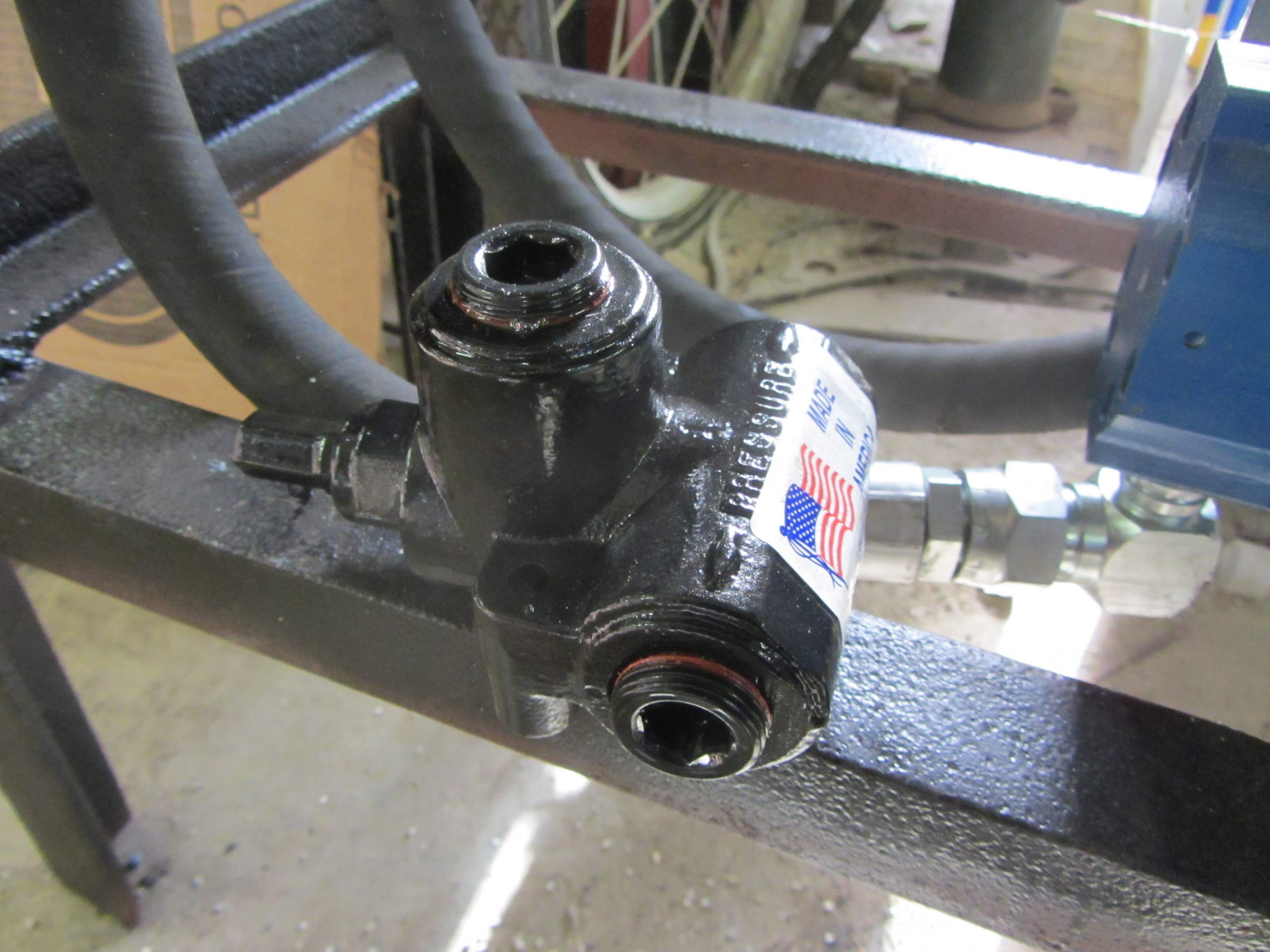

I have a gage port on the pressure line out of the pump. I do not plan on leaving the gage installed there. I have one permanently installed on the beam. I do not plan on a valve or QD when I disconnect the gage on the pump unit. It is a 3/8 jic fitting with a plug when the gage is not there.
Question IF the pump unit is stand alone that is the hoses are not hooked up to the beam and the pump is running, gage in place, and oil is returning to the tank over the relief valve. If I shut it down and disconnect the gage, is there pressure in the line? The pump is a 2 stage pump , does it have a check valve that would maintain pressure against the relief valve and or do the gears allow pressure to bleed off if the pump is not turning?
Pictures tomorrow.
This is not air and the pump is not turning. Oil is not compressible. The only pressure that could be there is from hoses returning to nominal. Crack the fitting with a rag over it and it is gone. I must have had air on my brain.

If the hoses are disconnected and your bypassing through your "safety" bypass, then you'll still have pressure in the upstream side of the bypass (at the instant of shutdown). The downstream (after) the bypass should have no pressure as it dumps to tank.

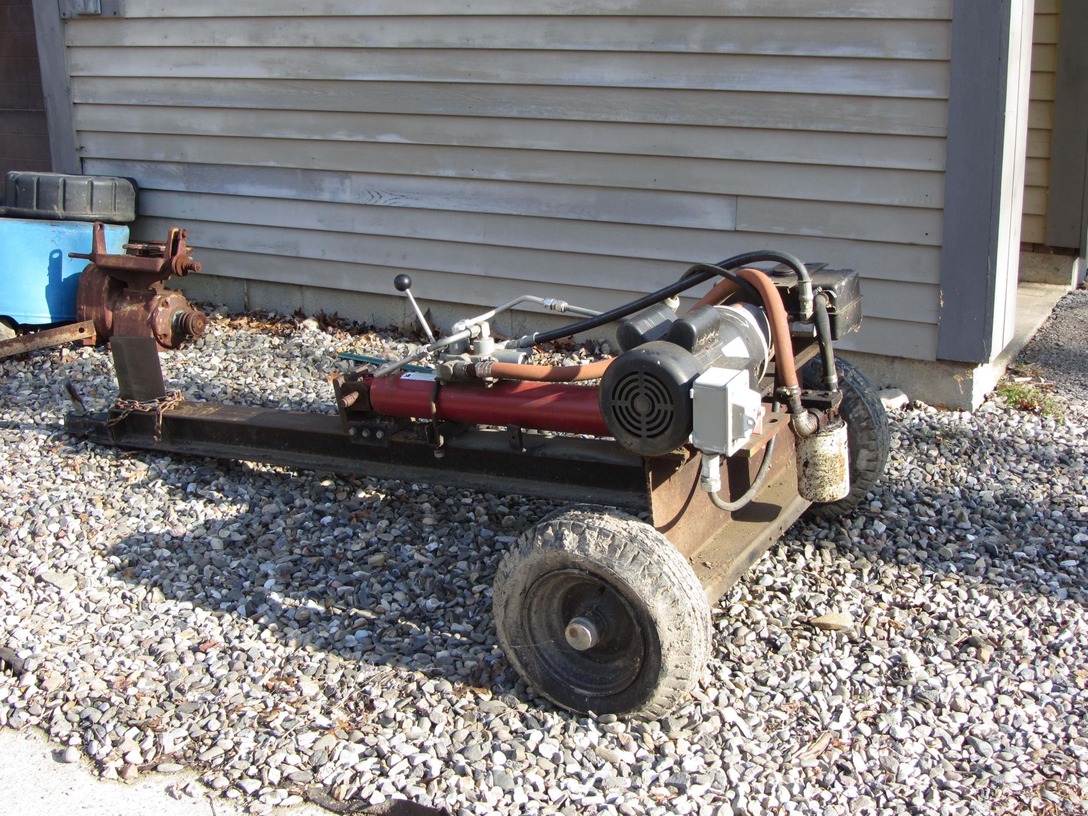

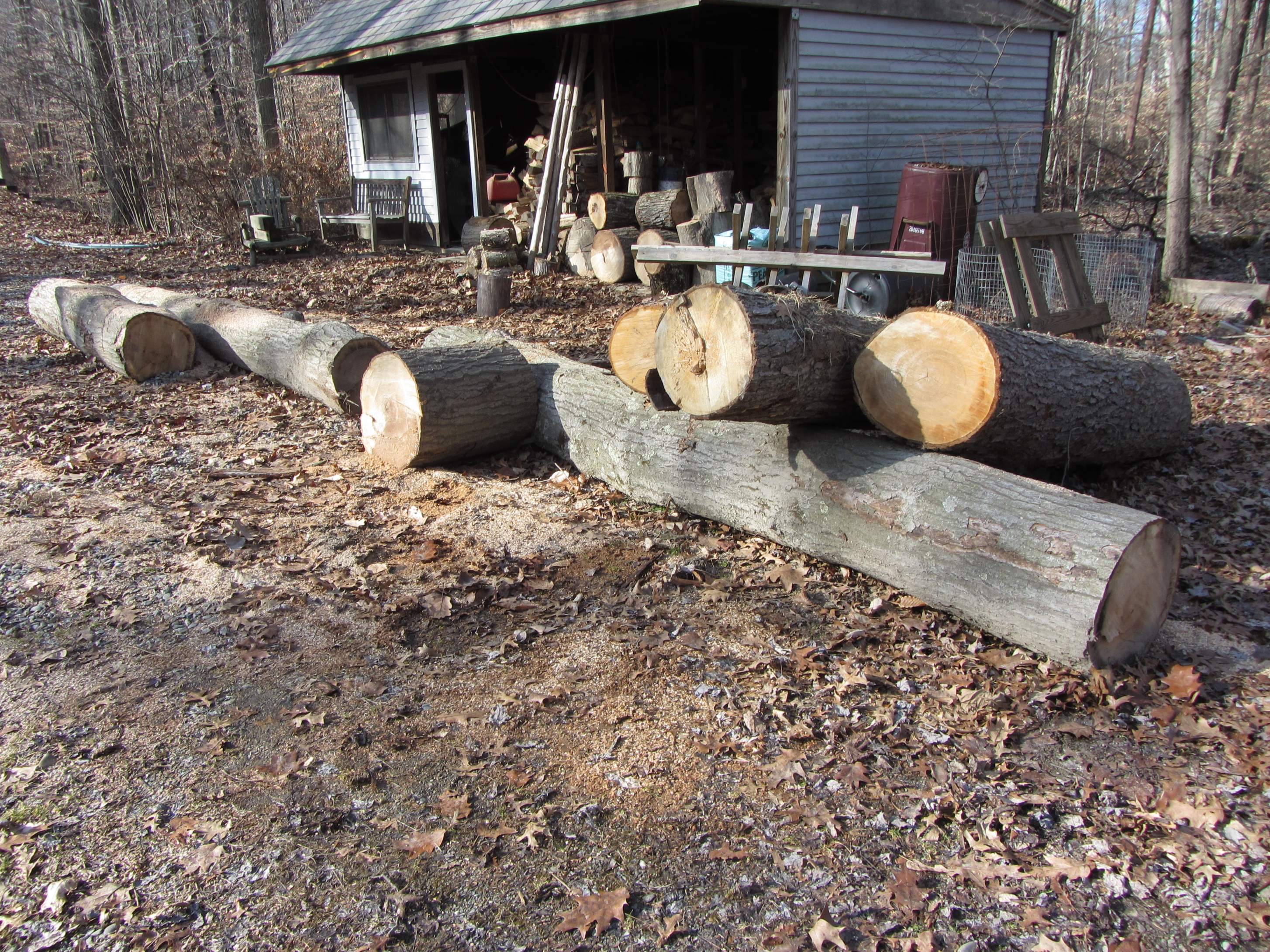

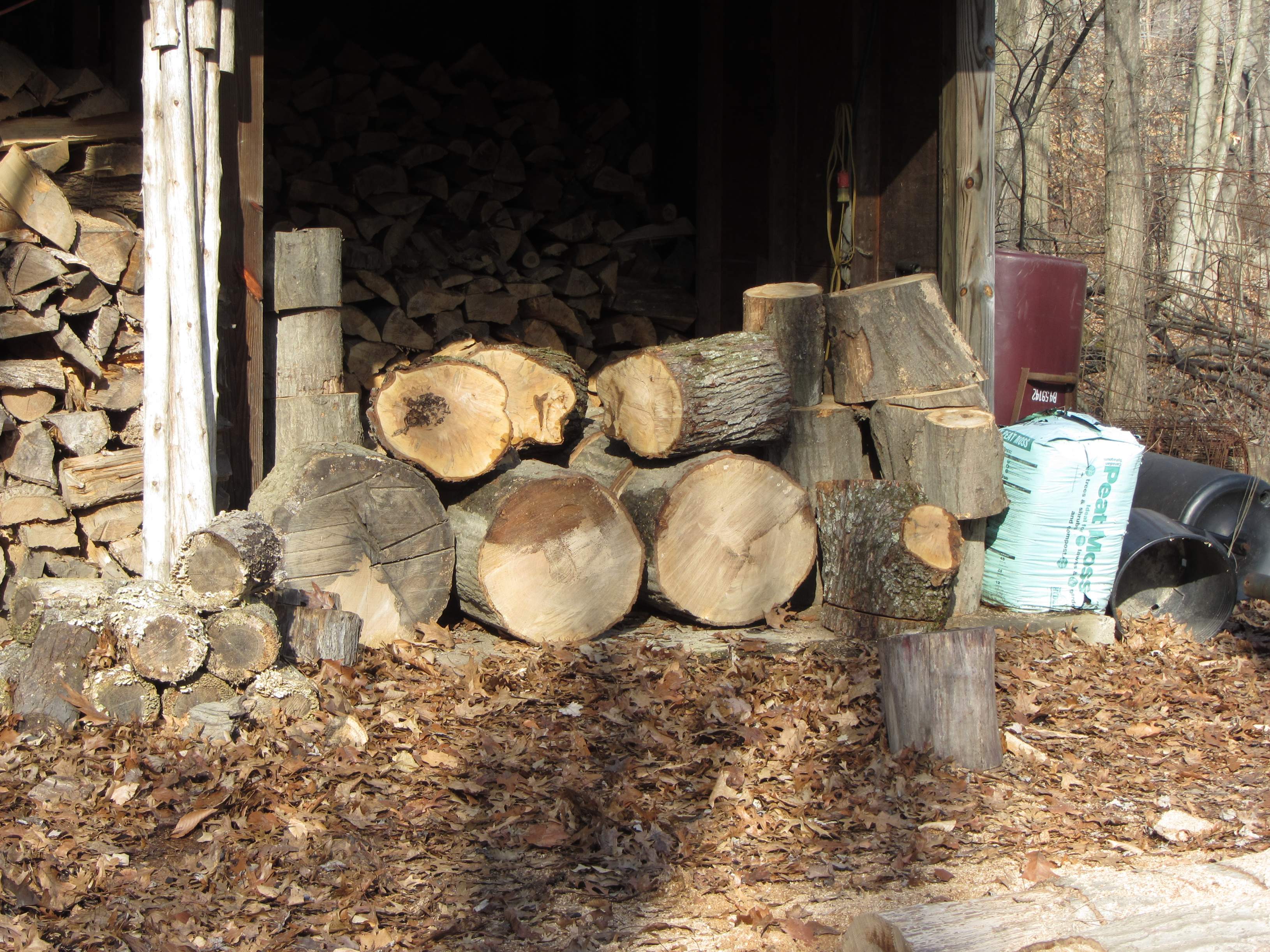

Pictures See those logs Oak and Maple and those are the small ones.
See the little log splitter Thats why I need a bigger one.
Relief valve installed Funny thing about plumbing fittings. Turn them until they point the way you want and then worry about another 360d or will they leak.

Why do you want to disconnect the gauge? Id leave it there full time, they arent that expensive.
There will be pressure there until it bleeds down. The relief will close at its set pressure, disconnecting the tank. The only way it can bleed down will be back through the pump, which could be a slow process. Of course when the splitter is hooked up, and the machine s turned off, you'll have an open path back to tank, so no buildup.
This pressure buildup can happen on equipment. Hoses can be next to impossible to plug / unplug with pressurized fluid in them. You may have to go and manually push the disconnect in to bleed off the pressure.

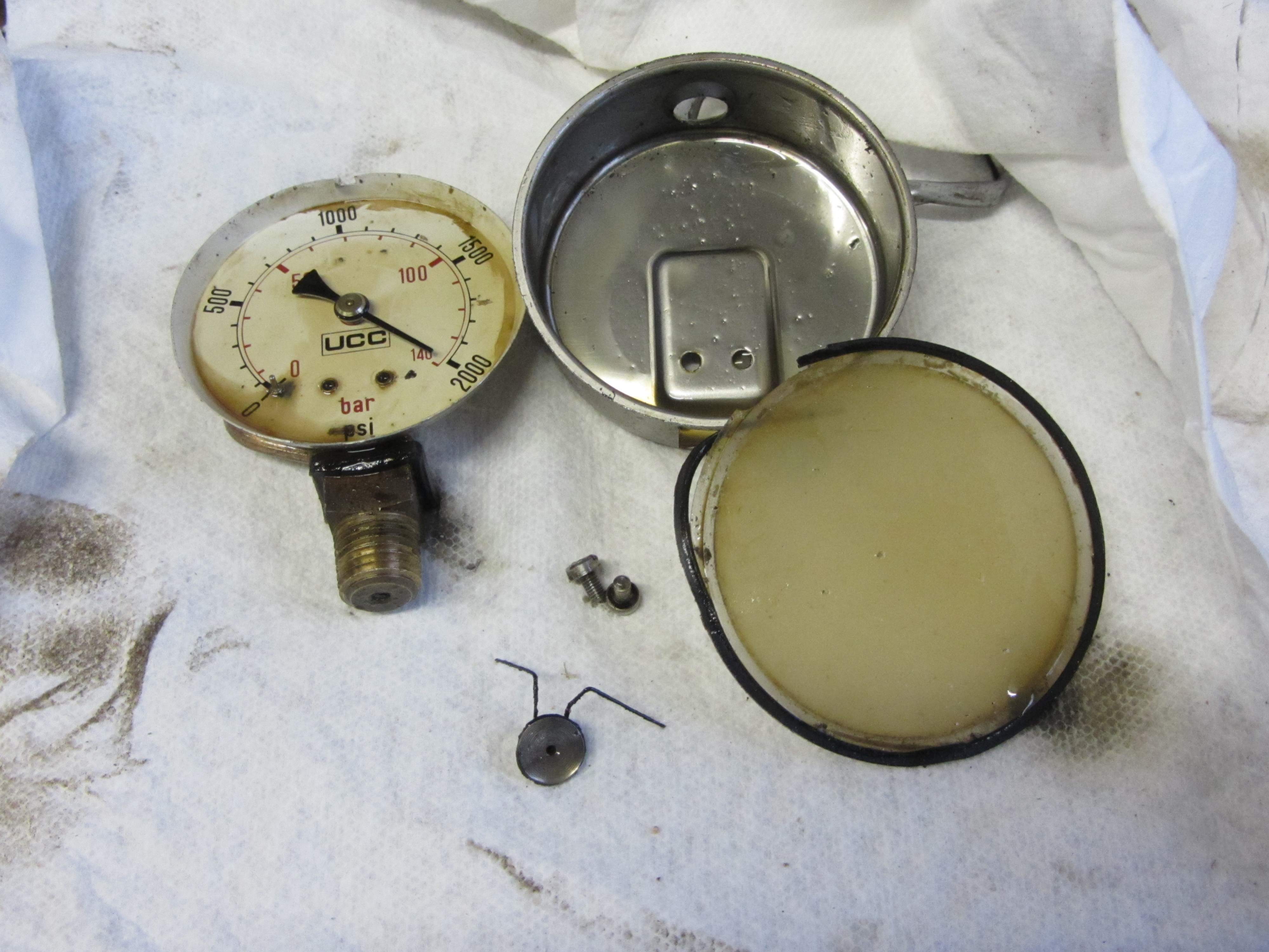

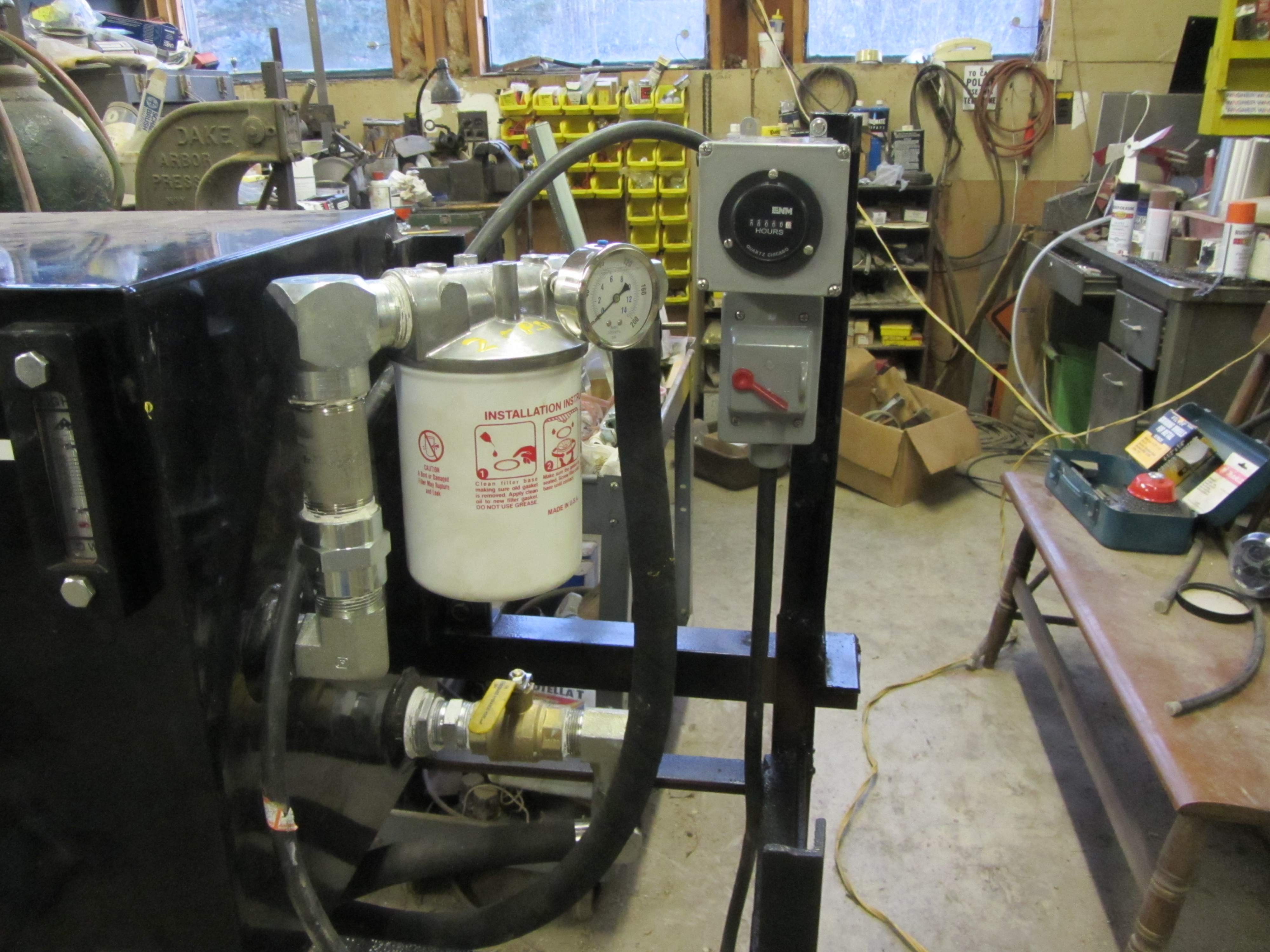

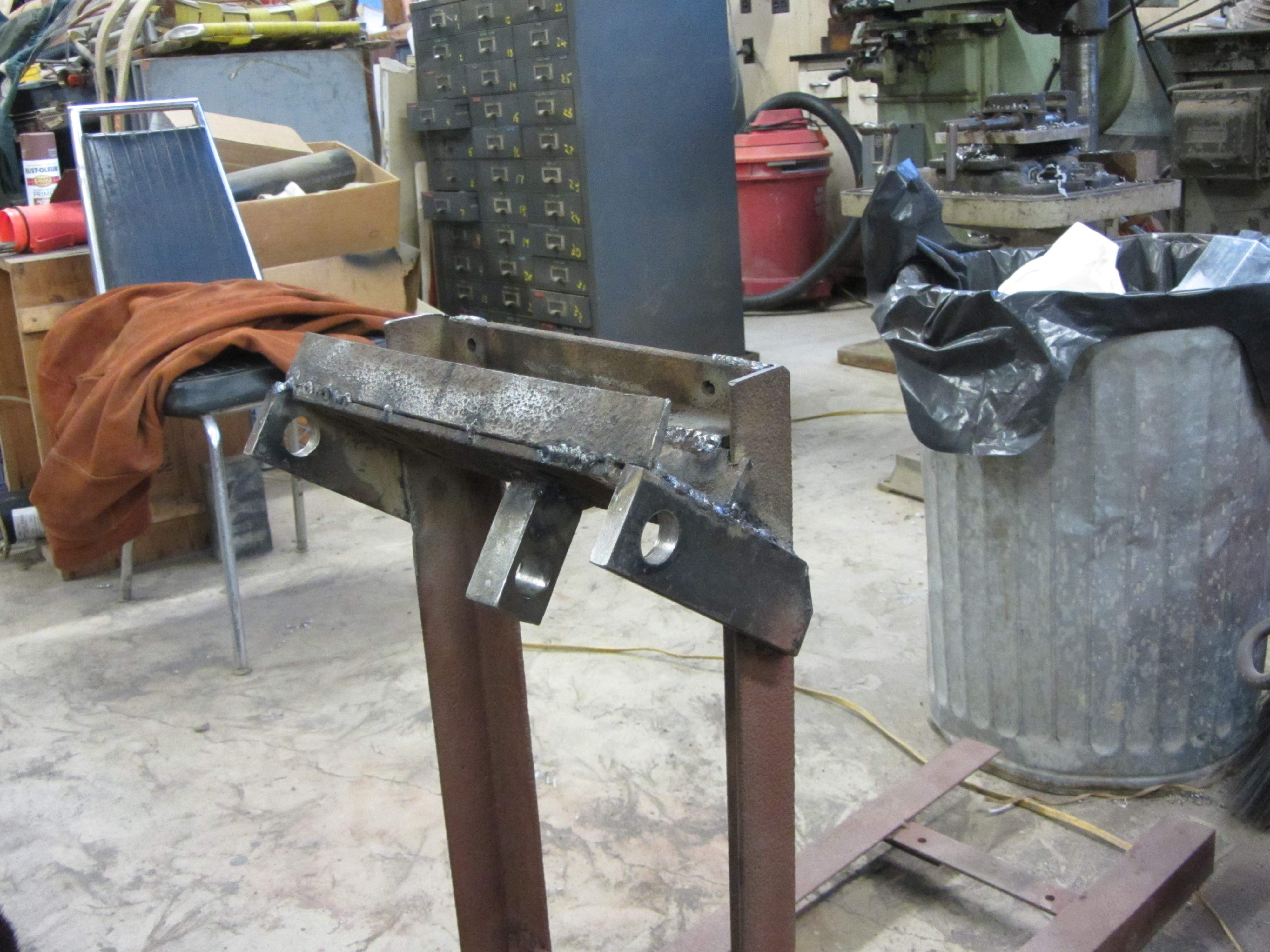

I Slow progress Cold out If I don't get the woodstove running by 10am I am not going to get 4 hours in. Went out to lunch with my wife yesterday. Killed the day for work but the lunch and the company was great.
So First picture My old gage. Face plate was so yellow it was hard to see and the needle was wrong side of zero. So I took it apart. Did anyone know the whole case is filled with gycerine. I think the needle was the wrong side of zero is because it was so cold. It only went to 2000 psi anyway.

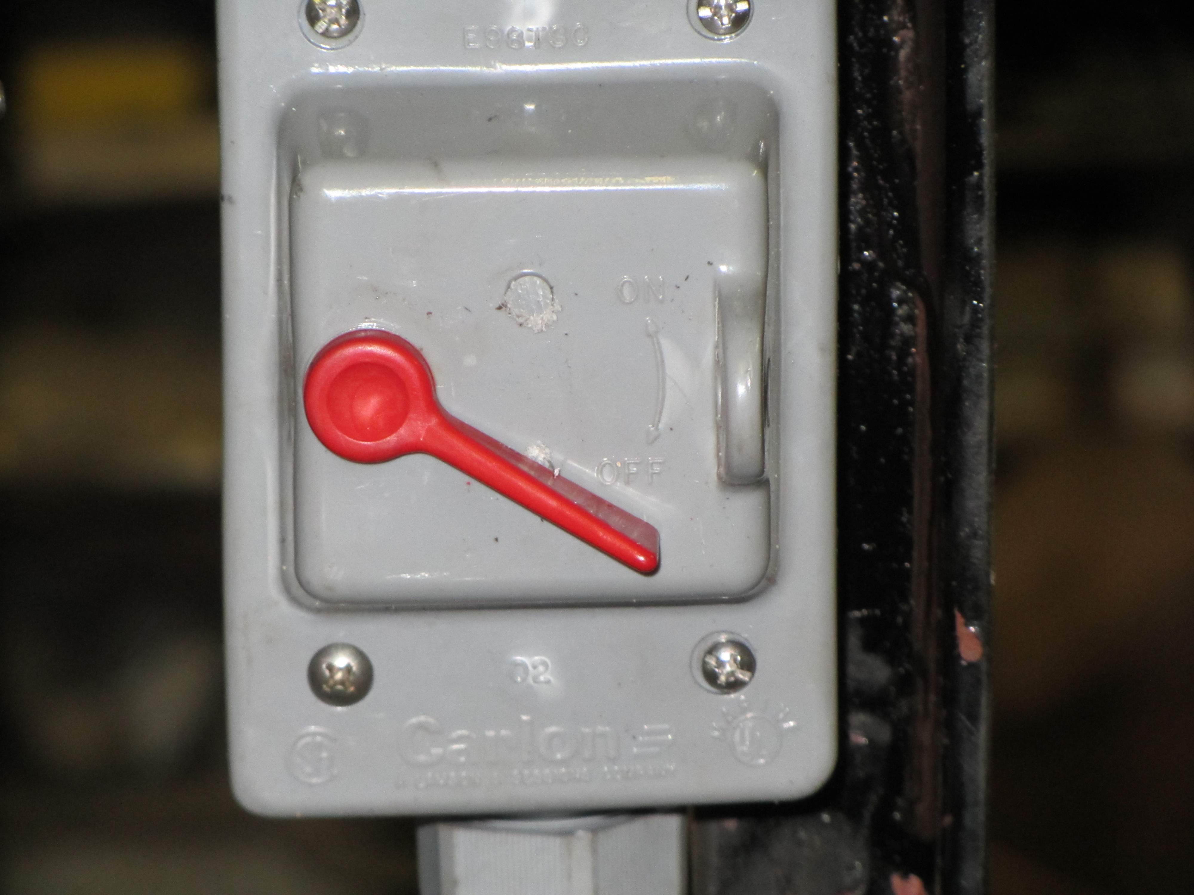

Second picture Electrical switch and hour meter done. Not a great bracket but it works and I am getting tired and cold.
3rd pic cover The switch cover did not work right. I was really annoyed because just before the motor on a TSC 6" cut off saw blew up. And I mean just that It went BANG and caught fire at the vent slots on the front end. I just got it a couple of weeks ago. Don't have the receipt so maybe ,if I am lucky they will exchange it. Back to the switch cover , Not enough throw to go from on to off. So I cut the pins off , Works ok now.

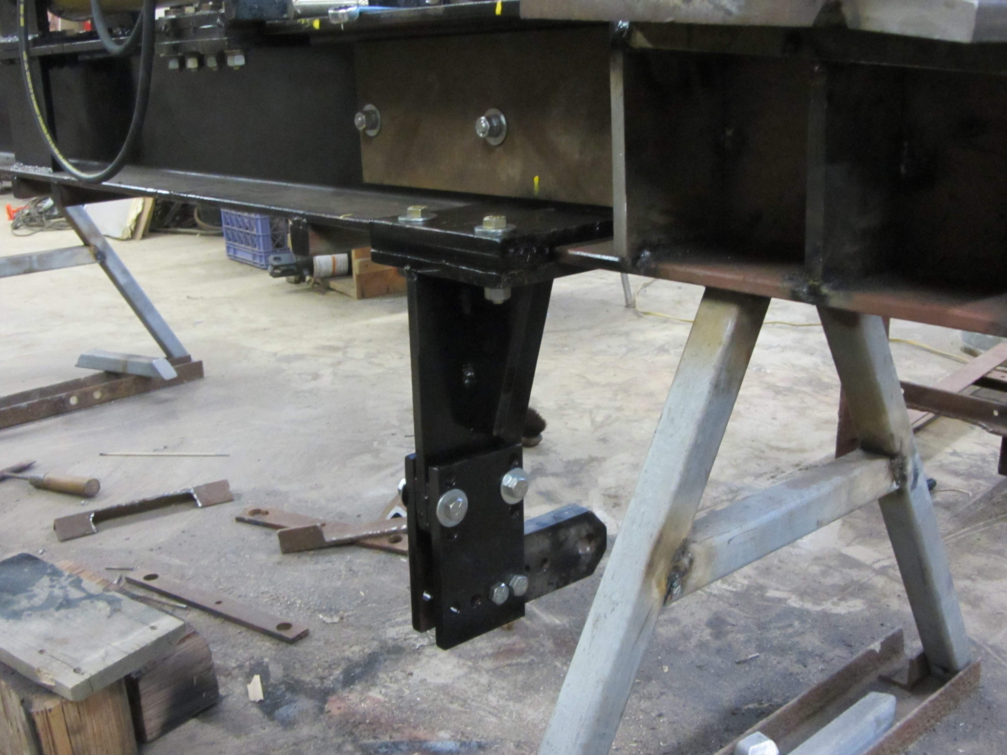

4th pic Finished the mount for the log lift cylinder

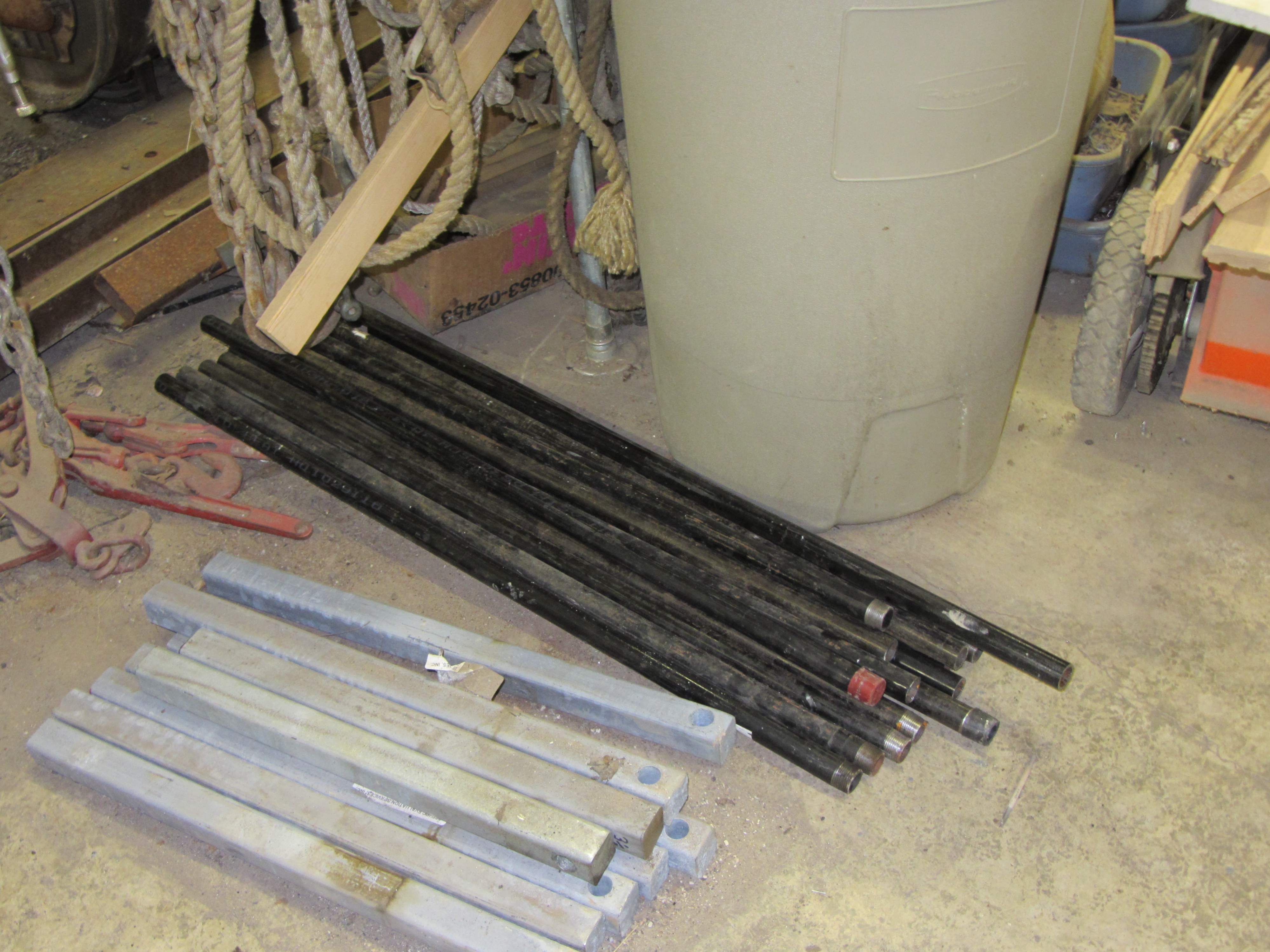

5th pic cut all the pipe for the out feed table
6th pic Log lift pivot s

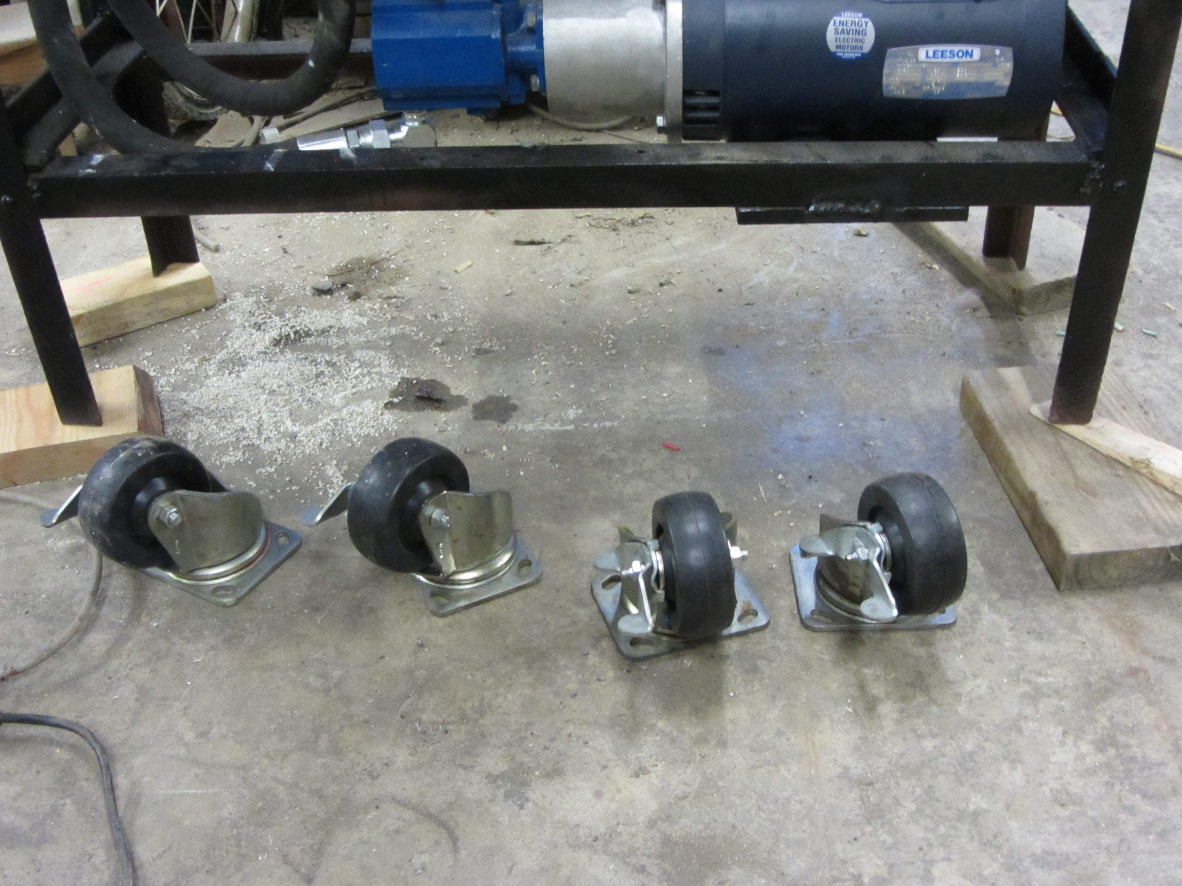

7th pic wheels Have to figuire out how to best mount them on the power supply. Unit is a little top heavy with no oil so I will spread the wheels to the out side. Trip hazard but cannot be helped.
