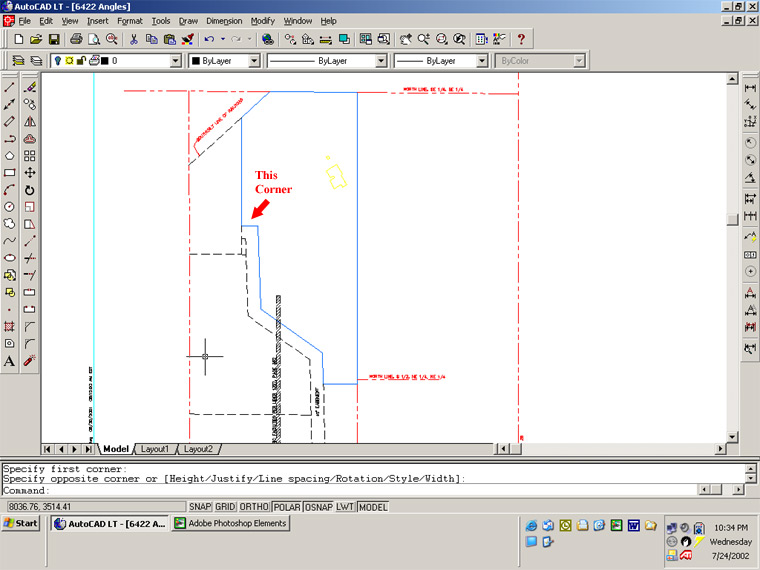

I have attached a view of my property all plotted out on AutoCad by my surveyor. My property is the 9 sided lot in blue that looks kind of like the state of Nevada.

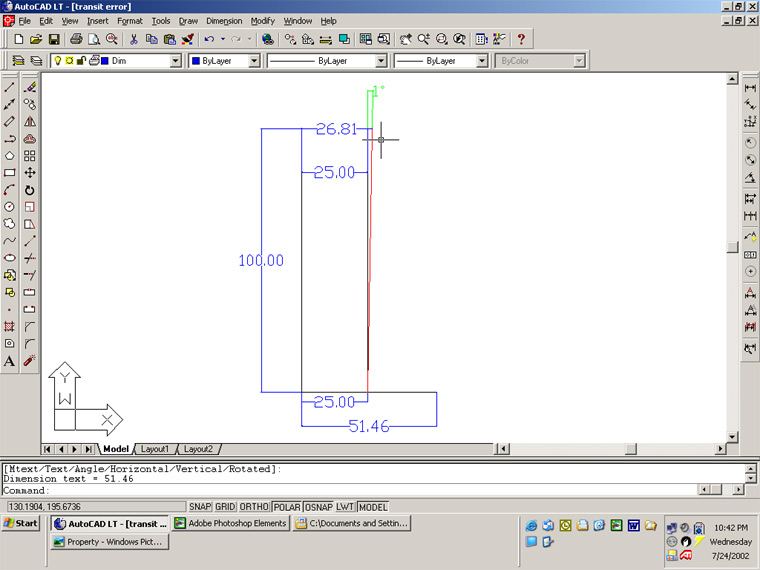

I was working in the corner that I have identified on the drawing. From that corner and going to the right (east) it is exactly 51.46 feet. I stretched a line from the two stakes put in by the surveyor and then measured 25 feet from the corner and set up my automatic level at that point.
I then lined the automatic level up exactly with the corner while the level was set at 270 degrees. I then turned the level to the 0/360 degree mark and centered a stake 100 feet out in the crosshairs. (It might have started at 0/360 and then turned to 270 I don't remember any more).
I then measured from the stake over to the property line and instead of it being 25 feet it was almost 27 feet. I did this same process three times and came up with the same results.
Then instead of starting with the level set to 270 degrees and turing to 0/360 degrees I started with the level a 0 degrees and turned to 90 degrees. The results were about 24 foot 8 inches.
Then I went from 90 degrees to 180 and so forth. So I went back inside and plotted it out on AutoCad (file attached in next post). I turns out that being 1 degree off at 100 feet is a difference of 1.81 feet. That is pretty much what I was coming up with on my own.
So I call CST/Berger and explained all this to them. After a couple of calls I finally got a call back from somebody quite high up. He explained that the auto levels are not meant for turning angles and an enclosed transit was what I needed. He was very helpful and I will continue to buy and recommend their products in the future.

Here is the second file. I hope I have explained this well enough and not confused this issue any further.
