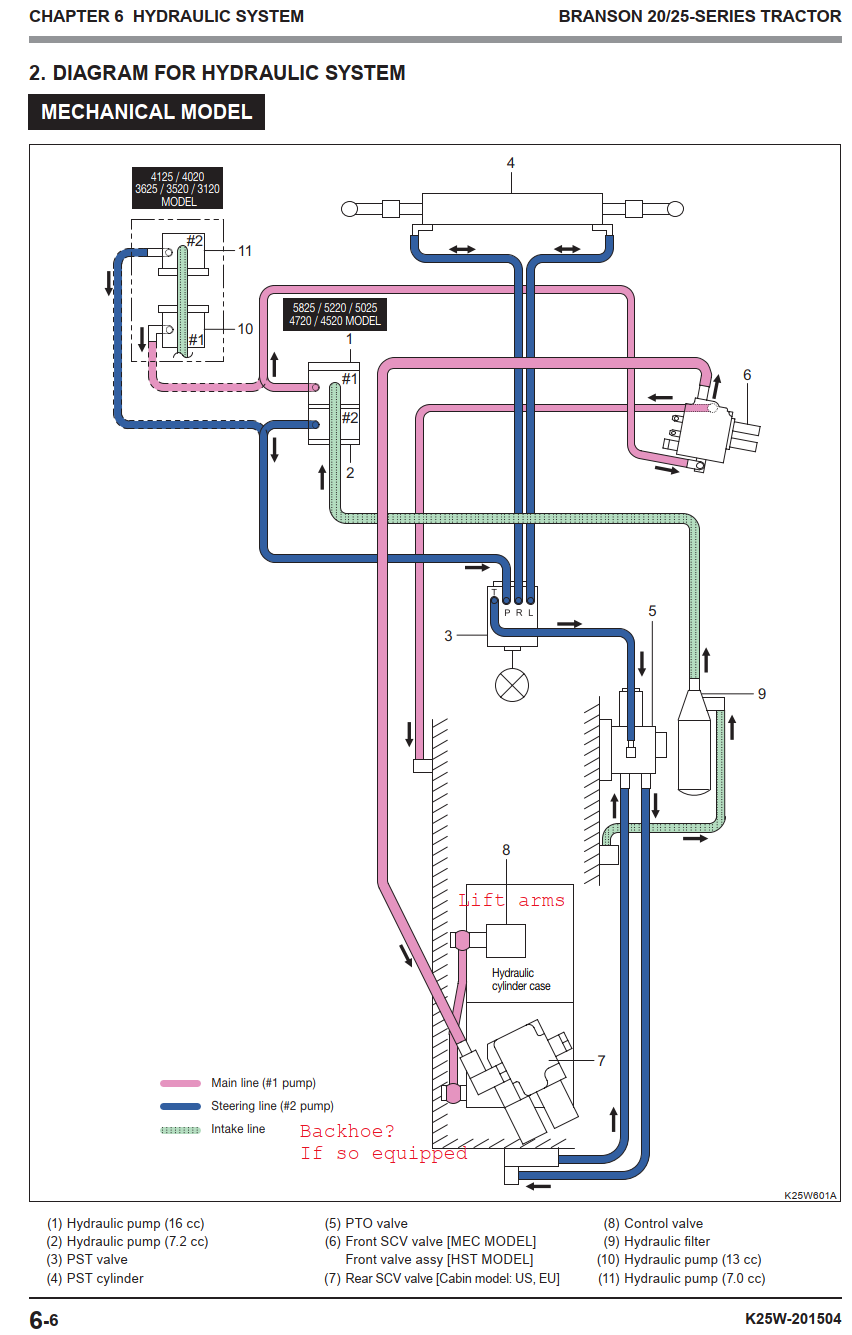

It's the powerbeyond and tank operation and how the backhoe lines are different somehow I think?. Say you only have one valve, the FEL we'll say, if you refer to the updated diagram, it shows a tank return and a powerbeyond, but since this is only one valve, it won't be connected. So, when you're not operating the FEL, there won't be flow, right? Or, is it the case that the PB will always be connected to something? The diagram seems very incomplete, the FEL valve is the only one showing a tank connection. If fluid has to flow, then the 3pt valve must have it's PB connected since if you're not FEL'ing or 3pt hitching, or backhoeing, that's the only way for it to go. But connected to what?
As to the backhoe, it has either no tank line or no PB line, there is only one hose in and one out. Was that just cost reduction and the fact that the 3pt can't be used when the backhoe is on? The necessity for flow would seem to mean its PB is connected to the out line for the case that the backhoe is on but you're not using it, but that really begs the question of what happens with the fluid used when you're operating it?

Forgot the drawing
trx-cap --  - 12_10_2021 , 14_09_26 - Branson 20 series service manual_ - PDF-XChange Editor.png

OK, one last question. I didn't want to mar my posts expressing my appreciation with another question. The valve under consideration seems to be laid out in a nearly universal pattern, there are tons of these things that are all almost identical. The front valve on the 3520 and probably most others has this layout. The issue with doing what I proposed is due to having to connect the tank output of the valve to the BH line that then goes to the 3pt arms and the back-pressure that could develop when using the 3pt lift which could damage the valve. So I need to connect the powerbeyond on the valve to the 3pt hitch, which requires a way to connect the tank-out to the tank. Since the front valve is laid out like the standard pattern, then it has two tank ports which are essentially two holes to the same space, I assume for flexibility in hose positioning, see red arrow in the photo. This would basically t into the tank line from the front valve. I think this should work but I've proven that doesn't mean much!
I've been trying to pick up some knowledge of hydraulic schematics, below is from the service manual. The system is an open system, all the videos I've seem show an open system as an 'H' when the control is centered, all lines connected, and a closed system has the 4 inputs deadended to a 'T', which is what the diagram shows. I'm still working on figuring out what's going on with that but it may have something to do with the little circle that seems to tie the P input to the T output. There is also a check valve which you could call a backflow preventer here. I'm thinking that should work, but I've proven that doesn't mean much! Since the flow to the spools is blocked and with the check valve, that sure seems like doing this won't muck up anything.
Is this doable? Is there another path to the tank I could use? I'm waiting on a price on the factory rear remotes but I have a feeling it's going to be a few hundred dollars more so I'd rather go cheap as long as it will work.

I would use a hydraulic T the tank hose off of the loader valve. I circled where I would put it on your picture.
/ Summit Monoblock Directional Control Valve #40
Just be aware that you will need a Power Beyond plug in the valve that you are using to send the fluid to the P port of the next valve.
Many times the power beyond plug will go in the straight thru port that may be marked as a T port until a power beyond plug is installed.
Attached is a link to a Prince mono block valve installation sheet it shows that the power beyond can be installed in a couple of different
locations and that an internal plug has to be installed in some setups.
