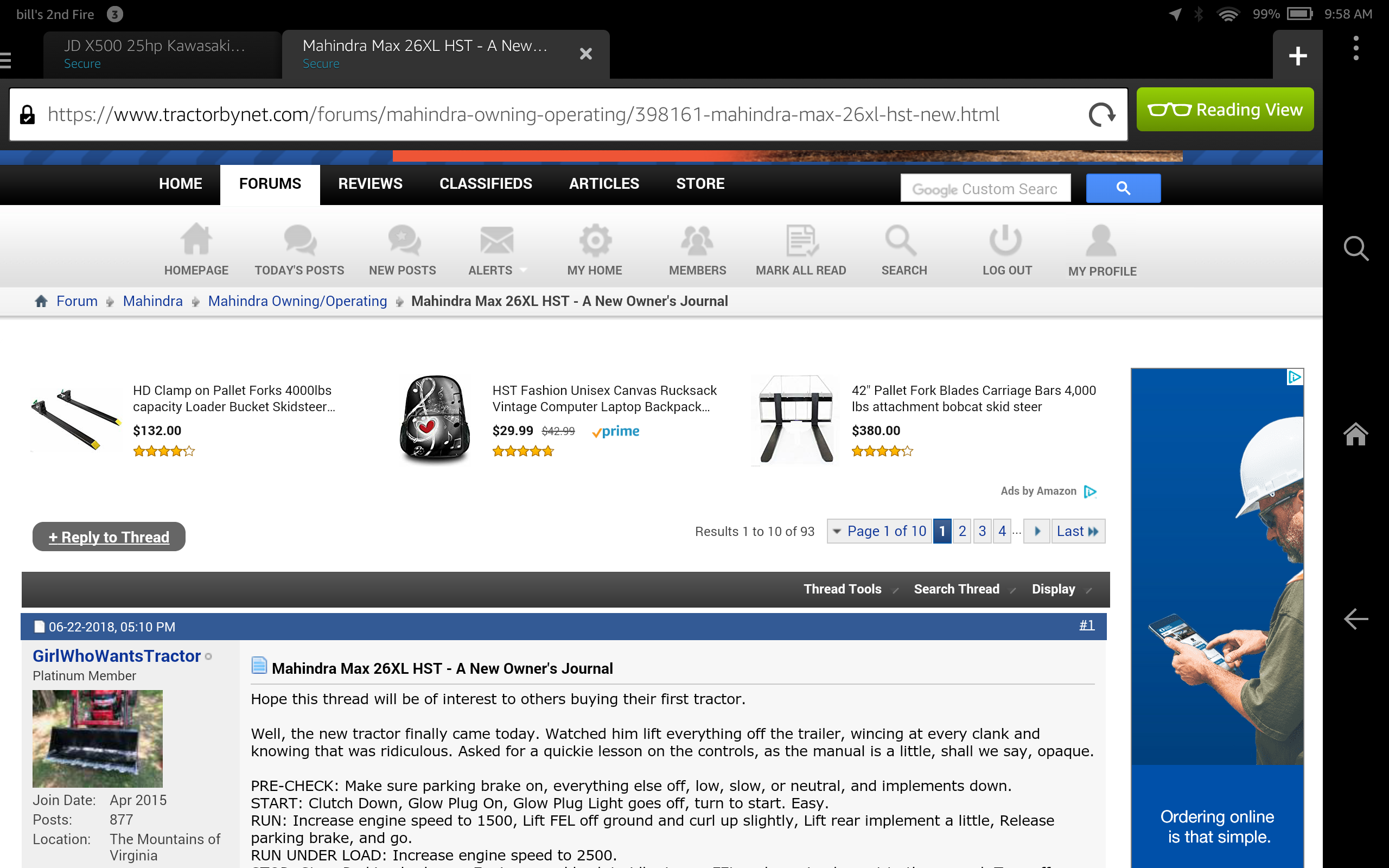

Are rear wheel spread widths adjustable on the Mahindra Max series, or do wheel spacers need to be installed to increase rear wheel separation?
/ Considering a Mahindra 25Max HST #19
Jeffy,
Read the owner journal produced by Girl Who Wants a Tractor. It answers every question feasible that a MAX Series owner or curious party might wish to know about this tractor line up
And since you obviously have NO experience w/ a B H attachment, know that when traveling at grade, operators frequently lower the boom, to offset any negative gravitational forces. There are certain benefits of ownership that are countered by the inaccurate speculation of tractor experts, that simply spread misinformation. Try this: Own it, use it, then comment and DON'T believe all you tube videos are hatched through Devine revelation.
/ Considering a Mahindra 25Max HST #20
Mine aren't adjustable. The wheels are already mounted to provide max spread. You can get wheel spacers after-market only, but it's not clear whether that would affect the warranty on a Mahindra.
