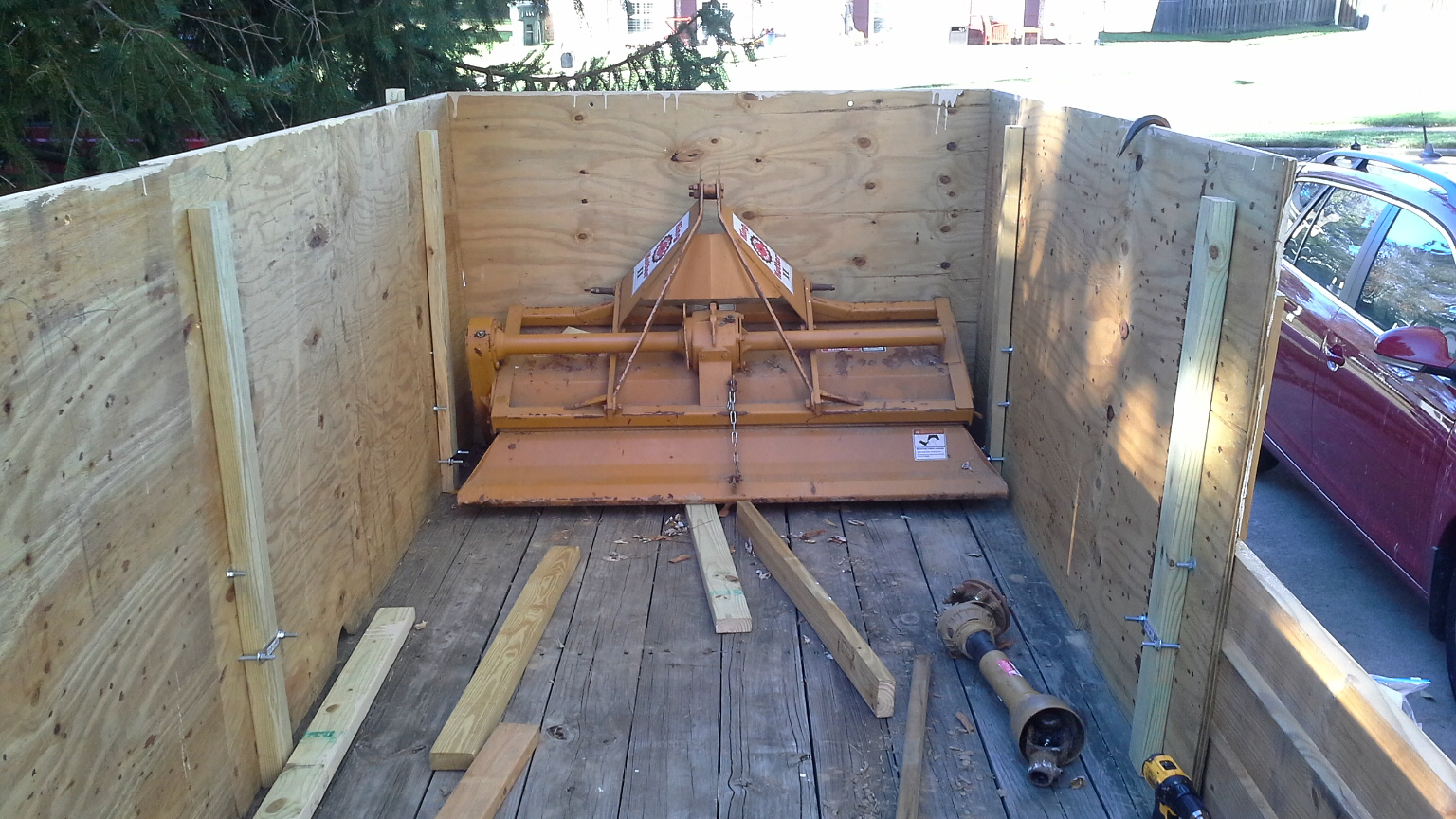

Good luck buying used. It took me about 3 years to pick up a 60" KK off Craigslist. I frequent government auctions, online auctions, Craigs List etc. and the ones that turned up were almost always beaten up badly. FINALLY just before I bought a new one (but just after I bought a new plow) a barely used one turned up for about half the price of new.
