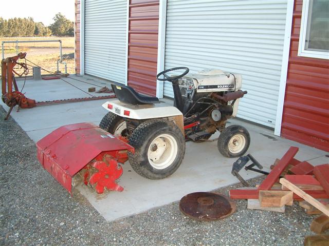

I've used walk behind tillers, 3-pt tillers (Yanmar RS1200 tiller, 48" wide, behind my Kubota B7510HST, and a garden tractor (Bolens GT1453 with 32" wide rototiller). I used the 3-pt tiller to put in about 1/4 acre of landscaping around my house when it was built in 2005. The Bolens was used for my 50x75 ft garden. The walk behind was used for work in tight spaces (shrub beds).
The walk behind was a $200 tiller from Home Depot. The Yanmar cost $250. The Bolens with tiller and 48" wide mid mount mower cost $600 off Craigslist.
Good luck.
